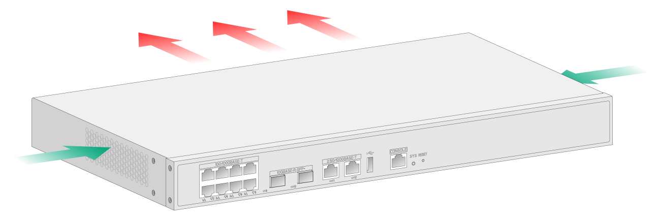

The device intakes air from side panels, and exhausts air from the rear panels. For adequate heat dissipation of the device, follow these guidelines:
·     Plan the installation site for the device based on the airflow direction
·     Reserve a minimum clearance of 100 mm (3.94 in) around the air vents.
·     Make sure the rack or workbench has a good ventilation system.
Figure1-1 Heat dissipation

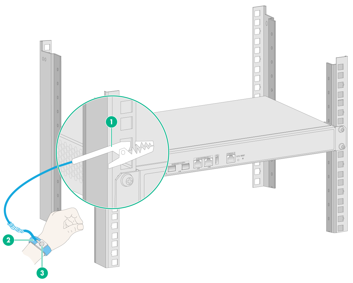

·     Before working with the device, wear ESD gloves and ESD garment, and remove conductive objects such as jewelry or watch. Make sure the wrist strap makes good skin contact and is reliably grounded.
·     Always remember to wear an ESD wrist strap when working with a transceiver module.
No ESD wrist strap is provided with the device. Prepare one yourself.
To attach an ESD wrist strap:
1.     Wear the wrist strap on your wrist.
2.     Lock the wrist strap tight around your wrist to maintain good contact with the skin.
3.     Secure the wrist strap lock and the alligator clip lock together.
4.     Attach the alligator clip to the rack.
5.     Make sure the rack is reliably grounded.
Figure1-2 Attaching an ESD wrist strap
(1) Alligator clip
(2) ESD wrist strap
(3) Lock

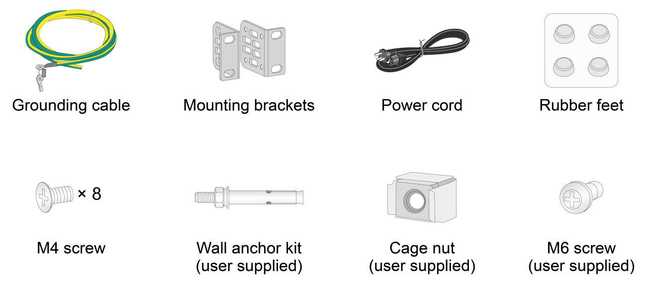

Installation accessories
Figure1-3 Installation accessories for the device
