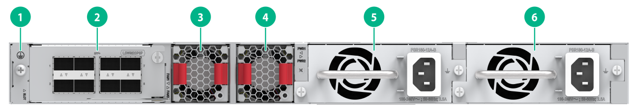

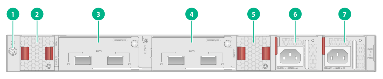

(1) Grounding screw |
(2) Fan tray 1 |
(3) Expansion card 1 |
(4) Expansion card 2 |
(5) Fan tray 2 |
(6) Power supply 1 |
(7) Power supply 2 |
The S5590-28T8XC-HI switch came with power supply slot 1 empty and power supply slot 2 installed with a filler panel. You can install one or two power supplies for the switch as required. In Figure2-2, two PSR250-12A1 AC power supplies are installed in the power supply slots.
The S5590-28T8XC-HI switch came with two fan tray slots empty. You must install two fan trays of the same model for the switch. In Figure2-2, two LSPM1FANSB-SN fan trays are installed in the fan tray slots.
The S5590-28T8XC-HI switch came with two expansion slots each installed with a filler panel. You can select expansion cards for the switch as required. In Figure2-2, two LSWM2QP2P interface cards are installed in the expansion slots.

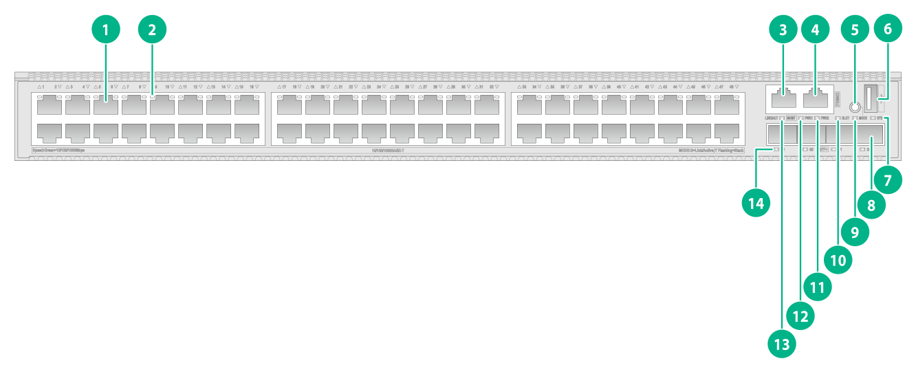

S5590-48T4XC-HI
Figure2-3 Front panel
(1) 10/100/1000BASE-T autosensing Ethernet port |
(2) 10/100/1000BASE-T autosensing Ethernet port LED |
(3) SFP+ port |
(4) Console port (CONSOLE) |
(5) Mode button |
(6) System status LED (SYS) |
(7) Mode LED (MODE) |
(8) Expansion card status LED 1 (SLOT1) |
(9) Expansion card status LED 2 (SLOT2) |
(10) USB port |
(11) Management Ethernet port LED (ACT/LINK) |
(12) Management Ethernet port (MGMT) |
(13) SFP+ port LED |
(2) Fan tray 1 |
(5) Fan tray 2 |
The S5590-48T4XC-HI switch came with power supply slot 1 empty and power supply slot 2 installed with a filler panel. You can install one or two power supplies for the switch as required. In Figure2-4, two PSR250-12A1 AC power supplies are installed in the power supply slots.
The S5590-48T4XC-HI switch came with two fan tray slots empty. You must install two fan trays of the same model for the switch. In Figure2-4, two LSPM1FANSB-SN fan trays are installed in the fan tray slots.
The S5590-48T4XC-HI switch came with two expansion slots each installed with a filler panel. You can select expansion cards for the switch as required. In Figure2-4, two LSWM2QP2P interface cards are installed in the expansion slots.

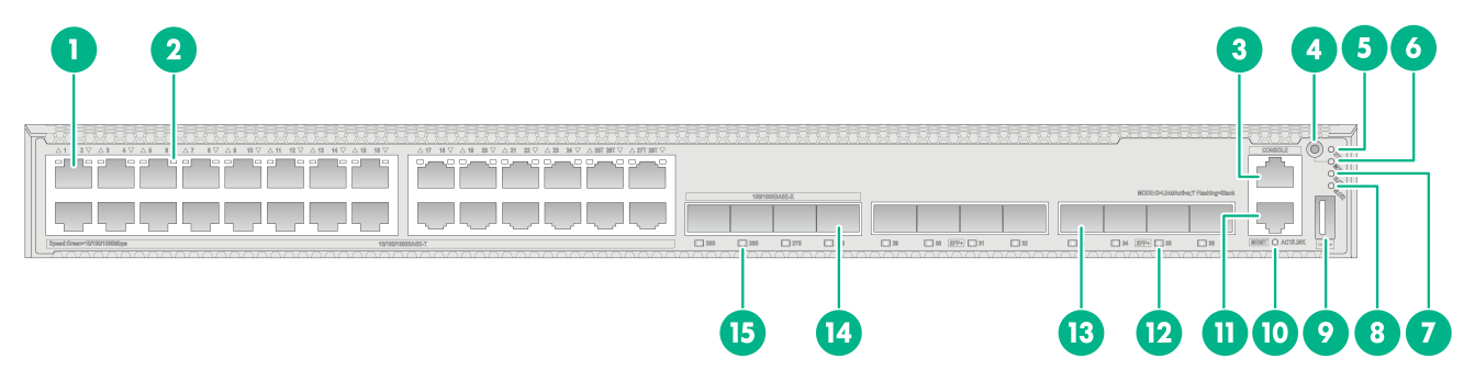

S5590-28S8XC-HI
Figure2-5 Front panel
(1) SFP port |
(2) SFP port LED |
(3) Console port (CONSOLE) |
(4) Mode button |
(5) System status LED (SYS) |
(6) Mode LED (MODE) |
(7) Expansion card status LED 1 (SLOT1) |
(8) Expansion card status LED 2 (SLOT2) |
(9) USB port |
(10) Management Ethernet port LED (ACT/LINK) |
(11) Management Ethernet port (MGMT) |
(12) SFP+ port LED |
(13) SFP+ port |
(14) 10/100/1000BASE-T autosensing Ethernet port |
(15) 10/100/1000BASE-T autosensing Ethernet port LED |

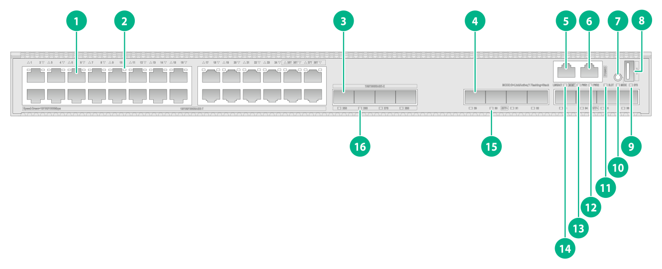

S5590-EI switch series

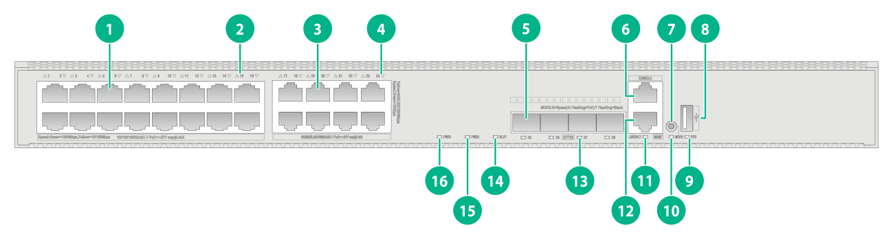

S5590-28T8XC-EI
Figure2-9 Front panel

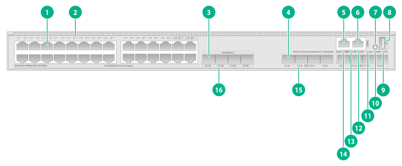

(3) SFP port |
(4) SFP+ port |
(5) Management Ethernet port (MGMT) |
(6) Console port (CONSOLE) |
(7) Mode button |
(8) USB port |
(9) System status LED (SYS) |
(10) Mode LED (MODE) |
(11) Expansion card status LED (SLOT) |
(12) Power supply 2 status LED (PWR2) |
(13) Power supply 1 status LED (PWR1) |
(14) Management Ethernet port LED (ACT/LINK) |
(15) SFP+ port LED |
(16) SFP port LED |

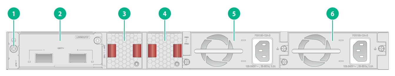

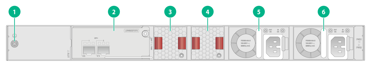

(2) Expansion card |
(3) Fan tray 1 |
(4) Fan tray 2 |
(5) Power supply 1 |
(6) Power supply 2 |
The S5590-28T8XC-EI switch came with power supply slot 1 empty and power supply slot 2 installed with a filler panel. You can install one or two power supplies for the switch as required. In Figure2-10, two PSR180-12A-B AC power supplies are installed in the power supply slots.
The S5590-28T8XC-EI switch came with two fan tray slots empty. You must install two fan trays of the same model for the switch. In Figure2-10, two LSPM1FANSB-SN fan trays are installed in the fan tray slots.
The S5590-28T8XC-EI switch came with one expansion slot installed with a filler panel. You can select an expansion card for the switch as required. In Figure2-10, an LSWM2QP2P interface card is installed in the expansion slot.

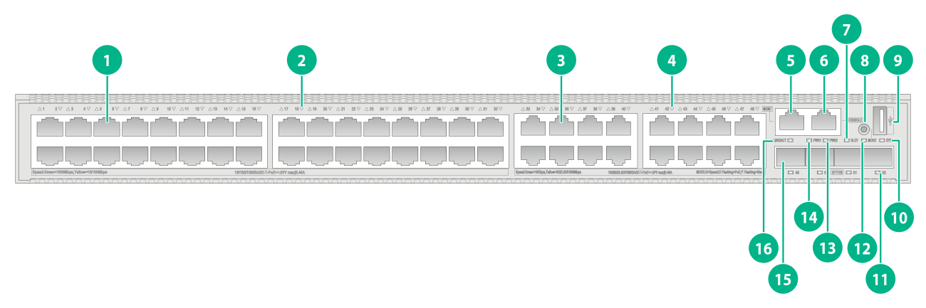

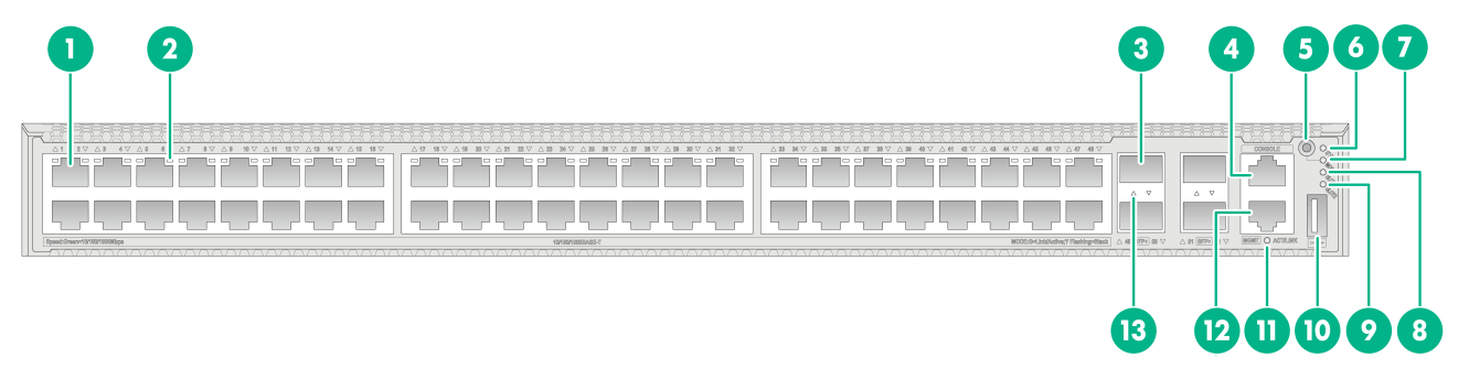

S5590-48T4XC-EI

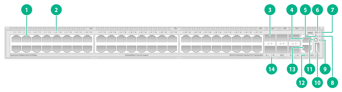

Figure2-11 Front panel
(3) Management Ethernet port (MGMT) |
(5) Mode button |
(6) USB port |
(7) System status LED (SYS) |
(8) SFP+ port |
(9) Mode LED (MODE) |
(10) Expansion card status LED (SLOT) |
(11) Power supply 2 status LED (PWR2) |
(12) Power supply 1 status LED (PWR1) |
(13) Management Ethernet port LED (ACT/LINK) |
(14) SFP+ port LED |
(3) Fan tray 1 |
(4) Fan tray 2 |
The S5590-48T4XC-EI switch came with power supply slot 1 empty and power supply slot 2 installed with a filler panel. You can install one or two power supplies for the switch as required. In Figure2-12, two PSR180-12A-B AC power supplies are installed in the power supply slots.
The S5590-48T4XC-EI switch came with two fan tray slots empty. You must install two fan trays of the same model for the switch. In Figure2-12, two LSPM1FANSB-SN fan trays are installed in the fan tray slots.
The S5590-48T4XC-EI switch came with one expansion slot installed with a filler panel. You can select an expansion card for the switch as required. In Figure2-12, an LSWM2QP2P interface card is installed in the expansion slot.

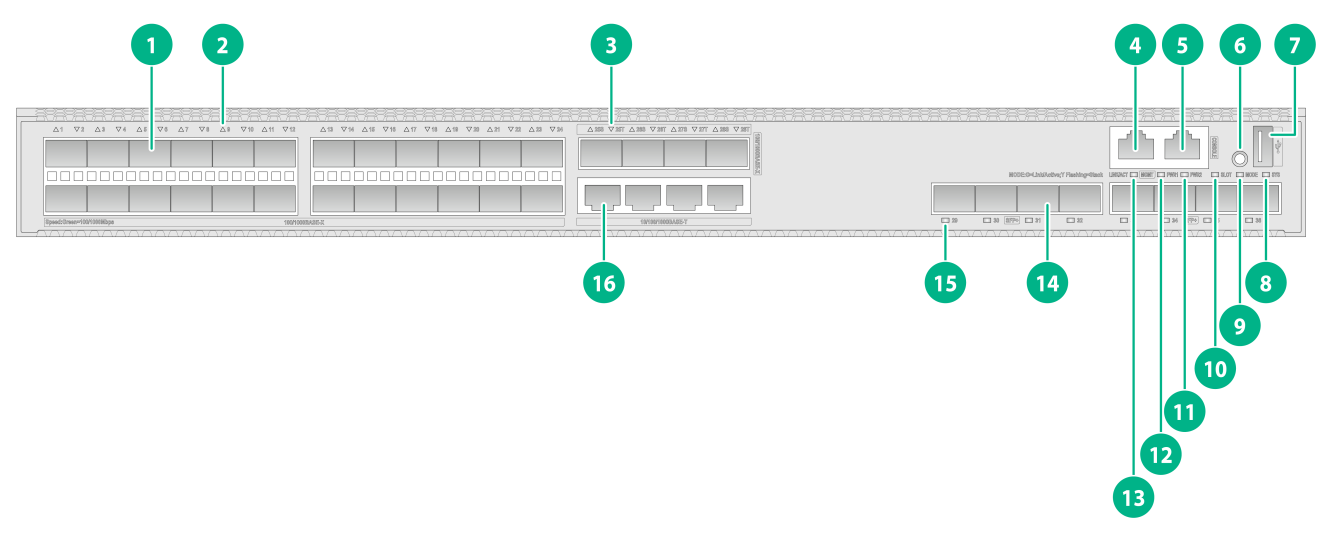

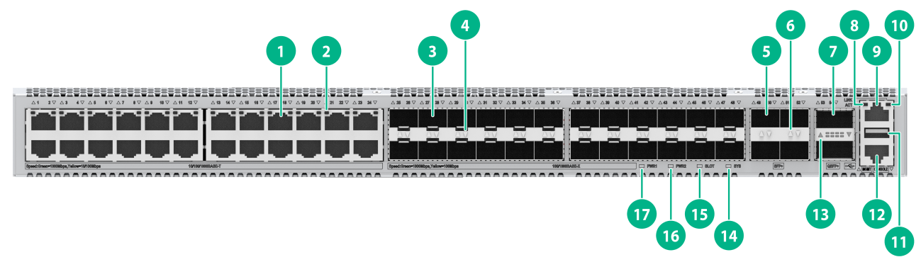

S5590-28S8XC-EI
Figure2-13 Front panel
(1) SFP port |
(2) SFP port LED |
(3) 10/100/1000BASE-T autosensing Ethernet port LED |
(4) Management Ethernet port (MGMT) |
(5) Console port (CONSOLE) |
(6) Mode button |
(7) USB port |
(8) System status LED (SYS) |
(14) SFP+ port |
(16) 10/100/1000BASE-T autosensing Ethernet port |
(3) Fan tray 1 |
(4) Fan tray 2 |
The S5590-28S8XC-EI switch came with power supply slot 1 empty and power supply slot 2 installed with a filler panel. You can install one or two power supplies for the switch as required. In Figure2-14, two PSR180-12A-B AC power supplies are installed in the power supply slots.
The S5590-28S8XC-EI switch came with two fan tray slots empty. You must install two fan trays of the same model for the switch. In Figure2-14, two LSPM1FANSB-SN fan trays are installed in the fan tray slots.
The S5590-28S8XC-EI switch came with one expansion slot installed with a filler panel. You can select an expansion card for the switch as required. In Figure2-14, an LSWM2QP2P interface card is installed in the expansion slot.

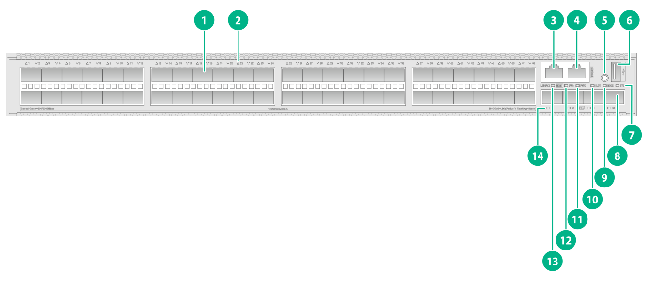

S5590-48S4XC-EI
Figure2-15 Front panel

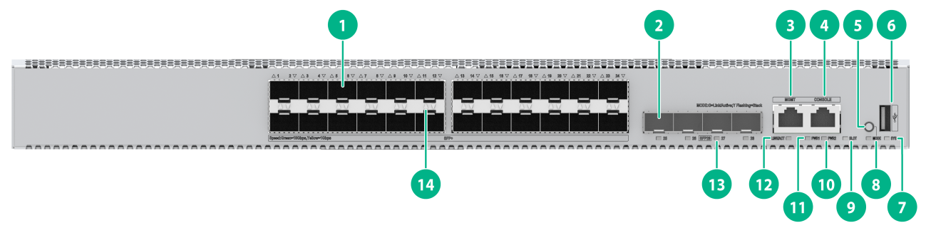

(1) SFP port |
(2) SFP port LED |
(5) Mode button |
(6) USB port |
(8) SFP+ port |
(3) Fan tray 1 |
(4) Fan tray 2 |
The S5590-48S4XC-EI switch came with power supply slot 1 empty and power supply slot 2 installed with a filler panel. You can install one or two power supplies for the switch as required. In Figure2-16, two PSR180-12A-B AC power supplies are installed in the power supply slots.
The S5590-48S4XC-EI switch came with two fan tray slots empty. You must install two fan trays of the same model for the switch. In Figure2-16, two LSPM1FANSB-SN fan trays are installed in the fan tray slots.
The S5590-48S4XC-EI switch came with one expansion slot installed with a filler panel. You can select an expansion card for the switch as required. In Figure2-16, an LSWM2QP2P interface card is installed in the expansion slot.
The S5590-48S4XC-EI switch with PID LS-5590-48S4XC-EI-GL supports shipping with fan trays and power supplies installed. For the switch to be shipped with fan trays or power supplies installed, contact the marketing staff.

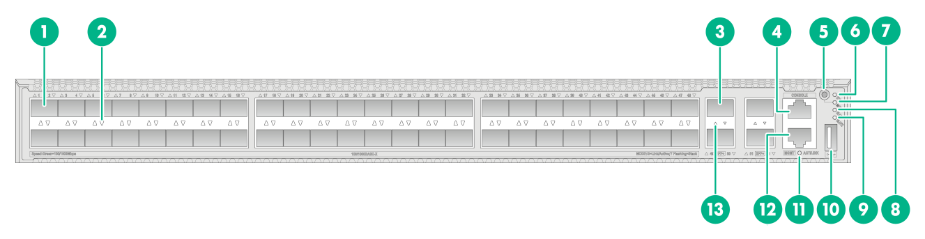

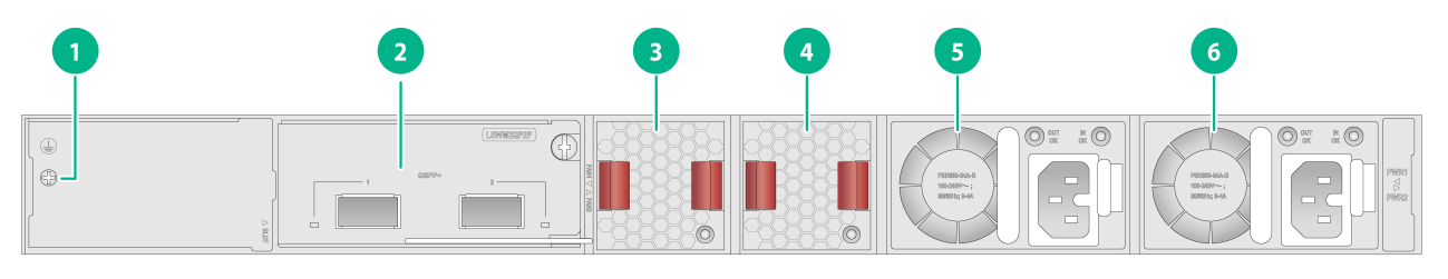

S5590-28P8XC-EI
Figure2-17 Front panel
(3) SFP port |
(4) SFP+ port |
(7) Mode button |
(8) USB port |
(16) SFP port LED |
(3) Fan tray 1 |
(4) Fan tray 2 |
The S5590-28P8XC-EI switch came with power supply slot 1 empty and power supply slot 2 installed with a filler panel. You can install one or two power supplies for the switch as required. In Figure2-18, two PSR600-54A-B AC power supplies are installed in the power supply slots.
The S5590-28P8XC-EI switch came with two fan tray slots empty. You must install two fan trays of the same model for the switch. In Figure2-18, two LSPM1FANSB-SN fan trays are installed in the fan tray slots.
The S5590-28P8XC-EI switch came with one expansion slot installed with a filler panel. You can select an expansion card for the switch as required. In Figure2-18, an LSWM2QP2P interface card is installed in the expansion slot.
The S5590-28P8XC-EI switch with PID LS-5590-28P8XC-EI-GL supports shipping with fan trays and power supplies installed. For the switch to be shipped with fan trays or power supplies installed, contact the marketing staff.

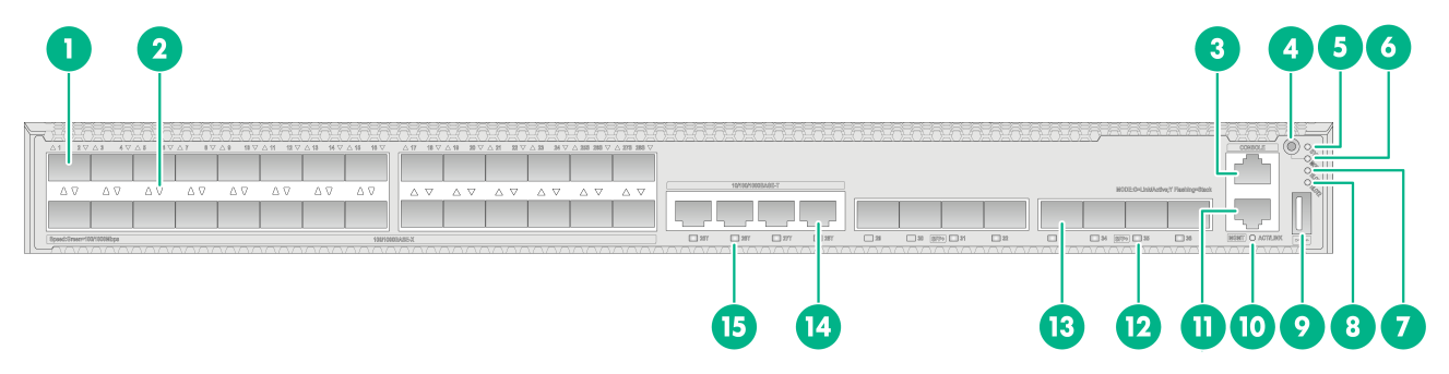

S5590-24X4YC-EI
Figure2-21 Front panel
(1) SFP+ port |
(2) SFP28 port |
(5) Mode button |
(6) USB port |
(8) Mode LED (MODE) |
(9) Expansion card status LED (SLOT) |
(10) Power supply 2 status LED (PWR2) |
(11) Power supply 1 status LED (PWR1) |
(12) Management Ethernet port LED (LINK/ACT) |
(13) SFP28 port LED (SFP28) |
(3) Fan tray 1 |
(4) Fan tray 2 |
The S5590-24X4YC-EI switch came with power supply slot 1 empty and power supply slot 2 installed with a filler panel. You can install one or two power supplies for the switch as required. In Figure2-22, two PSR180-12A-B AC power supplies are installed in the power supply slots.
The S5590-24X4YC-EI switch came with two fan tray slots empty. You must install two fan trays of the same model for the switch. In Figure2-22, two LSPM1FANSB-SN fan trays are installed in the fan tray slots.
The S5590-24X4YC-EI switch came with one expansion slot installed with a filler panel. You can select an expansion card for the switch as required. In Figure2-22, an LSWM2SP8P interface card is installed in the expansion slot.
S5590-48TS4X2QC-EI
Figure2-23 Front panel
(3) SFP port |
(4) SFP port LED |
(5) SFP+ port |
(6) SFP+ port LED |
(7) QSFP+ port |
(8) Management Ethernet port LED (ACT) |
(9) Management Ethernet port (MGMT) |
(10) Management Ethernet port LED (LINK) |
(11) USB port |
(12) Console port (CONSOLE) |
(13) QSFP+ port LED |
(14) System status LED (SYS) |
(15) Expansion card status LED (SLOT) |
(16) Power supply 2 status LED (PWR2) |
(17) Power supply 1 status LED (PWR1) |
(3) Fan tray 1 |
(4) Fan tray 2 |
The S5590-48TS4X2QC-EI switch came with power supply slot 1 empty and power supply slot 2 installed with a filler panel. You can install one or two power supplies for the switch as required. In Figure2-24, two PSR180-12A-B AC power supplies are installed in the power supply slots.
The S5590-48TS4X2QC-EI switch came with two fan tray slots empty. You must install two fan trays of the same model for the switch. In Figure2-24, two LSPM1FANSB-SN fan trays are installed in the fan tray slots.
The S5590-48TS4X2QC-EI switch came with one expansion slot installed with a filler panel. You can select an expansion card for the switch as required. In Figure2-24, an LSWM2SP8P interface card is installed in the expansion slot.
S5590-24UXM4YC-EI
Figure2-25 Front panel
(3) 10G/5G/2.5G/1000 BASE-T autosensing Ethernet port |
(4) 10G/5G/2.5G/1000 BASE-T autosensing Ethernet port LED |
(5) SFP28 port |
(7) Mode button |
(8) USB port |
(11) Management Ethernet port LED (LINK/ACT) |
(12) Management Ethernet port |
(13) SFP28 port LED |
(14) Expansion card status LED (SLOT) |
(15) Power supply 2 status LED (PWR2) |
(16) Power supply 1 status LED (PWR1) |
(3) Fan tray 1 |
(4) Fan tray 2 |
The S5590-24UXM4YC-EI switch came with power supply slot 1 empty and power supply slot 2 installed with a filler panel. You can install one or two power supplies for the switch as required. In Figure2-26, two PSR600-54A-B AC power supplies are installed in the power supply slots.
The S5590-24UXM4YC-EI switch came with two fan tray slots empty. You must install two fan trays of the same model for the switch. In Figure2-26, two LSPM1FANSB-SN fan trays are installed in the fan tray slots.
The S5590-24UXM4YC-EI switch came with one expansion slot installed with a filler panel. You can select an expansion card for the switch as required. In Figure2-26, an LSWM2SP2PB interface module is installed in the expansion slot.
S5590-48UXM4YC-EI
Figure2-27 Front panel
(5) Management Ethernet port |
(7) Expansion card status LED (SLOT) |
(8) Mode button |
(9) USB port |
(10) System status LED (SYS) |
(11) SFP28 port LED |
(12) Mode LED (MODE) |
(13) Power supply 2 status LED (PWR2) |
(14) Power supply 1 status LED (PWR1) |
(15) SFP28 port |
(16) Management Ethernet port LED (LINK/ACT) |
(3) Fan tray 1 |
(4) Fan tray 2 |
The S5590-48UXM4YC-EI switch came with power supply slot 1 empty and power supply slot 2 installed with a filler panel. You can install one or two power supplies for the switch as required. In Figure2-28, two PSR600-54A-B AC power supplies are installed in the power supply slots.
The S5590-48UXM4YC-EI switch came with two fan tray slots empty. You must install two fan trays of the same model for the switch. In Figure2-28, two LSPM1FANSB-SN fan trays are installed in the fan tray slots.
The S5590-48UXM4YC-EI switch came with one expansion slot installed with a filler panel. You can select an expansion card for the switch as required. In Figure2-28, an LSWM2SP2PB interface module is installed in the expansion slot.

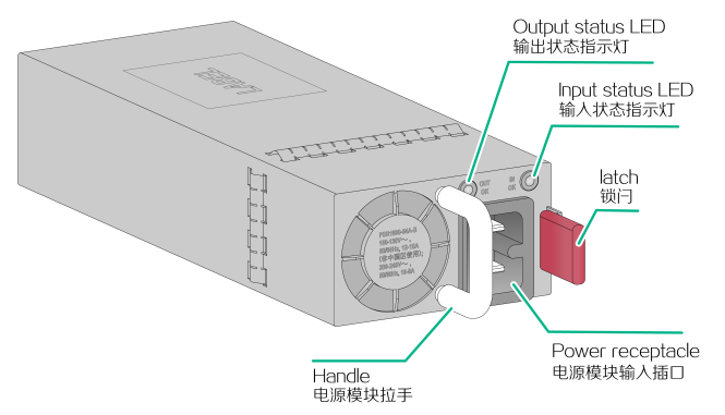

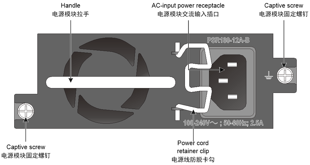

180W AC power supplies (PSR180-12A-F and PSR180-12A-B)
View
Figure4-2 PSR180-12A-B AC power supply view
The views of the PSR180-12A-F and PSR180-12A-B AC power supplies are similar, with only differences in the identifier.
Features
PSR180-12A-F and PSR180-12A-B are AC power supplies with AC input and DC output. The power supplies provide an output voltage of 12 V and a maximum output of 180 W. Table4-3 describes the features provided by the PSR180-12A-F and PSR180-12A-B power supplies.
Table4-3 Features provided by the PSR180-12A-F and PSR180-12A-B power supplies
Feature |
Description |
Protection function |
Protection against input overcurrent, input undervoltage, output overvoltage, output current limiting, output shortcircuit, and overtemperature conditions. |
Support for redundancy |
Two power supplies can be connected in parallel to achieve 1+1 redundancy and load balancing. |
Support for hot swapping |
You can remove one of the power supplies in 1+1 redundancy when the switch is operating correctly. |

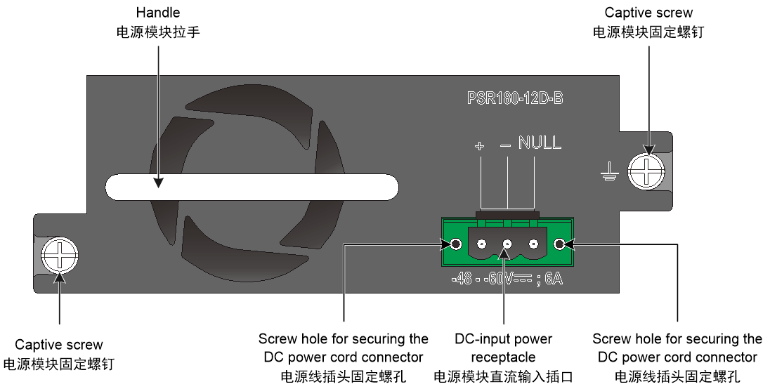

180W DC power supply (PSR180-12D-B)
View
Figure4-3 PSR180-12D-B DC power supply view
Features
PSR180-12D-B is a DC power supply with DC input and DC output. The power supply provides an output voltage of 12 V and a maximum output of 180 W. Table4-5 describes the features provided by the PSR180-12D-B power supply.
Table4-5 Features provided by the PSR180-12D-B power supply
Feature |
Description |
Technical specifications
Table4-6 Technical specifications
Item |
Specification |
Dimensions (H × W × D) |
41.1 × 101.6 × 207 mm (1.62 × 4.00 × 8.15 in), including the handle |
Weight |
1 kg (2.20 lb) |
Rated input voltage range |
–48 to –60 VDC |
Max input voltage range |
–36 to –72 VDC |
Rated input current |
N/A |
Rated output current |
15 A |
Rated output voltage |
12 V |
Rated output power |
180 W |
Melting current of power supply fuse |
8 A/125 V |
600W power supply (PSR600-54A-B)
View
Figure4-4 PSR600-54A-B AC power supply view
For information about the status LEDs, see "Status LEDs on a 600W/920W/1600W power supply."
Features
PSR600-54A-B is an AC power supply with AC or HVDC input and DC output. Table4-7 describes the features provided by the PSR600-54A-B power supply.
Table4-7 Features provided by the PSR600-54A-B power supply
Feature |
Description |
Table4-8 Technical specifications
Item |
Specification |
40.2 × 73.5 × 213.8 mm (1.58 × 2.89 × 8.42 in), including the handle |
Weight |
1 kg (2.20 lb) |
Rated AC input voltage range |
AC input: 100 VAC to 240 VAC @ 50 or 60 Hz HVDC input: 240 VDC |
Max AC input voltage range |
AC input: 90 VAC to 290 VAC @ 47 to 63 Hz HVDC input: 180 to 320 VDC |
N/A |
11 A |
56 V |
600 W |
10 A/250 V |

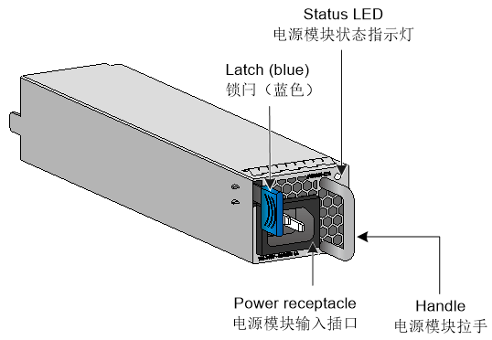

920W power supply (PSR920-54A-B)
View
Figure4-5 PSR920-54A-B AC power supply view
Features
PSR920-54A-B is an AC power supply with AC or HVDC input and DC output. Table4-9 describes the features provided by the PSR920-54A-B power supply.
Table4-9 Features provided by the PSR920-54A-B power supply
Feature |
Description |
Table4-10 Technical specifications
Item |
Specification |
Weight |
1 kg (2.20 lb) |
N/A |
16.5 A |
56 V |
920 W |
16 A/250 V |

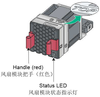

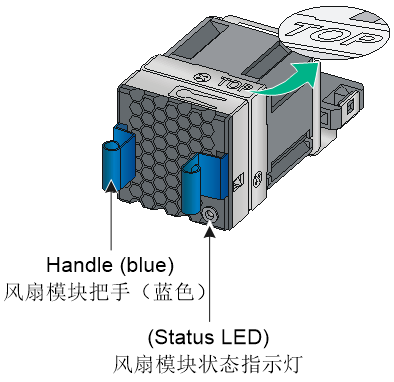

5 Removable fan trays
LSPM1FANSA-SN
View
Figure5-1 LSPM1FANSA-SN fan tray view
For information about the status LED, see "Fan tray status LED on a fan tray."
Features
The LSPM1FANSA-SN fan tray blows air from the power supply side to the port side. The fan tray features small size, fast heat dissipation, and hot swapping. It can automatically adjust the fan speed, providing powerful heat dissipation for the switch.
Table5-1 Technical specifications
Item |
Specification |
40 × 40.6 × 105 mm (1.57 × 1.60 × 4.13 in), including the handle |
Fan quantity |
1 |
Weight |
N/A |
Airflow direction |
Air drawn in from the fan tray faceplate |
Fan speed |
20000 R.P.M |
Max airflow |
20 CFM (0.57 m3/min) |
Input voltage |
12 V |
Max power consumption |
9.8 W |

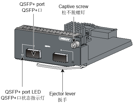

LSWM2QP2P
About LSWM2QP2P
The LSWM2QP2P interface card provides two QSFP+ ports.
Figure6-1 LSWM2QP2P interface card view
Ports and LEDs
For information about the ports and transceiver modules and cables available for the ports, see "QSFP+ port."
For information about the LEDs, see "QSFP+ port LED."

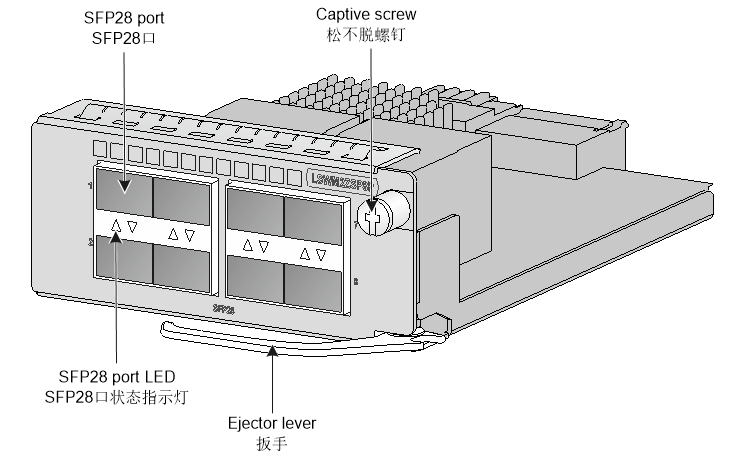

LSWM2ZSP8P
About LSWM2ZSP8P
The LSWM2ZSP8P interface module provides eight SFP28 ports.
Figure6-4 LSWM2ZSP8P interface module view
Ports and LEDs
For information about the ports and transceiver modules and cables available for the ports, see "SFP+ port" and "SFP28 port."
For information about the LEDs, see "SFP28 port LED."
NOTE: To use the LSWM2ZSP8P interface module, make sure the four lowest-numbered or four highest-numbered ports on the interface module have the same port rate and duplex mode. |

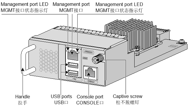

LSWM2EC
About LSWM2EC
The LSWM2EC EPS scanner module scans network-wide endpoints as instructed by the EPS server for port type and operating system type automatically and sends scanning results to the EPS server. Upon receiving the port information, the EPS server provides a baseline management over the endpoints that access the network system. By using this module on a switch, you can save hardware resources, increase the number of endpoints that can be scanned, and perform incremental scanning.
Figure6-5 LSWM2EC EPS scanner module view
LEDs
For information about the management port LEDs, see "LEDs on an LSWM2EC EPS scanner module."
Table6-2 Technical specifications
Item |
Specification |
Processor |
Intel C3758, 2.2 GHz |
DDR |
8G DDR4 |
Flash |
64GB EMMC |
Operating system |
Linux |
Maximum number of endpoints that can be scanned |
2500 |
Ports |
· 1 × management Ethernet port (MGMT) · 1 × console port · 2 × USB 3.0 ports |
41.1 × 95 × 197.5 mm (1.62 × 3.74 × 7.78 in) |
Weight |
0.5 kg (1.10 lb) |
Power consumption (static) |
14 W |
Power consumption (fully configured) |
30 W |

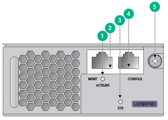

LSPM6FWD
About LSPM6FWD
The LSPM6FWD is a fourth-generation high performance firewall module. It provides features including firewall, VPN, content filtering, content identification, URL filtering, and NAT. By using this module on a switch, you can enhance the switch security capabilities without changing the network topology.
Figure6-6 LSPM6FWD front panel
(1) Management Ethernet port LED (ACT/LINK) |
(2) 10/100/1000BASE-T management Ethernet port |
(3) System status LED (SYS) |
(5) Captive screw |
Ports and LEDs
For information about the ports and transceiver modules and cables available for the ports, see "Ports on an LSPM6FWD firewall module."
For information about the LEDs, see "LEDs on an LSPM6FWD firewall module."

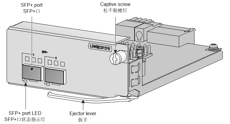

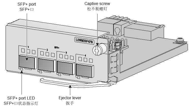

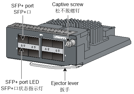

LSWM2SP2PB
About LSWM2SP2PB
The LSWM2SP2PB interface module provides two SFP+ ports.
Figure6-7 LSWM2SP2PB interface module view
Ports and LEDs
For information about the ports and transceiver modules and cables available for the ports, see "SFP port" and "SFP+ port."
LSWM2SP4PB
About LSWM2SP4PB
The LSWM2SP4PB interface module provides four SFP+ ports.
Figure6-8 LSWM2SP4PB interface module view
Ports and LEDs

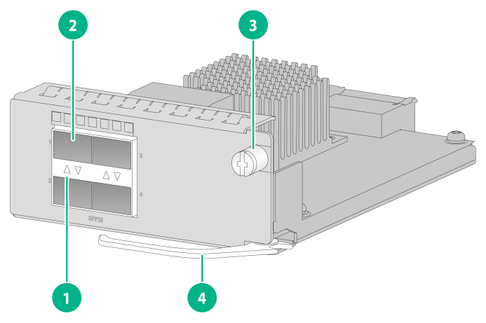

LSWM2ZSP4P
About LSWM2ZSP4P
The LSWM2ZSP4P interface module provides four SFP28 ports.
Figure6-9 LSWM2ZSP4P interface module view
(1) SFP28 port LED |
(2) SFP28 port |
(3) Captive screw |
(4) Ejector lever |
Ports and LEDs
Table6-4 Technical specifications
Item |
Specification |
40.1 × 95.0 × 147.5 mm (1.58 × 3.74 × 5.81 in) |
Weight |
0.4 kg (0.88 lb) |
5.0 W |
Power consumption (with typical configuration) |
6.0 W |
11.0 W |

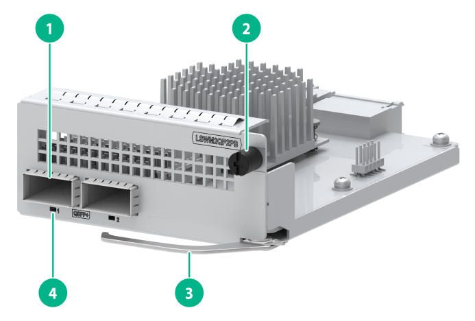

LSWM2QP2PB
About LSWM2QP2PB
The LSWM2QP2PB interface module provides two QSFP+ ports.
Figure6-10 LSWM2QP2PB interface module view
(1) QSFP+ port |
(2) Captive screw |
(3) Ejector lever |
(4) QSFP+ port LED |
Ports and LEDs
Table6-5 Technical specifications
Item |
Specification |
40.1 × 95 × 147.5 mm (1.58 × 3.74 × 5.81 in) |
Weight |
0.4 kg (0.88 lb) |
9 W |
10 W |
14 W |

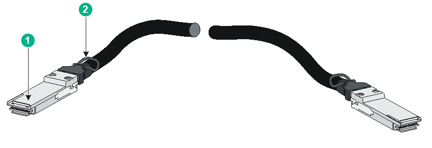

Figure7-1 SFP+ cable
(1) Connector |
(2) Pull latch |

Figure7-3 40G QSFP+ cable
(1) Connector |
(2) Pull tab |

Figure7-4 100G QSFP28 copper cable
(1) Connector |
(2) Pull tab |

Ports on an LSWM2EC EPS scanner module
Table7-21 Console port specifications
Item |
Specification |
Connector type |
RJ-45 |
Compliant standard |
EIA/TIA-232 |
Port transmission rate |
115200 bps |
Transmission medium and max transmission distance |
≤ 15 m (49.21 ft) over a common asynchronous serial interface cable |
Services |
· Provides connection to an ASCII terminal · Provides connection to the serial port of a local PC running terminal emulation program |
Table7-22 Management Ethernet port specifications
Item |
Specification |
Connector type |
RJ-45 |
· 1000 Mbps, full duplex · 100 Mbps, full duplex · 10 Mbps, full duplex |
MDI/MDI-X autosensing |
Supported |
Transmission medium |
Category-5 or above twisted pair cable |
Max transmission distance |
100 m (328.08 ft) |
IEEE 802.3i, 802.3u, and 802.3ab |
Functions and services |
Connects to a local PC or remote station for network management or software upgrade |
Table7-23 USB port specifications
Item |
Specification |
Port type |
USB 3.0 |
xHCI |
5 Gbps |
Uploads or downloads files, such as software image file and configuration file, from the flash file system on the module. |
Table7-24 Console port specifications
Item |
Specification |
Connector type |
RJ-45 |
RS-232 |
9600 bps (default) to 115200 bps |
Services |
· Provides connection to an ASCII terminal · Provides connection to the serial port of a local PC running terminal emulation program · Supports command line interface (CLI) |
Table7-25 10/100/1000BASE-T Ethernet copper port specifications
Item |
Specification |
Connector type |
RJ-45 |
802.3, 802.3u, and 802.3ab |
Port type |
Transmission distance |
100 m (328.08 ft) |
Rate and duplex mode |
· 10 Mbps, half/full duplex · 100 Mbps, half/full duplex · 1000 Mbps, full duplex |
The LSPM1FANSA-SN and LSPM1FANSB-SN fan trays each have a LED to indicate the fan tray operating status.
Table7-38 Fan tray status LED description
Status |
Description |
On |
The fan tray is faulty. |
Off |
The fan tray is operating correctly. |
Status LED on a PSR250-12A/PSR250-12A1 power supply
The PSR250-12A and PSR250-12A1 power supplies each have a LED to indicate the power input and output status.
Table7-39 Description for the status LED on a PSR250-12A/PSR250-12A1 power supply
LED status |
Description |
Steady green |
The power supply is operating correctly in active state. |
Flashing green |
The power supply is operating correctly in standby state. |
Steady red |
The power supply has failed or entered protection state. |
Red/Green flashing alternatively |
The power supply has an output overvoltage, output undervoltage, output overcurrent, output overload, or overtemperature alarm but has not entered protection state. |
Flashing red |
The power supply does not have power input. If two power supplies are installed and only one power supply has power input, the status LED of the power supply that does not have power input flashes red. |
Off |
The power supply does not have power input. |
The PSR600-54A-B, PSR920-54A-B, and PSR1600-54A-B power supplies each have two status LEDs to indicate the power input and output status.
Table7-40 Description for the status LEDs on a 600W/920W/1600W power supply
LED |
Mark |
Status |
Description |
Output status LED |
OUT OK |
Steady green |
Normal power output. |
Steady red |
Abnormal power output. |
Off |
No power output |
Input status LED |
IN OK |
Steady green |
Normal power input. |
Steady red |
Abnormal power input. |
Off |
No power input. |
LEDs on an LSWM2SP8P/LSWM2SP8PM interface card
The LSWM2SP8P and LSWM2SP8PM interface cards each provide eight SFP+ ports.
Table7-41 SFP+ port LED description
LED status |
Description |
Steady green |
A module has been installed and the port is operating at 10 Gbps. |
Flashing green |
The port is sending or receiving data at 10 Gbps. |
Steady yellow |
A module has been installed and the port is operating at 1 Gbps. |
Flashing yellow |
The port is sending or receiving data at 1 Gbps. |
Off |
No module has been installed or no link is present on the port. |
Table7-43 Description for the LEDs on an LSPM6FWD firewall module
LED |
Mark |
Status |
Description |
Management Ethernet port LED |
ACT/LINK |
Off |
No link is present on the port. |
Steady green |
A link is present on the port. |
Flashing green |
The port is sending or receiving data. |
System status LED |
SYS |
Off |
No power is input or the firewall module has failed. |
Slowly flashing green |
The system has started up and is operating correctly. |
Fast flashing green |
The system is loading software. |
