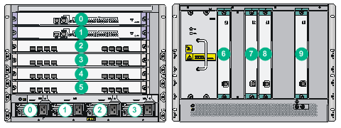

Figure1-1 SR8804-X front and rear views
(1) MPUs (slots 0 and 1)
(2) Service modules (slots 2 to 5)
(3) Power supplies
(4) Fan tray
(5) Switching fabric modules (slots 6 to 9)

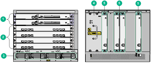

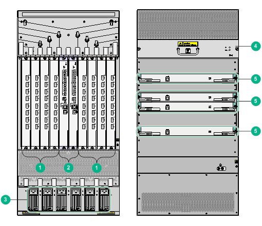

Figure1-2 SR8808-X (one fan tray) front and rear views
(1) Service modules (slots 0 to 3 and slots 6 to 9)
(2) MPUs (slots 4 and 5)
(3) Power supplies
(4) Fan tray
(5) Switching fabric modules (slots 10 to 13)

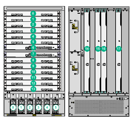

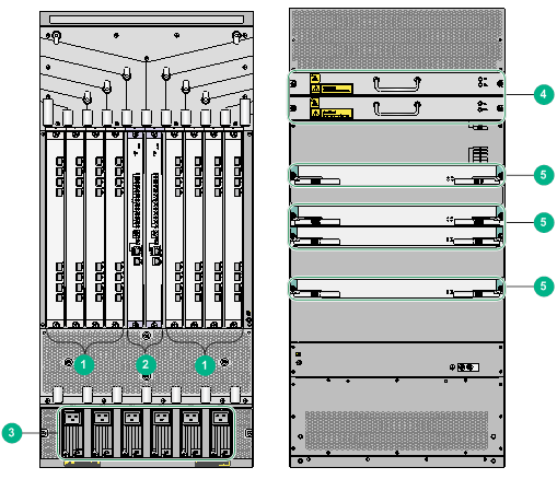

Figure1-3 SR8808-X (two fan trays) front and rear views
(3) Power supplies
(4) Fan trays

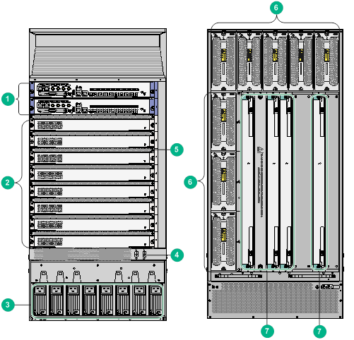

Figure1-4 SR8808H-X front and rear views
(2) Service modules (slots 2 to 9)
(3) Power supplies
(4) Power switches
(5) Air duct
(6) Fan trays
(7) Switching fabric modules (slots 10 to 14) (slot 11 can be used only when five switching fabric modules are required)

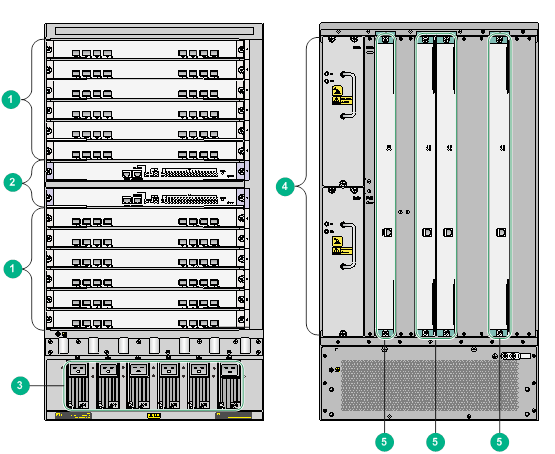

Figure1-5 SR8812-X front and rear views
(1) Service modules (slots 0 to 5 and slots 8 to 13)
(2) MPUs (slots 6 and 7)
(3) Power supplies
(4) Fan trays
(5) Switching fabric modules (slots 14 to 17)

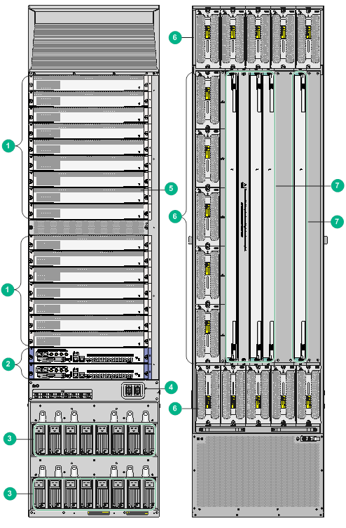

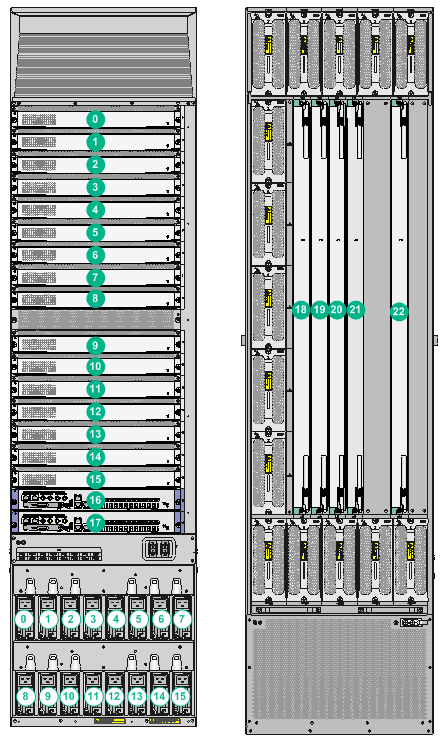

Figure1-6 SR8816-X front and rear views
(1) Service modules (slots 0 to 15)
(2) MPUs (slots 16 and 17)
(3) Power supplies
(4) Power switches
(5) Air duct
(6) Fan trays
(7) Switching fabric modules (slots 18 to 22) (slot 19 can be used only when five switching fabric modules are required)

Figure1-9 Slot numbering on the SR8816-X

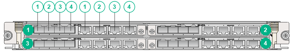

Interface module slot numbering and interface numbering
The slot numbering sequence for all interface modules follows the principle of top-to-bottom and left-to-right.
For example, as shown in Figure1-10, if you install MIC-GP4L interface modules on the CSPEX-1504X, white-background numbers represent interface numbers, and green-background numbers represent slot numbers. The fiber and copper ports of a combo interface are numbered in pairs.
Figure1-10 Subslot numbering and interface numbering
