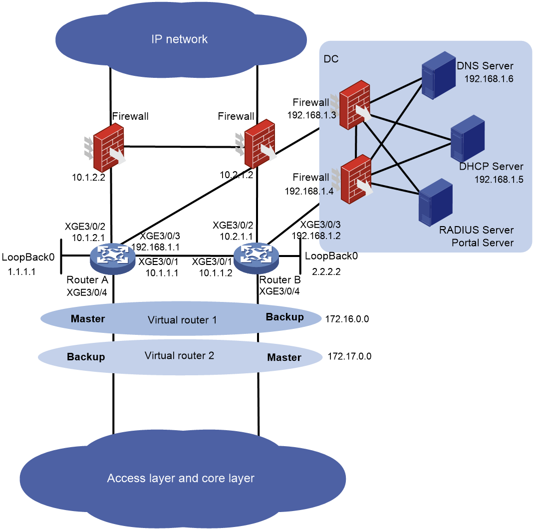

As shown in Figure 1, routers Router A and Router B are gateway devices.
Figure 1 Campus border gateway configuration example
Analysis
·     Configure IP addresses for interfaces on the routers, firewalls, and switches.
·     Configure OSPF for interfaces on the routers, firewalls, and switches.
·     Configure BFD for OSPF on the routers, firewalls, and switches to ensure network availability.
·     Configure VRRP to collaborate with BFD on the routers to improve device availability.
·     Configure QoS and deploy traffic policies on the routers.
·     Configure the DHCP relay agent, and allocate and manage IP addresses on the routers.
