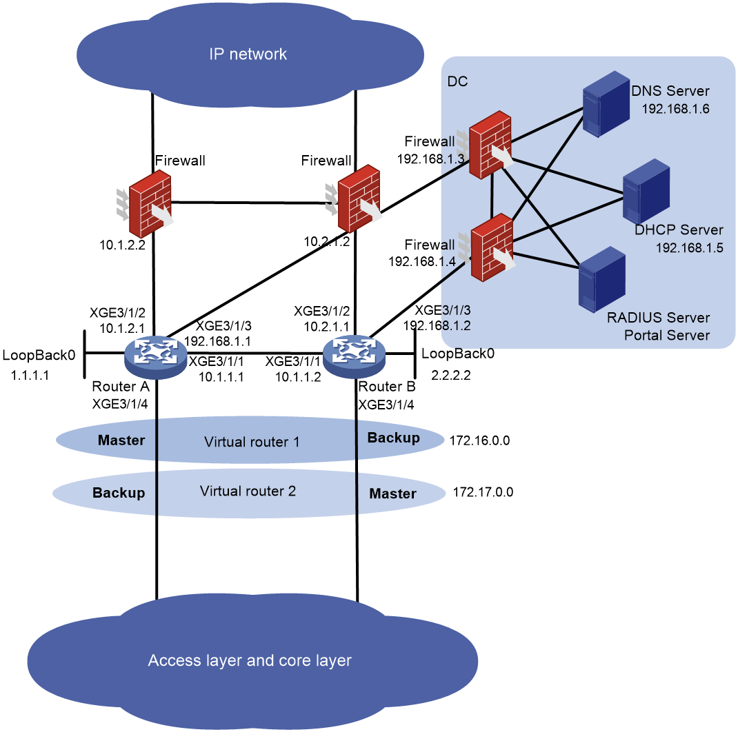

On the egress of a large-scaled campus, the routers  are directly connected to firewalls, and the firewalls are connected to the external network and data center. The firewalls provide security filtering for incoming and outgoing service traffic of the campus and assure network security. Within the campus, a user connects to the internal network through a wireless device, and the wireless device connects to the routers through devices on the access layer and core layer.
This document assumes that you have basic knowledge of Open Shortest Path First (OSPF), Bidirectional Forwarding Detection (BFD), Virtual Router Redundancy Protocol (VRRP), Quality of Service (QoS), and Dynamic Host Configuration Protocol (DHCP).
Campus border gateway configuration example
This example describes how to configure the routers in the campus border gateway configuration scenario. Configure the network as follows:
·     Users in the campus use private IP addresses. The user IP addresses are managed and allocated by the DHCP server. The routers act as the DHCP relay agents.
·     Divide users into VIP users and non-VIP users, and configure different number of endpoints that can be accessed and different upper bandwidth limits for VIP users and non-VIP users. To meet this requirement, configure QoS on the routers.
·     To ensure network availability, deploy BFD on each device. Deploy VRRP groups that collaborate with BFD on the two routers, so that the gateway devices can automatically negotiate the master and backup roles to ensure that the routes are not interrupted.
As shown in Figure 1, routers Router A and Router B are gateway devices.
Figure 1 Campus border gateway configuration example
Analysis
·     Configure IP addresses for interfaces on the routers, firewalls, and switches.
·     Configure OSPF for interfaces on the routers, firewalls, and switches.
·     Configure BFD for OSPF on the routers, firewalls, and switches to ensure network availability.
·     Configure VRRP to collaborate with BFD on the routers to improve device availability.
·     Configure QoS and deploy traffic policies on the routers.
·     Configure the DHCP relay agent, and allocate and manage IP addresses on the routers.

[RouterB] traffic classifier SIP
[RouterB-classifier-SIP] if-match acl 2002
[RouterB-classifier-SIP] quit
[RouterB] traffic behavior VIP
[RouterB-behavior-VIP] remark ip-precedence 5
[RouterB-behavior-VIP] quit
[RouterB] traffic behavior SIP
[RouterB-behavior-SIP] remark ip-precedence 4
[RouterB-behavior-SIP] quit
[RouterB] qos policy VIP
[RouterB-qospolicy-VIP] classifier VIP behavior VIP
[RouterB-qospolicy-VIP] quit
[RouterB] qos policy SIP
[RouterB-qospolicy-SIP] classifier SIP behavior SIP
[RouterB-qospolicy-SIP] quit
Applying QoS policies in sharing mode to the subinterfaces connecting to service traffic on Router A
<RouterA> system-view
[RouterA] interface Ten-GigabitEthernet 3/1/4.1
[RouterA-Ten-GigabitEthernet3/1/4.1] qos apply policy VIP inbound share-mode
[RouterA-Ten-GigabitEthernet3/1/4.1] quit
[RouterA] interface Ten-GigabitEthernet 3/1/4.2
[RouterA-Ten-GigabitEthernet3/1/4.2] qos apply policy SIP inbound share-mode
[RouterA-Ten-GigabitEthernet3/1/4.2] quit
Applying QoS policies in sharing mode to the subinterfaces connecting to service traffic on Router B
<RouterB> system-view
[RouterB] interface Ten-GigabitEthernet 3/1/4.1
[RouterB-Ten-GigabitEthernet3/1/4.1] qos apply policy VIP inbound share-mode
[RouterB-Ten-GigabitEthernet3/1/4.1] quit
[RouterB] interface Ten-GigabitEthernet 3/1/4.2
[RouterB-Ten-GigabitEthernet3/1/4.2] qos apply policy SIP inbound share-mode
[RouterB-Ten-GigabitEthernet3/1/4.2] quit
Configuring user access
Configuring Router A
[RouterA] dhcp enable
[RouterA-Ten-GigabitEthernet3/1/4.1] dhcp select relay
[RouterA-Ten-GigabitEthernet3/1/4.1] dhcp relay server-address 192.168.1.5
[RouterA-Ten-GigabitEthernet3/1/4.2] dhcp select relay
[RouterA-Ten-GigabitEthernet3/1/4.2] dhcp relay server-address 192.168.1.5
Configuring Router B
[RouterB] dhcp enable
[RouterB-Ten-GigabitEthernet3/1/4.1] dhcp select relay
[RouterB-Ten-GigabitEthernet3/1/4.1] dhcp relay server-address 192.168.1.5
[RouterB-Ten-GigabitEthernet3/1/4.2] dhcp select relay
[RouterB-Ten-GigabitEthernet3/1/4.2] dhcp relay server-address 192.168.1.5
# Display OSPF route information on Router A.
<RouterA> display ospf routing
         OSPF Process 1 with Router ID 1.1.1.1
                  Routing Table
                Topology base (MTID 0)
 Routing for network
 Destination        Cost     Type    NextHop         AdvRouter       Area
 10.1.2.0/24        2000     Stub    0.0.0.0         1.1.1.1         0.0.0.0
 10.1.1.0/24        10       Stub    0.0.0.0         1.1.1.1         0.0.0.0
 192.168.1.0/24     2000     Stub    0.0.0.0         1.1.1.1         0.0.0.0
 Total nets: 3
 Intra area: 3  Inter area: 0  ASE: 0  NSSA: 0
# Display OSPF route information on Router B.
<RouterB> display ospf routing
         OSPF Process 1 with Router ID 2.2.2.2
                  Routing Table
 Routing for network
 10.1.2.0/24        2010     Stub    10.1.1.1        1.1.1.1         0.0.0.0
 10.1.1.0/24        10       Stub    0.0.0.0         2.2.2.2         0.0.0.0
 192.168.1.0/24     2000     Stub    0.0.0.0         2.2.2.2         0.0.0.0
 Total nets: 3
# Display BFD session information on Router A.
<RouterA> display bfd session
 Total sessions: 1        Up sessions: 1        Init mode: Active
 IPv4 session working in control packet mode:
 LD/RD           SourceAddr      DestAddr        State   Holdtime    Interface
 33793/33793     10.1.1.1        10.1.1.2        Up      294ms       XGE3/1/1
# Display BFD session information on Router B.
<RouterB> display bfd session
 33793/33793     10.1.1.2        10.1.1.1        Up      267ms       XGE3/1/1
# Display VRRP group state information on Router A.
<RouterA> display vrrp
IPv4 virtual router information:
 Running mode : Standard
 Total number of virtual routers : 2
 Interface          VRID  State       Running Adver     Auth    Virtual
                                      pri     timer(cs) type    IP
 XGE3/1/4.1         1     Master      110     100       None    172.16.0.11
 XGE3/1/4.2         2     Backup      100     100       None    172.17.0.11
# Display VRRP group state information on Router B.
<RouterB> display vrrp
 XGE3/1/4.1         1     Backup      100     100       None    172.16.0.11
 XGE3/1/4.2         2     Master      110     100       None    172.17.0.11
