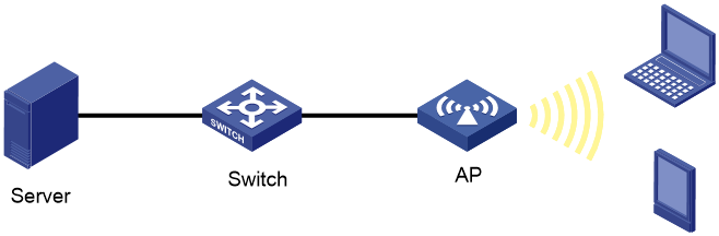

As shown in Figure 1, in a typical WLAN, if a wireless client experiences severe packet loss when it pings the server, troubleshoot the issue based on the packet forwarding path.
Figure 1 AC + fit AP network diagram
The troubleshooting analysis is as follows:
1.     Test the packet loss ratio of the wireless client.
2.     Identify whether the wired network that connects the AC and the AP has a packet loss issue.
3.     Identify whether the wireless client can access the network and obtain an IP address.
4.     Check the wireless client state, air interface usage, air interface quality, and background noise.
5.     Collect debugging information to analyze the issue cause.
