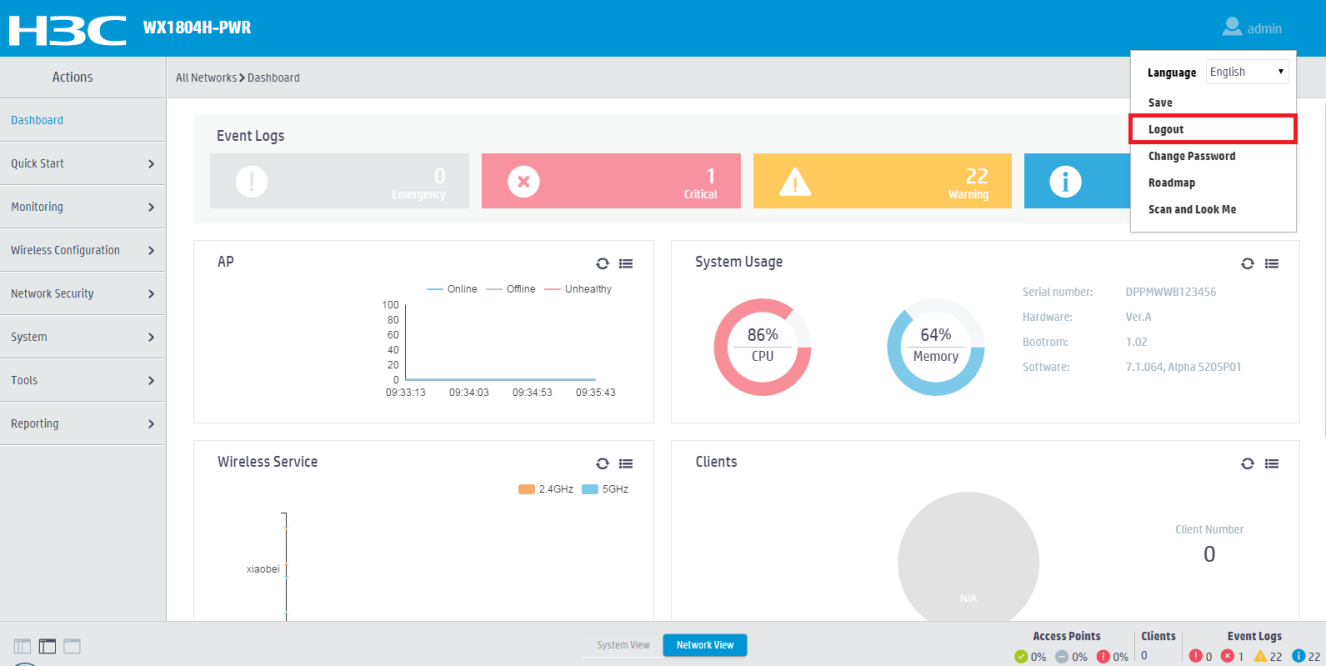

Web login failure
Symptom
The system displays an error message indicating that the maximum number of Web users has been reached when a user logs in to the Web interface. However, the output from the display web users command shows that only one Web user is online or even no Web users are online.
Solution
This symptom occurs when other users log out of the Web interface by directly closing the browser. To log out of the Web interface, you must click Logout in the upper-right corner of the Web interface, as shown in Figure 1.
Figure 1 Logging out of the Web interface
To resolve the issue:
1.     Execute the free web users all command to forcibly log off all online Web users.
2.     Log in to the Web interface again.
3.     If the issue persists, contact H3C Support.

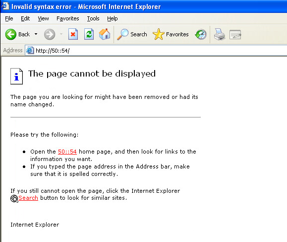

Web login failure through an IPv6 address
Symptom
A PC that runs Windows XP and the AC are both configured with IPv6 addresses, but the system prompts syntax error when the AC is accessed through an IPv6 address, as shown in Figure 4.
Figure 4 Invalid syntax error
Solution
This symptom occurs because the IE browser on Windows XP cannot identify an IPv6 address.
1.     Use UltraEdit to edit the hosts file in directory C:\WINDOWS\system32\drivers\etc of the PC.
2.     Enter 50::54       AC at the end of the file.
# Copyright (c) 1993-1999 Microsoft Corp.
# This is a sample HOSTS file used by Microsoft TCP/IP for Windows.
# This file contains the mappings of IP addresses to host names. Each
# entry should be kept on an individual line. The IP address should
# be placed in the first column followed by the corresponding host name.
# The IP address and the host name should be separated by at least one
# space.
# Additionally, comments (such as these) may be inserted on individual
# lines or following the machine name denoted by a '#' symbol.
# For example:
#      102.54.94.97     rhino.acme.com          # source server
#       38.25.63.10     x.acme.com              # x client host
127.0.0.1       localhost
50::54 AC
3.     Save the hosts file.
4.     Input http://AC/ in the address bar and press Enter to log in to the Web interface.
5.     If the issue persists, contact H3C Support.

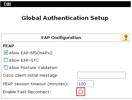

If 802.1X authentication is used together with the ACS, a client fails to associate with the AP again after going offline.
Solution
1.     Select System Configuration > Global Authentication Setup in ACS.
2.     Clear Enable Fast Reconnect.
Figure 5 Global Authentication Setup
