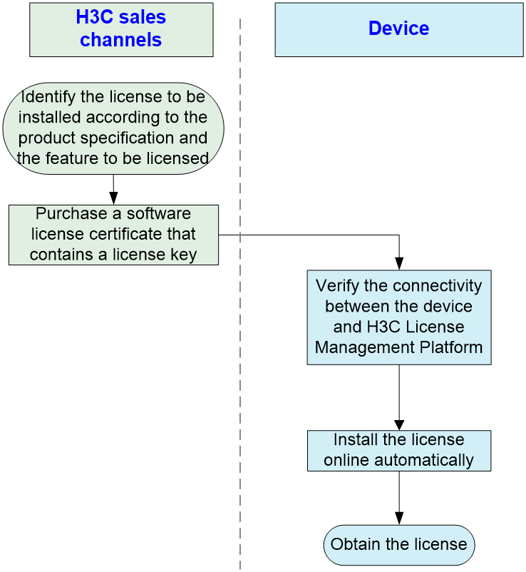

Q.     How do I configure online automatic license installation
IMPORTANT
IMPORTANT:
The Web interface in expert mode supports online automatic installation of licenses. If the current device version does not support this feature, upgrade the device to the most recent version as a best practice.
A.     To configure online automatic license installation, use the following procedure:
Figure 1 shows the workflow to install a license online automatically.
Figure 1 License installation workflow

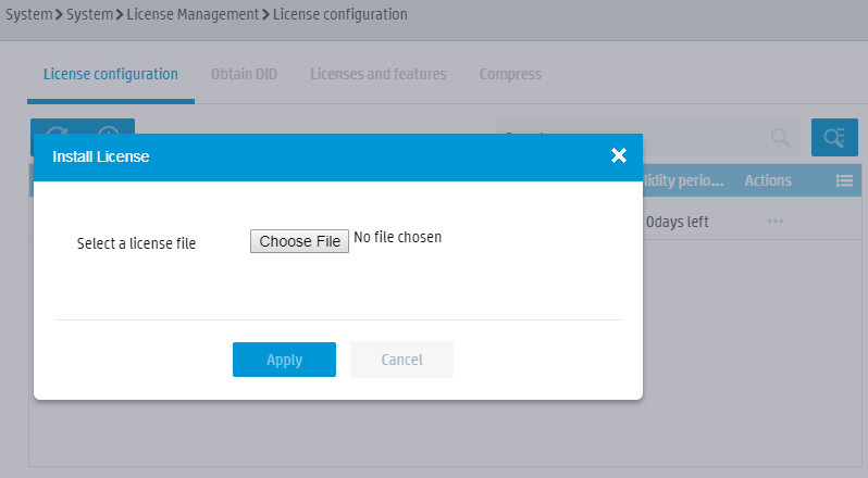

1.     Purchase a license certificate from an H3C official sales channel. The license key is printed on the license certificate.

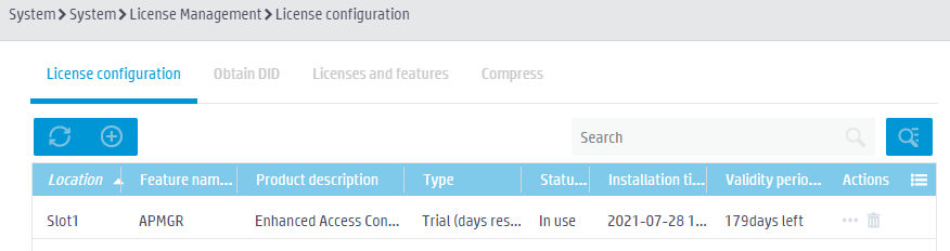

2.     Log in to the Web interface of the device, and access the System > System > License Management page. On the License configuration tab, click Online Automatic Installation.
Figure 2 License configuration

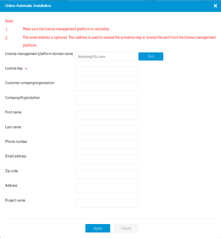

3.     In the dialog box that opens, click Test to verify the connectivity between the device and H3C License Management Platform. If they cannot reach each other, resolve the network issue.
4.     Enter license key and user information, and then click Apply.
Figure 3 License online automatic installation

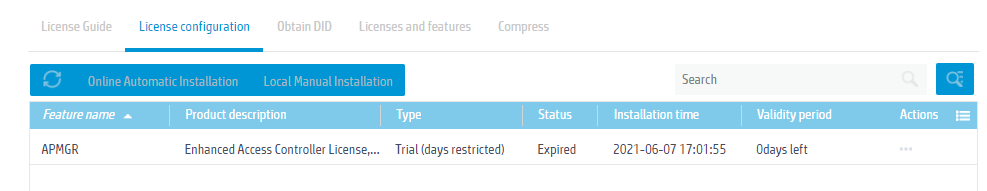

On the License configuration page, you can view license information.
Figure 4 Viewing license information

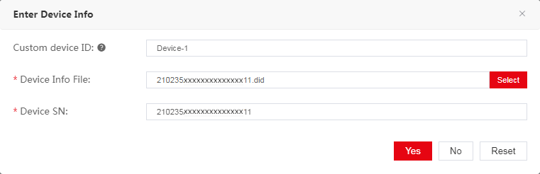

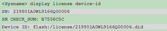

3.     Install a license.
a.     Purchase a license certificate from an H3C official sales channel. The license key is printed on the license certificate.

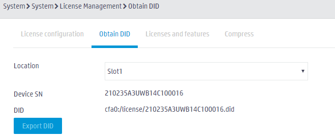

b.     Obtain the device SN and DID file from the device.
c.     Apply for an activation file from the H3C License Management Platform.
d.     Install the activation file on the device.
For more information, see H3C Comware 7 and Comware 9 WLAN Products Local Licensing Guide.

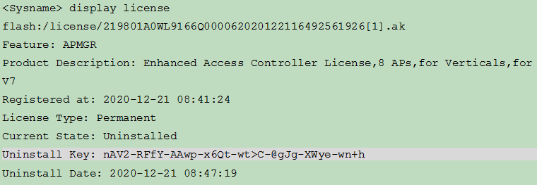

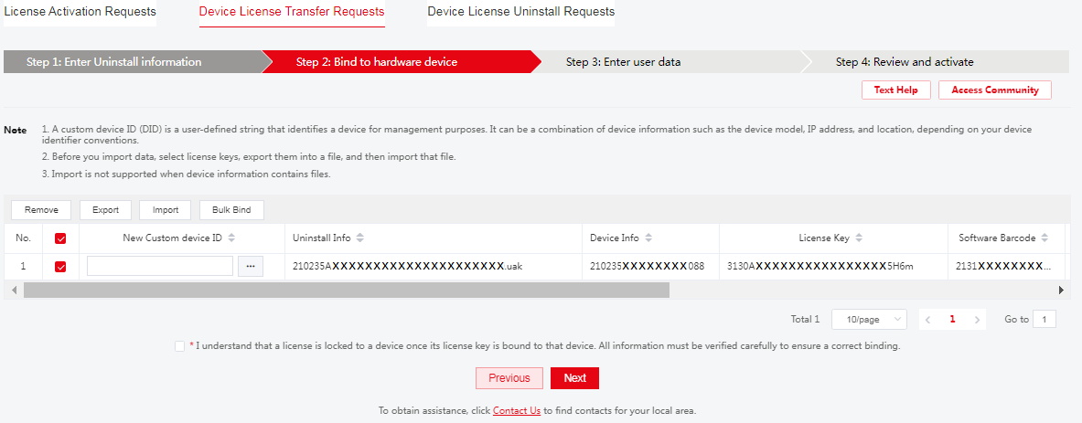

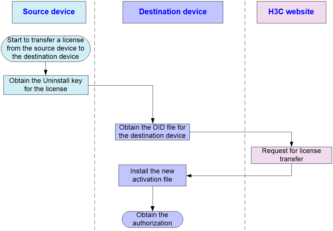

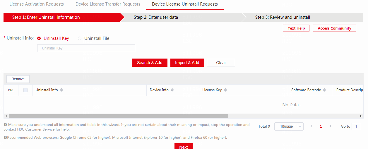

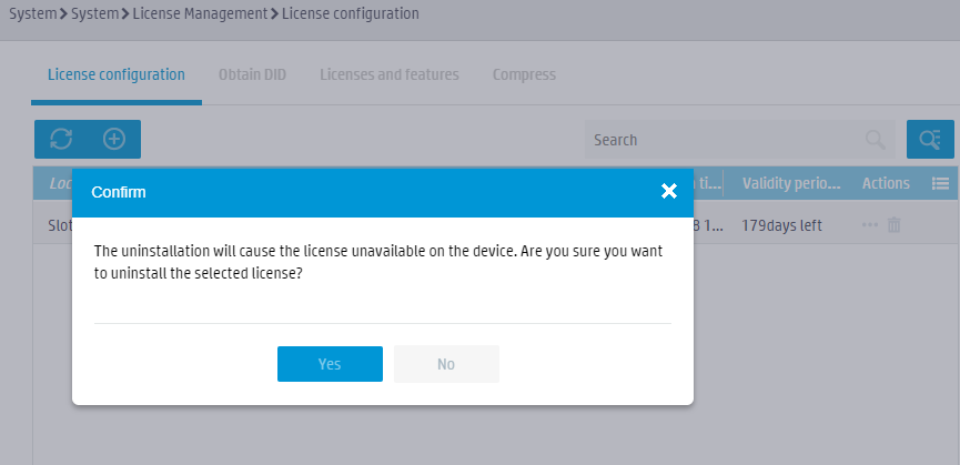

Q.     How do I uninstall a license?

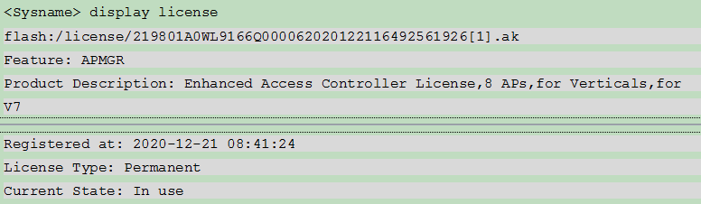

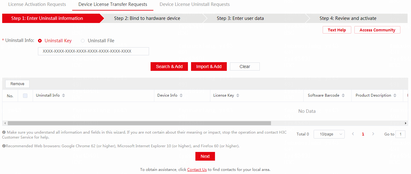

A.     To uninstall a license, use the following procedure. You can uninstall only formal licenses that have not expired.
Figure 6 Uninstallation flowchart
1.     Obtain an Uninstall key for a license on the device.
To obtain an Uninstall key for a license from the CLI:
a.     Execute the display license command to identify the activation file that will be uninstalled.

2.     Request license uninstallation on H3C License Management Platform.
a.     Log in to H3C License Management Platform at https://new-licensing.h3c.com/website/anonymous/navIndex/en-US/activate/input-license. Click the Device License Uninstall Requests tab.
Figure 9 Device License Uninstall Requests page
b.     Manually enter Uninstall keys one by one and click Search & Add to obtain uninstallation information. Select the uninstallation information that will be uninstalled, and then click Next.
c.     Enter user information, and then click Next. Review the uninstallation information, and then select the option that explicitly states your acceptance of all terms in the legal statement.
d.     Click Confirm & Uninstall.

Q.     How do I transfer a license?
A.     To transfer a license, use the following procedure.
You can perform this task to transfer a formal license that has not expired from one device to another.
Figure 10 License transfer workflow
1.     Obtain an Uninstall key on the source device.
To obtain an Uninstall key for a license from the CLI of the source device:
a.     Log in to the CLI of the source device.
b.     Execute the display license command to identify the activation file to be uninstalled.
c.     Execute the system-view command to enter system view.
d.     Execute the license activation-file uninstall command to uninstall the activation file.
e.     Execute the display license command to obtain the Uninstall key. Copy the Uninstall key, and then use the Uninstall key on H3C License Management Platform to request a license transfer or uninstallation.
Figure 11 Sample output from the display license command
To obtain an Uninstall key for a license from the Web interface of the source device:
a.     Log in to the Web interface of the device, and access the System > System > License Management page.
b.     On the License configuration tab, click the delete icon  in the Actions column for the license to be uninstalled, and then select Yes in the dialog box that opens.
Figure 12 Uninstalling a license
c.     Click the  icon to view and copy the Uninstall key.
2.     Obtain the device information of the destination device.
To obtain the device information for the destination device from the CLI of the device, log in to the CLI of the device, and execute the display license device-id command in any view to obtain the device SN and value of the Device ID field. Use FTP or TFTP to upload the DID file to the PC (Web client). If FTP is used to transfer the DID file, use the Binary mode.
Figure 13 Obtaining the DID file
To obtain the device information for the destination device from the Web interface of the device, log in to the Web interface of the device, and access the System > System > License Management page. Click the Obtain DID tab. You can view the device SN and download the DID file.
Figure 14 Obtaining device information

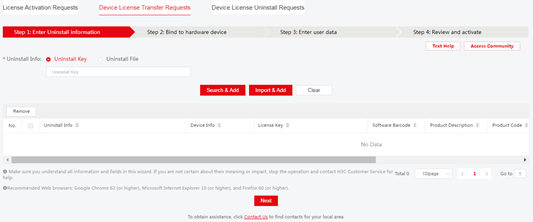

3.     Requesting license transfer on H3C License Management Platform.
a.     Open a Web browser and access H3C License Management Platform at https://new-licensing.h3c.com/website/anonymous/navIndex/en-US/activate/input-license. Click the Device License Transfer Requests tab.
Figure 15 Device License Transfer Requests page
b.     Select Uninstall Key, enter the Uninstall key, and then click Search & Add. The platform will automatically obtain the information associated with the Uninstall key.
Figure 16 Uploading Uninstall keys
c.     Select the target uninstall info, and then click Next to access the Bind to hardware device page. Click the  icon next to the Custom device ID box in the license key entry. Set the device ID and upload the device information file as instructed, and then click Yes to bind the license to the device.
Figure 17 Bind to hardware device page
Figure 18 Entering device information
d.     Bind the uninstallation information of the source device to the destination device. Make sure you understand the impact of the binding operation, and then select the option that explicitly states so. Click Next.

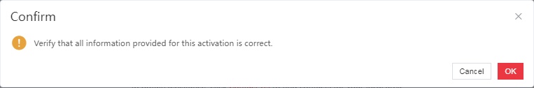

f.     Review the license key and device information, select I accept all terms and conditions of H3C License Service Portal Legal Statement, and then click Confirm & Activate.
Figure 19 Reviewing information and activating the licenses
g.     Double-check the license key and device information, and then click OK in the dialog box.
Figure 20 Confirmation dialog box

4.     Install the new activation file on the destination device.
To install the new activation file from the CLI of the destination device, use FTP or TFTP to upload the activation file to the PC. If FTP is used, use the Binary mode.
To install the activation file on the device from the CLI:
a.     Access the CLI of the device.
b.     Execute the system-view command to enter system view.
c.     Execute the license activation-file install command to install the activation file.
To install the activation file on the device from the Web interface:
b.     On the License configuration tab, click the  icon.
c.      In the dialog box that opens, click Select File, select a file, and then click Apply.
Figure 21 Installing an activation file

Q.     How do I view the installed licenses on a device?
A.     Use the following methods to view the installed licenses on a device:
·     Web interface in expert mode
Log in to the Web interface of the device, access the License configuration page. You can view information about the installed licenses on the device.
Figure 23 Viewing information about installed licenses

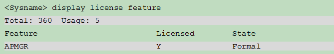

¡     To view information about software feature licenses, execute the display license feature command.
Figure 24 Displaying software feature license information

Q.     How do I export a DID file?
A.     A DID file is used for requesting for an activation file from the H3C License Management Platform. You can use either of the following methods to export the DID file of a device.
·     To export a DID file from the Web interface in expert mode, log in to the Web interface of the device, access the License Management page, click the Obtain DID tab, and then click Export DID.
Figure 26 Exporting the DID file
·     To export a DID file from the CLI, execute the display license device-id command in any view to obtain the value in the Device ID field. Use FTP or TFTP to upload the DID file to the PC (Web client). If FTP is used to transfer the DID file, use the Binary mode.
Figure 27 Obtaining the DID file

Q.     How do I know which features require licenses?
A.     Execute the display license feature command to display brief license information for features.

Q.     How can I view the remaining days of AP licenses?
A.     Execute the display license command. The output from this command is displayed as follows:
<AC> display license
Slot 1:
cfa0:/license/210235A1AMB1570000052015091410025584386.ak
Feature: APMGR
Product Description: Enhanced Access Controller License,128 APs,for Verticals,for V7
Registered at: 2018-09-14 10:04:09
License Type: Trial (days restricted)
Trial Time Left (days): 353
Current State: In use
