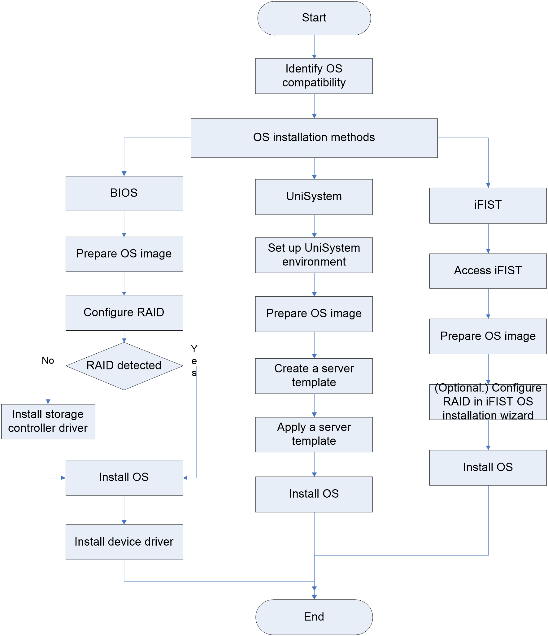

OS installation methods
The operating system (OS) installation methods vary by application scenario, as shown in Table 1.
Table 1 OS installation methods
Application scenario
Feature
OS installation on a single server
Installing an OS through the BIOS
Most common OS installation method. You can monitor each installation phase and customize the settings.
Installing an OS and drivers through iFIST
Simplifies OS installation and saves time.
Bulk OS installation on multiple servers
Installs OSs in bulk in a large-sized network.

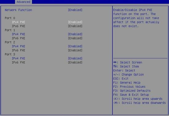

PXE
1.     Set up the PXE environment, including a TFTP server and a DHCP server.
2.     Connect an Ethernet port on each server where the OS is to be installed to the PXE environment. For more information about how to set up the PXE environment, see the PXE environment setup guide.
3.     Upload the OS image to the TFTP server.
4.     Enable PXE (enabled by default) on the servers where the OS is to be installed. For more information, see "Enabling PXE."

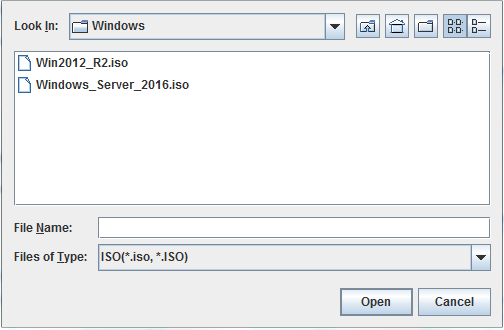

Virtual media
Mount the OS image through HDM. For more information, see "Mounting an OS image through a remote console."

2.     Click the Advanced tab, select Network Stack Configuration, and then press Enter.
3.     Set Network Stack, IPv4 PXE Support, and IPv6 PXE Support to Enabled (Enabled by default).
Figure 5 Enabling PXE
4.     Access the Advanced > Network PXE Control screen. Then, enable PXE on each port (Enabled by default).
Figure 6 Enabling PXE on network ports

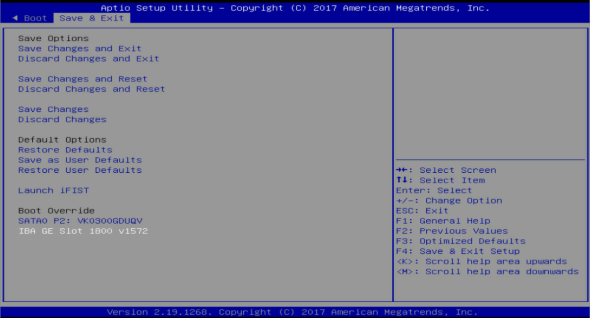

6.     Click the Save & Exit tab, and then select the boot option for PXE in the Boot Override area.
¡     For UEFI boot mode, select the port connecting to the PXE server. In this example, port 1 connects to the PXE server.
Figure 7 PXE boot options in UEFI boot mode
¡     For Legacy boot mode, select the only option. All ports on the network adapter share the same PXE boot option.
Figure 8 PXE boot options in Legacy boot mode

3.     Click the CD/DVD tab, and then click Browse in the CD/DVD Media: I area. In the dialog box that opens, select a CD/DVD file, and then click Open.
Figure 10 Selecting a CD/DVD file

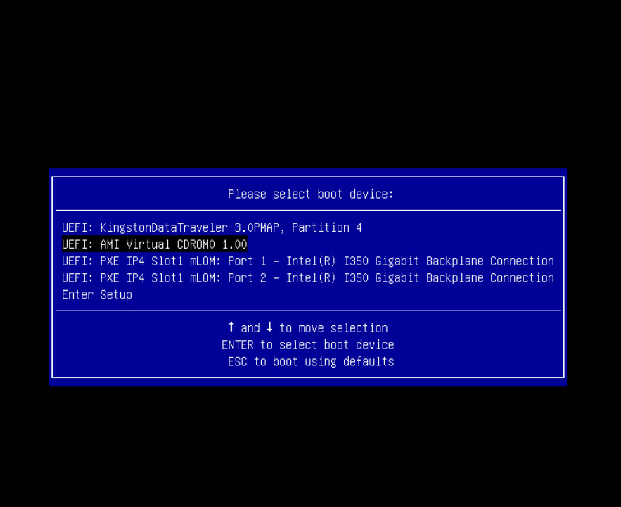

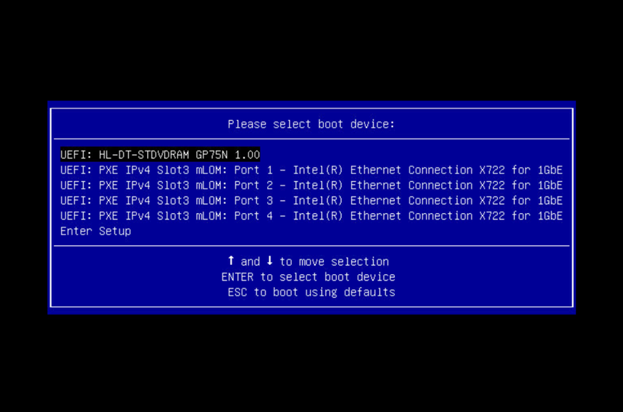

Selecting the boot media

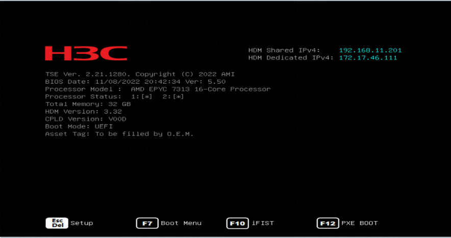

1.     Start the server, and press F7 at the prompt, as shown in Figure 14.
Figure 14 Starting the server
2.     Select the boot media that contains the OS image. This section provides figures for selecting physical optical drive GK-DT-STDVDRAM and virtual media AMI Virtual CDROM0 mounted from the remote console as examples.
Figure 15 Selecting physical optical drive GK-DT-STDVDRAM as the boot media
Figure 16 Selecting virtual media AMI Virtual CDROM0 as the boot media

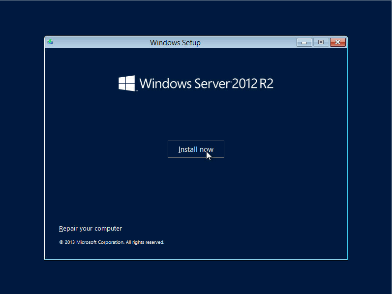

3.     Click Install now.
Figure 18 Starting installing Windows Server

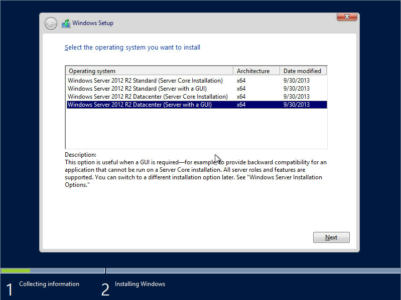

4.     Select an OS version, and then click Next.
As a best practice, select an OS with a GUI. This example selects Windows Server 2012 R2 Datacenter (Server with a GUI).
Figure 19 Selecting an OS version

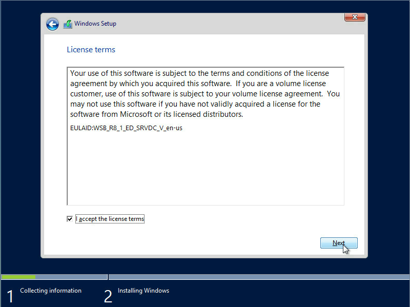

5.     Select I accept the license terms, and then click Next.
Figure 20 License terms

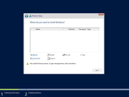

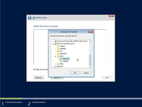

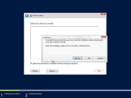

7.     Click Load Driver, and then click Browse.
CAUTION
CAUTION:
Load the storage controller driver when installing a Windows Server OS to avoid the following issues:
·     The disk cannot be detected (see Figure 22).
·     The OS cannot be accessed after installation.
Figure 22 Disk not detected
Figure 23 Loading a driver
8.     Select the path where the driver is located, and then click OK.
Figure 24 Selecting the driver path

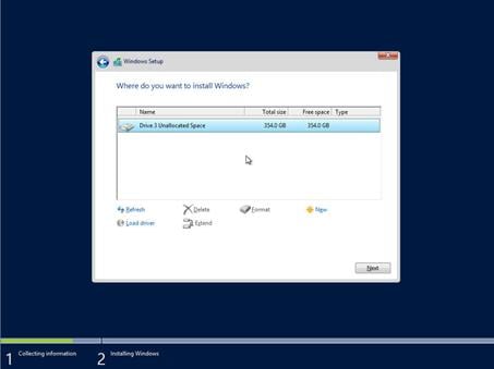

10.     Select the destination drive to install the OS, and then click Next.
Figure 26 Loading storage controller driver completed

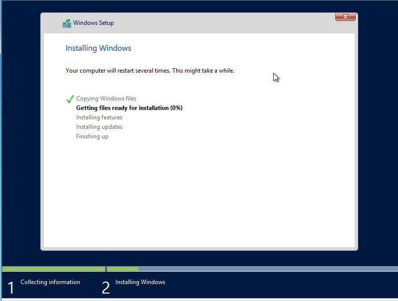

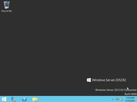

11.     Wait for the system to complete OS installation.
Figure 27 Installing the OS

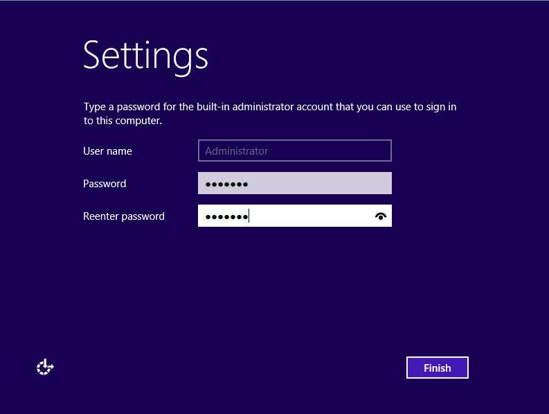

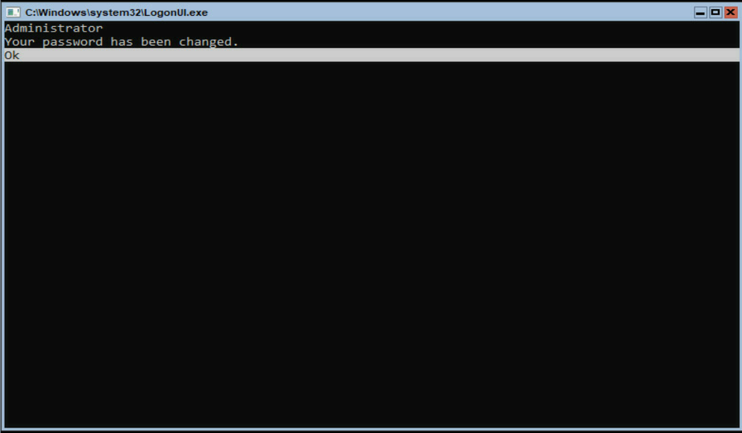

12.     Set the password, and then click Finish after the system completes installation and enters the Settings page.
The user name is Administrator, which cannot be modified.
Figure 28 Setting the password

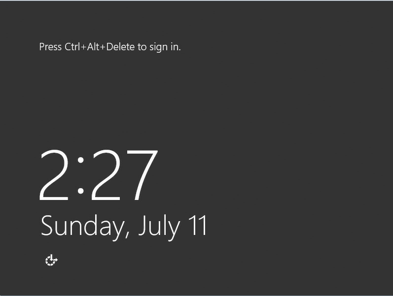

13.     Press Ctrl+Alt+Delete on the keyboard of the remote console as prompted.
Figure 29 OS installation completed

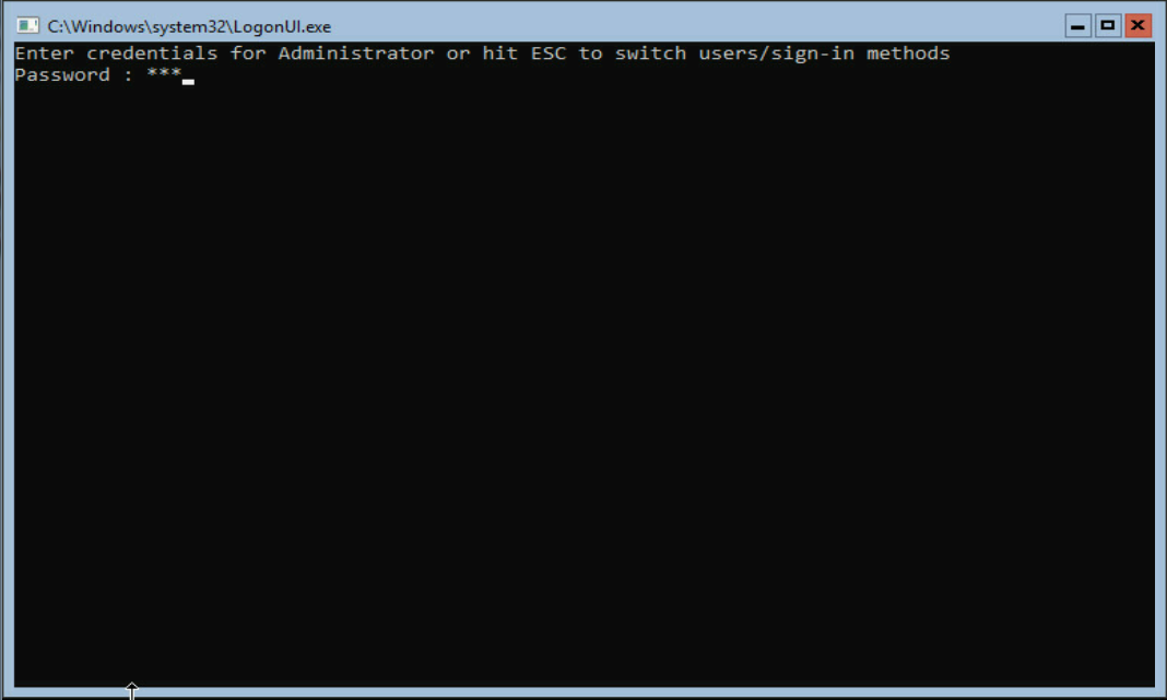

14.     Enter the administrator password.
For the OS to correctly identify hardware devices, install the Chipset driver after OS installation.
Figure 30 Entering the administrator password
Figure 31 Entering the OS

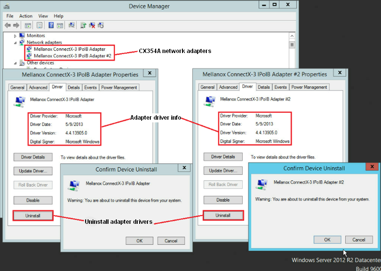

The CPU on the server supports QAT, if Device Manager displays the following:
To use QAT, contact Intel Support.

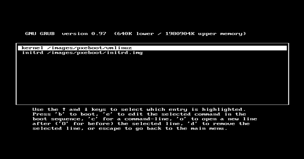

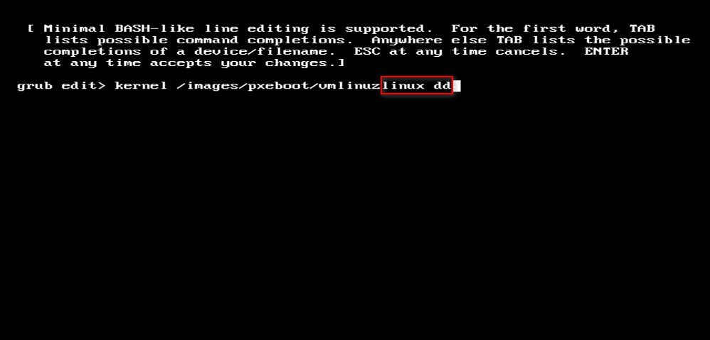

3.     Select the line that starts with kernel, and then press e.
Figure 33 Selecting the line that starts with kernel
4.     Input the linux dd command, and then press Enter. Then press b to start installation.
Figure 34 Entering the kernel page

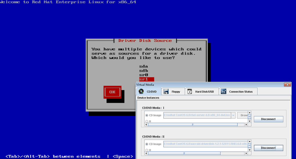

5.     On the page that opens, select Yes.
Figure 35 Selecting a driver disk
6.     Select the mirrored interface to mount the driver disk.
Figure 36 Selecting the mirrored interface

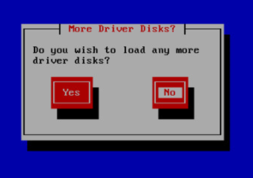

8.     Click No to not load any other drivers and enter self-test.
Figure 38 Canceling loading any other drivers

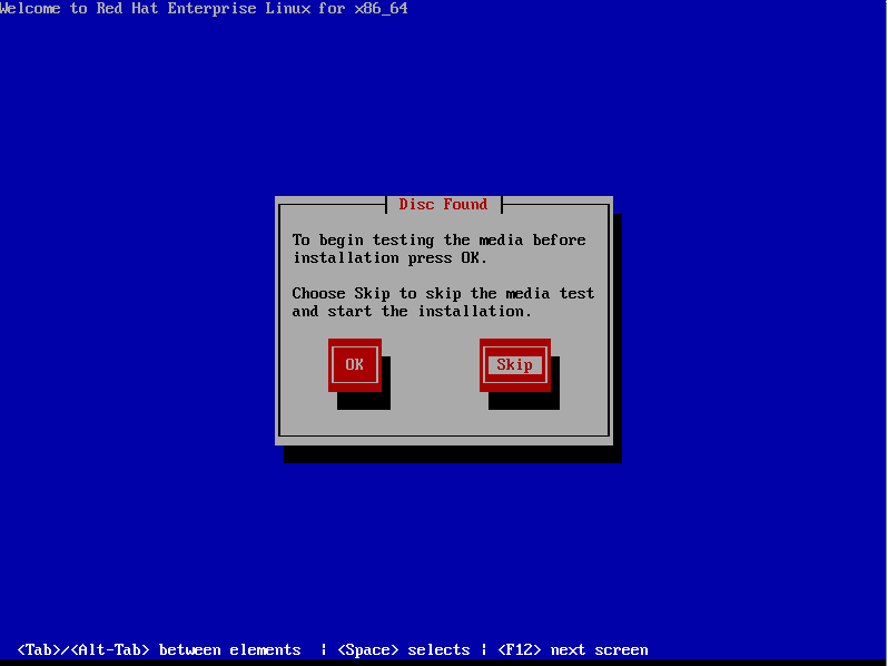

9.     Press Tab, select OK or Skip, and then press Enter. This example selects Skip.
Figure 39 Confirming media test

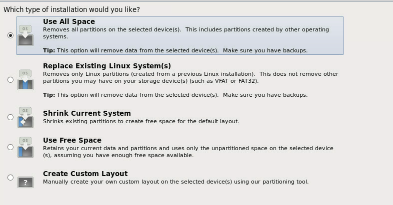

17.     Select the type of installation, and then click Next. This example selects Use All Space.
Figure 47 Selecting the type of installation

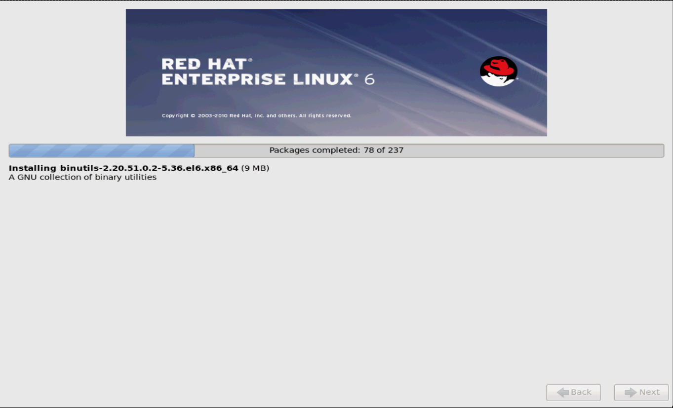

Figure 52 Installing the OS

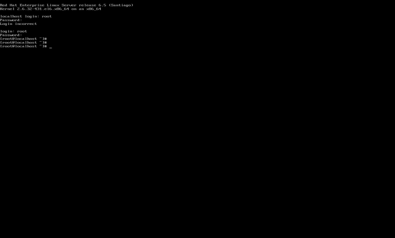

22.     Click Reboot to reboot the server.
Figure 53 Rebooting the server
Figure 54 Logging in to the OS

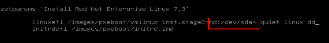

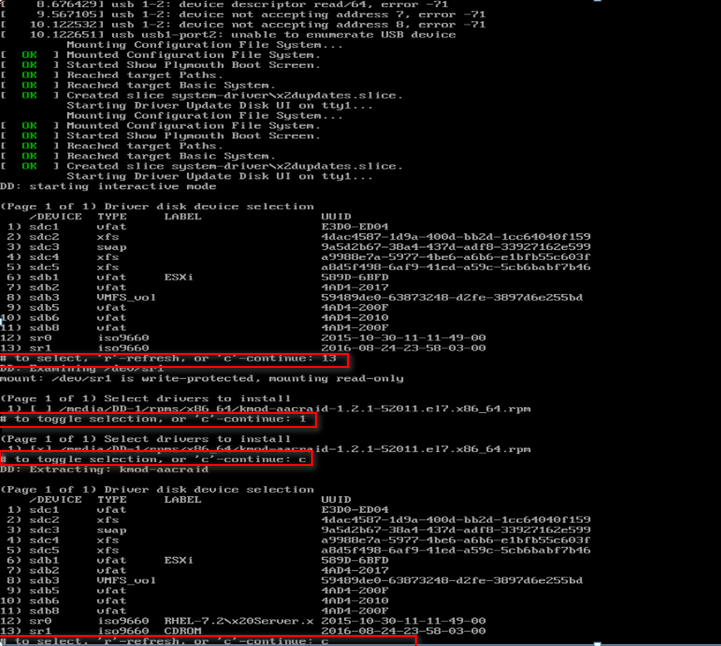

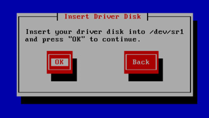

3.     Input linux dd at the end of the line that starts with linuxefi, and then press F10 or Ctrl+X to start installation.
Figure 56 Parameter configuration

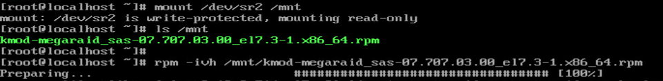

4.     Perform the following steps to configure the parameters:
a.     Display the location of the driver. In this example, sr1 has a driver mounted, so you select 13.
b.     Enter 1 to select the rpm file.
c.     Enter c to continue installation.
If not all drivers are listed on the page, enter r to refresh the driver list.
Figure 57 Parameter configuration

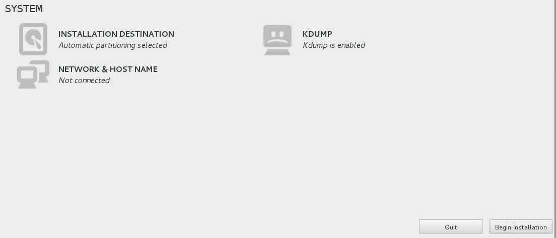

7.     Click INSTALLATION DESTINATION. Select the disk where the OS is to be installed, and then click Done.
This example uses automatic partitioning. To use manual partitioning, select I will configure partitioning.
Then you must select Standard Partition from the New mount points will use the following partitioning scheme list for successful OS installation.
If you select manual partitioning in UEFI boot mode, you must create the /boot/efi partition, and the files in the partition must be in efipartition or fat format. If you do not do so, an error will occur during OS installation.
Figure 60 Selecting the disk to install the OS

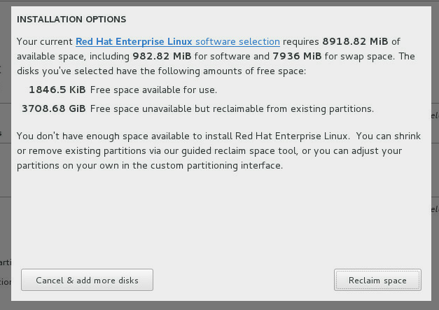

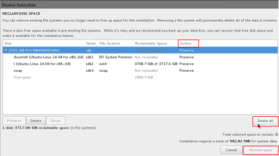

8.     Click Reclaim space to format the disk when the following dialog box appears.
Figure 61 Confirming the formatting operation
9.     Click Delete all. When the status in the Action column changes to Delete, click Reclaim space to delete all partitions.
Figure 62 Deleting the current partitions

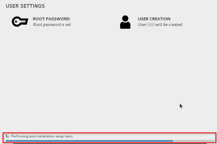

11.     Click ROOT PASSWORD.
Figure 64 User settings

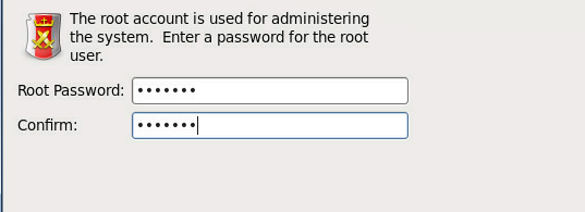

12.     Enter the root password, and then click Done. If the password is too simple, the system gives a prompt. To accept the simple password, click Done twice.
Figure 65 Setting the root password
As a best practice, set a root password to one with the Strong security level.

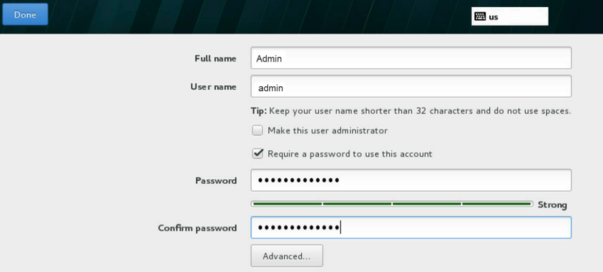

13.     Click USER CREATION, create a new user account, set the password, and then click Done. If the password is too simple, the system gives a prompt. To accept the simple password, click Done twice.
Figure 66 Creating a user account
14.     Wait for the system to complete installation.
Figure 67 Installing the OS
15.     Click Reboot to reboot the server after the installation is complete.
Figure 68 Rebooting the server

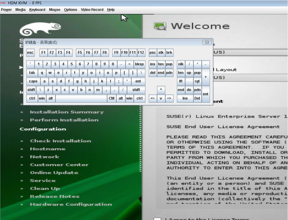

3.     Open the soft keyboard, and press Ctrl+Alt+F2 to enter the CLI console.
Figure 71 Entering the CLI console

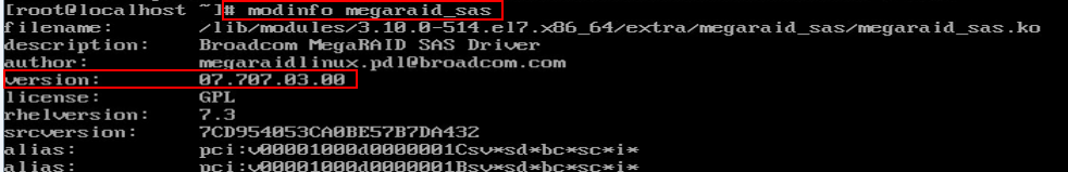

4.     Enter the modinfo aacraid command to identify whether the driver has been installed successfully. Press Ctrl+Alt+F7 to continue OS installation.

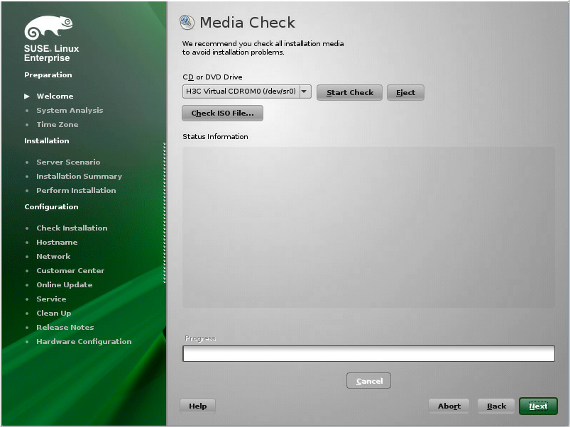

6.     Select Check ISO File as required, and then click Next.
Figure 73 Media Check

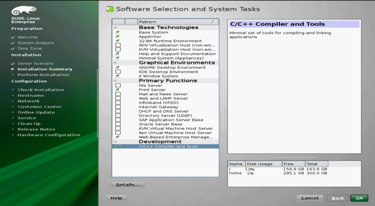

10.     Select the server base scenario, and then click Next. As a best practice, select Physical Machine for new installation.
Figure 77 Selecting the server base scenario
11.     To use the default settings, click Install. The system will start OS installation.

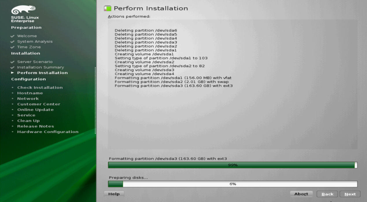

Figure 78 Installing the OS

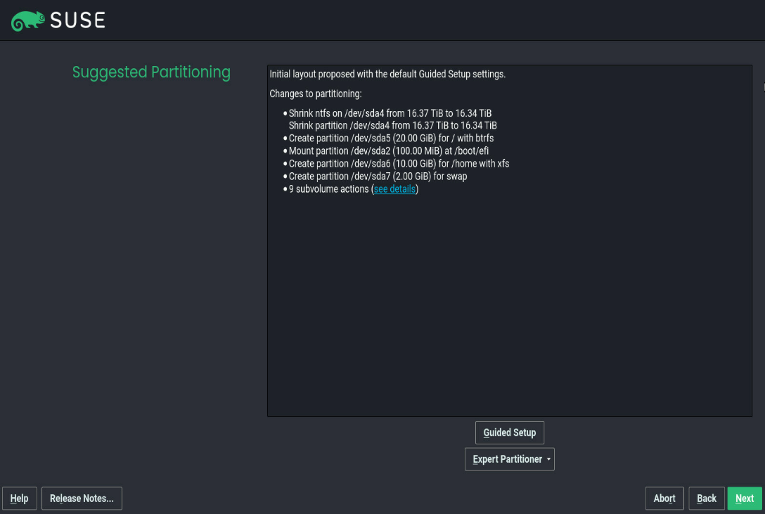

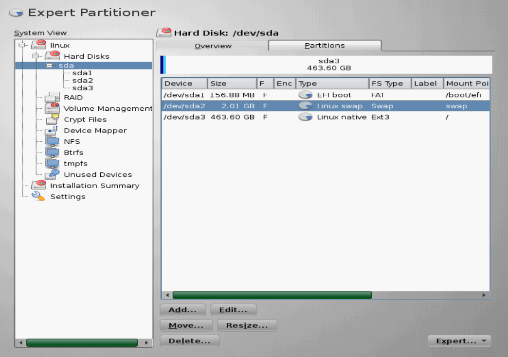

12.     To manually partition the disk:
a.     Click Partitioning, on the Preparing Hard Disk page select a partitioning method, and then click Next.
If you select 1.IDE Disk, the system will automatically partition the disk based on the size of the disk. If you select Custom Partitioning, you can manually partition the disk as needed. This example selects Custom Partitioning.
Figure 79 Preparing hard disk
b.     From the left navigation tree, select Hard Disks > sda.
The following partitions must be added:
-     swap—Switching partition to implement virtual memory. As a best practice, set its size to one or twice of the physical memory.

14.     After the installation is complete, click Next. The system will automatically reboot.
Figure 85 Performing installation
Figure 86 OS rebooting
15.     Set the root password, and then click Next when the following page appears.
Figure 87 Setting the root password

1.     Enter the BIOS and select boot options. For more information, see "Selecting the boot media."

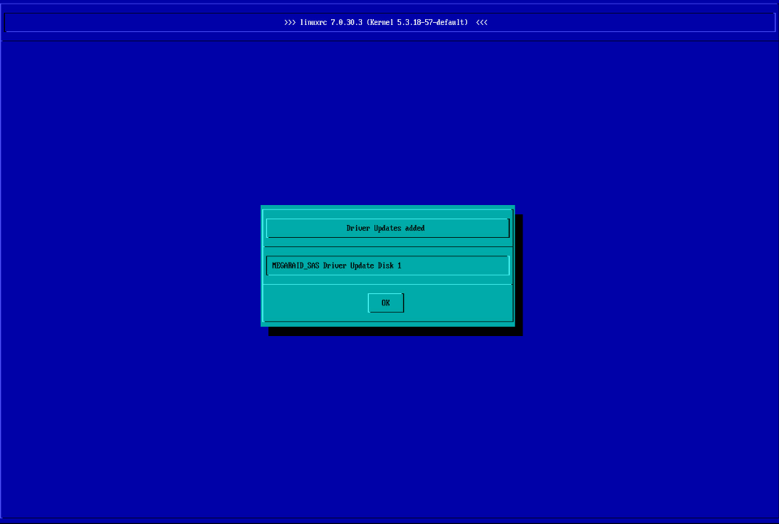

3.     Input dud=1 at the end of the line that starts with linuxefi, and then press F10 to start installation.
Figure 90 Editing the kernel
4.     As shown in Figure 91, on the driver loading screen, select OK and press Enter to enter the driver medium selection screen.
Figure 91 Confirming driver loading

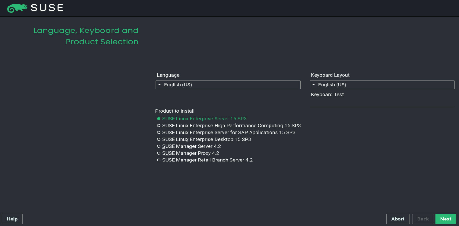

6.     As shown in Figure 93, set the language and keyboard layout of the OS, and then select the type of the OS to be installed in the Product to install section. Then, click Next. The following installs a new OS as an example.
Figure 93 Setting the language, keyboard layout, and OS type

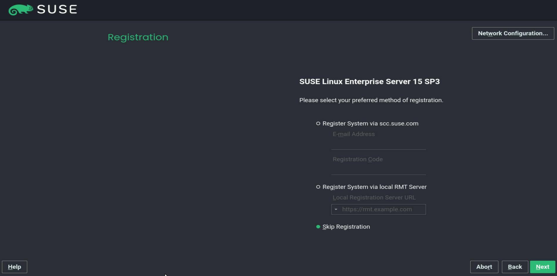

8.     As shown in Figure 95, select whether to register. This example selects Skip Registration. Then, click Next. In the dialog box that opens as shown in Figure 96, click OK.
An unregistered system will be unable to receive regular updates and fix security vulnerabilities.
Figure 95 Selecting a registration method
Figure 96 Skipping registration

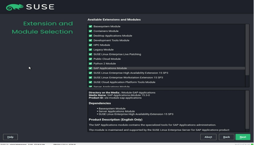

9.     As shown in Figure 97, select extensions and modules for the system as needed, and click Next. It might be time consuming if you select many opions.
Figure 97 Selecting extensions and modules

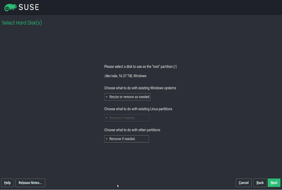

12.     As shown in Figure 100, to use the default partitions, click Next only. You can also configure user-defined partitions in the following methods:
¡     To configure partitions in guide mode, click Guided Setup to enter the screen as shown in Figure 101.
¡     To configure partitions in expert mode, click Expert Partitioner to enter the screen as shown in Figure 102.
·     swap—Switching partition to implement virtual memory. As a best practice, set its size to one or twice of the physical memory.
·     /boot/efi—System boot file partition. It must be in the efi partition or fat format. As a best practice, set the size to 100 MB to 200 MB.
·     /—Root partition to save system software and files.
Figure 100 Disk partitioning
Figure 101 Partitioning in guide mode
Figure 102 Partitioning in expert mode

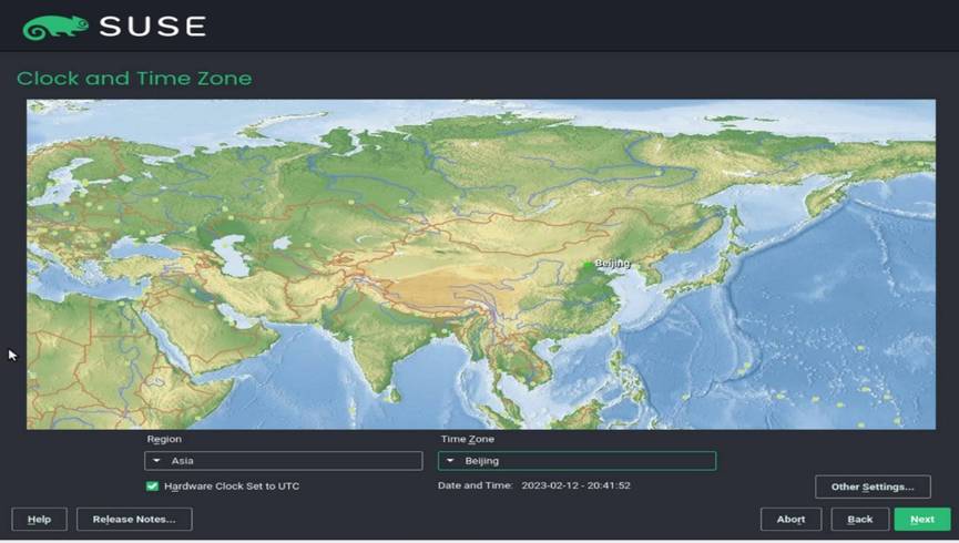

13.     Set the region and time zone. As shown in Figure 103, click the drop-down arrow for the Region and Time Zone fields to set the region and time zone, respectively, and then click Next.
Figure 103 Setting the region and time zone

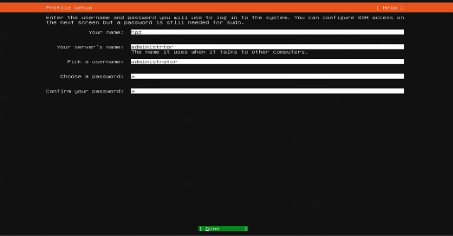

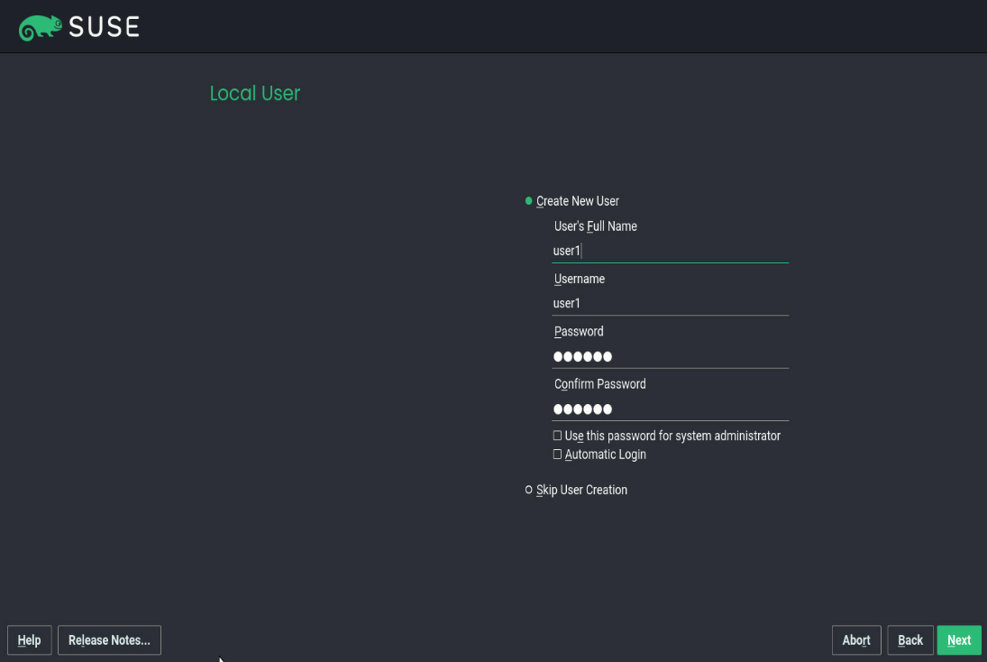

14.     As shown in Figure 104, set the username and password to create a local user, and then click Next.
Figure 104 Setting the username and password

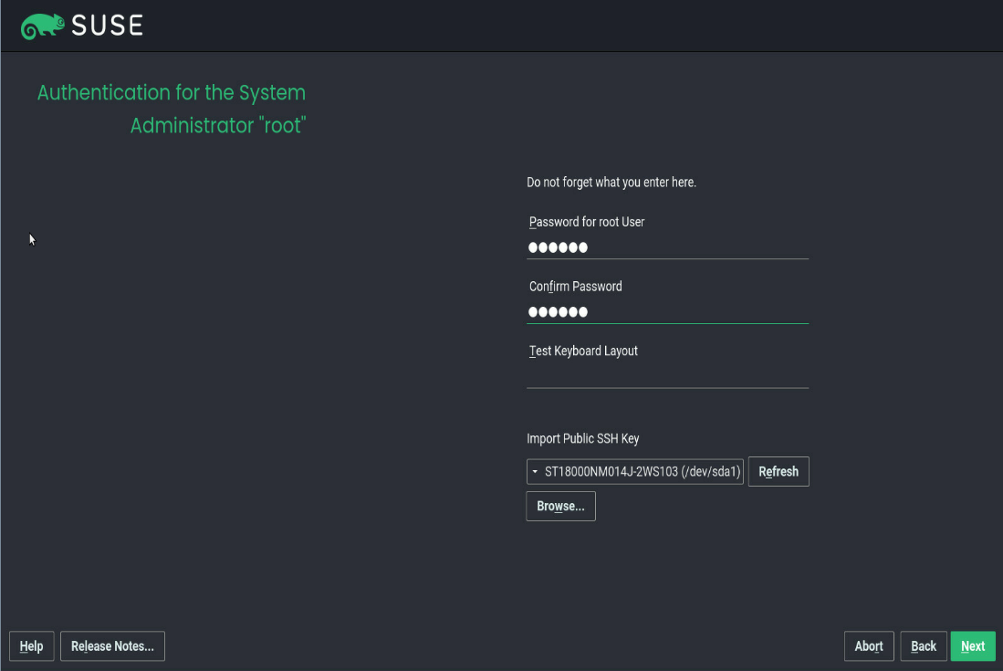

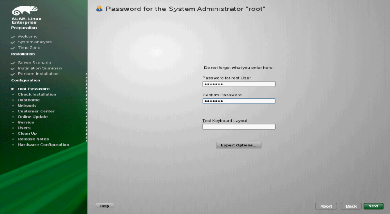

15.     As shown in Figure 105, set the root password, and then click Next.
Figure 105 Setting the root password

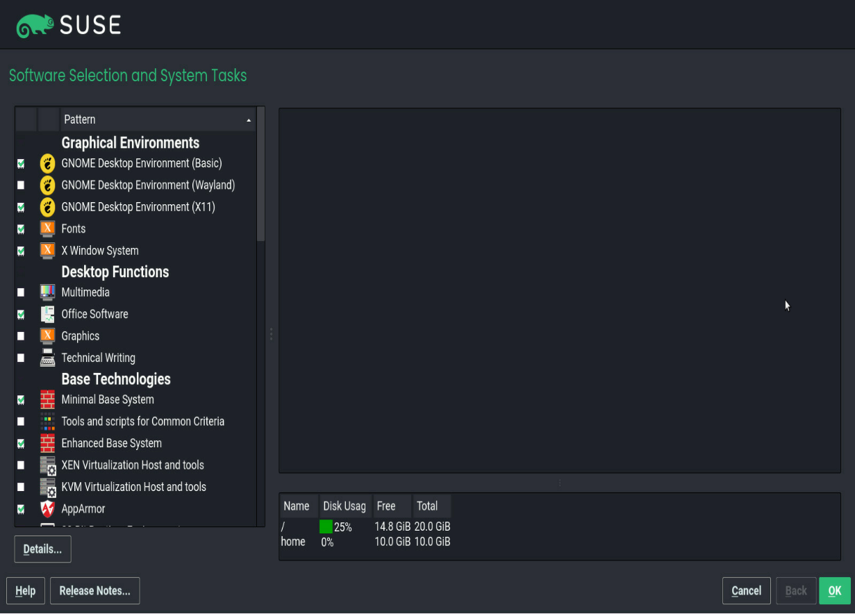

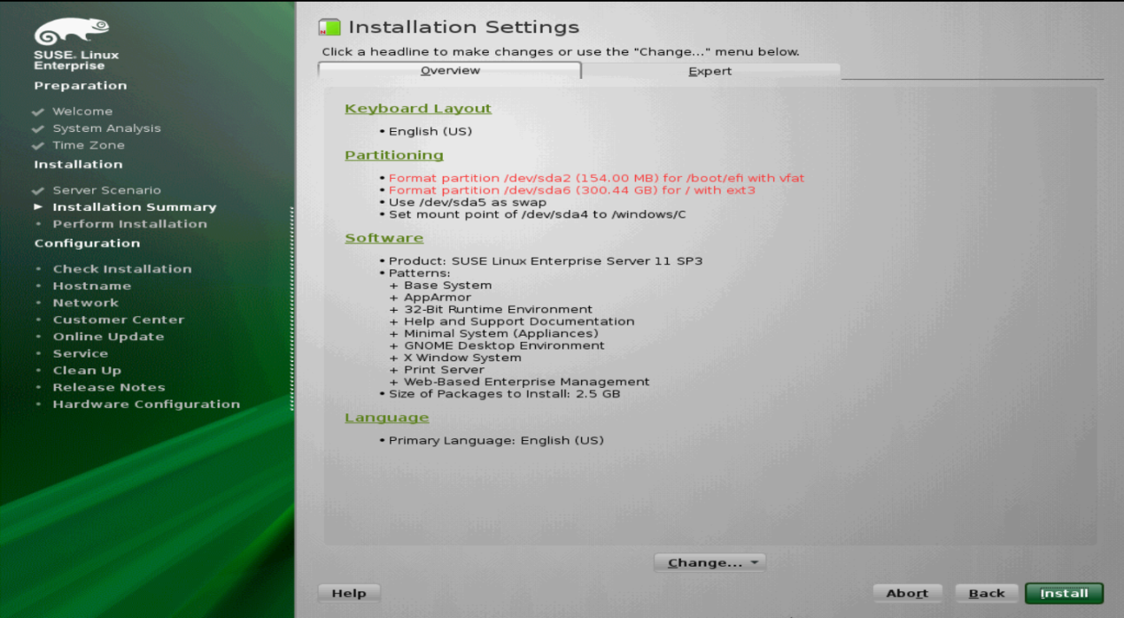

16.     As shown in Figure 106, click Software on the installation settings screen. On the screen as shown in Figure 107, select software and system tasks, and then click OK.
Figure 106 Installation Settings screen
Figure 107 Selecting software and system tasks

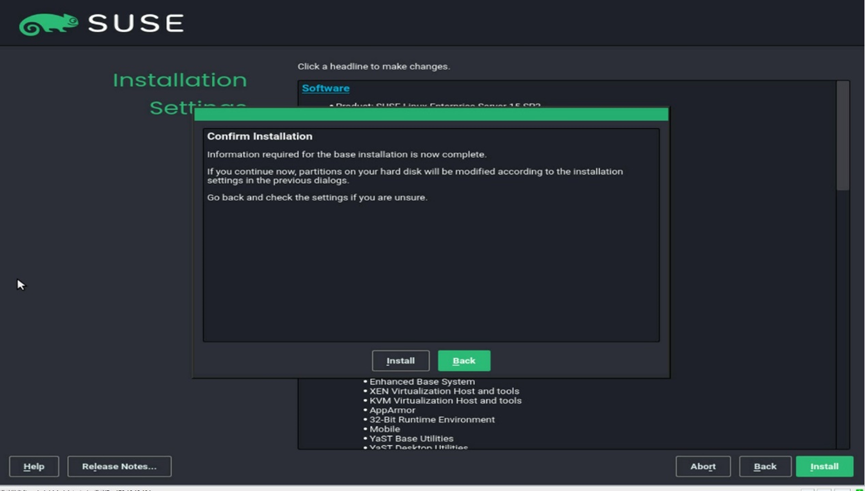

17.     As shown in Figure 108, click Install. In the dialog box that opens, click Install to start system installation. The installation progress is as shown in Figure 109.
Figure 108 Confirming installation
Figure 109 System installation screen

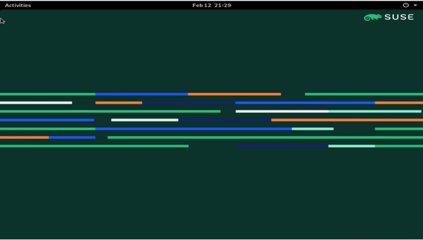

18.     After system installation finishes, restart the system and enter the username and password to enter the system desktop, as shown in Figure 110.
Figure 110 Entering the system desktop

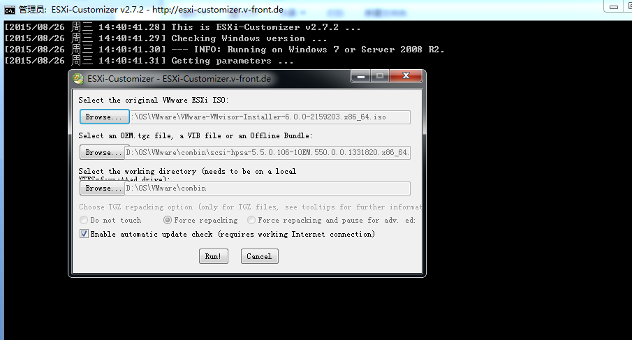

1.     Download ESXi-Customizer and storage controller driver. You can download ESXi-Customizer from the Internet and a storage controller driver from the H3C website.
2.     Run ESXI-Customizer.cmd, and perform the following tasks in the dialog box that opens:
¡     Select the original VMware ESXi ISO.
¡     Select an OEM.tgz file, a VIB file, or an Offline Bundle.
¡     Select the working directory.
3.     Click Run.
Figure 111 Integrating an OS image and a storage controller driver

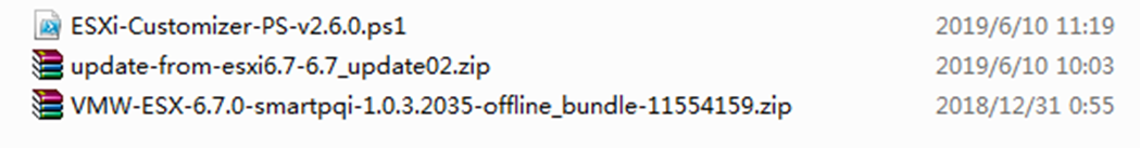

b.     Put the storage controller driver, original VMWare ESXi OS image, and ESXi-Customizer-PS in the same directory.
Figure 115 Preparing the driver, OS image, and ESXi-Customizer-PS

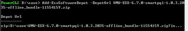

d.     Execute the Add-esxsoftwareDepot –depoturl driver_file_name.zip command to load the driver file.
Figure 117 Loading the driver file

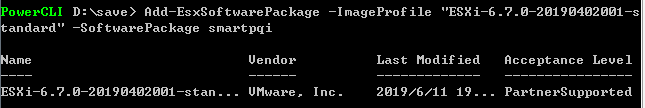

h.     Execute the Add-EsxSoftwarePackage –ImageProfile configuration_file_name –SoftwarePackage driver_name command to integrate the OS image and the driver.
Figure 121 Integrating the OS image and the driver

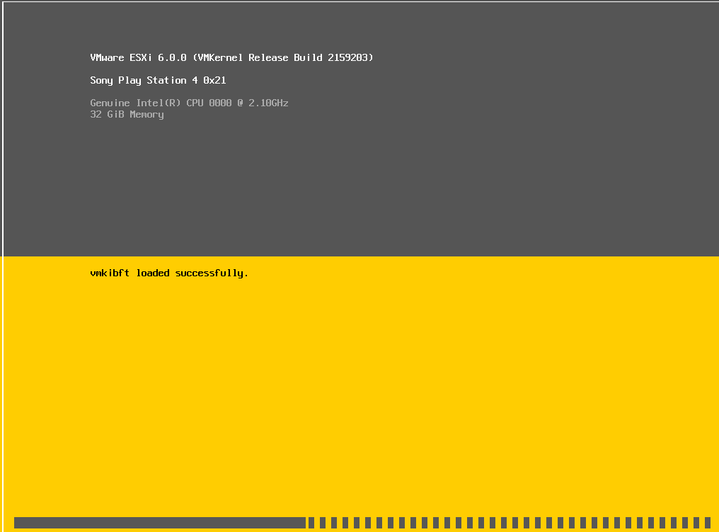

2.     Wait for the system to load the file.

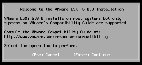

Figure 124 Loading ESXi installer
Figure 125 Loading the OS module
3.     Press Enter as prompted to continue installation.
Figure 126 VMware ESXi installation

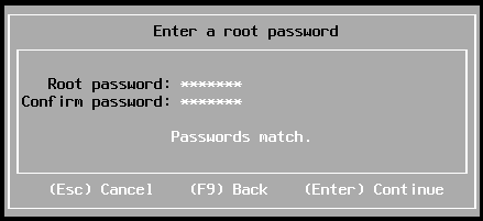

8.     Set the root password, and then press Enter.
Figure 131 Setting the root password

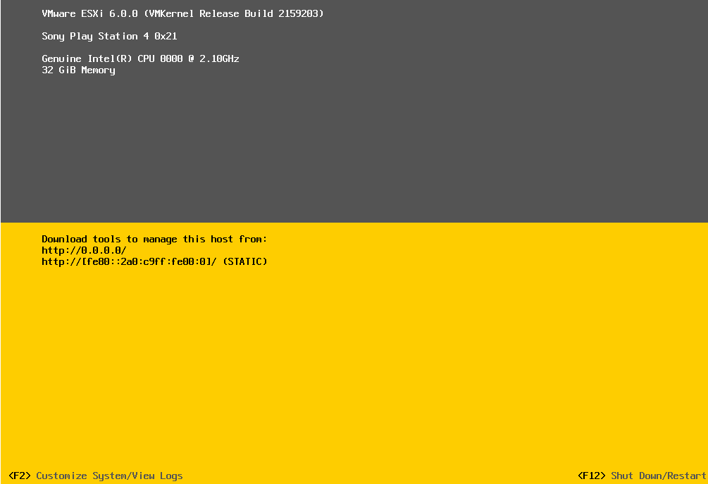

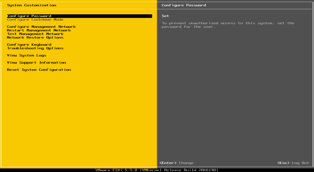

11.     Press F2, enter the root password, and then press Enter.
The OS installation is complete when the page as shown in Figure 136 appears.
Figure 135 Entering the root password
Figure 136 Configuring the password

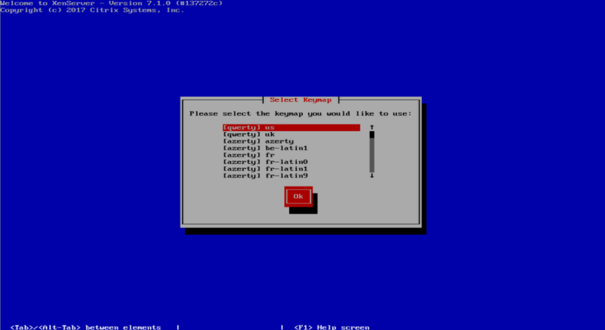

3.     Select the keymap to use and then click OK. This example selects [qwerty] us.
Figure 138 Selecting the keymap

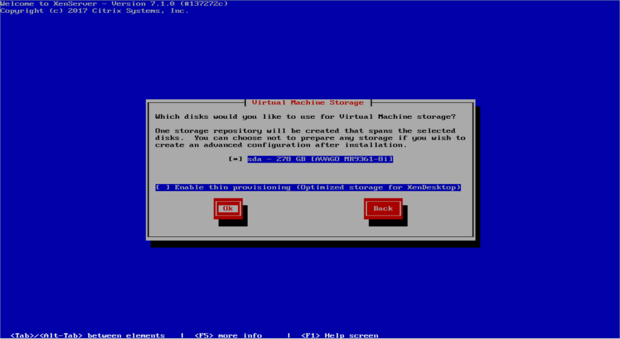

6.     Select a disk to install the OS if you have multiple disks, and then click OK.
Figure 141 Selecting a disk

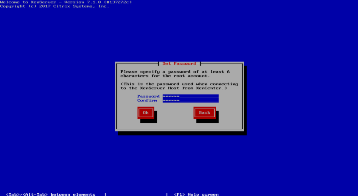

9.     Set and confirm the root password, and then click OK. XenCenter will use this password to connect to the XenServer host.
Figure 144 Setting the root password

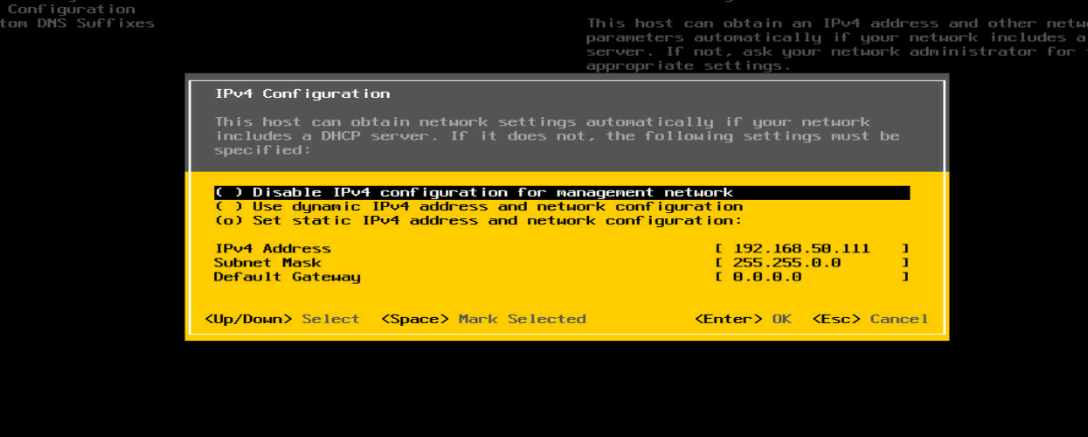

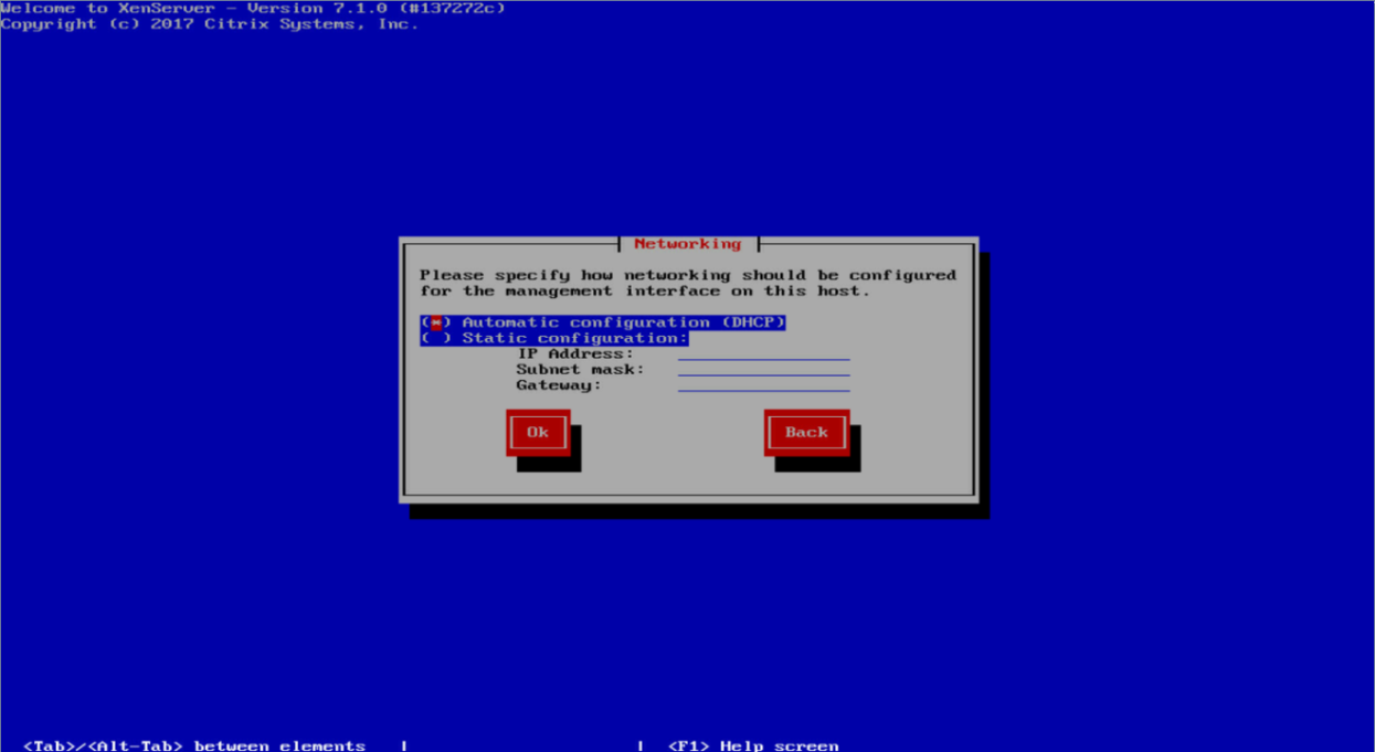

11.     Select a method for specifying an IP address for the management interface, and then click OK.
¡     Automatic configuration (DHCP)Obtains an IP address through DHCP.
¡     Static configurationManually specify an IP address. If you select this option, you must also specify an IP address, mask, and gateway address.
Figure 146 Specifying an IP address

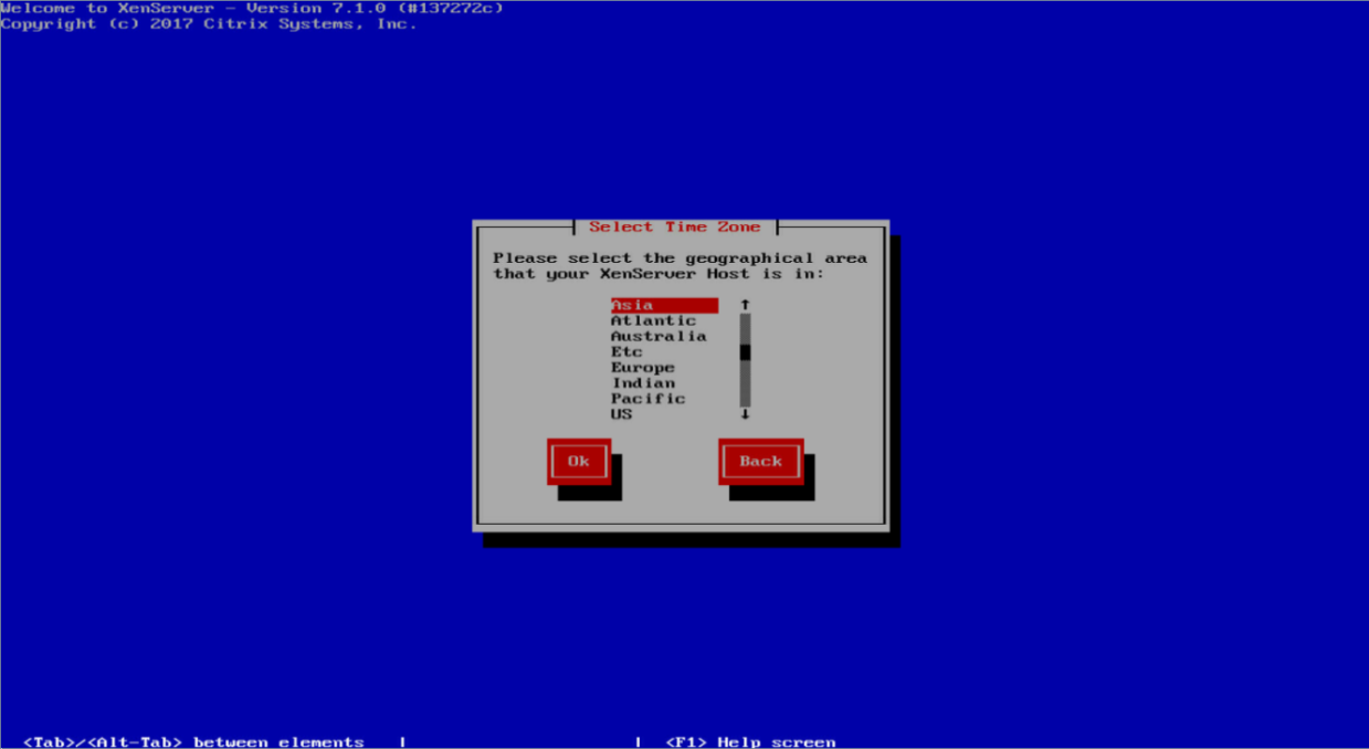

13.     Set the time zone by selecting the geographical area and then the city, and then click OK.
Figure 148 Setting the time zone

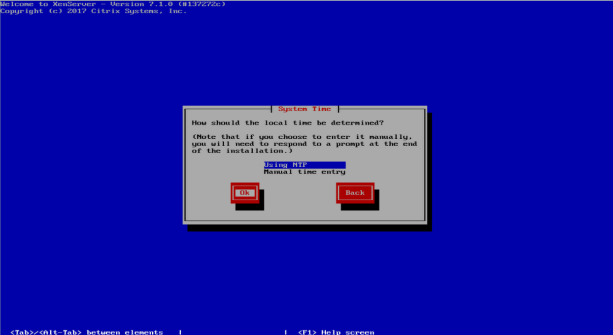

14.     Select a method for setting the system time, and then click OK.
¡     Using NTPYou must specify a minimum of one NTP server and specify the IP address of the NTP server.
¡     Manual time entryYou must manually enter the system time after installation.
Figure 149 Selecting the method for setting the system time
Figure 150 Configuring the NTP server

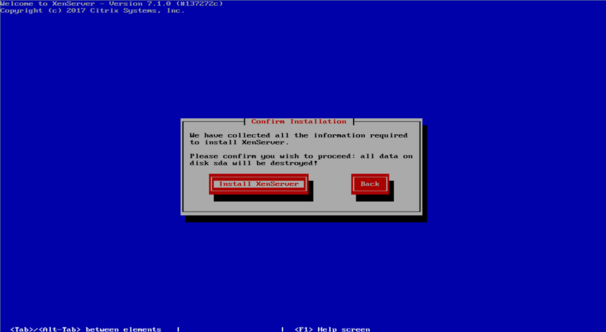

15.     Select Install XenServer, and then press Enter to start installation.
Figure 151 Starting installation

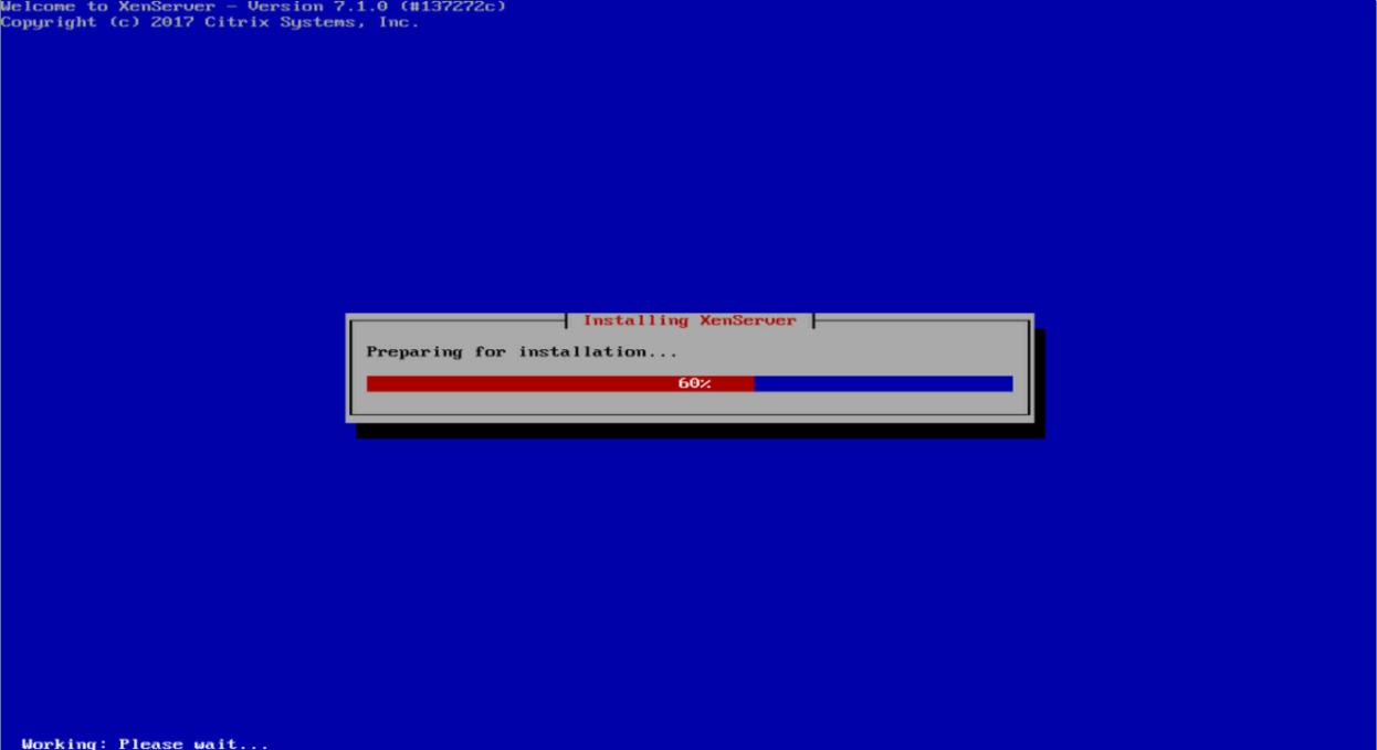

16.     Wait for the system to complete installation.
Figure 152 OS installation in progress

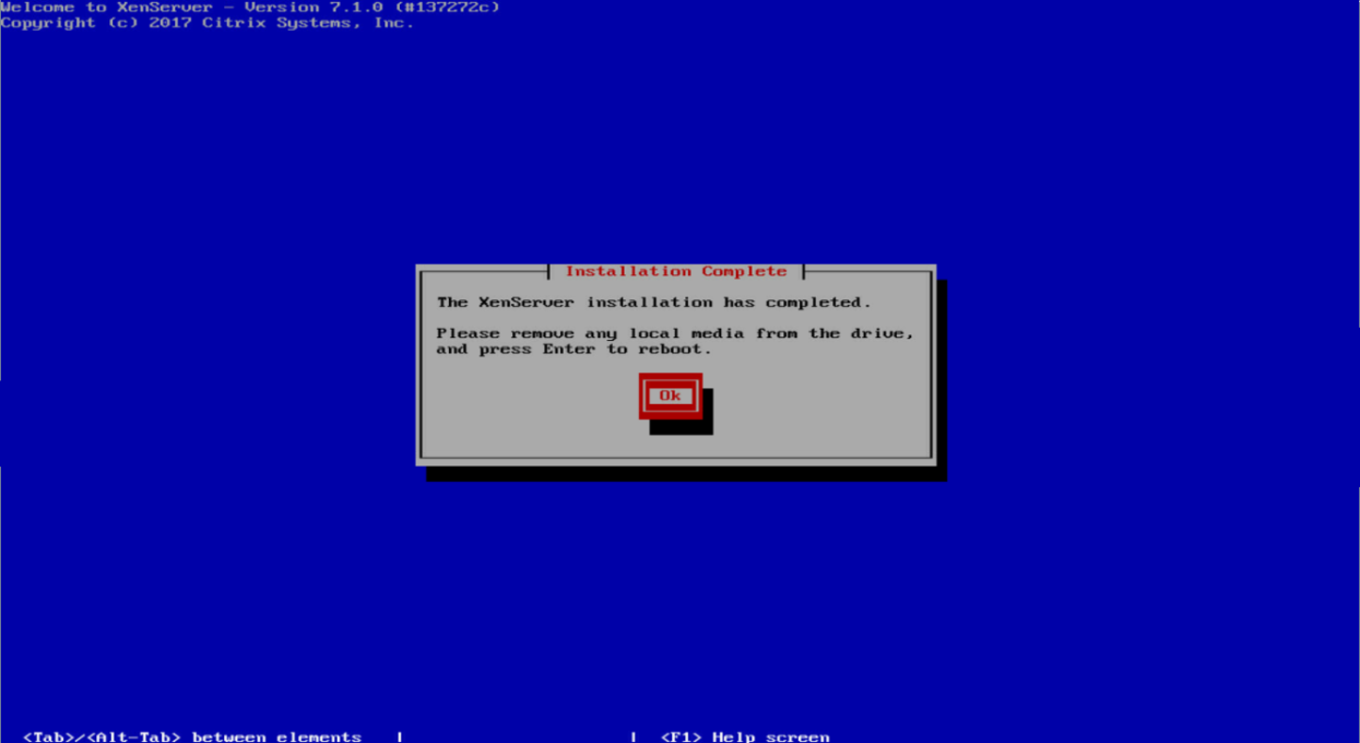

17.     Click OK after installation is completed to restart the server.
Figure 153 Installation completed

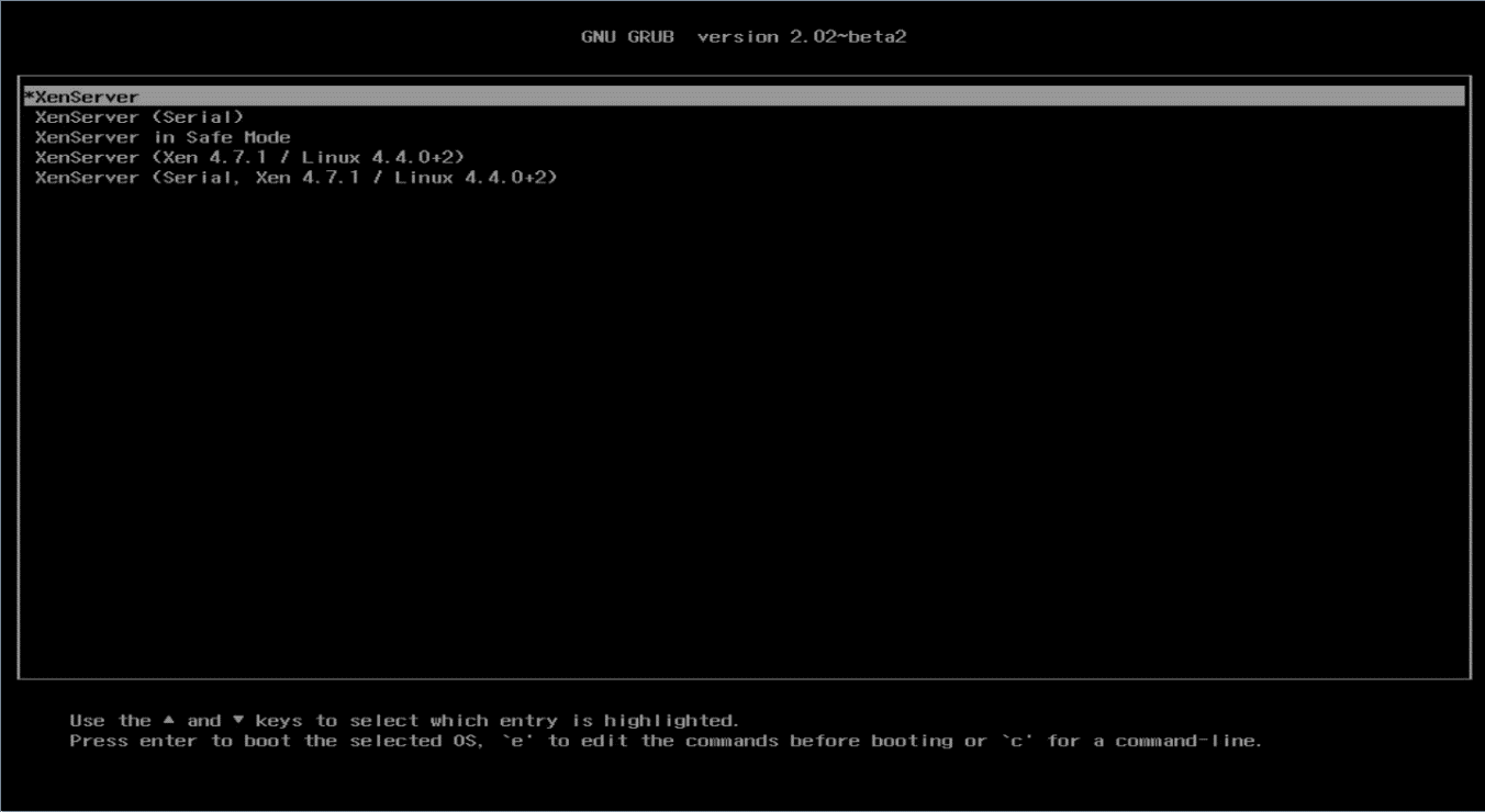

18.     Select XenServer, and then press Enter.
Figure 154 GNU GRUB
You have entered the Citrix XenServer GUI when the following page appears.
Figure 155 Citrix 7.1 GUI

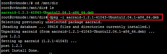

Make sure both the OS image and the storage controller driver file have been mounted to the server.

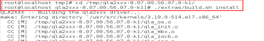

Install the RAID controller driver package by following the procedures in the Readme packed with the RAID controller driver package obtained from the H3C official website.
If the system displays that the driver name is in use when you remove the driver shipped with the kernel by executing the modpobe –r driver_name or rmmod driver_name command, it indicates that the hard drive connected to the storage controller has the system disk where the controller is created. In this case, do not remove the driver until you are prompted or reboot the server and then enter the BIOS Setup Utility to delete the original logical disk, create a new disk and then continue installation.

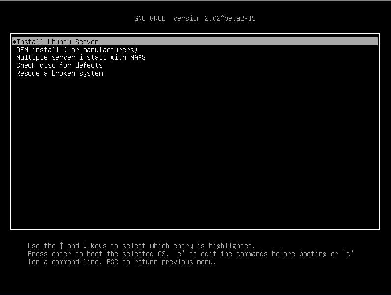

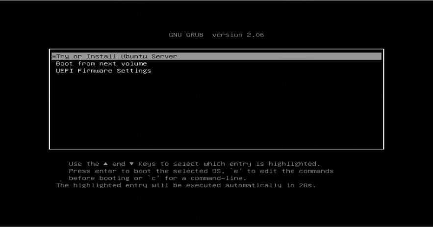

2.     Select Install Ubuntu Server, and then press Enter.
Figure 156 Installing Ubuntu server

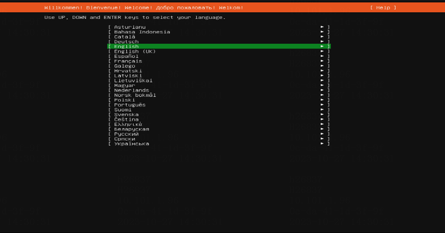

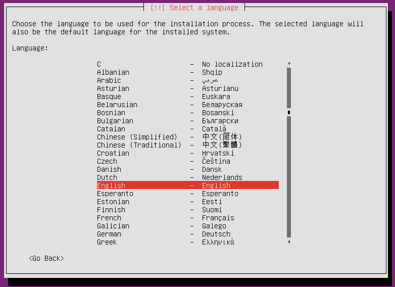

3.     Select a language, and then press Enter.
Figure 157 Selecting a language

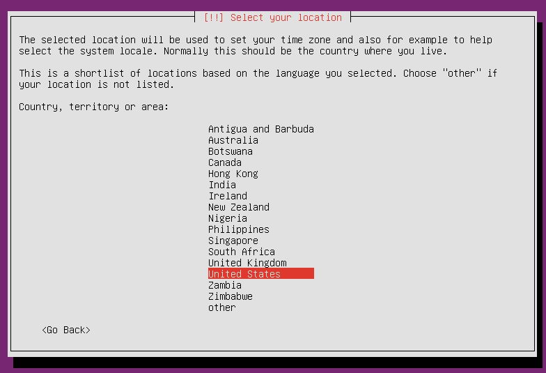

4.     Select your location, and then press Enter.
Figure 158 Selecting a location

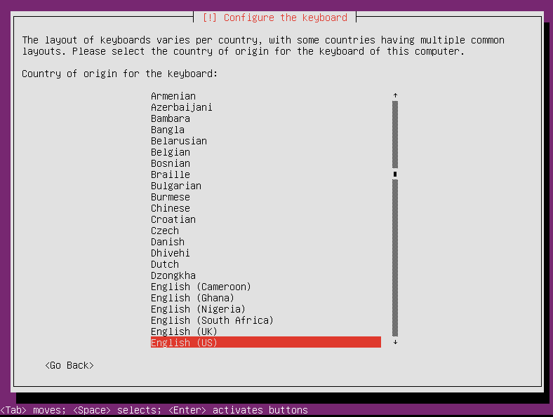

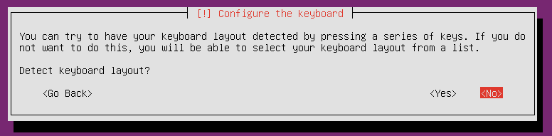

5.     Select whether to detect keyboard layout. This example skips keyboard layout detection.
Figure 159 Selecting whether to detect keyboard layout
6.     Select the country of origin for the keyboard, and then press Enter.
Figure 160 Selecting the country of origin for the keyboard

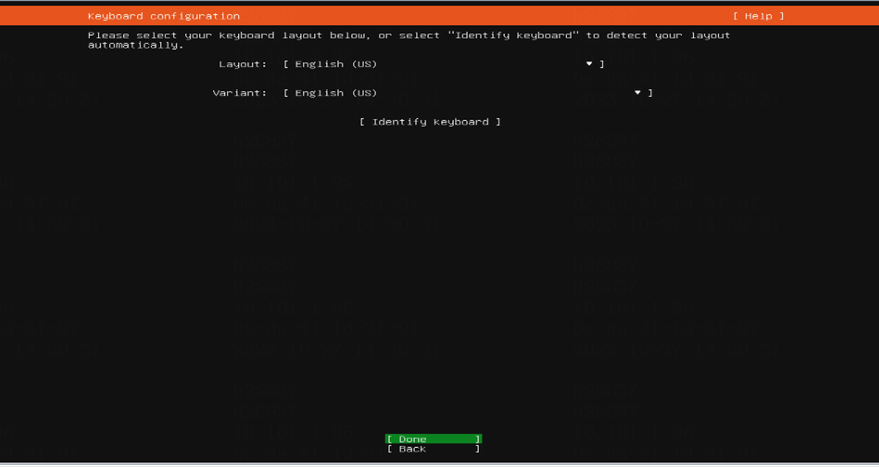

7.     Select the keyboard layout, and then press Enter.
Figure 161 Selecting the keyboard layout

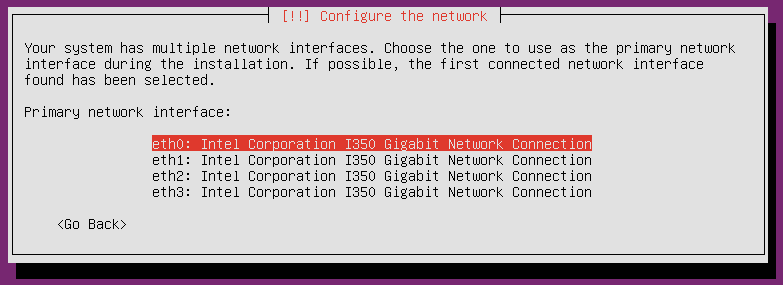

8.     Select a connected network interface as the primary network interface, and then press Enter.
Figure 162 Configuring the network

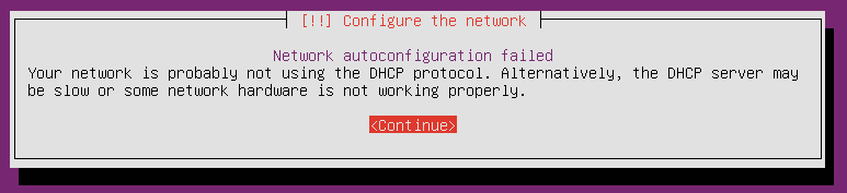

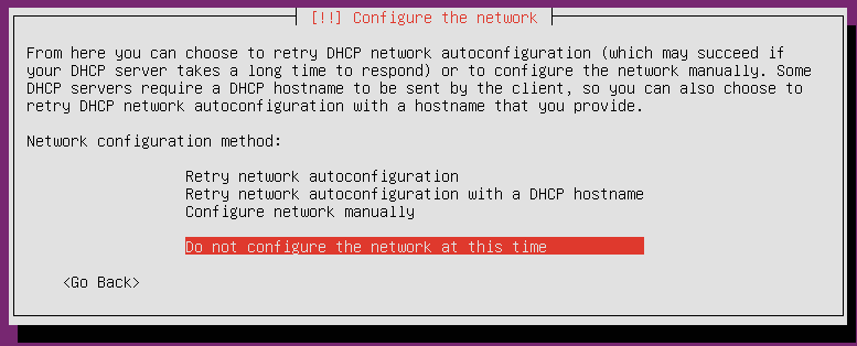

9.     Press Enter when the following page appears.
Figure 163 Network autoconfiguration failed
10.     Select a network configuration method, and then press Enter. This example selects not to configure the network at this time.

11.     Enter the host name and set the user and password in turn by following the configuration wizard, as shown in the following figures.
Figure 165 Entering the host name

1.     Restart the server and enter the screen as shown in Figure 179. Click Esc to enter the BIOS Setup Utility.
Figure 179 Restarting the server
2.     As shown in Figure 180, select EXIT. Select virtual medium CDROM that has been added and press Enter.
Figure 180 Selecting a virtual medium
3.     As shown in Figure 181, select Install Ubuntu Server on the GRUB screen to start Ubuntu installation.
Figure 181 GRUB screen
4.     As shown in Figure 182, select the system language by using the arrow keys on the keyboard and press Enter.
Figure 182 Selecting the system language
5.     As shown in Figure 183, set the keyboard layout and click Done.
Figure 183 Setting the keyboard layout

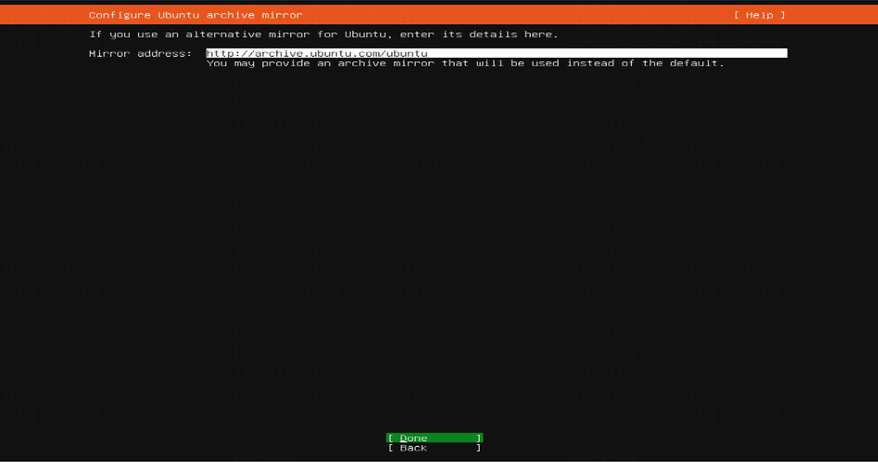

9.     As shown in Figure 187, set the mirror address. Enter the mirror address in the Mirror address field. Then, select Done and press Enter.
Figure 187 Setting the mirror address

14.     As shown in Figure 192, set the username, server name, and password. Then, move the cursor to Done, and press Enter.
Figure 192 Setting the username, server name, and password

4.     On the INSTALLATION SUMMARY page that opens, configure the system information, including the installation destination, network name, and host name.
Figure 200 Configuring system information
a.     In the SYSTEM area of the INSTALLATION SUMMARY page, click Installation Destination. On the page that opens, select the destination devices, select a storage configuration, select whether to encrypt the data, and then click Done.
Figure 201 Configuring the installation destination
b.     In the SYSTEM area of the INSTALLATION SUMMARY page, click Network & Host Name. On the page that opens, select a network port, specify a host name, and then click Done.
Figure 202 Configuring the network name and host name

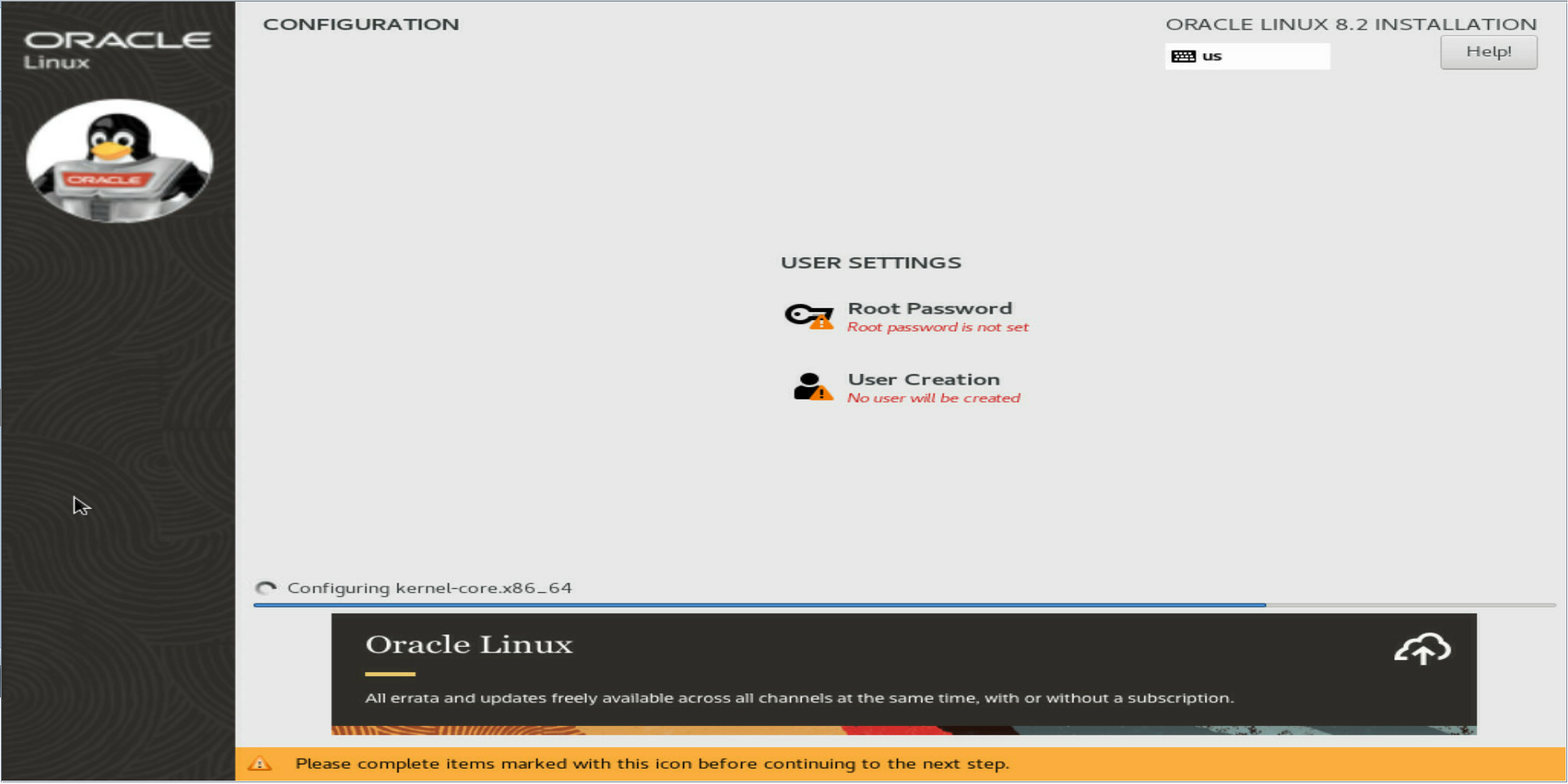

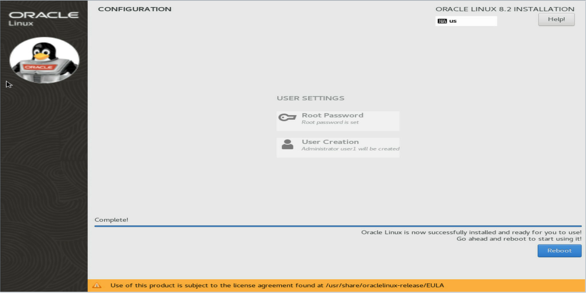

6.     After the installation finishes, click Root Password on the CONFIGURATION page to set the root password and click Done.
As a best practice, specify a strong password.
Figure 204 Setting the root password

9.     On the login page that opens, enter the password to sign in to the OS.
Figure 207 Entering the password
After a successful login, you are placed on the welcome page as shown in Figure 208.
Figure 208 OS welcome screen

11.     As shown in Figure 220, edit the user password for OS login. Use the up and down arrow keys on the keyboard to select OK and press Enter. Then, set the password and press Enter, as shown in Figure 221.
Figure 220 Setting the OS login password
Figure 221 Entering and confirming a new password
12.     Press Enter to confirm the successful password change, as shown in Figure 222.
Figure 222 Login password set successfully

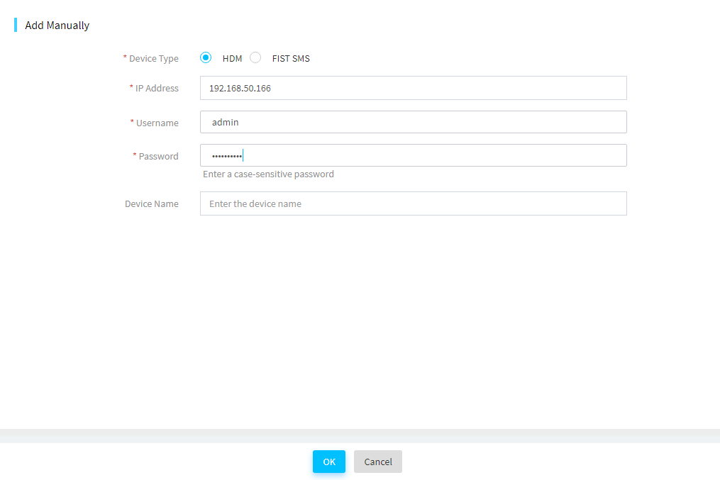

2.     Click Add and select Add Manually in the Method dialog box that opens.
IMPORTANT
IMPORTANT:
To add multiple servers in bulk, select Auto Discovery or Bulk import as a best practice. For more information, see the UniSystem user guide.
3.     Select HDM as the device type, enter the HDM management IP address, HDM username and password, and then click OK.
IMPORTANT
IMPORTANT:
Make sure the HDM account specified by the username has the administrator role and the VMedia privilege. For more information about user privileges, see HDM online help.
Figure 228 Adding a server

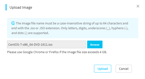

2.     Click Upload.
3.     In the dialog box that opens, click Browse to select an image file to upload, and then click Upload.
After the uploading, you can view the uploaded OS image in the Images page.
Figure 230 Uploading an OS image

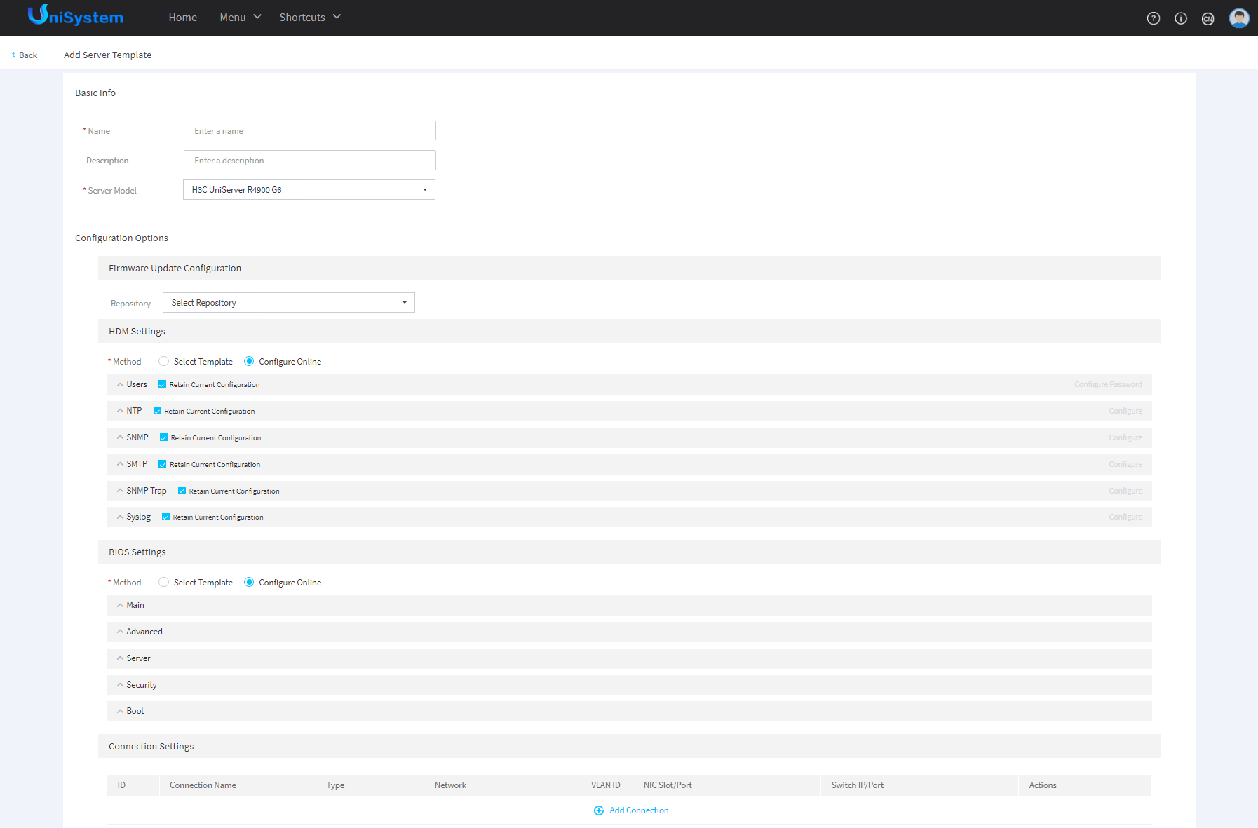

1.     In the navigation pane, select Menu > Templates > Server Templates to enter the Server Templates page.
Figure 235 Server Templates page
2.     Click Add.
Figure 236 Adding a server template
3.     In the Basic Info area, enter the server template name and template description (optional), and then select a compatible server model from the Server Model list.

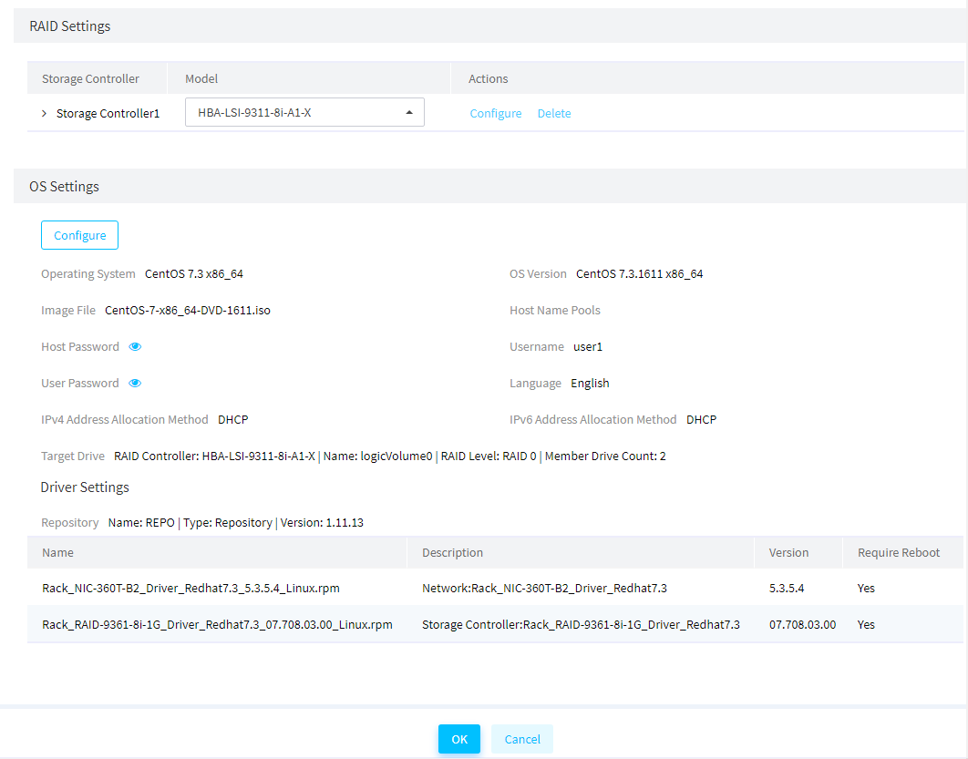

4.     In the RAID Settings area, click Add Storage Controller, select the storage controller model, and then click Configure.
UniSystem supports managing only LSI controllers in RAID mode.
Figure 237  Adding a storage controller
5.     On the dialog box that opens, enter RAID name, RAID level, select a physical drive, and then click OK.
IMPORTANT
IMPORTANT:
To avoid OS installation failure, do not install an OS through a template on a drive of 2 TB or a larger capacity as a best practice.
