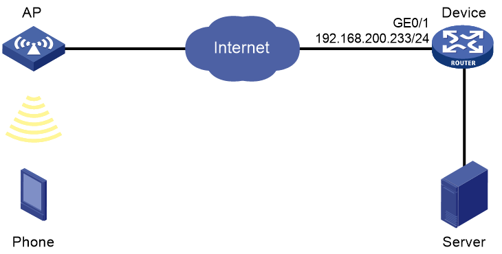

Example: Establishing an IKEv2-based IPsec tunnel to protect IPv4 packets between a mobile phone and a gateway
Establish an IPsec tunnel between a mobile phone (Phone) and a gateway (Device) in order to protect the data flows between them. The following information describes the deployment in detail:
·     The encapsulation mode is the tunnel mode.
·     The security protocol is ESP.
·     The phone and device use IKEv2 to establish IPsec SAs.
·     The device does not perform IKE extended authentication on the phone and assigns an IPv4 address to the phone.
Figure 1 Network diagram

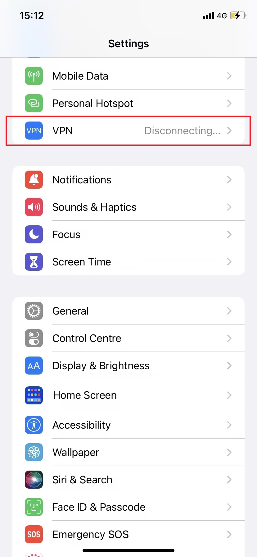

1.     Access the Settings page of the phone, and then click VPN, as shown in Figure 2.
Figure 2 Settings

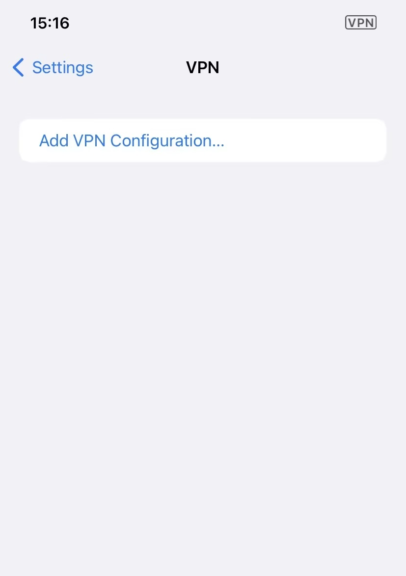

2.     Go to the VPN & Device Management > VPN page, and then click Add VPN Configuration to open the Add Configuration page.
Figure 3 VPN

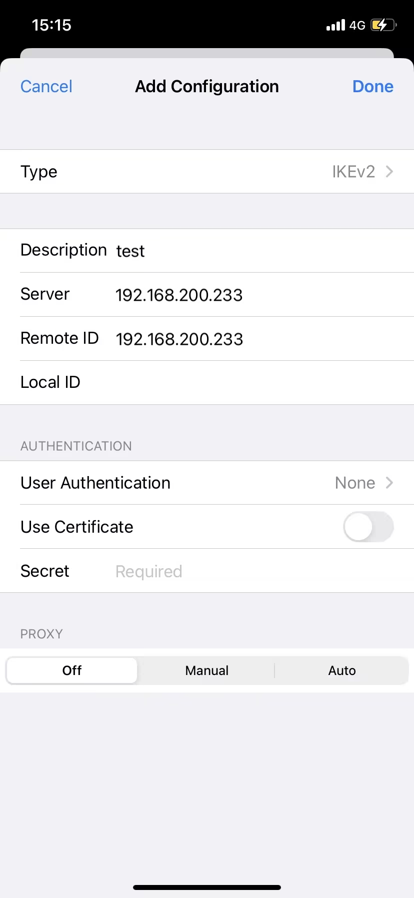

3.     Add the following configuration:
¡     Type: Select IKEv2 as the VPN type.
¡     Description: Enter a description for the VPN. This example uses test.
¡     Server: Enter 192.168.200.233.
¡     Remote ID: Enter 192.168.200.233.
¡     User Authentication: Select None.
¡     Use Certificate: Turn off this button.
¡     Secret: Enter 123.
¡     Click Done to complete and save the VPN configuration.
Figure 4 Add Configuration

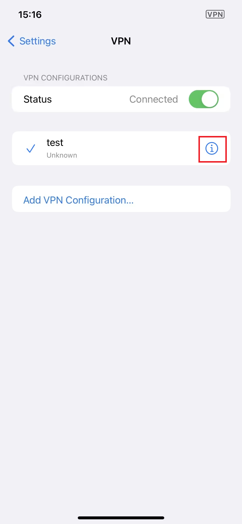

After the previous configuration is complete, the phone and the device can establish an IPsec tunnel through IKEv2 negotiation.
# On the VPN page of the phone, connect to VPN test. You can see that the VPN status turns to Connected, indicating that the phone has connected to the device. Click the icon at the right of the VPN connection field to view the details.
Figure 5 VPN

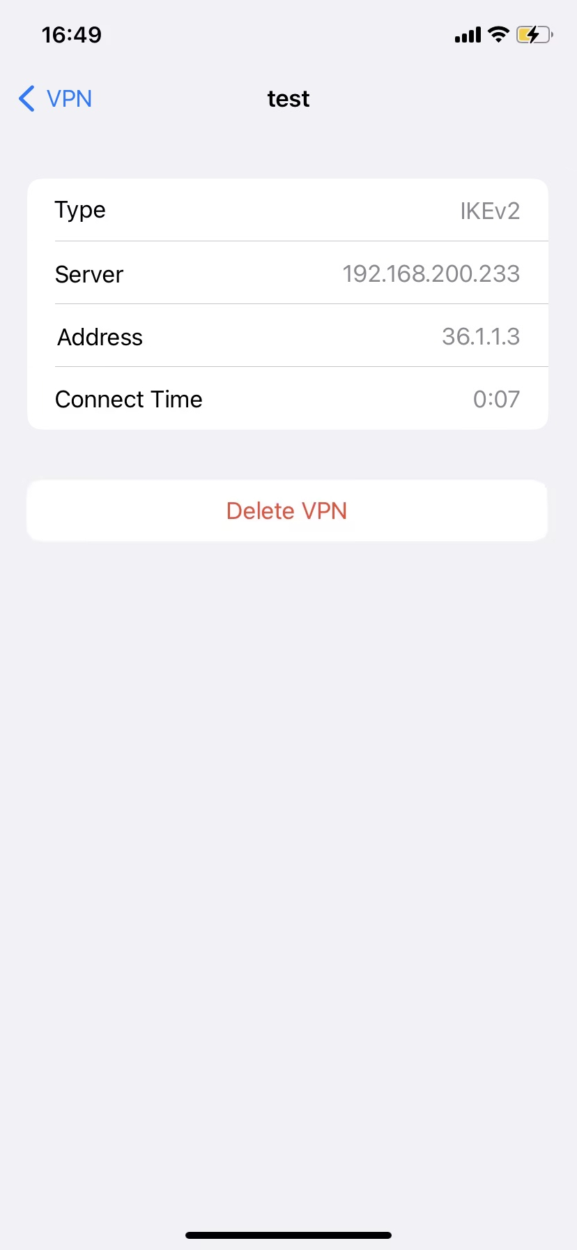

# On the VPN details page, you can see that the phone has connected to the device and obtained an IPv4 address of 36.1.1.3.
Figure 6 VPN details
