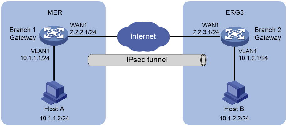

As shown in Figure 1, the MER router is the gateway of branch 1 and the ERG3 router is the gateway of branch 2. MER uses a single WAN interface, ERG3 uses dual WAN interfaces, and the WAN interfaces each use a fixed public address to connect to the Internet. Branch 1 and branch 2 communicate with each other over the Internet.
To protect data flows between the branches, establish an IPsec tunnel between the two gateway routers. The specific requirements are as follows:
·     Configure the two gateway routers to use preshared key 123456TESTplat&! for authentication.
·     Use the main mode IKE negotiation.
·     Specify the encryption algorithm as 3DES-CBC and the authentication algorithm as MD5.
·     Specify the encapsulation mode as the tunnel mode and the security protocol as ESP.
Figure 1 Network diagram

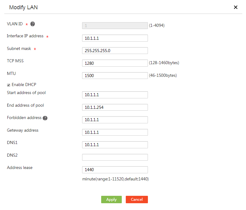

Editing the IP address of VLAN-interface 1
# Change the IP address of VLAN-interface 1 to 10.1.1.1/24. The configuration steps are as follows:
1.     From the left navigation pane, select Network > LAN Settings.
2.     Click the LAN Settings tab.
3.     Click the edit icon in the Operation column for VLAN1.
4.     In the Interface IP address field, enter 10.1.1.1.
5.     In the Subnet mask field, enter 255.255.255.0.
6.     Use the default settings for the other parameters, and click Apply.

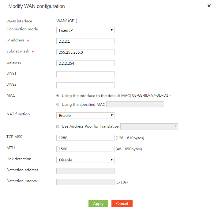

Configuring WAN1 to connect to the Internet

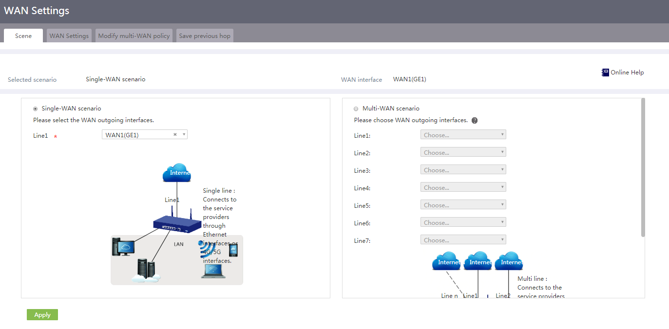

# In this example, select the single-WAN scenario for the MER router, and set the connection mode of the selected WAN interface to fixed IP. The configuration steps are as follows:
1.     On the Web interface of the device, select Network > WAN Settings from the navigation pane.
2.     On the Scene tab, select Single-WAN scenario, select WAN1 for Line1, and then click Apply.
3.     Click the WAN Settings tab.
4.     Click the Edit icon in the Operation column for WAN1.
5.     In the Connection mode field, select Fixed IP.
6.     In the IP Address field, enter 2.2.2.1.
7.     In the Subnet mask field, enter 255.255.255.0.
8.     In the Gateway field, enter 2.2.2.254.
9.     Use the default settings for other parameters. Click Apply.

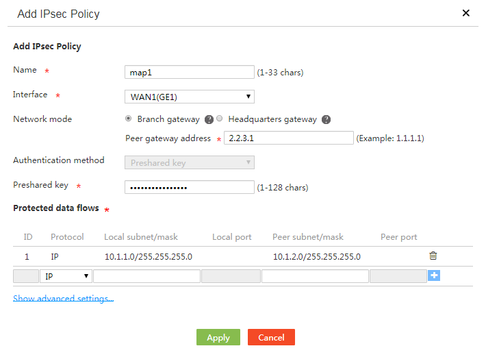

Configuring the IPsec policy
# Specify the network mode as the branch gateway and the IKE negotiation mode as the main mode. The configuration steps are as follows:
1.     From the navigation pane, select Virtual Network > IPsec VPN.
2.     Click Add. On the page that opens, configure the following parameters:
¡     Specify the name as map1.
¡     Select WAN1 in the Interface field.
¡     Select Branch gateway in the Network mode field.
¡     Enter 2.2.3.1 in the Peer gateway address field.
¡     Enter 123456TESTplat&! in the Preshared key field.
¡     In the Protected data flows area, select IP as the protocol to be protected, enter 10.1.1.0/24 in the Local subnet/mask filed and 10.1.2.0/24 in the Peer subnet/mask field, and then click the + icon.
Figure 5 Configuring the IPsec policy

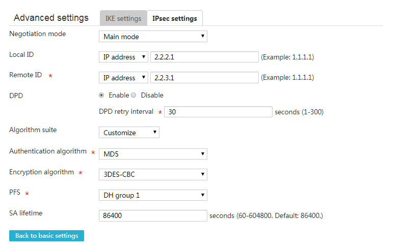

3.     Click Show advanced settings. On the page that opens, configure the following parameters:
¡     In the Negotiation mode field, select Main mode.
¡     In the Local ID field, select IP address, and then enter 2.2.2.1.
¡     In the Remote ID field, select IP address, and then enter 2.2.3.1.
¡     In the DPD field, select Enable, and set the DPD retry interval to 30 seconds. (This feature is disabled by default. To monitor the availability of the IPsec tunnel in time, enable this feature.)
¡     In the Algorithm suite field, select Customize.
¡     In the Authentication algorithm field, select MD5.
¡     In the Encryption algorithm field, select 3DES-CBC.
¡     Use the default settings for other parameters.
Figure 6 IKE settings

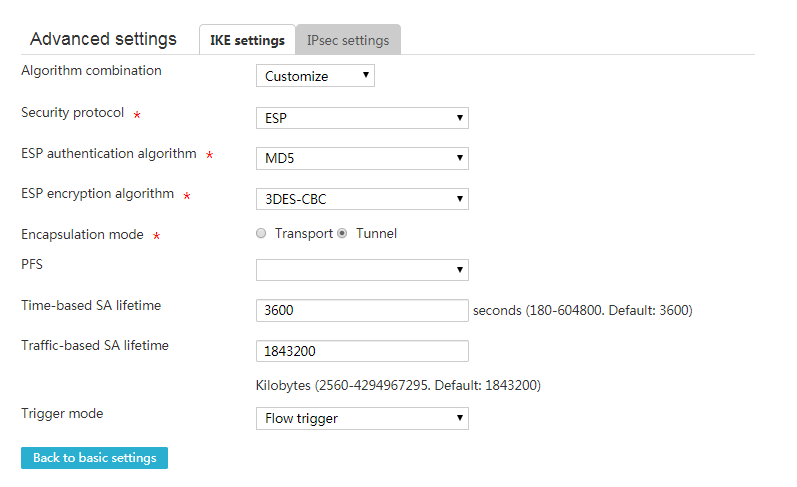

4.     Click the IPsec settings tab, and then configure the following parameters:
¡     In the Algorithm combination field, select Customize.
¡     In the Security protocol field, select ESP.
¡     In the ESP authentication algorithm field, select MD5.
¡     In the encryption algorithm field, select encryption algorithm.
¡     In the Encapsulation mode field, select Tunnel.
5.     Click Back to basic settings to go back to the Add IPsec Policy page.
Figure 7 IPsec settings

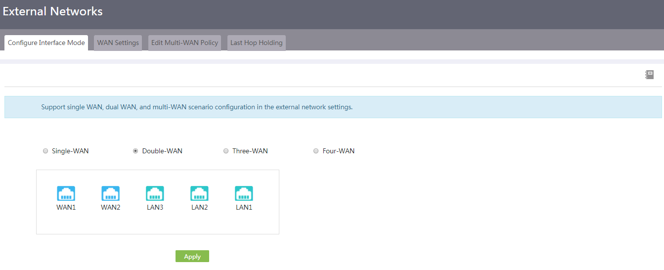

# In this example, select the Double-WAN scenario for the ERG3 router, and set the connection mode of the selected WAN interface to fixed IP. The configuration steps are as follows:
1.     On the Web interface of the device, select Network Settings > External Networks from the navigation pane.
2.     On the Configure Interface Mode tab, select Double-WAN scenario, and then click Apply.

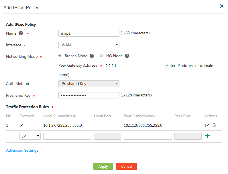

# Specify the network mode as the branch gateway and the IKE negotiation mode as main mode. The configuration steps are as follows:
1.     From the navigation pane, select VPN > IPsec VPN.
¡     Select Branch Node in the Networking Mode field.
¡     Enter 2.2.2.1 in the Peer Gateway Address field.
¡     Enter 123456TESTplat&! in the Preshared Key field.
¡     In the Traffic Protection Rules area, select IP as the protocol to be protected, enter 10.1.2.0/24 in the Local Subnet/Mask filed and 10.1.1.0/24 in the Peer Subnet/Mask field, and then click the + icon.
Figure 11 Configuring the IPsec policy

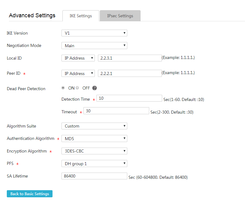

3.     Click Advanced Settings. On the page that opens, configure the following parameters:
¡     In the IKE Version field, select V1.
¡     In the Negotiation Mode field, select Main.
¡     In the Local ID field, select IP address, and then enter 2.2.3.1.
¡     In the Peer ID field, select IP address, and then enter 2.2.2.1.
¡     In the DPD field, select ON, and set the detection time to 10 and timeout to 30.
¡     In the Algorithm Suite field, select Customize.
¡     In the Authentication Algorithm field, select MD5.
¡     In the Encryption Algorithm field, select 3DES-CBC.

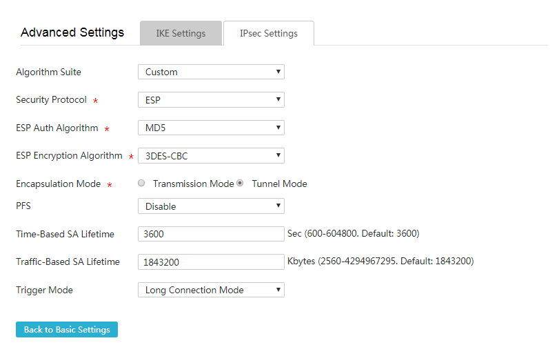

4.     Click the IPsec Settings tab, and then configure the following parameters:
¡     In the Security Protocol field, select ESP.
¡     In the ESP Auth Algorithm field, select MD5.
¡     In the ESP Encryption Algorithm field, select 3DES-CBC.
¡     In the Encapsulation Mode field, select Tunnel Mode.
5.     Click Back to Basic Settings to go back to the Add IPsec Policy page.
Figure 13 IPsec settings
