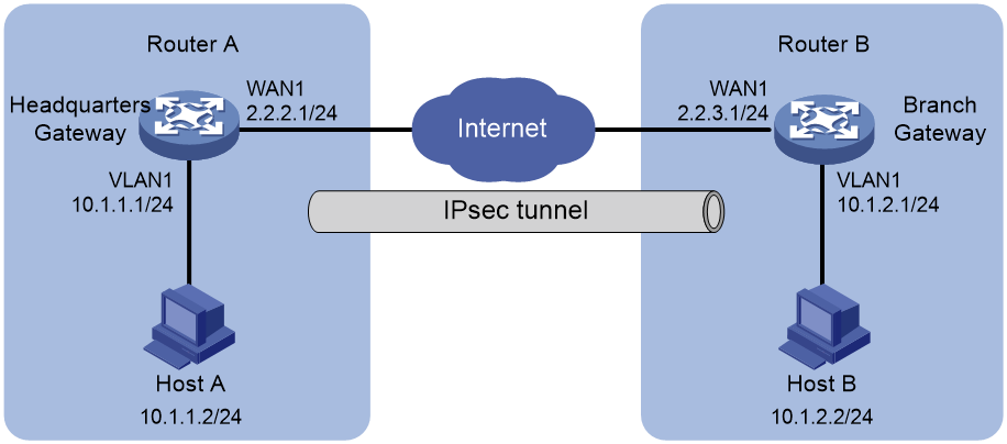

As shown in Figure 1, Router A is the gateway of the headquarters and Router B is the gateway of the branch. Router A and Router B each use a single WAN interface with a fixed public address to connect to the Internet. The headquarters and the branch communicate with each other over the Internet.
To protect data flows between the headquarters and the branch, establish an IPsec tunnel between the gateway routers Router A and Router B. The specific requirements are as follows:
·     Configure Router A and Router B to use preshared key 123456TESTplat&! for authentication.
·     Use the main mode IKE negotiation.
·     Specify the encryption algorithm as 3DES-CBC and the authentication algorithm as MD5.
·     Specify the encapsulation mode as the tunnel mode and the security protocol as ESP.
Figure 1 Network diagram

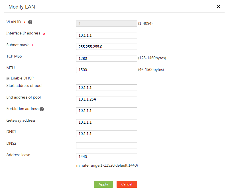

Editing the IP address of VLAN-interface 1
# Change the IP address of VLAN-interface 1 to 10.1.1.1/24. The configuration steps are as follows:
1.     From the left navigation pane, select Network > LAN Settings.
2.     Click the LAN Settings tab.
3.     Click the edit icon in the Operation column for VLAN1.
4.     In the Interface IP address field, enter 10.1.1.1.
5.     In the Subnet mask field, enter 255.255.255.0.
6.     Use the default settings for the other parameters, and click Apply.
Figure 2 Editing the LAN configuration

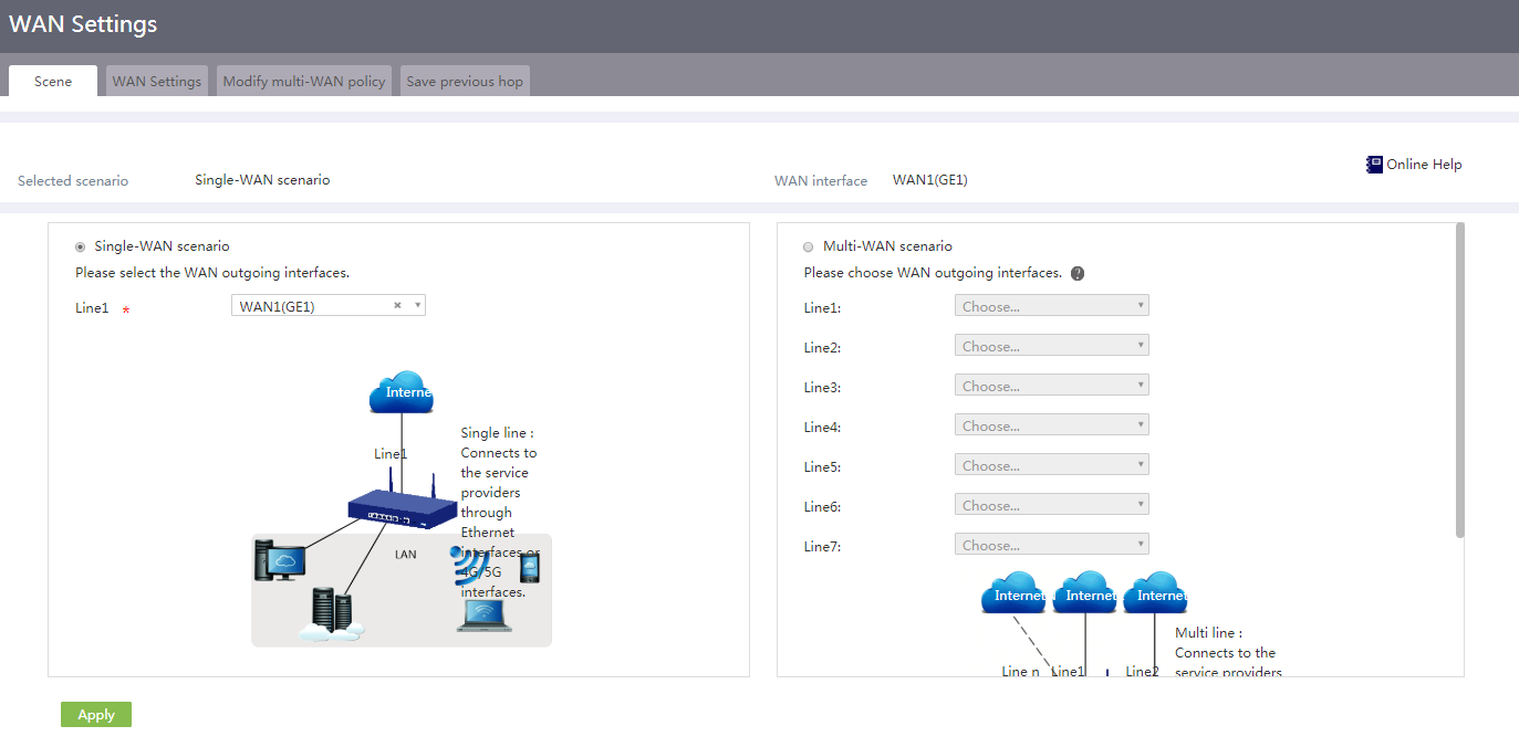

Configuring WAN1 to connect to the Internet
# In this example, select the single-WAN scenario for Router A, and set the connection mode of the selected WAN interface to fixed IP. The configuration steps are as follows:
1.     On the Web interface of the device, select Network > WAN Settings from the navigation pane.
2.     On the Scene tab, select Single-WAN scenario, select WAN1 for Line1, and then click Apply.
3.     Click the WAN Settings tab.
4.     Click the Edit icon in the Operation column for WAN1.
5.     In the Connection mode field, select Fixed IP.
6.     In the IP Address field, enter 2.2.2.1.
7.     In the Subnet mask field, enter 255.255.255.0.
8.     In the Gateway field, enter 2.2.2.254.
9.     Use the default settings for other parameters. Click Apply.
Figure 3 Configuring the WAN scenario
Figure 4 Editing WAN settings

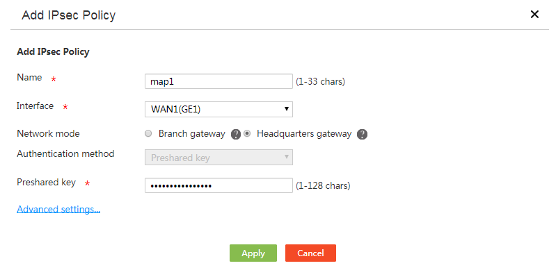

Configuring the IPsec policy
# Specify the network mode as headquarters gateway and the IKE negotiation mode as main mode. The configuration steps are as follows:
1.     From the navigation pane, select Virtual Network > IPsec VPN.
2.     Click Add. On the page that opens, configure the following parameters:
¡     Specify the name as map1.
¡     Select WAN1 in the Interface field.
¡     Select Headquarters gateway in the Network mode field.
¡     Enter 123456TESTplat&! in the Preshared key field.
Figure 5 Configuring the IPsec policy

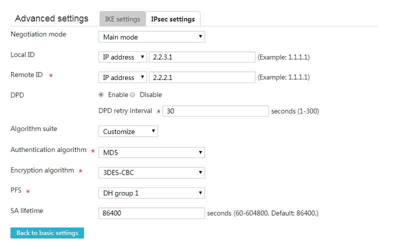

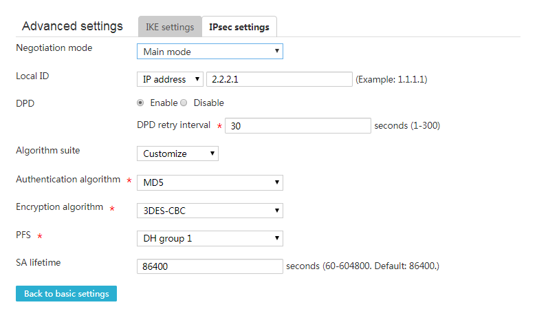

3.     Click Show advanced settings. On the page that opens, configure the following parameters:
¡     In the Negotiation mode field, select Main mode.
¡     In the Local ID field, select IP address, and then enter 2.2.2.1.
¡     In the DPD field, select Enable, and set the DPD retry interval to 30 seconds. (This feature is disabled by default. To monitor the availability of the IPsec tunnel in time, enable this feature.)
¡     In the Algorithm suite field, select Customize.
¡     In the Authentication algorithm field, select MD5.
¡     In the Encryption algorithm field, select 3DES-CBC.
¡     Use the default settings for other parameters.
Figure 6 IKE settings

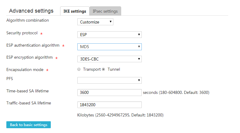

4.     Click the IPsec settings tab, and then configure the following parameters:
¡     In the Algorithm combination field, select Customize.
¡     In the Security protocol field, select ESP.
¡     In the ESP authentication algorithm field, select MD5.
¡     In the encryption algorithm field, select encryption algorithm.
¡     In the Encapsulation mode field, select Tunnel.
5.     Click Back to basic settings to go back to the Add IPsec Policy page.
Figure 7 IPsec settings

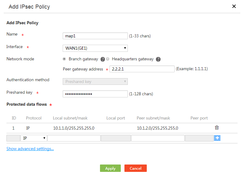

# Specify the network mode as branch gateway and the IKE negotiation mode as main mode. The configuration steps are as follows:
¡     Select Branch gateway in the Network mode field.
¡     Enter 2.2.2.1 in the Peer gateway address field.
¡     In the Protected data flows area, select IP as the protocol to be protected, enter 10.1.2.0/24 in the Local subnet/mask filed and 10.1.1.0/24 in the Peer subnet/mask field, and then click the + icon.
Figure 11 Configuring the IPsec policy
¡     In the Local ID field, select IP address, and then enter 2.2.3.1.
¡     In the Remote ID field, select IP address, and then enter 2.2.2.1.
Figure 12 IKE settings
¡     In the ESP encryption algorithm field, select 3DES-CBC.
Figure 13 IPsec settings
