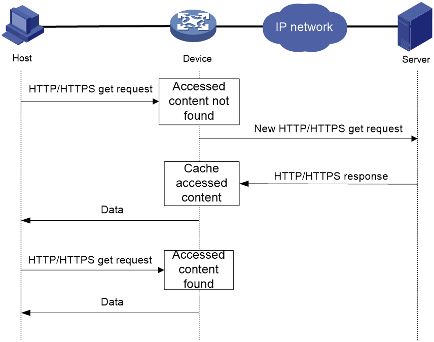

Web caching mechanism
Figure 1 shows the Web caching mechanism.
Figure 1 Web caching mechanism
1.     The host sends an HTTP or HTTPS GET request to the device.
2.     The device identifies whether the destination port number in the request is the same as the listening port number used by the Web server. If yes, the device replaces the destination port number with the listening port number specified for Web caching to trigger the Web caching process.
3.     The Web caching process obtains the URL of the request and looks up its cache for the requested content.
¡     If the requested content is found in the cache, the device retrieves the content and sends the content to the host. The HTTP or HTTPS GET operation is completed.
¡     If the requested content is not found, the device re-constructs the request and sends the request to the Web server.
4.     The Web server sends the requested content to the device.
5.     The device identifies whether the Web caching feature is configured to cache the content.
¡     If yes, the device uses the Web caching feature to cache the content, re-constructs a response, and sends the response to the host.
¡     If not, the device re-constructs a response and sends the response to the host.
Before sending the response, the device will check whether the source port number is the same as the listening port number used by Web caching. If not, the device will replace the source port number in the response with the listening port number of the Web server.

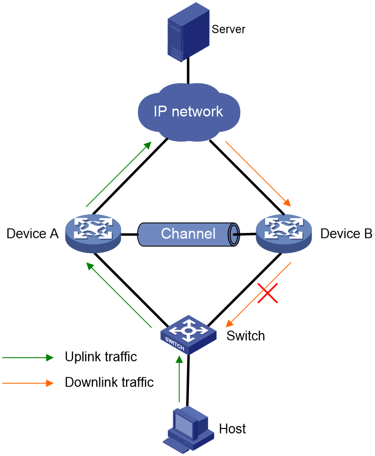

Configuring traffic direction channels for Web cache dual gateways
Perform this task in the Web Cache dual gateways scenario. As shown in Figure 2, gateways Device A and Device B provide the Web Cache service for the user through the switch, and equal cost paths exist on both the uplink and downlink for Web cache. If the uplink and downlink traffic forwarding paths are not the same, the uplink traffic and downlink traffic will be forwarded to different gateways for processing, for example, the user uplink traffic passes Device A and the downlink traffic for the user passes Device B. Device B does not have a record for the user and therefore cannot forward the downlink traffic to the user and the user cannot access the requested Web resources as a result.
In the Web cache dual gateway scenario, the uplink traffic refers to the HTTP/HTTPS requests sent from user hosts to Web servers, and the downlink traffic refers to the HTTP/HTTP responses sent from Web servers to user hosts. The traffic direction channel between the gateway devices is a direct physical link or a GRE tunnel, which ensures the IP connectivity between the gateways.
Figure 2 User failure to access Web resources
As shown in Figure 3, on Device B, you can configure a traffic direction channel with the peer gateway (Device A). If Device B receives Web cache downlink traffic for a user that it cannot find, it forwards the downlink traffic to the peer gateway through the specified channel interface, so the peer gateway can provide Web resources for the user correctly.
Figure 3 Traffic direction channel between gateways
When you execute the dual-gateway-channel command, make sure the specified IPv4 address of the peer gateway is reachable, and in the routing table, the outgoing interface for this IPv4 address is the channel interface specified in this command.
You can use the dual-gateway-channel command to configure multiple traffic direction channels in multiple VPN instances. If you execute this command for the same VPN instance or for the public network multiple times, the most recent configuration takes effect.
Before you configure a channel for traffic direction with the peer gateway, complete the following tasks:
·     Establish the channel between the gateways to ensure that the downlink traffic can be sent to the peer gateway through the channel.
·     Disable the Web cache feature.
After you configure the channel, enable the Web cache feature again.
