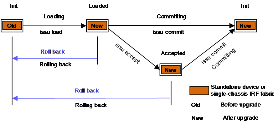

Performing an incremental upgrade on a single-chassis IRF fabric
As shown in Figure 1, the upgrade operates as follows:
1.     The device is in Init state before the upgrade and enters Loading state when the issu load command is executed. When the upgrade completes, the device enters Loaded state.
2.     The device enters Accepted state when the issu accept command is executed successfully to accept the upgrade to a compatible version and delete the automatic rollback timer.
3.     The device enters Committing state when the issu commit command is executed to complete the ISSU upgrade to a compatible version, and it enters Init state when the upgrade completes.
IMPORTANT
IMPORTANT:
If a rollback is performed during the upgrade process, the system will roll back to the version before the upgrade.
Figure 1 Performing an incremental upgrade on a standalone device or a single-chassis IRF fabric

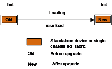

As shown in Figure 2, the device is in Init state before the upgrade and enters Loading state when the issu load command is executed. When the upgrade completes, the device enters Loaded state.
Figure 2 Performing a reboot, ISSU reboot, or incompatible upgrade on a standalone device or single-chassis IRF fabric

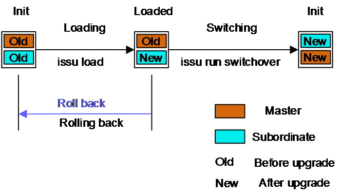

Performing a compatible upgrade on a multichassis IRF fabric
As shown in Figure 3, the upgrade operates as follows:
1.     The device is in Init state before the upgrade and enters Loading state when the issu load command is executed to upgrade a subordinate device in the IRF fabric. When the upgrade completes, the device enters Loaded state.
2.     The device enters Switching state when the issu run switchover command is executed to perform an ISSU switchover. When the switchover completes, the device enters Switchover state.
3.     The device enters Accepted state when the issu accept command is executed successfully to accept the upgrade to a compatible version and delete the automatic rollback timer.
4.     The device enters Committing state when the issu commit command is executed to upgrade all other member devices in the IRF fabric. When the upgrade completes, the device enters Init state.
IMPORTANT
IMPORTANT:
Figure 3 Performing a compatible upgrade on a multichassis IRF fabric

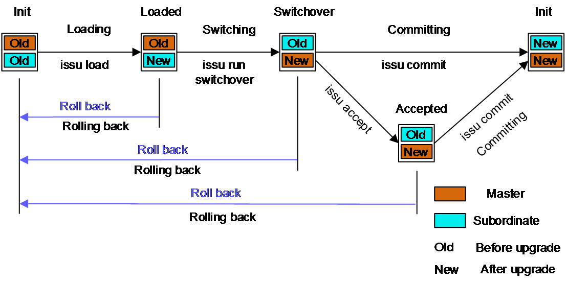

Performing an incompatible upgrade on a multichassis IRF fabric
As shown in Figure 4, the upgrade operates as follows:
2.     The device enters Switching state when the issu run switchover command is executed to perform an ISSU switchover. All the other members will be upgraded. When the switchover completes, the device enters Init state.
IMPORTANT
IMPORTANT:
Figure 4 Performing an incompatible upgrade on a multichassis IRF fabric
Upgrade a subordinate member device first. Then, upgrade the remaining member devices, including the original master.
1.     (Optional.) Configure automatic rollback:
a.     Enter system view.
b.     Set the automatic rollback timer.
issu rollback-timer minutes
By default, the automatic rollback timer is set to 45 minutes.
The automatic rollback timer starts when you execute the issu run switchover command.
c.     Return to user view.
2.     Verify that the system is stable.
display system stable state
The system is stable if the System State field displays Stable. For a successful ISSU, you must make sure the system is stable before you proceed to the next step.
3.     Load the upgrade images as startup images on a subordinate member.
¡     Use .bin files:
issu load file { boot filename | system filename | feature filename&<1-30> | patch filename&<1-30> } * slot slot-number&<1-9> [ reboot ]
¡     Use an .ipe file:
issu load file ipe ipe-filename [ patch filename&<1-30> ] slot slot-number&<1-9> [ reboot ]
The software images for the device are digitally signed. The system verifies the digital signatures of the specified software images for authenticity and integrity before it sets or loads them as main startup images. If the digital signature verification fails, the system will not set or load the specified images as main startup images and you will receive a digital signature verification failure message.
4.     Verify that the system is stable.
The system is stable if the System State field displays Stable. For a successful ISSU, you must make sure the system is stable before you proceed to the next step. If the system reported an error in the previous step, verify that the system is stable and then use the issu rollback command to roll back the upgrade.
5.     Perform an ISSU switchover.
issu run switchover
This command also starts the automatic rollback timer. When the timer expires, the system automatically rolls back to the original software images.
6.     (Optional.) Accept the upgrade and delete the automatic rollback timer.
issu accept
Execute this command before the automatic rollback timer expires.
7.     Verify that the system is stable.
The system is stable if the System State field displays Stable. For a successful ISSU, you must make sure the system is stable before you proceed to the next step. If the system reported an error in the previous two steps, verify that the system is stable and then use the issu rollback command to roll back the upgrade.
8.     Upgrade the remaining members to complete the ISSU.
issu commit slot slot-number
Execute this command before the automatic rollback timer expires. After you execute this command for one member device, wait for the member device to start up and join the IRF fabric again before you upgrade another member device.
CAUTION
CAUTION:
Repeat the previous step and this step to upgrade the remaining member devices, including the original master device. After you execute this command for one member device, wait for the member device to start up and join the IRF fabric again before you upgrade another member device. This practice ensures a successful ISSU.
9.     Verify that the ISSU is finished.
display issu state
If the ISSU state field displays Init, the ISSU is finished.
Upgrade one or more subordinate member devices first. Then, upgrade the remaining member devices, including the original master.
To perform an incompatible upgrade on a multichassis IRF fabric, execute the following commands in user view:
1.     Verify that the system is stable.
2.     Load the upgrade images as startup images on subordinate members.
¡     Use .bin files:
¡     Use an .ipe file:
As a best practice on a ring-topology IRF fabric, specify half of the subordinate members for this command to reduce service interruption. Make sure the specified subordinate members are physically connected.
3.     Verify that the system is stable.
4.     Perform an ISSU switchover to complete the ISSU process.
issu run switchover
This command upgrades the remaining members.
5.     Verify that the ISSU is finished.
display issu state
To perform an incremental upgrade on a single-chassis IRF fabric, execute the following commands in user view:
2.     Load the upgrade images as startup images.
¡     Use .bin files:
issu load file { boot filename | system filename | feature filename&<1-30> | patch filename&<1-30> } * slot slot-number [ reboot ]
¡     Use an .ipe file:
issu load file ipe ipe-filename [ patch filename&<1-30> ] slot slot-number [ reboot ]
4.     Complete the ISSU process.
CAUTION
CAUTION:
When this command is completed, the ISSU status changes to Init and the ISSU process cannot be rolled back.
display issu state
