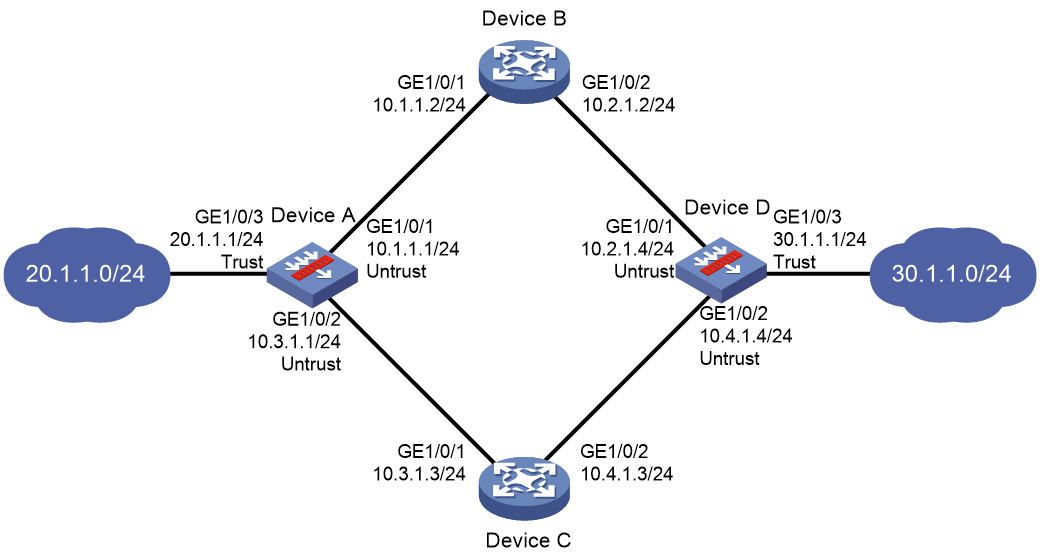

Example: Configuring static routing-Track-NQA collaboration
As shown in Figure 2:
·     Device A is the default gateway of the hosts in network 20.1.1.0/24.
·     Device D is the default gateway of the hosts in network 30.1.1.0/24.
·     Hosts in the two networks communicate with each other through static routes.
To ensure network availability, configure route backup and static routing-Track-NQA collaboration on Device A and Device D as follows:
·     On Device A, assign a higher priority to the static route to 30.1.1.0/24 with next hop Device B. This route is the master route. The static route to 30.1.1.0/24 with next hop Device C acts as the backup route. When the master route is unavailable, the backup route takes effect.
·     On Device D, assign a higher priority to the static route to 20.1.1.0/24 with next hop Device B. This route is the master route. The static route to 20.1.1.0/24 with next hop Device C acts as the backup route. When the master route is unavailable, the backup route takes effect.
Figure 2 Network diagram

Example: Configuring static routing-Track-BFD collaboration
As shown in Figure 3:
·     Device B is the default gateway of the hosts in network 30.1.1.0/24.
To ensure network availability, configure route backup and static routing-Track-BFD collaboration on Device A and Device B as follows:
·     On Device A, assign a higher priority to the static route to 30.1.1.0/24 with next hop Device B. This route is the master route. The static route to 30.1.1.0/24 with next hop Device C acts as the backup route. When the master route is unavailable, BFD can quickly detect the route failure to make the backup route take effect.
·     On Device B, assign a higher priority to the static route to 20.1.1.0/24 with next hop Device A. This route is the master route. The static route to 20.1.1.0/24 with next hop Device C acts as the backup route. When the master route is unavailable, BFD can quickly detect the route failure to make the backup route take effect.
Figure 3 Network diagram
Configuring Device A
1.     Assign IP addresses to interfaces:
# Assign an IP address to interface GigabitEthernet 1/0/1.
<DeviceA> system-view
[DeviceA-GigabitEthernet1/0/1] ip address 10.2.1.1 255.255.255.0
[DeviceA-GigabitEthernet1/0/1] quit
2.     Configure settings for routing:
# Configure a main static route to 30.1.1.0/24 with next hop 10.2.1.2 and default priority 60, and associate the static route with track entry 1.
[DeviceA] ip route-static 30.1.1.0 24 10.2.1.2 track 1
# Configure a backup static route to 30.1.1.0/24 with next hop 10.3.1.3 and priority 80.
[DeviceA] ip route-static 30.1.1.0 24 10.3.1.3 preference 80
3.     Add interfaces to security zones.
[DeviceA] security-zone name untrust
[DeviceA-security-zone-Untrust] import interface gigabitethernet 1/0/1
[DeviceA-security-zone-Untrust] import interface gigabitethernet 1/0/2
[DeviceA-security-zone-Untrust] quit
[DeviceA] security-zone name trust
[DeviceA-security-zone-Trust] import interface gigabitethernet 1/0/3
[DeviceA-security-zone-Trust] quit
4.     Configure a security policy:
# Configure a rule named trust-untrust to permit packets from network 20.1.1.0/24 to network 30.1.1.0/24.
[DeviceA] security-policy ip
[DeviceA-security-policy-ip] rule name trust-untrust
[DeviceA-security-policy-ip-1-trust-untrust] source-zone trust
[DeviceA-security-policy-ip-1-trust-untrust] destination-zone untrust
[DeviceA-security-policy-ip-1-trust-untrust] source-ip-subnet 20.1.1.0 24
[DeviceA-security-policy-ip-1-trust-untrust] destination-ip-subnet 30.1.1.0 24
[DeviceA-security-policy-ip-1-trust-untrust] action pass
[DeviceA-security-policy-ip-1-trust-untrust] quit
# Configure a rule named untrust-trust to permit packets from network 30.1.1.0/24 to network 20.1.1.0/24.
[DeviceA-security-policy-ip] rule name untrust-trust
[DeviceA-security-policy-ip-2-untrust-trust] source-zone untrust
[DeviceA-security-policy-ip-2-untrust-trust] destination-zone trust
[DeviceA-security-policy-ip-2-untrust-trust] source-ip-subnet 30.1.1.0 24
[DeviceA-security-policy-ip-2-untrust-trust] destination-ip-subnet 20.1.1.0 24
[DeviceA-security-policy-ip-2-untrust-trust] action pass
[DeviceA-security-policy-ip-2-untrust-trust] quit
# Configure a rule named bfdlocalout to allow Device A to send BFD echo packets to Device B.
[DeviceA-security-policy-ip] rule name bfdlocalout
[DeviceA-security-policy-ip-3-bfdlocalout] source-zone local
[DeviceA-security-policy-ip-3-bfdlocalout] destination-zone untrust
[DeviceA-security-policy-ip-2-bfdlocalout] service bfd-echo
[DeviceA-security-policy-ip-3-bfdlocalout] action pass
[DeviceA-security-policy-ip-3-bfdlocalout] quit
# Configure a rule named bfdlocalin to allow Device A to receive BFD echo packets.
[DeviceA-security-policy-ip] rule name bfdlocalin
[DeviceA-security-policy-ip-4-bfdlocalin] source-zone untrust
[DeviceA-security-policy-ip-4-bfdlocalin] destination-zone local
[DeviceA-security-policy-ip-2-bfdlocalin] service bfd-echo
[DeviceA-security-policy-ip-4-bfdlocalin] action pass
[DeviceA-security-policy-ip-4-bfdlocalin] quit
# Configure a rule named untrust-untrust to allow Device A to respond to the BFD echo packets from Device B.
[DeviceA-security-policy-ip] rule name untrust-untrust
[DeviceA-security-policy-ip-5-untrust-untrust] source-zone untrust
[DeviceA-security-policy-ip-5-untrust-untrust] destination-zone untrust
[DeviceA-security-policy-ip-5-untrust-untrust] source-ip-host 1.1.1.1
[DeviceA-security-policy-ip-5-untrust-untrust] destination-ip-host 10.2.1.2
[DeviceA-security-policy-ip-5-untrust-untrust] action pass
[DeviceA-security-policy-ip-5-untrust-untrust] quit
# Configure a rule named pinglocalout to allow Device A to send ping packets to Device B.
[DeviceA-security-policy-ip] rule name pinglocalout
[DeviceA-security-policy-ip-6-pinglocalout] source-zone local
[DeviceA-security-policy-ip-6-pinglocalout] destination-zone untrust
[DeviceA-security-policy-ip-6-pinglocalout] service ping
[DeviceA-security-policy-ip-6-pinglocalout] action pass
[DeviceA-security-policy-ip-6-pinglocalout] quit
# Configure a rule named pinglocalin to allow Device A to respond to the ping packets from Device B.
[DeviceA-security-policy-ip] rule name pinglocalin
[DeviceA-security-policy-ip-7-pinglocalin] source-zone untrust
[DeviceA-security-policy-ip-7-pinglocalin] destination-zone local
[DeviceA-security-policy-ip-7-pinglocalin] service ping
[DeviceA-security-policy-ip-7-pinglocalin] action pass
[DeviceA-security-policy-ip-7-pinglocalin] quit
[DeviceA-security-policy-ip] quit
5.     Specify 10.10.10.10 as the source address for BFD echo packets.
[DeviceA] bfd echo-source-ip 10.10.10.10
6.     Configure track entry 1, and associate it with the BFD session to verify the connectivity between Device A and Device B.
[DeviceA] track 1 bfd echo interface gigabitethernet 1/0/1 remote ip 10.2.1.2 local ip 10.2.1.1
[DeviceA-track-1] quit

10.2.1.1/32         Direct 0    0            127.0.0.1       InLoop0
10.3.1.0/24         Direct 0    0            10.3.1.1        GE1/0/2
10.3.1.1/32         Direct 0    0            127.0.0.1       InLoop0
20.1.1.0/24         Direct 0    0            20.1.1.1        GE1/0/3
20.1.1.1/32         Direct 0    0            127.0.0.1       InLoop0
30.1.1.0/24         Static 80   0            10.3.1.3        GE1/0/2
127.0.0.0/8         Direct 0    0            127.0.0.1       InLoop0
127.0.0.1/32        Direct 0    0            127.0.0.1       InLoop0
The output shows that Device A forwards packets to 30.1.1.0/24 through Device C. The backup static route has taken effect.
# Verify that the hosts in 20.1.1.0/24 can communicate with the hosts in 30.1.1.0/24 when the master route fails.
[DeviceA] ping -a 20.1.1.1 30.1.1.1
Ping 30.1.1.1: 56  data bytes, press CTRL_C to break
Reply from 30.1.1.1: bytes=56 Sequence=1 ttl=254 time=2 ms
Reply from 30.1.1.1: bytes=56 Sequence=2 ttl=254 time=1 ms
Reply from 30.1.1.1: bytes=56 Sequence=3 ttl=254 time=1 ms
Reply from 30.1.1.1: bytes=56 Sequence=4 ttl=254 time=2 ms
Reply from 30.1.1.1: bytes=56 Sequence=5 ttl=254 time=1 ms
--- Ping statistics for 30.1.1.1 ---
5 packet(s) transmitted, 5 packet(s) received, 0.00% packet loss
round-trip min/avg/max/std-dev = 1/1/2/1 ms
# Verify that the hosts in 30.1.1.0/24 can communicate with the hosts in 20.1.1.0/24 when the master route fails.
[DeviceB] ping -a 30.1.1.1 20.1.1.1
Ping 20.1.1.1: 56  data bytes, press CTRL_C to break
Reply from 20.1.1.1: bytes=56 Sequence=1 ttl=254 time=2 ms
Reply from 20.1.1.1: bytes=56 Sequence=2 ttl=254 time=1 ms
Reply from 20.1.1.1: bytes=56 Sequence=3 ttl=254 time=1 ms
Reply from 20.1.1.1: bytes=56 Sequence=4 ttl=254 time=1 ms
Reply from 20.1.1.1: bytes=56 Sequence=5 ttl=254 time=1 ms
--- Ping statistics for 20.1.1.1 ---
