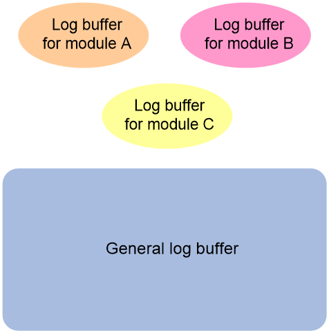

This feature enables log output to log buffers based on the log source modules. Log buffers include the following types:
·     Separate module-specific log buffers—Logs generated by modules that have separate log buffers are saved to their respective log buffers.
For example, session logs and attack defense logs are saved to the session log buffer and the attack defense log buffer, respectively. With separate buffers, you can manage and view the module-specific logs and general logs conveniently.
The modules that have separate log buffers are determined by factory settings. To view the names of supported modules, use the display logbuffer module ? command. You can use the display logbuffer module module-name command to view buffered logs of the specified module.
·     General log buffer—Logs generated by the system and the modules other than the modules that have separate log buffers are saved to the general log buffer.
You can use the display logbuffer command without the module keyword to view buffered logs in the general log buffer.
Figure 2 General log buffer and separate module-specific log buffers

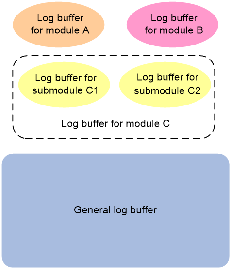

·     Separate module-specific or submodule-specific log buffers—Logs generated by modules and submodules that have separate log buffers are saved to their respective log buffers.
For example, session logs and attack defense logs are saved to the session log buffer and the attack defense log buffer, respectively. With separate buffers, you can manage and view the module-specific or submodule-specific logs and general logs conveniently.
The modules and submodules that have separate log buffers are determined by factory settings. To view the names of supported modules, use the display logbuffer module ? command. To view the names of supported submodules, use the display logbuffer module module-name submodule ? command. You can use the display logbuffer module module-name command to view buffered logs of the specified module. You can use the display logbuffer module module-name submodule submodule-name command to view buffered logs of the specified submodule.
·     General log buffer—Logs generated by the system and the modules or submodules other than the modules or submodules that have separate log buffers are saved to the general log buffer.
Figure 3 General log buffer and separate module-specific or submodule-specific log buffers
