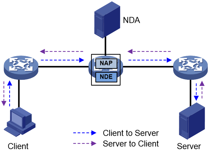

NetAnalysis architecture
A typical NetAnalysis system consists of the following elements:
·     NetAnalysis data exporter (NDE)—Typically, the device CPU chip serves as an NDE. The NDE uses ACL rules to filter out service traffic that requires further analysis. Once the NDE identifies the data flows that match an ACL rule, it sends them to a NetAnalysis processor for further analysis and processing.
·     NetAnalysis processor (NAP)—An application running on an operating system. The NAP receives, processes, and analyzes data flows sent from the NDE. Then, it sends the results to a NetAnalysis data analyzer.
·     NetAnalysis data analyzer (NDA)—A network traffic analysis tool that provides a Web interface for obtaining, displaying, and analyzing service flow data.

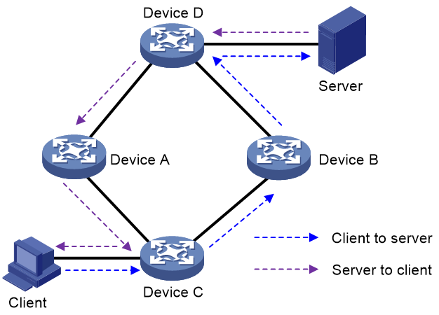

As shown in Figure 1, when a service flow passes through multiple devices, if its return traffic is forwarded along the same path, all devices on the path can obtain bidirectional traffic of the service flow. This enables the devices to analyze the flow to obtain performance statistics such as packet loss rate and latency.
Typically, an NDE and an NAP are collocated on a device.

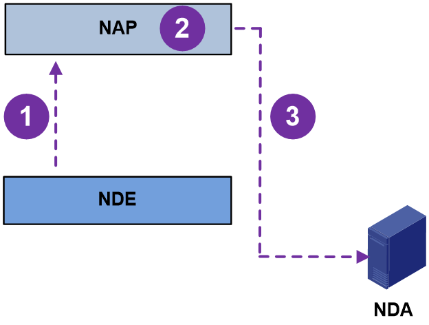

NetAnalysis workflow
As shown in Figure 2, NetAnalysis works as follows:
1.     The NDE uses ACL rules to match service flows and replicates the service flows that match an ACL rule to the NAP.
2.     The NAP creates a flow table for each received service flow to analyze it if the service flow satisfies connection setup requirements. The NAP drops a service flow if the service flow does not meet the connection setup  requirements or the NAP is overloaded. For the connection setup procedure, see "CM connection setup."
3.     The NAP encapsulates the analysis results into packets and forwards the packets to the NDA for analysis and display.

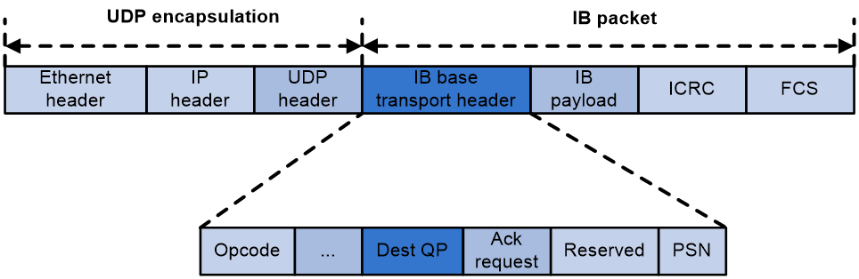

RoCEv2 packet format
RoCEv2 is a network layer protocol that enables Layer 3 communication between broadcast domains. RoCEv2 encapsulates packets based on the UDP encapsulation. Figure 3 shows the format of an RoCEv2 packet.
Figure 3 RoCEv2 packet format
An RoCEv2 packet contains the following fields:
·     Ethernet header—Includes the source and destination MAC addresses.
·     IP header—Includes the source and destination IP addresses.
·     UDP header—Includes the source and destination port numbers. The destination port number is fixed at 4791.
·     InfiniBand base transport header—Includes key fields monitored by NetAnalysis.
·     IB payload.
·     ICRC and FCS.
The InfiniBand base transport header contains the following fields:
·     Opcode—RoCEv2 packet type indicating the operation mode. Available values for this field include the following:
¡     ConnectMsg—The packet is used for setting up an RoCEv2 connection. The connection is called a communication management (CM) connection. Devices in an RoCEv2 network transmit data packets through CM connections.
¡     Send—The packet is sent to the remote end without specifying where the receiver stores data.
¡     Write—The packet carries the address, key, and length of data to be written to the remote end.
¡     Read—The packet carries the address, key, and length of data to be read from the remote end. RoCEv2 packets of the Send, Write, and Read types are analyzed during throughput analysis.
¡     ACK—The packet is a response message returned by the receiver. Based on the ACK extended transport header unique to RoCEv2 ACK packets, an ACK packet can be one of the following types:
-     Common ACK packet indicating that data is received successfully.
-     NAK packet that indicates packet loss.
·     Dest QP—Destination QP that identifies an RoCEv2 flow. This field is similar to the destination port number. It is a key value used by NetAnalysis to create an RoCEv2 flow table.
·     PSN—Sequence number of the RoCEv2 packet. Packet loss is determined by checking whether the PSNs of packets are consecutive. If packet loss occurs, the receiver returns an NAK packet.

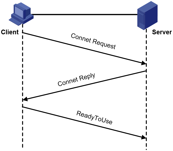

CM connection setup
RDMA sets up CM connections based on RoCE packets or TCP packets with custom fields. NetAnalysis can analyze the RoCE packets and TCP packets used for CM connection setup. The analysis process does not differ much between the packet types. The following information uses RoCE packet-based CM connection setup as an example.
Figure 4 CM connection setup process
As shown in Figure 4, a CM connection is setup as follows:
1.     The client sends a Connect Request packet to the server for requesting RoCEv2 connection setup.
2.     Upon receiving the Connect Request packet, the server returns a Connect Reply packet for confirming RoCEv2 connection setup. Upon receiving the Connect Reply packet, the client determines that an RoCEv2 connection has been set up with the server.
3.     The client sends a ReadyToUse packet to the server for confirming that the connection is ready. Upon receiving the packet, the server determines that the CM connection is set up successfully.

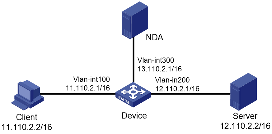

As shown in Figure 5, NetAnalysis can use either of the following modes for RoCEv2 traffic analysis when multiple paths exist between an RoCEv2 client and an RoCEv2 server:
·     Bidirectional mode—NetAnalysis monitors bidirectional traffic sent between the server and the client. Based on the 4-tuple information in CM connection setup packets, NetAnalysis can collect RoCEv2 traffic statistics based on sessions and provide the session-specific RTT and lost packet count.
·     Unidirectional mode—NetAnalysis monitors the traffic sent from the client to the server to obtain the 3-tuple information used for creating RoCEv2 flow entries. In this mode, NetAnalysis collects RoCEv2 traffic statistics based on flows and provides only packet throughput information.
As a best practice to ensure correct RoCEv2 traffic analysis, configure the mode of RoCEv2 traffic analysis as follows:
·     Enable bidirectional mode on the devices attached to the server and the client (Device C and Device D).
·     Enable unidirectional mode on the intermediate devices (Device A and Device B).
Figure 5 Mode of RoCEv2 traffic analysis

Example: Configuring NetAnalysis to analyze RoCEv2 traffic
As shown in Figure 6, configure NetAnalysis on the device to analyze the bidirectional RoCEv2 traffic sent between the server and the client and output the RoCEv2 traffic statistics to the NDA.
Figure 6 Network diagram
1.     Assign an IP address to each interface, as shown in Figure 6. (Details not shown.)
2.     Configure NetAnalysis to analyze RoCEv2 traffic:
# Enable bidirectional RoCEv2 traffic analysis.
<Device> system-view
[Device] netanalysis rocev2 mode bidir
# Enable global RoCEv2 traffic statistics collection.
[Device] netanalysis rocev2 statistics global
# Display configuration and status of the RoCEv2 cache after the device has been operating for a period of time.
[Device] display netanalysis rocev2 cache
S2D: source to destination              D2S: destination to source
RTT: round trip time                    RPT: packet throughput in read mode
WPT: packet throughput in write mode    SPT: packet throughput in send mode
I: input          O: output             L: local          R: remote
NetAnalysis cache information:
Flow created at        Service type
Src IP                 Src QP        S2D RTT      S2D RPT      S2D SPT/WPT
S2D NAK Pkts           S2D Interface(I)           S2D Interface(O)
S2D Src VXLAN ID       S2D Dst VXLAN ID
Dst IP                 Dst QP        D2S RTT      D2S RPT      D2S SPT/WPT
D2S NAK Pkts           D2S Interface(I)           D2S Interface(O)
D2S Src VXLAN ID       D2S Dst VXLAN ID
01/22/2019 09:08:15    RC
11.110.2.2             93309         50           11           11
2                      Vlan-int100(L)             Vlan-int200(L)
10                     10
12.110.2.2             85353         50           11           11
8373                   Vlan-int200(L)             Vlan-int100(L)
10                     10
# Display RoCEv2 traffic statistics.
[Device] display netanalysis rocev2 statistics
Last statistics resetting time: Never
Received packets: 1833088
Type
         Active         Aged           Created         Reported
        (Sessions)     (Sessions)     (Sessions)      (Sessions)
RoCEv2
        2               0               2              10
