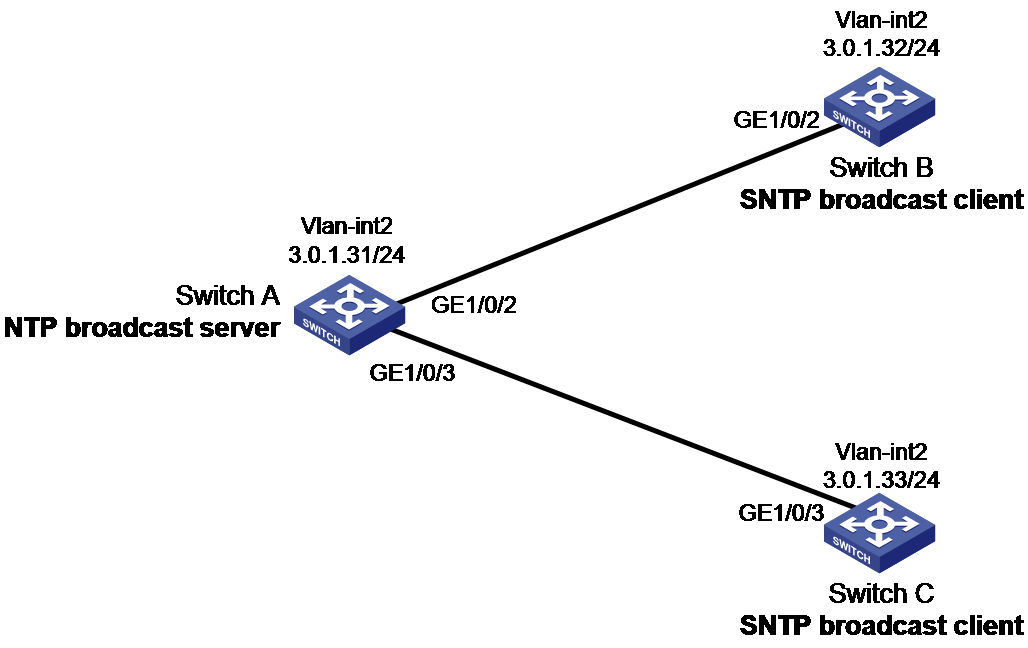

NTP working mechanism
Figure 1 shows how NTP synchronizes the system time between two devices (Device A and Device B, in this example). Assume that:
·     Prior to the time synchronization, the time is set to 10:00:00 am for Device A and 11:00:00 am for Device B.
·     Device B is used as the NTP server. Device A is to be synchronized to Device B.
·     It takes 1 second for an NTP message to travel from Device A to Device B, and from Device B to Device A.
·     It takes 1 second for Device B to process the NTP message.
Figure 1 Basic work flow
The synchronization process is as follows:
1.     Device A sends Device B an NTP message, which is timestamped when it leaves Device A. The time stamp is 10:00:00 am (T1).
2.     When this NTP message arrives at Device B, Device B adds a timestamp showing the time when the message arrived at Device B. The timestamp is 11:00:01 am (T2).
3.     When the NTP message leaves Device B, Device B adds a timestamp showing the time when the message left Device B. The timestamp is 11:00:02 am (T3).
4.     When Device A receives the NTP message, the local time of Device A is 10:00:03 am (T4).
Up to now, Device A can calculate the following parameters based on the timestamps:
·     The roundtrip delay of the NTP message: Delay = (T4 – T1) – (T3 – T2) = 2 seconds.
·     Time difference between Device A and Device B: Offset = [ (T2 – T1) + (T3 – T4) ] /2 = 1 hour.
Based on these parameters, Device A can be synchronized to Device B.
This is only a rough description of the work mechanism of NTP. For more information, see the related protocols and standards.

Example: Configuring NTP client/server association mode
As shown in Figure 4, perform the following tasks:
·     Configure Device A's local clock as its reference source, with stratum level 2.
·     Configure Device B to operate in client mode and specify Device A as the NTP server of Device B.
Figure 4 Network diagram
1.     Assign an IP address to each interface, and make sure Device A and Device B can reach each other, as shown in Figure 4. (Details not shown.)
2.     Configure Device A:

Example: Configuring NTP broadcast association mode
As shown in Figure 8, configure Switch C as the NTP server for multiple devices on the same network segment so that these devices synchronize the time with Switch C.
·     Configure Switch C's local clock as its reference source, with stratum level 2.
·     Configure Switch C to operate in broadcast server mode and send broadcast messages from VLAN-interface 2.
·     Configure Switch A and Switch B to operate in broadcast client mode, and listen to broadcast messages on VLAN-interface 2.
Figure 8 Network diagram
1.     Assign an IP address to each interface, and make sure Switch A, Switch B, and Switch C can reach each other, as shown in Figure 8. (Details not shown.)
2.     Configure Switch C:

Example: Configuring NTP multicast association mode
As shown in Figure 9, configure Switch C as the NTP server for multiple devices on different network segments so that these devices synchronize the time with Switch C.
·     Configure Switch C to operate in multicast server mode and send multicast messages from VLAN-interface 2.
·     Configure Switch A and Switch D to operate in multicast client mode and receive multicast messages on VLAN-interface 3 and VLAN-interface 2, respectively.
Figure 9 Network diagram
1.     Assign an IP address to each interface, and make sure the switches can reach each other, as shown in Figure 9. (Details not shown.)

5.     Configure Switch B:
Because Switch A and Switch C are on different subnets, you must enable the multicast functions on Switch B before Switch A can receive multicast messages from Switch C.
# Enable IP multicast functions.
<SwitchB> system-view
[SwitchB] multicast routing
[SwitchB-mrib] quit
[SwitchB-Vlan-interface2] pim dm
[SwitchB-Vlan-interface2] quit
[SwitchB] vlan 3
[SwitchB-vlan3] port ten-gigabitethernet 3/0/1
[SwitchB-vlan3] quit
[SwitchB] interface vlan-interface 3
[SwitchB-Vlan-interface3] igmp enable
[SwitchB-Vlan-interface3] igmp static-group 224.0.1.1
[SwitchB-Vlan-interface3] quit
[SwitchB] igmp-snooping
[SwitchB-igmp-snooping] quit
[SwitchB] interface ten-gigabitethernet 3/0/1
[SwitchB-Ten-GigabitEthernet3/0/1] igmp-snooping static-group 224.0.1.1 vlan 3
6.     Configure Switch A:

Example: Configuring NTP authentication in broadcast association mode
As shown in Figure 12, configure Switch C as the NTP server for multiple devices on the same network segment so that these devices synchronize the time with Switch C. Configure Switch A and Switch B to authenticate the NTP server.
·     Configure Switch C's local clock as its reference source, with stratum level 3.
·     Configure Switch A and Switch B to operate in broadcast client mode and receive broadcast messages on VLAN-interface 2.
·     Enable NTP authentication on Switch A, Switch B, and Switch C.
Figure 12 Network diagram
1.     Assign an IP address to each interface, and make sure Switch A, Switch B, and Switch C can reach each other, as shown in Figure 12. (Details not shown.)

5.     Verify the configuration:
NTP authentication is enabled on Switch A and Switch B, but not on Switch C, so Switch A and Switch B cannot synchronize their local clocks to Switch C.
[SwitchB-Vlan-interface2] display ntp-service status
 Clock status: unsynchronized
 Clock stratum: 16
 Reference clock ID: none

Example: Configuring SNTP in broadcast association mode
As shown in Figure 14, configure Switch A as the NTP broadcast server to provide NTP clock synchronization for other devices on the LAN.
·     On Switch A, configure the local clock as the reference source, with stratum level 2.
·     Configure Switch A to operate in broadcast server mode and send broadcast messages from VLAN-interface 2.
·     Configure Switch B and Switch C to operate in broadcast client mode, and listen to broadcast messages on VLAN-interface 2.
Figure 14 Network diagram
