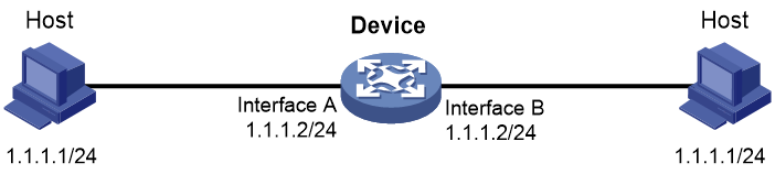

ARP operating mechanism
As shown in Figure 2, Host A and Host B are on the same subnet. Host A sends a packet to Host B as follows:
1. Host A looks through the ARP table for an ARP entry for Host B. If one entry is found, Host A uses the MAC address in the entry to encapsulate the IP packet into a data link layer frame. Then Host A sends the frame to Host B.
2. If Host A finds no entry for Host B, Host A buffers the packet and broadcasts an ARP request. The payload of the ARP request contains the following information:
¡ Sender IP address and sender MAC address—Host A's IP address and MAC address.
¡ Target IP address—Host B's IP address.
¡ Target MAC address—An all-zero MAC address.
All hosts on this subnet can receive the broadcast request, but only the requested host (Host B) processes the request.
3. Host B compares its own IP address with the target IP address in the ARP request. If they are the same, Host B operates as follows:
a. Adds the sender IP address and sender MAC address into its ARP table.
b. Encapsulates its MAC address into an ARP reply.
c. Unicasts the ARP reply to Host A.
4. After receiving the ARP reply, Host A operates as follows:
a. Adds the MAC address of Host B into its ARP table.
b. Encapsulates the MAC address into the packet and sends the packet to Host B.
Figure 2 ARP address resolution process
If Host A and Host B are on different subnets, Host A sends a packet to Host B as follows:
1. Host A broadcasts an ARP request where the target IP address is the IP address of the gateway.
2. The gateway responds with its MAC address in an ARP reply to Host A.
3. Host A uses the gateway's MAC address to encapsulate the packet, and then sends the packet to the gateway.
4. If the gateway has an ARP entry for Host B, it forwards the packet to Host B directly. If not, the gateway broadcasts an ARP request, in which the target IP address is the IP address of Host B.
5. After the gateway gets the MAC address of Host B, it sends the packet to Host B.

As shown in Figure 3, Interface A and Interface B on the device has the same IP address, because Interface A borrows the IP address of Interface B. The host can move from interface A to interface B without changing its IP address (1.1.1.1 in this example.)
When the host connects to Interface A, the device learns an ARP entry in which the IP address is 1.1.1.1 and the output interface is Interface A. After the host moves to Interface B, the device learns a new ARP entry in which the IP address is 1.1.1.1 and the output interface is Interface B.
This will cause loss of packets destined for the host, because the FIB entry for the host is generated based on the ARP entry generated earlier for it. The output interface in the FIB entry is different from the actual interface to which the host is attached after its movement.
With unique ARP entry learning enabled, the device deletes the existing ARP entry for an IP address when it learns a new ARP entry with a different interface than the existing entry for that IP address. This ensures that the output interface in the FIB entry for the client is the one to which the endpoint is attached.

Common proxy ARP configuration example
Example: Configuring common proxy ARP
As shown in Figure 6, Host A and Host D have the same prefix and mask, but they are located on different subnets. No default gateway is configured on Host A and Host D.
Configure common proxy ARP on the router to ensure communication between Host A and Host D.
# Configure the IP address of HundredGigE 1/0/2.
<Router> system-view
[Router] interface hundredgige 1/0/2
[Router-HundredGigE1/0/2] ip address 192.168.10.99 255.255.255.0
# Enable common proxy ARP on HundredGigE 1/0/2.
[Router-HundredGigE1/0/2] proxy-arp enable
[Router-HundredGigE1/0/2] quit
# Configure the IP address of HundredGigE 1/0/1.
[Router] interface hundredgige 1/0/1
[Router-HundredGigE1/0/1] ip address 192.168.20.99 255.255.255.0
# Enable common proxy ARP on HundredGigE 1/0/1.
[Router-HundredGigE1/0/1] proxy-arp enable
[Router-HundredGigE1/0/1] quit
# Verify that Host A and Host D can ping each other.
