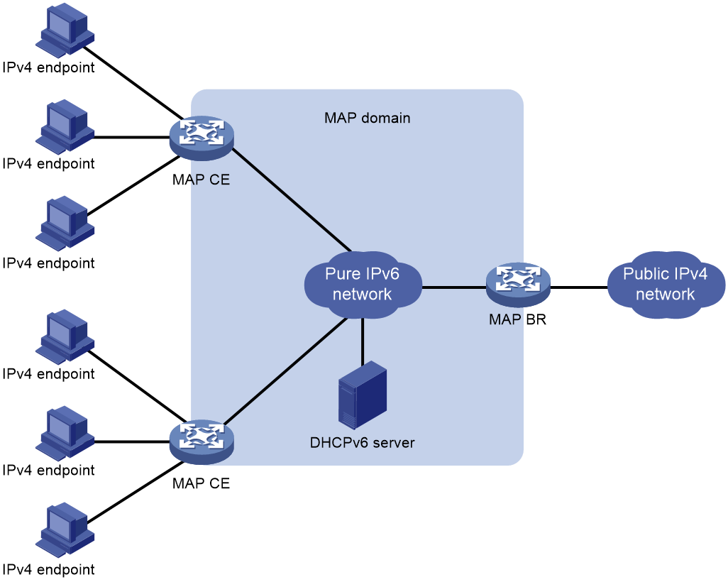

As shown in Figure 1, the network deployed with MAP-E has MAP CEs and a MAP BR. MAP CEs serve as the service access points for private IPv4 users and the MAP BR acts as the edge node between the IPv4 network and the IPv6 network. The MAP CEs and MAP BR make up a MAP domain. In the same MAP domain, the MAP CEs and MAP BR share the same IPv6 prefix, IPv4 prefix, BMR, and FMR.
IMPORTANT
IMPORTANT:
·     H3C devices can only operate as MAP CEs.
·     A MAP domain can have only one MAP BR.

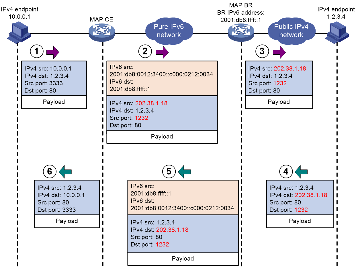

Packet processing flow
Figure 2 shows the packet processing flow of MAP-E.
1.     A private IPv4 user sends a packet to a public IPv4 user.
2.     After the MAP CE receives the packet, the NAT and tunnel modules of the MAP CE perform the following tasks:
a.     The NAT module translates the private source IP address and source port number in the IPv4 packet to a public address and port number.
b.     The tunnel module calculates the IPv6 address corresponding to the public source IPv4 address and source port number based on the BMR. Then, it encapsulates the IPv4 packet with an IPv6 packet header, in which the source IPv6 address is the calculated IPv6 address and the destination IPv6 address is the IPv6 address of the BR.
3.     After the MAP BR receives the IPv6 packet, the tunnel module checks the source IPv6 address and port in the packet. If the packet passes the check, the tunnel module removes the IPv6 packet header to obtain the original IPv4 packet. Then, the forwarding module forwards the IPv4 packet to the public IPv4 network side based on an IPv4 route.
4.     The public IPv4 user sends a response to the private IPv4 network side.
5.     After the MAP BR receives the IPv4 packet, the tunnel module calculates the IPv6 address corresponding to the destination IPv4 address and destination port number based on the BMR. Then, it encapsulates the IPv4 packet with an IPv6 packet header, in which the destination IPv6 address and source IPv6 address are the calculated IPv6 address and IPv6 address of the MAP BR, respectively.
6.     After the MAP CE receives the IPv6 packet, the tunnel module removes the IPv6 packet header to obtain the original IPv4 packet. The NAT module looks up the address mapping table and translates the destination IP address and destination port number in the IPv4 packet. Then, the forwarding module forwards the IPv4 packet to the private IPv4 network side based on an IPv4 route.

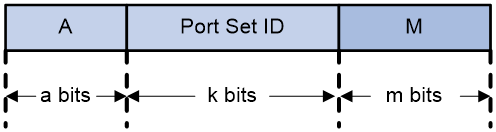

MAP divides a 16-bit transport layer port number into the following parts:
·     A—PSID offset, which is the number of PSID offset bits. The default value is 6. The PSID offset avoids conflicts with well-known port numbers in the range of 0 to 1023.
·     PSID—The length (k) of a PSID determines the sharing ratio (R), which equals to 2k. Transport layer ports are divided into 2k sets and each set contains a group of consecutive port numbers. Each MAP CE has a unique port set.
·     M—The length (m) of this field determines the number of consecutive ports in the port set, which is 2m.
Consequently, a total of 2k port sets are obtained. A PSID uniquely identifies a port set. Each port set contains a number of ((2A)-1)×(2m) ports.

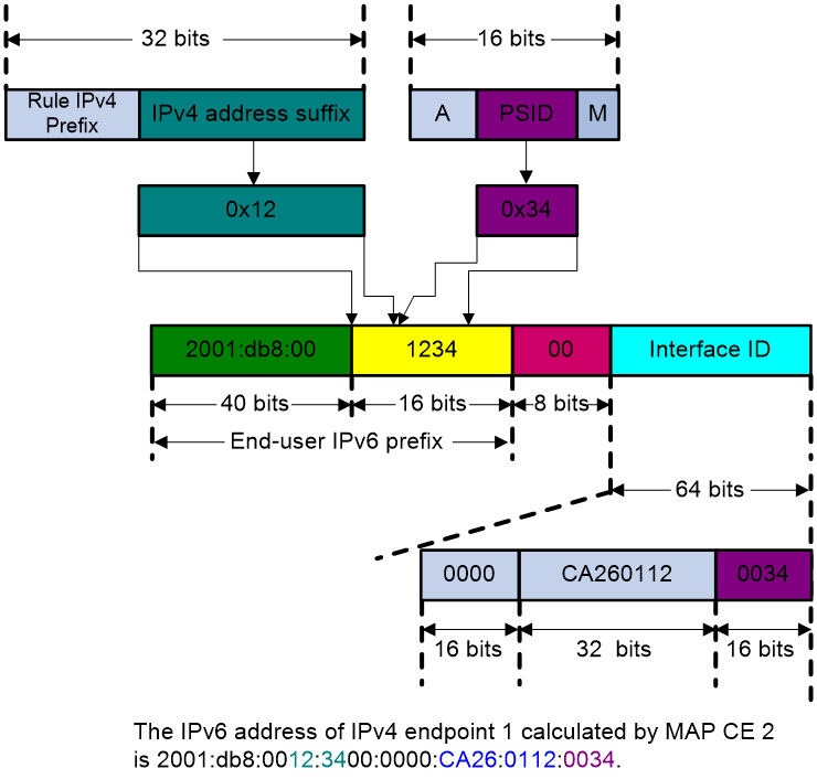

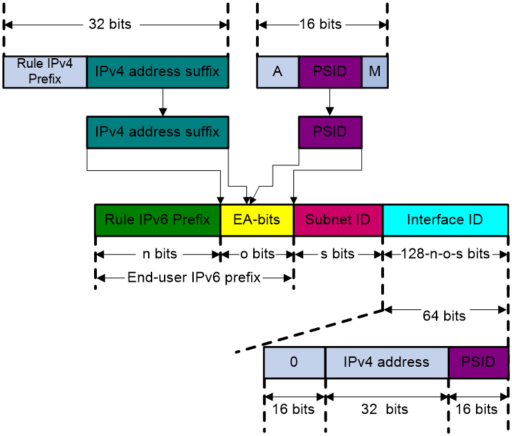

Address mapping mechanism
The MAP CE maps the translated IPv4 address and port number of the original IPv4 packet to an IPv6 address based on the mapping rule, as shown in Figure 4. The IPv6 address contains the Rule IPv6 prefix, EA, Subnet ID, and Interface ID fields. The mapping rule establishes a strong connection between the IPv4 address and port information and the IPv6 address to perform a stateless mapping. This protects the MAP BR from maintaining the mapping between the IPv6 and IPv4 addresses.
·     Rule IPv6 prefix—IPv6 prefix assigned to the MAP CE by the DHCPv6 server.
·     Subnet ID—ID of the first subnet. The value for s is 0.
·     EA—A combination of the IPv4 suffix and the value of the transport layer port's PSID.
·     Interface ID—A combination of an IPv4 address and PSID value.
¡     IPv4 address—If the DHCPv6 server assigns a shared IPv4 address or a dedicated IPv4 address to the MAP CE, the value is the assigned 32-bit IPv4 address. If the DHCPv6 server assigns a Rule IPv4 prefix to the MAP CE, the value for this field is right-padded with 0s to create a 32-bit field. For example, if the Rule IPv4 prefix is 2.1.1.0/29, the value for this field is 0x02010100 (hexadecimal).
¡     PSID—If the PSID value extracted from the EA-bits is less than 16 bits, it is left-padded with 0s to create a 16-bit field. For example, if the PSID value extracted from the EA-bits is 0xAC, the value for this field is 0x00AC. If the DHCPv6 server assigns a Rule IPv4 prefix or a dedicated IPv4 address, no PSID value can be extracted. The value for this field is 0x0000.

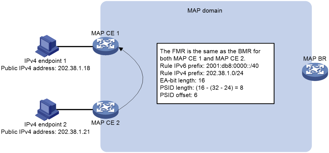

MAP rules
MAP-E rules contain BMRs and FMRs. BMRs are required and FMRs are optional.
·     BMR—Describes the mapping between an IPv6 address and an IPv4 address+port. A MAP CE uses a BMR to perform NAT44 on IPv4 packets and encapsulates the translated IPv4 packets with an IPv6 packet header. A MAP BR uses a BMR to decapsulate IPv6 packets and encapsulate the returned packets with an IPv6 packet header, and then forwards the packets to MAP CEs based on an IPv6 route in the MAP domain.
·     FMR—Used to implement direct communication between MAP CEs in a MAP domain without MAP BRs. In a MAP domain, when a MAP CE accesses another MAP CE, the source IPv6 address is the IPv6 address calculated by the MAP CE through BMR, and the destination IPv6 address is the address of the peer MAP CE. An FMR is used by the MAP CE to calculate the IPv6 address of the peer MAP CE, which is used as the destination IPv6 address. At present, the FMR must be the same as the BMR.
As shown in Figure 5, MAP CE 1, MAP CE 2, and MAP BR reside in the same MAP domain. MAP CE 1 and MAP CE 2 have the same BMR and the FMR is the same as the BMR.
Figure 5 Accessing MAP CE 1 from MAP CE 2 by using an FMR
When IPv4 endpoint 2 accesses IPv4 endpoint 1 by using the public IPv4 address and port number of IPv4 endpoint 1, MAP CE 2 encapsulates the original IPv4 packet sent by IPv4 endpoint 2 with an IPv6 header as follows:
1.     MAP CE 2 calculates the IPv6 address of IPv4 endpoint 2 based on the translated public source IPv4 address and source port number information of IPv4 endpoint 2 and the BMR.
2.     MAP CE 2 calculates the IPv6 address of IPv4 endpoint 1 based on the public IPv4 address and port number information of IPv4 endpoint 1 and the FMR.
Figure 6 shows the calculation process.
Figure 6 Calculating the IPv6 address of IPv4 endpoint 1
3.     MAP-CE 2 encapsulates the original IPv4 packet sent by IPv4 endpoint 2 with an IPv6 packet header. The source IPv6 address and destination IPv6 address in the IPv6 packet header are the IPv6 addresses obtained from steps 1 and 2, respectively.
MAP CE 2 does not send the packet to the MAP BR because the destination IPv6 address in the IPv6 packet header is the IPv6 address of IPv4 endpoint 1.
Similarly, when MAP CE 1 returns a response to MAP CE 2, it also encapsulates the original packet with an IPv6 packet header.

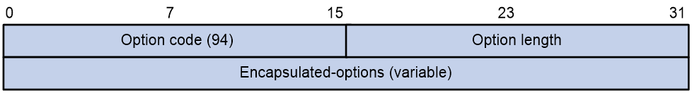

·     Option 94
Option 94, also known as MAP-E Container Option, carries only MAP-E information. Figure 7 shows the format of Option 94.
Figure 7 Format of Option 94
¡     Option code—Option number, which is 94.
¡     Option length—Length of the option, variable.
¡     Encapsulated-options—Sub-options encapsulated in Option 94, including Option 89, Option 90, and Option 93.

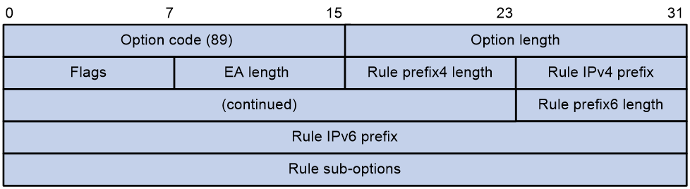

·     Option 89
Option 89, also known as MAP-E Rule Option, is required for Option 94. Figure 8 shows the format of Option 89.
Figure 8 Format of Option 89
¡     Option code—Option number, which is 89.
¡     Flags—Rule identifier.
-     The reserved bit is fixed at 0 at present.
-     The F bit identifies the rule type. Value 1 indicates a BMR and value 0 indicates an FMR.
¡     EA length—Length of the EA-bits.
¡     Rule prefix4 length—IPv4 prefix length.
The EA length and Rule prefix4 length fields jointly determine the type of IP address assigned to the MAP CE.
·     When EA length+Rule prefix4 length<32, the DHCPv6 server assigns an IPv4 prefix (IP address segment) to the CE.
·     When EA length+Rule prefix4 length=32, the DHCPv6 server assigns a dedicated IP address to the CE.
·     When EA length+Rule prefix4 length>32, the DHCPv6 server assigns a shared IP address to the CE.
¡     Rule IPv4 prefix—IPv4 prefix.
¡     Rule prefix6 length—IPv6 prefix length.
¡     Rule IPv6 prefix—IPv6 prefix.
¡     Rule sub-options—Sub-option of the rule, which is Option 93.

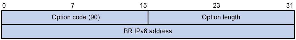

·     Option 90
Option 90, also known as BR Option, is required for Option 94. Figure 9 shows the format of Option 90.
Figure 9 Format of Option 90
¡     Option code—Option number, which is 90.
¡     Option length—Length of the option, which is 16 bytes.
¡     BR IPv6 address—IPv6 address of the BR.

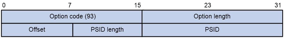

·     Option 93
Option 93, also known as Port Parameters Option, is required for Option 89. Figure 10 shows the format of Option 93.
Figure 10 Format of Option 93
¡     PSID Offset—Offset bits of the PSID.
¡     PSID Len—Length of the PSID.
¡     PSID—PSID value.

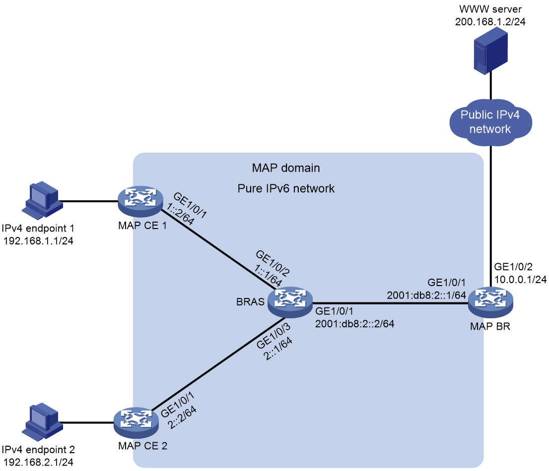

Example: Configuring basic MAP-E
As shown in Figure 11, the MAP CEs connect to the MAP BR through the IPv6 access network, and the MAP BR connects to both the public IPv4 network and the IPv6 access network. The BRAS device, working as a DHCPv6 server, issues the BR IPv6 address and MAP rule to the MAP CEs. Each IPv4 endpoint connects to a MAP CE that performs packet encapsulation and accesses the public IPv4 network resources on subnet 10.0.0.1/24 through the MAP domain or the other IPv4 endpoint in the MAP domain.
The MAP-E information issued by the BRAS device is as follows:
·     In the BMR, the Rule IPv6 Prefix is 2001:DB8:1:64BE::/64, the Rule IPv4 Prefix is 192.0.0.0/24, and the EA length is 16.
·     The BR IPv6 address is 2001:DB8:CAFE::1.
Figure 11 Network diagram
On the BRAS device, configure the settings related to issuing MAP-E information. On the MAP BR, configure the BMR.
1.     Configure MAP CE 1.
# Create a tunnel interface in MAP-E tunnel mode.
<MAP CE 1> system-view
[MAP CE 1] interface tunnel 1 mode map-e
[MAP CE 1-Tunnel1] quit
# Create MAP-E instance 1.
[MAP CE 1] map-e instance 1 dynamic
# Configure the MAP-E instance to obtain MAP-E information through DHCPv6.
[MAP CE 1-mape-1] mode pd
# Bind the MAP-E instance to physical interface GigabitEthernet 1/0/1. When the interface receives a response from the DHCPv6 server, the MAP CE associates the MAP-E information in the response with the MAP-E instance bound to the interface.
[MAP CE 1-mape-1] source interface gigabitethernet 1/0/1
[MAP CE 1-mape-1] quit
# Specify IPv6 address 1::2/64 for GigabitEthernet 1/0/1. Configure the interface as a DHCPv6 client for IPv6 prefix acquisition. Configure the DHCPv6 client to assign an ID to the obtained IPv6 prefix.
[MAP CE 1] interface gigabitethernet 1/0/1
[MAP CE 1-GigabitEthernet1/0/1] ipv6 address 1::2 64
[MAP CE 1-GigabitEthernet1/0/1] ipv6 dhcp client pd 1
[MAP CE 1-GigabitEthernet1/0/1] quit
# Bind MAP-E instance 1 to the tunnel interface, so that the DHCPv6 module of the MAP CE can push the obtained MAP-E information to the NAT and tunnel modules.
[MAP CE 1-Tunnel1] map-e instance 1
# Enable NAT MAP.
[MAP CE 1-Tunnel1] nat map enable
# Configure a static route in which the destination address is 10.0.0.1/24 and output interface is the tunnel interface.
[MAP CE 1] ip route-static 10.0.0.1 24 tunnel 1
# Configure a static route in which the destination address is 192.168.2.1/24 and output interface is the tunnel interface.
[MAP CE 1] ip route-static 192.168.2.1 24 tunnel 1
# Configure a static route in which the destination address is the BR IPv6 address, output interface is GigabitEthernet 1/0/1, and next hop is 1::1.
[MAP CE 1] ipv6 route-static 2001:db8:cafe::1 128 gigabitethernet 1/0/1 1::1
# Specify slot 2 to process NAT traffic.
IMPORTANT
IMPORTANT:
When private-to-public and public-to-private traffic of a session resides on different slots, you must use the nat service command to make sure address translation for the forward and reverse traffic are performed on the same NAT service card.
[MAP CE 1-GigabitEthernet1/0/1] nat service slot 2
# Configure the Endpoint-Independent Mapping mode for PAT.
[MAP CE 1] nat mapping-behavior endpoint-independent
2.     Configure MAP CE 2.
<MAP CE 2> system-view
[MAP CE 2] interface tunnel 1 mode map-e
[MAP CE 2-Tunnel1] quit
[MAP CE 2] map-e instance 1 dynamic
[MAP CE 2-mape-1] mode pd
[MAP CE 2-mape-1] source interface gigabitethernet 1/0/1
[MAP CE 2-mape-1] quit
# Specify IPv6 address 2::2/64 for GigabitEthernet 1/0/1. Configure the interface as a DHCPv6 client for IPv6 prefix acquisition. Configure the DHCPv6 client to assign an ID to the obtained IPv6 prefix.
[MAP CE 2] interface gigabitethernet 1/0/1
[MAP CE 2-GigabitEthernet1/0/1] ipv6 address 2::2 64
[MAP CE 2-GigabitEthernet1/0/1] ipv6 dhcp client pd 1
[MAP CE 2-GigabitEthernet1/0/1] quit
[MAP CE 2-Tunnel1] map-e instance 1
# Enable NAT MAP.
[MAP CE 2-Tunnel1] nat map enable
[MAP CE 2] ip route-static 10.0.0.1 24 tunnel 1
# Configure a static route in which the destination address is 192.168.1.1/24 and output interface is the tunnel interface.
[MAP CE 2] ip route-static 192.168.1.1 24 tunnel 1
# Configure a static route in which the destination address is the BR IPv6 address, output interface is GigabitEthernet 1/0/1, and next hop is 2::1.
[MAP CE 2] ipv6 route-static 2001:db8:cafe::1 128 gigabitethernet 1/0/1 2::1
IMPORTANT
IMPORTANT:
[MAP CE 2-GigabitEthernet1/0/1] nat service slot 2
[MAP CE 2] nat mapping-behavior endpoint-independent
# Display detailed information about MAP-E instance 1.
[MAP CE 1] display map instance name 1 verbose
Type: MAP-E
Instance-name: 1
Mode: PD
Interface-name: GigabitEthernet1/0/1
Tunnel-name: Tunnel1
Prefix: 2001:DB8:1:64BE:103::/80
MAP status: Valid
MAP Rule Info:
  BR Address: 2001:DB8:CAFE::1
  Rule IPv4 Address: 192.0.0.0/24
  Rule IPv6 Prefix Address: 2001:DB8:1:64BE::/64
  EA-Bits Length: 16
  flags: 128
Calculated Info:
  IPv4 Start Address: 192.0.0.1
  IPv4 End Address: 192.0.0.1
  PSID:
    PSID Offset: 2
    PSID Len: 4
    PSID: 3
  MAP IPv6 Address: 2001:DB8:1:64BE:130:C000:1:3
Other Info:
  Expired Time: Jan 13 01:33:48 2023
  NAT last notified: Jan 10 03:04:10 2023
  Tunnel last notified: Jan 10 03:04:04 2023
# Display public resources obtained in MAP-E information on the MAP-E tunnel interface.
[MAP CE 1] display nat map interface tunnel 1
NAT MAP address group information:
  Totally 1 NAT MAP address groups.
  Address group name/ID: MAP-E_tunnel_1/65536
    Resource information:
      Start address        End address        Start port    End port
      192.0.0.1            192.0.0.1          19456         20479
                                              35840         36863
                                              52224         53247
