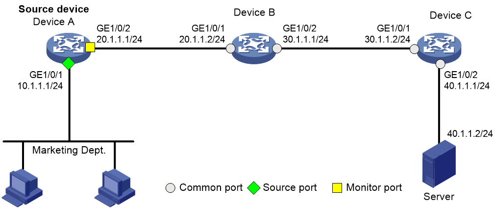

Reflector port method
In Layer 2 remote port mirroring that uses the reflector port method, packets are mirrored as follows:
1.     The source device copies packets received on the mirroring sources to the reflector port.
2.     The reflector port broadcasts the mirrored packets in the remote probe VLAN.
3.     The intermediate devices transmit the mirrored packets to the destination device through the remote probe VLAN.
4.     Upon receiving the mirrored packets, the destination device determines whether the ID of the mirrored packets is the same as the remote probe VLAN ID. If the two VLAN IDs match, the destination device forwards the mirrored packets to the data monitoring device through the monitor port.
Figure 2 Layer 2 remote port mirroring implementation through the reflector port method
Egress port method
In Layer 2 remote port mirroring that uses the egress port method, packets are mirrored as follows:
1.     The source device copies packets received on the mirroring sources to the egress port.
2.     The egress port forwards the mirrored packets to the intermediate devices.
3.     The intermediate devices flood the mirrored packets in the remote probe VLAN and transmit the mirrored packets to the destination device.
Figure 3 Layer 2 remote port mirroring implementation through the egress port method

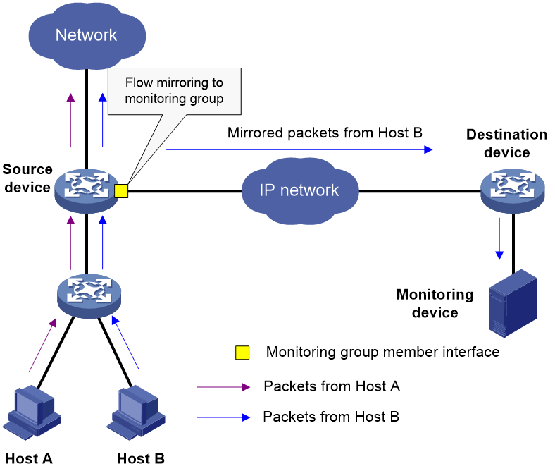

Layer 3 remote port mirroring (ERSPAN)
Layer 3 remote port mirroring encapsulates mirrored packets in GRE packets with a protocol number of 0x88BE and routes the packets to the remote monitoring device.
The switch series supports implementing Layer 3 remote port mirroring in encapsulation parameter mode.
To implement Layer 3 remote port mirroring in encapsulation parameter mode, perform the following tasks:
1.     On the source device, create a local mirroring group and configure the mirroring sources, the monitor port, and the encapsulation parameters for mirrored packets.
2.     On all devices from source to destination, configure a unicast routing protocol to ensure Layer 3 reachability between the devices.
Create a local mirroring group on the source device, and specify the source ports and monitor port for the local mirroring group. When configuring the monitor port, specify the following encapsulation parameters for mirrored packets:
·     Monitoring device IP address as destination IP address.
·     Monitor port IP address as source IP address.
As shown in Figure 4, Layer 3 remote port mirroring in encapsulation parameter mode works as follows:
1.     The source device copies a packet passing through a source port.
2.     The source device encapsulates the copied packet with the specified encapsulation parameters, monitoring device IP as destination IP and monitor port IP as source IP.
3.     The encapsulated packet is routed to the monitoring device through the IP network.
4.     The monitoring device decapsulates the packet and analyzes the packet contents.
The packet sent to the monitoring device through Layer 3 remote port mirroring in encapsulation parameter mode is encapsulated. In this mode, make sure the monitoring device supports decapsulating packets.
Figure 4 Layer 3 remote port mirroring in encapsulation parameter mode

Configuring flow mirroring
About flow mirroring
Flow mirroring copies packets matching a class to a destination for packet analyzing and monitoring. It is implemented through QoS.
To implement flow mirroring through QoS, perform the following tasks:
·     Define traffic classes and configure match criteria to classify packets to be mirrored. Flow mirroring allows you to flexibly classify packets to be analyzed by defining match criteria.
·     Configure traffic behaviors to mirror the matching packets to the specified destination.
You can configure an action to mirror the matching packets to one of the following destinations:
·     Interface—The matching packets are copied to an interface and then forwarded to a data monitoring device for analysis.
·     Monitoring group—The matching packets are copied to the member interface of a monitoring group and then forwarded to the data monitoring devices directly connected to the interface.
·     CPU—The matching packets are copied to the CPU of an IRF member device. The CPU analyzes the packets or delivers them to upper layers.
For more information about QoS policies, traffic classes, and traffic behaviors, see ACL and QoS Configuration Guide.
Types of flow-mirroring traffic to an interface
Depending on whether the mirroring source and mirroring destination are on the same device, flow-mirroring traffic to an interface includes the following types:
·     Flow mirroring SPAN—Flow-mirrors traffic to a local interface.
·     Flow mirroring RSPAN—Flow-mirrors traffic to an interface, and then forwards traffic to a remote Layer 2 interface based on the VLAN of the mirrored traffic or through QoS traffic redirecting.
·     Flow mirroring ERSPAN—Encapsulates traffic in GRE packets with protocol number 0x88BE and routes the traffic to a remote monitoring device at Layer 3.

Monitoring group mode
As shown in Figure 12, flow mirroring ERSPAN in monitoring group mode works as follows:
1.     On the source device, configure a monitoring group, add member interfaces to the monitoring group, and configure the encapsulation parameters for the member interfaces.
2.     On the source device, apply a QoS policy as follows:
a.     Configure a traffic class to match packets.
b.     Configure a traffic behavior to mirror traffic to the monitoring group.
c.     Create a QoS policy, and associate the traffic class with the traffic behavior in the QoS policy.
d.     Apply the QoS policy.
3.     The source device copies a matching packet and mirrors the packet to the monitoring group. The member interfaces of the monitoring group encapsulate the packet with the specified encapsulation parameters.
4.     The source device forwards the packet in either of the following methods:
¡     Forwards the mirrored packet out of the specified outgoing interface.
¡     Looks up a route for the encapsulated mirrored packet based on the source IP address and destination IP address of the encapsulated packet.
5.     The encapsulated packet is routed to the monitoring device.
6.     The monitoring device decapsulates the packet and analyzes the packet contents.
The packet sent to the monitoring device through flow mirroring in this mode is encapsulated. In this mode, make sure the monitoring device supports decapsulating packets.
Figure 12 Flow mirroring ERSPAN in monitoring group mode

Example: Configuring flow mirroring
As shown in Figure 13, configure flow mirroring so that the server can monitor the following traffic:
·     All traffic that the Technical Department sends to access the Internet.
·     IP traffic that the Technical Department sends to the Marketing Department during working hours (8:00 to 18:00) on weekdays.
Figure 13 Network diagram
