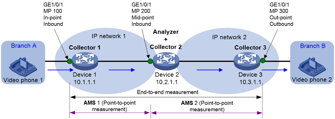

Application scenarios
End-to-end packet loss measurement
iNQA measures whether packet loss occurs between the ingress points (where the target flow enters the IP network) and the egress points (where the flow leaves the network).
·     Scenario 1: The target flow has only one ingress point and one egress point, and the two points are on the same network, for example, the local area network or the core network.
As shown in Figure 4, to measure packet loss for the flow in the network, deploy iNQA on Device 1 and Device 3.
Figure 4 Scenario 1
·     Scenario 2: The target flow can have multiple ingress points and egress points, and the points are on the same network, for example, the local area network or the core network.
As shown in Figure 5, to measure packet loss for the flow in the network, deploy iNQA on Device 1, Device 2, Device 3, and Device 4.
Figure 5 Scenario 2
·     Scenario 3: The ingress points and the egress points of a target flow are on the different networks.
As shown in Figure 6, to measure whether packet loss occurs when the flow crosses over the IP network, deploy iNQA on the egress devices of the headquarters and branches to measure.
Figure 6 Scenario 3
Point-to-point packet loss measurement
This measurement is based on atomic measurement spans (AMSs), which define smaller ranges than the end-to-end measurement. This method is helpful if you want to find out between which specific devices the packet loss occurs.
As shown in Figure 7, to configure point-to-point measurement, define AMSs, specify the flow direction in each AMS, and configure the ingress MP group and egress MP group for each AMS.
Figure 7 Point-to-point packet loss measurement
Operating mechanism
iNQA uses the model of multi-point collection and single-point calculation. Multiple collectors collect and report the packet data periodically and one analyzer calculates the data periodically.
Before starting the iNQA packet loss measurement, make sure all collectors are time synchronized through NTP or PTP. Therefore, all collectors can use the same measurement interval to color the flow and report the packet statistics to the analyzer. As a best practice, the analyzer and all collectors are time synchronized to facilitate management and maintenance. For more information about NTP, see "Configuring NTP." For more information about PTP, see "Configuring PTP."
The number of incoming packets and that of outgoing packets in a network should be equal within a time period. If they are not equal, packet loss occurs in the network.
As shown in Figure 8, the flow enters the network from MP 100, passes through MP 200, and leaves the network from MP 300. The devices where the flow passes are collectors and NTP clients, and the aggregation device is the analyzer and NTP server.
The iNQA measurement works as follows:
1.     The analyzer synchronizes the time with all collectors through the NTP protocol.
2.     The ingress MP on collector 1 identifies the target flow. It colors and decolors the packets in the flow alternatively at intervals, and periodically reports the packet statistics to the analyzer.
3.     The middle MP on collector 2 identifies the target flow and reports the packet statistics to the analyzer periodically.
4.     The egress MP on collector 3 identifies the target flow. It decolors the colored packets and reports the packet statistics to the analyzer periodically.
5.     The analyzer calculates packet loss for the flow of the same period and same instance as follows:
Number of lost packets = Number of incoming packets on the MP – Number of outgoing packets on the MP
Packet loss rate = (Number of incoming packets on the MP – Number of outgoing packets on the MP) / Number of incoming packets on the MP
The analyzer calculates the byte loss in the similar way the packet loss is calculated.
For the end-to-end measurement, the data from the ingress MP and egress MP is used.
For the point-to-point measurement, the analyzer calculates the result on a per-AMS basis.
·     In AMS 1: Packet loss = Number of packets at MP 100 – Number of packets at MP 200
·     In AMS 2: Packet loss = Number of packets at MP 200 –  Number of packets at MP 300
Figure 8 Network diagram

Example: Configuring an point-to-point iNQA packet loss measurement
As shown in Figure 10, Video phone 1 sends a video data flow to Video phone 2 through an IP network. The Video phone 2 is experiencing an erratic video display problem.
·     Enable the collector functionality on Device 1, Device 2, and Device 3, and enable the analyzer functionality on Device 2.
·     Define the flow from Device 1 to Device 3 as the forward flow.
·     Set the packet loss upper limit and packet loss lower limit to 6% and 4%, respectively.
·     Run the packet loss measurement for 15 minutes.
Figure 10 Network diagram
1.     Assign 10.1.1.1, 10.2.1.1, and 10.3.1.1 to Collector 1, Collector 2, and Collector 3, respectively.
2.     Configure OSPF in the IP network to make sure Collector 1, Collector 3, and the analyzer can reach each other. (Details not shown.)
3.     Configure NTP or PTP on Collector 1, Collector 2, and Collector 3 for clock synchronization. (Details not shown.)
1.     Configure Collector 1:
# Specify 10.1.1.1 as the collector ID.
<Collector1> system-view
[Collector1] inqa collector
[Collector1-inqa-collector] collector id 10.1.1.1
# Bind the collector to the analyzer with ID 10.2.1.1.
[Collector1-inqa-collector] analyzer 10.2.1.1
# Specify ToS field bit 5 as the flag bit.
[Collector1-inqa-collector] flag loss-measure tos-bit 5
# Configure collector instance 1 to monitor the forward flow entering the network at GigabitEthernet1/0/1 from 10.1.1.0 and 10.3.1.0.
[Collector1-inqa-collector] instance 1
[Collector1-inqa-collector-instance-1] flow forward source-ip 10.1.1.0 24 destination-ip 10.3.1.0 24
[Collector1-inqa-collector-instance-1] mp 100 in-point port-direction inbound
[Collector1-inqa-collector-instance-1] quit
[Collector1-inqa-collector] quit
[Collector1] interface gigabitethernet 1/0/1
[Collector1-GigabitEthernet1/0/1] inqa mp 100
[Collector1-GigabitEthernet1/0/1] quit
# Run the packet loss measurement for 15 minutes for collector instance 1.
[Collector1-inqa-collector-instance-1] loss-measure enable duration 15
[Collector1-inqa-collector-instance-1] return
<Collector1>
2.     Configure Collector 2 and the analyzer:
# Specify 10.2.1.1 as the collector ID.
<AnalyzerColl2> system-view
[AnalyzerColl2] inqa collector
[AnalyzerColl2-inqa-collector] collector id 10.2.1.1
[AnalyzerColl2-inqa-collector] analyzer 10.2.1.1
[AnalyzerColl2-inqa-collector] flag loss-measure tos-bit 5
[AnalyzerColl2-inqa-collector] instance 1
[AnalyzerColl2-inqa-collector-instance-1] flow forward source-ip 10.1.1.0 24 destination-ip 10.3.1.0 24
[AnalyzerColl2-inqa-collector-instance-1] mp 200 mid-point port-direction inbound
[AnalyzerColl2-inqa-collector-instance-1] quit
[AnalyzerColl2-inqa-collector] quit
[AnalyzerColl2] interface gigabitethernet 1/0/1
[AnalyzerColl2-GigabitEthernet1/0/1] inqa mp 200
[AnalyzerColl2-GigabitEthernet1/0/1] quit
[AnalyzerColl2-inqa-collector-instance-1] loss-measure enable duration 15
# Specify 10.2.1.1 as the analyzer ID.
[AnalyzerColl2] inqa analyzer
[AnalyzerColl2-inqa-analyzer] analyzer id 10.2.1.1
# Bind analyzer instance 1 to Collector 1, Collector 2, and Collector 3.
[AnalyzerColl2-inqa-analyzer] instance 1
[AnalyzerColl2-inqa-analyzer-instance-1] collector 10.1.1.1
[AnalyzerColl2-inqa-analyzer-instance-1] collector 10.2.1.1
[AnalyzerColl2-inqa-analyzer-instance-1] collector 10.3.1.1
# Configure AMS 1 to measure the packet loss rate for the forward flow from MP 100 to MP 200.
[AnalyzerColl2-inqa-analyzer-instance-1] ams 1
[AnalyzerColl2-inqa-analyzer-instance-1-ams-1] flow forward
[AnalyzerColl2-inqa-analyzer-instance-1-ams-1] in-group collector 10.1.1.1 mp 100
[AnalyzerColl2-inqa-analyzer-instance-1-ams-1] out-group collector 10.2.1.1 mp 200
[AnalyzerColl2-inqa-analyzer-instance-1-ams-1] quit
# Configure AMS 2 to measure the packet loss rate for the forward flow from MP 200 to MP 300.
[AnalyzerColl2-inqa-analyzer-instance-1] ams 2
[AnalyzerColl2-inqa-analyzer-instance-1-ams-2] flow forward
[AnalyzerColl2-inqa-analyzer-instance-1-ams-2] in-group collector 10.2.1.1 mp 200
[AnalyzerColl2-inqa-analyzer-instance-1-ams-2] out-group collector 10.3.1.1 mp 300
[AnalyzerColl2-inqa-analyzer-instance-1-ams-2] quit
# Set the packet loss upper limit and lower limit to 6% and 4%, respectively.
[AnalyzerColl2-inqa-analyzer-instance-1] loss-measure alarm upper-limit 6 lower-limit 4
# Enable the measurement functionality of analyzer instance 1.
[AnalyzerColl2-inqa-analyzer-instance-1] measure enable
[AnalyzerColl2-inqa-analyzer-instance-1] return
<AnalyzerColl2>
3.     Configure Collector 3:
# Specify 10.3.1.1 as the collector ID.
<Collector3> system-view
[Collector3] inqa collector
[Collector3-inqa-collector] collector id 10.3.1.1
[Collector3-inqa-collector] analyzer 10.2.1.1
[Collector3-inqa-collector] flag loss-measure tos-bit 5
[Collector3-inqa-collector] instance 1
[Collector3-inqa-collector-instance-1] flow forward source-ip 10.1.1.0 24 destination-ip 10.3.1.0 24
[Collector3-inqa-collector-instance-1] mp 300 out-point port-direction outbound
[Collector3-inqa-collector-instance-1] quit
[Collector3-inqa-collector] quit
[Collector3] interface gigabitethernet 1/0/1
[Collector3-GigabitEthernet1/0/1] inqa mp 300
[Collector3-GigabitEthernet1/0/1] quit
[Collector3-inqa-collector-instance-1] loss-measure enable duration 15
[Collector3-inqa-collector-instance-1] return
<Collector3>
