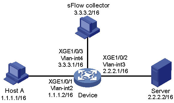

As shown in Figure 2, perform the following tasks:
·     Configure flow sampling in random mode and counter sampling on Ten-GigabitEthernet 1/0/1 of the device to monitor traffic on the port.
·     Configure the device to send sampled information in sFlow packets through Ten-GigabitEthernet 1/0/3 to the sFlow collector.
Figure 2 Network diagram
1.     Configure VLANs, assign Ethernet interfaces to VLANs, and configure IP addresses and subnet masks for VLAN interfaces, as shown in Figure 2. (Details not shown.)
2.     Configure the sFlow agent and configure information about the sFlow collector:
# Configure the IP address for the sFlow agent.
<Device> system-view
[Device] sflow agent ip 3.3.3.1
# Configure information about the sFlow collector. Specify the sFlow collector ID as 1, IP address as 3.3.3.2, port number as 6343 (default), and description as netserver.
[Device] sflow collector 1 ip 3.3.3.2 description netserver
