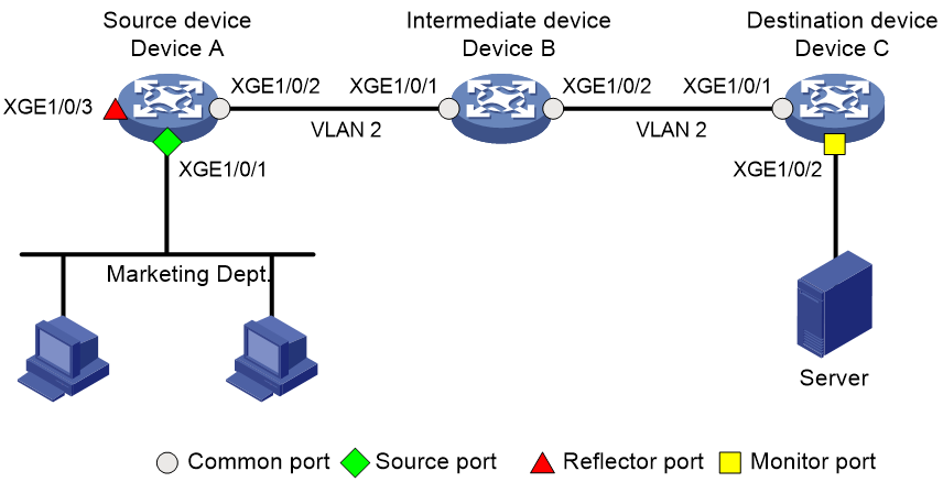

Reflector port method
In Layer 2 remote port mirroring that uses the reflector port method, packets are mirrored as follows:
1.     The source device copies packets received on the mirroring sources to the reflector port.
2.     The reflector port broadcasts the mirrored packets in the remote probe VLAN.
3.     The intermediate devices transmit the mirrored packets to the destination device through the remote probe VLAN.
4.     Upon receiving the mirrored packets, the destination device determines whether the ID of the mirrored packets is the same as the remote probe VLAN ID. If the two VLAN IDs match, the destination device forwards the mirrored packets to the data monitoring device through the monitor port.
Figure 2 Layer 2 remote port mirroring implementation through the reflector port method

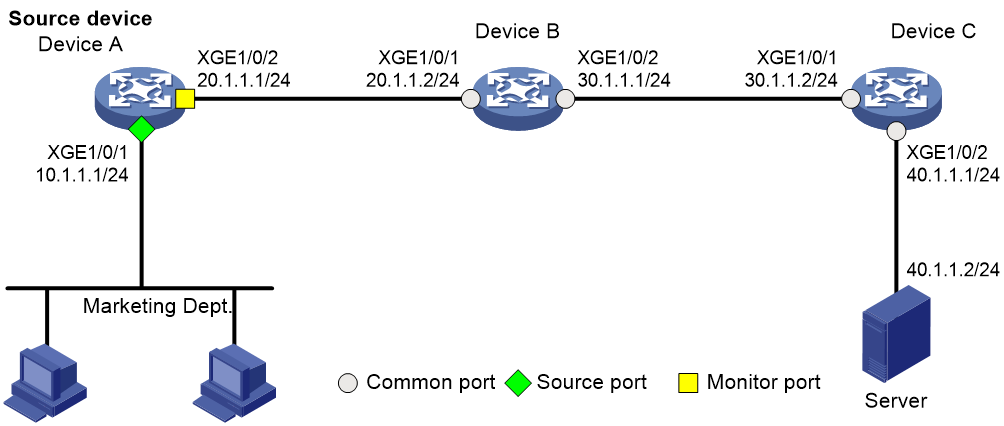

Egress port method
In Layer 2 remote port mirroring that uses the egress port method, packets are mirrored as follows:
1.     The source device copies packets received on the mirroring sources to the egress port.
2.     The egress port forwards the mirrored packets to the intermediate devices.
3.     The intermediate devices flood the mirrored packets in the remote probe VLAN and transmit the mirrored packets to the destination device.
Figure 3 Layer 2 remote port mirroring implementation through the egress port method

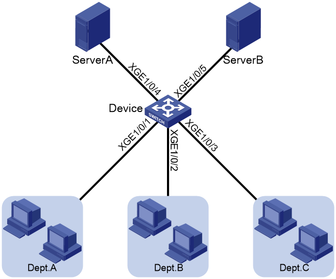

Example: Configuring local port mirroring(SPAN)
As shown in Figure 5, configure local port mirroring in source port mode to enable the server to monitor the bidirectional traffic of the two departments.

Example: Configuring local port mirroring with multiple monitoring devices
As shown in Figure 6, Dept. A, Dept. B, and Dept. C are connected to the device through Ten-GigabitEthernet 1/0/1, Ten-GigabitEthernet 1/0/2, and Ten-GigabitEthernet 1/0/3, respectively.
Configure port mirroring to enable data monitoring devices Server A and Server B to monitor both the incoming and outgoing traffic of departments A, B, and C.
Figure 6 Network diagram
# Create remote source group 1.
<Device> system-view
[Device] mirroring-group 1 remote-source
# Configure Ten-GigabitEthernet 1/0/1 through Ten-GigabitEthernet 1/0/3 as source ports of remote source group 1.
[Device] mirroring-group 1 mirroring-port Ten-GigabitEthernet1/0/1 to Ten-GigabitEthernet1/0/3 both
# Configure an unused port (Ten-GigabitEthernet 1/0/6 in this example) as the reflector port of remote source group 1.
[Device] mirroring-group 1 reflector-port Ten-GigabitEthernet1/0/6
This operation may delete all settings made on the interface. Continue? [Y/N]:y
# Create VLAN 10 and assign the ports connecting the data monitoring devices to the VLAN.
[Device] vlan 10
[Device-vlan10] port Ten-GigabitEthernet1/0/4 to Ten-GigabitEthernet1/0/5
[Device-vlan10] quit
# Configure VLAN 10 as the remote probe VLAN of remote source group 1.
[Device] mirroring-group 1 remote-probe vlan 10
Example: Configuring Layer 2 remote port mirroring (RSPAN with reflector port)
As shown in Figure 7, configure Layer 2 remote port mirroring to enable the server to monitor the bidirectional traffic of the Marketing Department.
Figure 7 Network diagram
1.     Configure Device C (the destination device):
# Configure Ten-GigabitEthernet 1/0/1 as a trunk port, and assign the port to VLAN 2.
<DeviceC> system-view
[DeviceC] interface ten-gigabitethernet 1/0/1
[DeviceC-Ten-GigabitEthernet1/0/1] port link-type trunk
[DeviceC-Ten-GigabitEthernet1/0/1] port trunk permit vlan 2
[DeviceC-Ten-GigabitEthernet1/0/1] quit
# Create a remote destination group.
[DeviceC] mirroring-group 2 remote-destination
# Create VLAN 2.
[DeviceC] vlan 2
# Disable MAC address learning for VLAN 2.
[DeviceC-vlan2] undo mac-address mac-learning enable
[DeviceC-vlan2] quit
# Configure VLAN 2 as the remote probe VLAN for the mirroring group.
[DeviceC] mirroring-group 2 remote-probe vlan 2
# Configure Ten-GigabitEthernet 1/0/2 as the monitor port for the mirroring group.
[DeviceC] interface ten-gigabitethernet 1/0/2
[DeviceC-Ten-GigabitEthernet1/0/2] mirroring-group 2 monitor-port
# Disable the spanning tree feature on Ten-GigabitEthernet 1/0/2.
[DeviceC-Ten-GigabitEthernet1/0/2] undo stp enable
# Assign Ten-GigabitEthernet 1/0/2 to VLAN 2.
[DeviceC-Ten-GigabitEthernet1/0/2] port access vlan 2
[DeviceC-Ten-GigabitEthernet1/0/2] quit
2.     Configure Device B (the intermediate device):
# Create VLAN 2.
<DeviceB> system-view
[DeviceB] vlan 2
[DeviceB-vlan2] undo mac-address mac-learning enable
[DeviceB-vlan2] quit
[DeviceB] interface ten-gigabitethernet 1/0/1
[DeviceB-Ten-GigabitEthernet1/0/1] port link-type trunk
[DeviceB-Ten-GigabitEthernet1/0/1] port trunk permit vlan 2
[DeviceB-Ten-GigabitEthernet1/0/1] quit
# Configure Ten-GigabitEthernet 1/0/2 as a trunk port, and assign the port to VLAN 2.
[DeviceB] interface ten-gigabitethernet 1/0/2
[DeviceB-Ten-GigabitEthernet1/0/2] port link-type trunk
[DeviceB-Ten-GigabitEthernet1/0/2] port trunk permit vlan 2
[DeviceB-Ten-GigabitEthernet1/0/2] quit
3.     Configure Device A (the source device):
# Create a remote source group.
<DeviceA> system-view
[DeviceA] mirroring-group 1 remote-source
# Create VLAN 2.
[DeviceA] vlan 2
[DeviceA-vlan2] undo mac-address mac-learning enable
[DeviceA-vlan2] quit
[DeviceA] mirroring-group 1 remote-probe vlan 2
# Configure Ten-GigabitEthernet 1/0/1 as a source port for the mirroring group.
[DeviceA] mirroring-group 1 mirroring-port ten-gigabitethernet 1/0/1 both
# Configure Ten-GigabitEthernet 1/0/3 as the reflector port for the mirroring group.
[DeviceA] mirroring-group 1 reflector-port ten-gigabitethernet 1/0/3
This operation may delete all settings made on the interface. Continue? [Y/N]: y
[DeviceA] interface ten-gigabitethernet 1/0/2
[DeviceA-Ten-GigabitEthernet1/0/2] port link-type trunk
[DeviceA-Ten-GigabitEthernet1/0/2] port trunk permit vlan 2
[DeviceA-Ten-GigabitEthernet1/0/2] quit
# Verify the mirroring group configuration on Device C.
[DeviceC] display mirroring-group all
Mirroring group 2:
    Type: Remote destination
    Status: Active
    Monitor port: Ten-GigabitEthernet1/0/2
    Remote probe VLAN: 2
# Verify the mirroring group configuration on Device A.
[DeviceA] display mirroring-group all
Mirroring group 1:
    Type: Remote source
    Status: Active
    Mirroring port:
        Ten-GigabitEthernet1/0/1  Both
    Reflector port: Ten-GigabitEthernet1/0/3
Example: Configuring Layer 2 remote port mirroring (RSPAN with egress port)
On the Layer 2 network shown in Figure 8, configure Layer 2 remote port mirroring to enable the server to monitor the bidirectional traffic of the Marketing Department.
Figure 8 Network diagram
# Create VLAN 2.
[DeviceC] vlan 2
# Assign Ten-GigabitEthernet 1/0/2 to VLAN 2 as an access port.
# Create VLAN 2.
[DeviceB] vlan 2
# Create VLAN 2.
[DeviceA] vlan 2
# Configure VLAN 2 as the remote probe VLAN of the mirroring group.
# Configure Ten-GigabitEthernet 1/0/2 as the egress port for the mirroring group.
[DeviceA] mirroring-group 1 monitor-egress ten-gigabitethernet 1/0/2
# Disable the spanning tree feature on the port.
[DeviceA-Ten-GigabitEthernet1/0/2] undo stp enable
Mirroring group 2:
    Status: Active
Mirroring group 1:
    Type: Remote source
    Status: Active
    Mirroring port:
    Monitor egress port: Ten-GigabitEthernet1/0/2

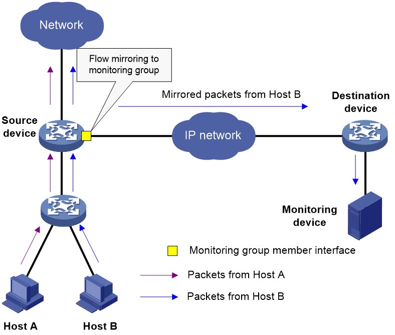

Configuring flow mirroring
About flow mirroring
Flow mirroring copies packets matching a class to a destination for packet analyzing and monitoring. It is implemented through QoS.
To implement flow mirroring through QoS, perform the following tasks:
·     Define traffic classes and configure match criteria to classify packets to be mirrored. Flow mirroring allows you to flexibly classify packets to be analyzed by defining match criteria.
·     Configure traffic behaviors to mirror the matching packets to the specified destination.
You can configure an action to mirror the matching packets to one of the following destinations:
·     Interface—The matching packets are copied to an interface and then forwarded to a data monitoring device for analysis.
·     Monitoring group—The matching packets are copied to the member interface of a monitoring group and then forwarded to the data monitoring devices directly connected to the interface.
·     CPU—The matching packets are copied to the CPU of an IRF member device. The CPU analyzes the packets or delivers them to upper layers.
For more information about QoS policies, traffic classes, and traffic behaviors, see ACL and QoS Configuration Guide.
Types of flow-mirroring traffic to an interface
Depending on whether the mirroring source and mirroring destination are on the same device, flow-mirroring traffic to an interface includes the following types:
·     Flow mirroring SPAN—Flow-mirrors traffic to a local interface.
·     Flow mirroring RSPAN—Flow-mirrors traffic to an interface, and then forwards traffic to a remote Layer 2 interface based on the VLAN of the mirrored traffic or through QoS traffic redirecting.
·     Flow mirroring ERSPAN—Encapsulates traffic in GRE packets with protocol number 0x88BE and routes the traffic to a remote monitoring device at Layer 3.
Flow mirroring SPAN or RSPAN
For flow mirroring SPAN, configure a QoS policy on the source device. Configure the QoS policy as follows:
1.     Configure a traffic class to match packets.
2.     Configure a traffic behavior to flow-mirror traffic to an interface.
3.     Associate the traffic class with the traffic behavior.
When the device receives a matching packet, the device sends one copy of the packet to the interface specified by the traffic behavior. The interface forwards the mirrored packet to the monitoring device.
Figure 10 Flow mirroring SPAN
To implement RSPAN, forward the mirrored packet to a remote Layer 2 interface based on the VLAN of the mirrored packet or through QoS traffic redirecting.
Flow mirroring ERSPAN can be implemented in monitoring group mode.

Figure 11 Flow mirroring ERSPAN in encapsulation parameter mode
Monitoring group mode
As shown in Figure 12, flow mirroring ERSPAN in monitoring group mode works as follows:
1.     On the source device, configure a monitoring group, add member interfaces to the monitoring group, and configure the encapsulation parameters for the member interfaces.
2.     On the source device, apply a QoS policy as follows:
a.     Configure a traffic class to match packets.
b.     Configure a traffic behavior to mirror traffic to the monitoring group.
c.     Create a QoS policy, and associate the traffic class with the traffic behavior in the QoS policy.
d.     Apply the QoS policy.
3.     The source device copies a matching packet and mirrors the packet to the monitoring group. The member interfaces of the monitoring group encapsulate the packet with the specified encapsulation parameters.
4.     The source device forwards the packet in either of the following methods:
¡     Forwards the mirrored packet out of the specified outgoing interface.
¡     Looks up a route for the encapsulated mirrored packet based on the source IP address and destination IP address of the encapsulated packet.
5.     The encapsulated packet is routed to the monitoring device.
6.     The monitoring device decapsulates the packet and analyzes the packet contents.
The packet sent to the monitoring device through flow mirroring in this mode is encapsulated. In this mode, make sure the monitoring device supports decapsulating packets.
Figure 12 Flow mirroring ERSPAN in monitoring group mode

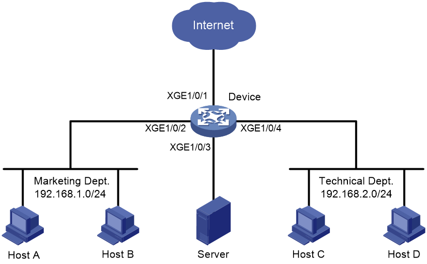

As shown in Figure 13, configure flow mirroring so that the server can monitor the following traffic:
·     All traffic that the Technical Department sends to access the Internet.
·     IP traffic that the Technical Department sends to the Marketing Department during working hours (8:00 to 18:00) on weekdays.
Figure 13 Network diagram
# Create working hour range work, in which working hours are from 8:00 to 18:00 on weekdays.
[Device] time-range work 8:00 to 18:00 working-day
# Create IPv4 advanced ACL 3000 to allow packets from the Technical Department to access the Internet and the Marketing Department during working hours.
[Device] acl advanced 3000
[Device-acl-ipv4-adv-3000] rule permit tcp source 192.168.2.0 0.0.0.255 destination-port eq www
[Device-acl-ipv4-adv-3000] rule permit ip source 192.168.2.0 0.0.0.255 destination 192.168.1.0 0.0.0.255 time-range work
[Device-acl-ipv4-adv-3000] quit
# Create traffic class tech_c, and configure the match criterion as ACL 3000.
[Device] traffic classifier tech_c
[Device-classifier-tech_c] if-match acl 3000
[Device-classifier-tech_c] quit
# Create traffic behavior tech_b, configure the action of mirroring traffic to Ten-GigabitEthernet 1/0/3.
[Device] traffic behavior tech_b
[Device-behavior-tech_b] mirror-to interface ten-gigabitethernet 1/0/3
[Device-behavior-tech_b] quit
# Create QoS policy tech_p, and associate traffic class tech_c with traffic behavior tech_b in the QoS policy.
[Device] qos policy tech_p
[Device-qospolicy-tech_p] classifier tech_c behavior tech_b
[Device-qospolicy-tech_p] quit
# Apply QoS policy tech_p to the incoming packets of Ten-GigabitEthernet 1/0/4.
[Device] interface ten-gigabitethernet 1/0/4
[Device-Ten-GigabitEthernet1/0/4] qos apply policy tech_p inbound
[Device-Ten-GigabitEthernet1/0/4] quit
# Verify that the server can monitor the following traffic:
·     All traffic sent by the Technical Department to access the Internet.
·     IP traffic that the Technical Department sends to the Marketing Department during working hours on weekdays.
(Details not shown.)
