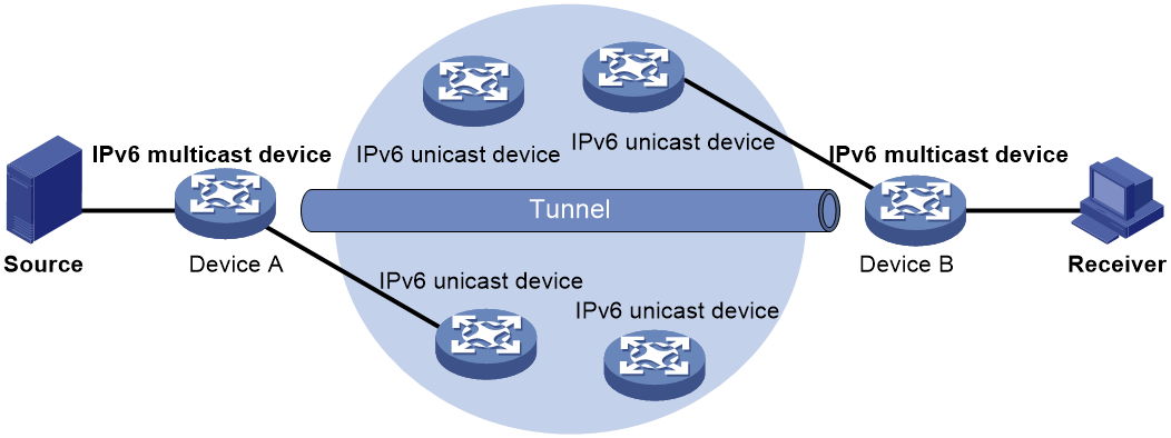

IPv6 multicast forwarding across IPv6 unicast subnets
Devices forward the IPv6 multicast data from an IPv6 multicast source hop by hop along the forwarding tree, but some devices might not support IPv6 multicast protocols in a network. When the IPv6 multicast data is forwarded to a device that does not support IPv6 multicast, the forwarding path is blocked. In this case, you can enable IPv6 multicast data forwarding across the IPv6 unicast subnets by establishing a tunnel between the devices at both ends of the IPv6 unicast subnets.
Figure 2 IPv6 multicast data transmission through a tunnel
As shown in Figure 2, a tunnel is established between Device A and Device B. Device A encapsulates the IPv6 multicast data in unicast IPv6 packets, and forwards them to Device B across the tunnel through unicast devices. Then, Device B strips off the unicast IPv6 header and continues to forward the IPv6 multicast data down toward the receivers.

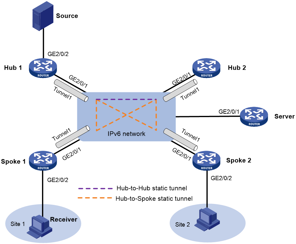

Example: Configuring IPv6 multicast forwarding over ADVPN tunnel interfaces
As shown in Figure 3:
·     An IPv6 ADVPN tunnel is established between each spoke and hub.
·     All hubs and spokes support IPv6 multicast. IPv6 PIM-SM runs on them, and NBMA runs on their IPv6 ADVPN tunnel interfaces.
·     OSPFv3 runs all hubs and spokes.
Configure the routers so that Spoke 1 can receive IPv6 multicast data from the source.
Figure 3 Network diagram

# Configure the VAM server not to authenticate VAM clients.
[Server-vam-server-domain-abc] authentication-method none
# Enable the VAM server.
[Server-vam-server-domain-abc] server enable
# Create hub group 0.
[Server-vam-server-domain-abc] hub-group 0
# Specify private IPv6 addresses for hubs in hub group 0.
[Server-vam-server-domain-abc-hub-group-0] hub ipv6 private-address 192:168::1
[Server-vam-server-domain-abc-hub-group-0] hub ipv6 private-address 192:168::2
# Specify a private IPv6 address range for spokes in hub group 0.
[Server-vam-server-domain-abc-hub-group-0] spoke ipv6 private-address range 192:168:: 192:168::FFFF:FFFF:FFFF:FFFF
[Server-vam-server-domain-abc-hub-group-0] quit
[Server-vam-server-domain-abc] quit
b.     Configure Hub 1:
# Create VAM client hub1.
<Hub1> system-view
[Hub1] vam client name Hub1
# Specify ADVPN domain abc for the VAM client.
[Hub1-vam-client-Hub1] advpn-domain abc
# Specify the VAM server.
[Hub1-vam-client-Hub1] server primary ipv6-address 1::11
# Set the pre-shared key to 123456.
[Hub1-vam-client-Hub1] pre-shared-key simple 123456
# Enable the VAM client.
[Hub1-vam-client-Hub1] client enable
c.     Configure Hub 2:
# Create VAM client hub2.
<Hub2> system-view
[Hub2] vam client name hub2
[Hub2-vam-client-hub2] advpn-domain abc
[Hub2-vam-client-hub2] server primary ipv6-address 1::11
[Hub2-vam-client-hub2] pre-shared-key simple 123456
[Hub2-vam-client-hub2] client enable
d.     Configure Spoke 1:
# Create VAM client Spoke1.
<Spoke1> system-view
[Spoke1] vam client name Spoke1
[Spoke1-vam-client-Spoke1] advpn-domain abc
[Spoke1-vam-client-Spoke1] server primary ipv6-address 1::11
[Spoke1-vam-client-Spoke1] pre-shared-key simple 123456
[Spoke1-vam-client-Spoke1] client enable
[Spoke1-vam-client-Spoke1] quit
e.     Configure Spoke 2:
# Create VAM client Spoke2.
<Spoke2> system-view
[Spoke2] vam client name Spoke2
[Spoke2-vam-client-Spoke2] advpn-domain abc
[Spoke2-vam-client-Spoke2] server primary ipv6-address 1::11
[Spoke2-vam-client-Spoke2] pre-shared-key simple 123456
[Spoke2-vam-client-Spoke2] client enable
[Spoke2-vam-client-Spoke2] quit
f.     Configure IPv6 ADVPN tunnel interfaces:
# On Hub 1, configure GRE-mode IPv6 ADVPN tunnel interface tunnel1.
[Hub1] interface tunnel 1 mode advpn gre ipv6
[Hub1-Tunnel1] source gigabitethernet 2/0/1
[Hub1-Tunnel1] ipv6 address FE80::1 link-local
[Hub1-Tunnel1] ipv6 address 192:168::1 64
[Hub1-Tunnel1] vam ipv6 client hub1
[Hub1-Tunnel1] quit
# On Hub 2, configure GRE-mode IPv6 ADVPN tunnel interface tunnel1.
[Hub2] interface tunnel 1 mode advpn gre ipv6
[Hub2-Tunnel1] source gigabitethernet 2/0/1
[Hub2-Tunnel1] ipv6 address FE80::2 link-local
[Hub2-Tunnel1] ipv6 address 192:168::2 64
[Hub2-Tunnel1] vam ipv6 client hub1
[Hub2-Tunnel1] quit
# On Spoke 1, configure GRE-mode IPv6 ADVPN tunnel interface tunnel1.
[Spoke1] interface tunnel 1 mode advpn gre ipv6
[Spoke1-Tunnel1] source gigabitethernet 2/0/1
[Spoke1-Tunnel1] ipv6 address FE80::3 link-local
[Spoke1-Tunnel1] ipv6 address 192:168::3/64
[Spoke1-Tunnel1] vam ipv6 client spoke1
[Spoke1-Tunnel1] quit
# On Spoke 2, configure GRE-mode IPv6 ADVPN tunnel interface tunnel1.
[Spoke2] interface tunnel 1 mode advpn gre ipv6
[Spoke2-Tunnel1] source gigabitethernet 2/0/1
[Spoke2-Tunnel1] ipv6 address FE80::4 link-local
[Spoke2-Tunnel1] ipv6 address 192:168::4/64
[Spoke2-Tunnel1] vam ipv6 client spoke2
[Spoke2-Tunnel1] quit
3.     Configure OSPFv3:
# On Hub 1, configure OSPFv3.
<Hub1> system-view
[Hub1] ospfv3
[Hub1-ospfv3-1] router-id 0.0.0.1
[Hub1-ospfv3-1] area 0.0.0.0
[Hub1-ospfv3-1-area-0.0.0.0] quit
[Hub1-ospfv3-1] quit
[Hub1] interface loopback 0
[Hub1-LoopBack0] ospfv3 1 area 0.0.0.0
[Hub1-LoopBack0] quit
[Hub1] interface gigabitethernet 2/0/2
[Hub1-GigabitEthernet2/0/2] ospfv3 1 area 0.0.0.0
[Hub1-GigabitEthernet2/0/2] quit
[Hub1-Tunnel1] ospfv3 1 area 0.0.0.0
[Hub1-Tunnel1] ospfv3 network-type p2mp
[Hub1-Tunnel1] quit
# On Hub 2, configure OSPFv3.
<Hub2> system-view
[Hub2] ospfv3
[Hub2-ospfv3-1] router-id 0.0.0.2
[Hub2-ospfv3-1] area 0.0.0.0
[Hub2-ospfv3-1-area-0.0.0.0] quit
[Hub2-ospfv3-1] quit
[Hub2] interface loopback 0
[Hub2-LoopBack0] ospfv3 1 area 0.0.0.0
[Hub2-LoopBack0] quit
[Hub2-Tunnel1] ospfv3 1 area 0.0.0.0
[Hub2-Tunnel1] ospfv3 network-type p2mp
[Hub2-Tunnel1] quit
# On Spoke 1, configure OSPFv3.
[Spoke1] ospfv3 1
[Spoke1-ospfv3-1] router-id 0.0.0.3
[Spoke1-ospfv3-1] area 0.0.0.0
[Spoke1-ospfv3-1-area-0.0.0.0] quit
[Spoke1-ospfv3-1] quit
[Spoke1-Tunnel1] ospfv3 1 area 0.0.0.0
[Spoke1-Tunnel1] ospfv3 network-type p2mp
# On Spoke 2, configure OSPFv3.
[Spoke2] ospfv3 1
[Spoke2-ospfv3-1] router-id 0.0.0.4
[Spoke2-ospfv3-1] area 0.0.0.0
[Spoke2-ospfv3-1-area-0.0.0.0] quit
[Spoke2-ospfv3-1] quit
[Spoke2-Tunnel1] ospfv3 1 area 0.0.0.0
[Spoke2-Tunnel1] ospfv3 network-type p2mp
[Spoke2] interface gigabitethernet 2/0/2
[Spoke2-GigabitEthernet2/0/2] ospfv3 1 area 0.0.0.0
[Spoke2-GigabitEthernet2/0/2] quit
4.     Configure IPv6 multicast:
a.     Configure Hub 1:
# Enable IPv6 multicast routing.
<Hub1> system-view
[Hub1] ipv6 multicast routing
[Hub1-mrib6] quit
# Enable IPv6 PIM-SM on Loopback 0 and GigabitEthernet 2/0/2.
[Hub1-LoopBack0] ipv6 pim sm
[Hub1-GigabitEthernet2/0/2] ipv6 pim sm
# Enable IPv6 PIM-SM and NBMA mode on Tunnel interface tunnel1.
[Hub1-Tunnel1] ipv6 pim sm
[Hub1-Tunnel1] ipv6 pim nbma-mode
[Hub1-Tunnel1] quit
# Configure Loopback 0 as a C-BSR and a C-RP.
<Hub1> system-view
[Hub1] ipv6 pim
[Hub1-pim6] c-bsr 44::44
[Hub1-pim6] c-rp 44::44
[Hub1-pim6] quit
b.     Configure Hub 2:
<Hub2> system-view
[Hub2] ipv6 multicast routing
[Hub2-mrib6] quit
# Enable IPv6 PIM-SM on Loopback 0.
[Hub2-LoopBack0] ipv6 pim sm
[Hub2-Tunnel1] ipv6 pim sm
[Hub2-Tunnel1] ipv6 pim nbma-mode
[Hub2-Tunnel1] quit
<Hub2> system-view
[Hub2] ipv6 pim
[Hub2-pim6] c-bsr 55::55
[Hub2-pim6] c-rp 55::55
[Hub2-pim6] quit
c.     Configure Spoke 1:
[Spoke1] ipv6 multicast routing
[Spoke1-mrib6] quit
[Spoke1-Tunnel1] ipv6 pim sm
[Spoke1-Tunnel1] ipv6 pim nbma-mode
# Enable MLD on GigabitEthernet 2/0/2.
[Spoke1] interface gigabitethernet 2/0/2
[Spoke1-GigabitEthernet2/0/2] mld enable
[Spoke1-GigabitEthernet2/0/2] quit
d.     Configure Spoke 2:
[Spoke2] ipv6 multicast routing
[Spoke2-mrib6] quit
[Spoke2-Tunnel1] ipv6 pim sm
[Spoke2-Tunnel1] ipv6 pim nbma-mode
# Send an MLD report from Spoke 1 to join the IPv6 multicast group FF0E::1. (Details not shown.)
# Send IPv6 multicast data from the source to the IPv6 multicast group. (Details not shown.)
# Display IPv6 PIM routing entries on Hub 1.
[Hub1]display ipv6 pim routing-table
 Total 1 (*, G) entries; 1 (S, G) entries
 (*, FF0E::1)
     RP: 44::44 (local)
     Protocol: pim-sm, Flag: WC
     UpTime: 17:02:10
     Upstream interface: Register-Tunnel0
         Upstream neighbor: NULL
         RPF prime neighbor: NULL
     Downstream interface information:
     Total number of downstream interfaces: 1
         1: Tunnel1, FE80::3
             Protocol: pim-sm, UpTime: 17:01:23, Expires: 00:02:41
 (100::1, FF0E::1)
     RP: 44::44 (local)
     Protocol: pim-sm, Flag: SPT LOC ACT
     UpTime: 00:00:02
     Upstream interface: GigabitEthernet2/0/3
         1: Tunnel1, FE80::3
             Protocol: pim-sm, UpTime: 00:00:02, Expires: 00:03:28
The output shows that Tunnel interface tunnel1 (FE80::3) on Spoke 1 will receive the IPv6 multicast data addressed to the IPv6 multicast group FF0E::1 from the source.
