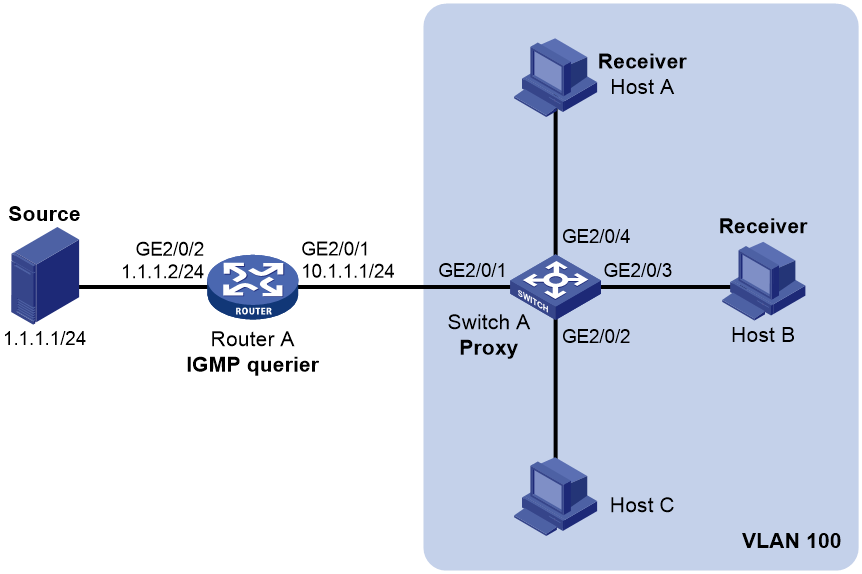

IGMP snooping configuration examples
Example: Configuring VLAN-based IGMP snooping group polices and simulated joining
As shown in Figure 3, Router A runs IGMPv2 and acts as the IGMP querier. Switch A runs IGMPv2 snooping.
Configure a multicast group policy and simulated joining to meet the following requirements:
·     Host A and Host B receive only the multicast data addressed to multicast group 224.1.1.1. Multicast data can be forwarded through GigabitEthernet 2/0/3 and GigabitEthernet 2/0/4 of Switch A uninterruptedly, even though Host A and Host B fail to receive the multicast data.
·     Switch A will drop unknown multicast data instead of flooding it in VLAN 100.
Figure 3 Network diagram
1.     Assign an IP address and subnet mask to each interface, as shown in Figure 3. (Details not shown.)
2.     Configure Router A:
# Enable IP multicast routing.
<RouterA> system-view
[RouterA] multicast routing
[RouterA-mrib] quit
# Enable IGMP on GigabitEthernet 2/0/1.
[RouterA] interface gigabitethernet 2/0/1
[RouterA-GigabitEthernet2/0/1] igmp enable
[RouterA-GigabitEthernet2/0/1] quit
# Enable PIM-DM on GigabitEthernet 2/0/2.
[RouterA] interface gigabitethernet 2/0/2
[RouterA-GigabitEthernet2/0/2] pim dm
[RouterA-GigabitEthernet2/0/2] quit
3.     Configure Switch A:
# Enable the IGMP snooping feature.
<SwitchA> system-view
[SwitchA] igmp-snooping
[SwitchA-igmp-snooping] quit
# Create VLAN 100, and assign GigabitEthernet 2/0/1 through GigabitEthernet 2/0/4 to the VLAN.
[SwitchA] vlan 100
[SwitchA-vlan100] port gigabitethernet 2/0/1 to gigabitethernet 2/0/4
# Enable IGMP snooping, and enable dropping unknown multicast data for VLAN 100.
[SwitchA-vlan100] igmp-snooping enable
[SwitchA-vlan100] igmp-snooping drop-unknown
[SwitchA-vlan100] quit
# Configure a multicast group policy so that hosts in VLAN 100 can join only multicast group 224.1.1.1.
[SwitchA] acl basic 2001
[SwitchA-acl-ipv4-basic-2001] rule permit source 224.1.1.1 0
[SwitchA-acl-ipv4-basic-2001] quit
[SwitchA-igmp-snooping] group-policy 2001 vlan 100
# Configure GigabitEthernet 2/0/3 and GigabitEthernet 2/0/4 as simulated member hosts of multicast group 224.1.1.1.
[SwitchA] interface gigabitethernet 2/0/3
[SwitchA-GigabitEthernet2/0/3] igmp-snooping host-join 224.1.1.1 vlan 100
[SwitchA-GigabitEthernet2/0/3] quit
[SwitchA] interface gigabitethernet 2/0/4
[SwitchA-GigabitEthernet2/0/4] igmp-snooping host-join 224.1.1.1 vlan 100
[SwitchA-GigabitEthernet2/0/4] quit
# Send IGMP reports from Host A and Host B to join multicast groups 224.1.1.1 and 224.2.2.2. (Details not shown.)
# Display dynamic IGMP snooping group entries for VLAN 100 on Switch A.
[SwitchA] display igmp-snooping group vlan 100
Total 1 entries.
VLAN 100: Total 1 entries.
  (0.0.0.0, 224.1.1.1)
    Host ports (2 in total):
      GE2/0/3                              (00:03:23)
      GE2/0/4                              (00:04:10)
The output shows the following information:
·     Host A and Host B have joined multicast group 224.1.1.1 through the member ports GigabitEthernet 2/0/4 and GigabitEthernet 2/0/3 on Switch A, respectively.
·     Host A and Host B have failed to join multicast group 224.2.2.2.
