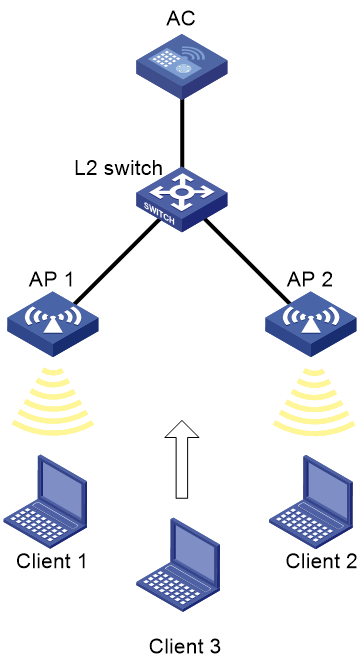

WLAN load balancing dynamically balances clients across radios to ensure wireless service quality and adequate bandwidth for clients in high-density WLANs.
NOTE: The term "AC" in this document refers to MSR routers that can function as ACs. For more information, see "Compatibility of hardware and AC functionality." |
Networking scheme
To configure WLAN load balancing among specific APs, the APs must be managed by the same AC, and the clients can discover the APs. As shown in Figure 1, AP 1, AP 2, and AP 3 are managed by the same AC and each AP has only one radio enabled. Load balancing is enabled on AP 1, AP 2, and AP 3. AP 3 has reached its maximum load. When Client 5 tries to associate with AP 3, the AC rejects the association request and directs Client 5 to AP 1 or AP 2.
Work mechanism
The device performs load balancing when the following conditions are met:
· The load of a radio reaches the threshold.
· The load gap between the radio and the radio that has the lightest load reaches the load gap threshold.
When the load and load gap for the radio reach their respective threshold, the radio rejects the association request of a client. If the number of times that the radio rejects the client reaches the specified maximum number of denials for association requests, the radio accepts the client's association request.

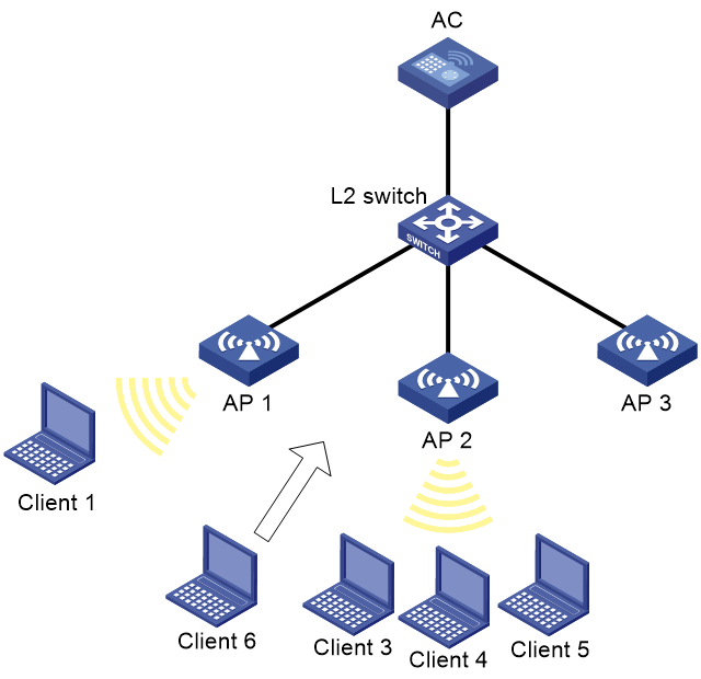

Session-mode load balancing
As shown in Figure 2, each AP has only one radio enabled. Client 1 associates with AP 1, and Client 2 through Client 4 associate with AP 2. The session threshold and session gap threshold are set to 3 and 2, respectively. When Client 5 tries to associate with AP 2, AP 2 rejects the request because both the session threshold and session gap threshold are reached.

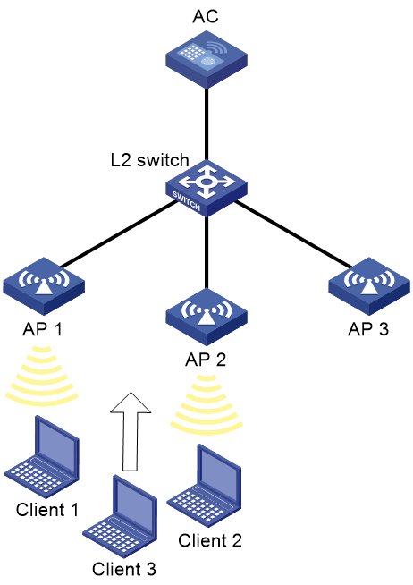

Traffic-mode load balancing
As shown in Figure 3, each AP has only one radio enabled. Client 1 associates with AP 1, and Client 2 associates with AP 2. When the traffic of AP 1 and the traffic gap between AP 1 and AP 2 reach their respective thresholds, AP 1 rejects the association request from Client 3.

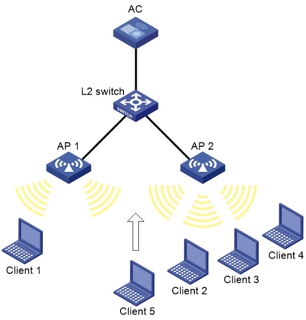

Bandwidth-mode load balancing
As shown in Figure 4, each AP has only one radio enabled. Client 1 associates with AP 1, and Client 2 associates with AP 2. When the bandwidth of AP 1 and the bandwidth gap between AP 1 and AP 2 reach their respective thresholds, AP 1 rejects the association request from Client 3.

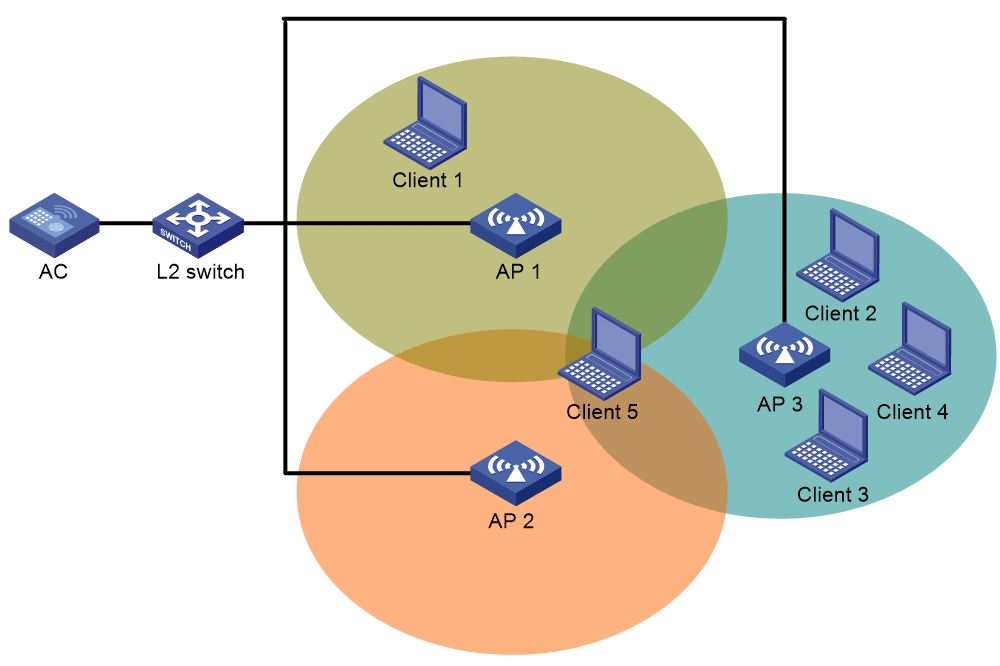

Load balancing types
The device supports the following load balancing types:
· Radio based—The device determines the radios that will participate in load balancing based on the received neighbor reports. The neighbor report of a radio records the MAC address and RSSI value of each client that is detected by the radio. The device determines that a radio will participate in load balancing when either of the following conditions is met:
¡ A client requests to associate with the radio.
¡ The radio detects that a client's RSSI has reached the RSSI threshold but the client does not request to associate with the radio.
· Load balancing group based—You add the radios of desired APs to a load balancing group. The device performs load balancing only on radios in this load balancing group.

Example: Configuring bandwidth-mode load balancing
As shown in Figure 7, each AP has only one radio enabled. AP 1 and AP 2 are managed by the AC and the clients can discover the APs.
Configure the AC to perform bandwidth-mode load balancing on AP 1 and AP 2 when the following conditions are met:
· The bandwidth of one AP reaches 12 Mbps.
· The bandwidth gap between the APs reaches 3 Mbps.
# Create wireless service template 1, and set its SSID to bandwidth-balance.
<AC> system-view
[AC] wlan service-template 1
[AC-wlan-st-1] ssid bandwidth-balance
[AC-wlan-st-1] service-template enable
[AC-wlan-st-1] quit
# Create AP template ap1, and specify the model and serial ID.
[AC] wlan ap ap1 model WA6320
[AC-wlan-ap-ap1] serial-id 219801A28N819CE0002T
# Bind service template 1 to radio 2 of AP 1.
[AC-wlan-ap-ap1] radio 2
[AC-wlan-ap-ap1-radio-2] service-template 1
[AC-wlan-ap-ap1-radio-2] radio enable
[AC-wlan-ap-ap1-radio-2] quit
[AC-wlan-ap-ap1] quit
# Create AP template ap2, and specify the model and serial ID.
[AC] wlan ap ap2 model WA6320
[AC-wlan-ap-ap2] serial-id 219801A28N819CE0003T
# Bind service template 1 to radio 2 of AP 2.
[AC-wlan-ap-ap2] radio 2
[AC-wlan-ap-ap2-radio-2] service-template 1
[AC-wlan-ap-ap2-radio-2] radio enable
[AC-wlan-ap-ap2-radio-2] quit
[AC-wlan-ap-ap2] quit
# Set the load balancing mode to bandwidth mode, and set the bandwidth threshold and bandwidth gap threshold to 12 Mbps and 3 Mbps, respectively.
[AC] wlan load-balance mode bandwidth 12 gap 3
# Enable WLAN load balancing.
[AC] wlan load-balance enable
# Verify that the AC performs bandwidth-mode load balancing for AP 1 and AP 2 when the following conditions are met:
· The bandwidth of AP 2 reaches 12 Mbps.
· The bandwidth gap between the APs reaches 3 Mbps. (Details not shown.)
# Verify that AP 1 and AP 2 are load balanced by using the display wlan client command. (Details not shown.)

Example: Configuring session-mode load balancing
As shown in Figure 8, AP 1, AP 2, and AP 3 are managed by the AC and the clients can discover the APs. Client 1 associates with radio 2 of AP 1. Client 3 through Client 5 associate with radio 2 of AP 2.
Configure the AC to perform session-mode load balancing on radio 2 of AP 1 and radio 2 of AP 2 when the following conditions are met:
· The number of sessions on one radio reaches 3.
· The session gap between the radios reaches 2.
# Create wireless service template 1, and set its SSID to session-balance.
<AC> system-view
[AC-wlan-st-1] ssid session-balance
[AC-wlan-st-1] quit
# Create AP template ap3, and specify the model and serial ID.
[AC] wlan ap ap3 model WA6320
[AC-wlan-ap-ap3] serial-id 219801A28N819CE0004T
# Bind service template 1 to radio 2 of AP 3.
[AC-wlan-ap-ap3] radio 2
[AC-wlan-ap-ap3-radio-2] service-template 1
[AC-wlan-ap-ap3-radio-2] radio enable
[AC-wlan-ap-ap3-radio-2] quit
[AC-wlan-ap-ap3] quit
# Set the load balancing mode to session mode, and set the session threshold and session gap threshold to 3 and 2, respectively.
[AC] wlan load-balance mode session 3 gap 2
# Create load balancing group 1.
[AC] wlan load-balance group 1
# Add radio 2 of AP 1 and radio 2 of AP 2 to load balancing group 1.
[AC-wlan-lb-group-1] ap name ap1 radio 2
[AC-wlan-lb-group-1] ap name ap2 radio 2
# Verify that the AC performs session-mode load balancing for radio 2 of AP 1 and radio 2 of AP 2 when the following conditions are met:
· The number of sessions on either radio reaches 3.
· The session gap between the radios reaches 2. (Details not shown.)
