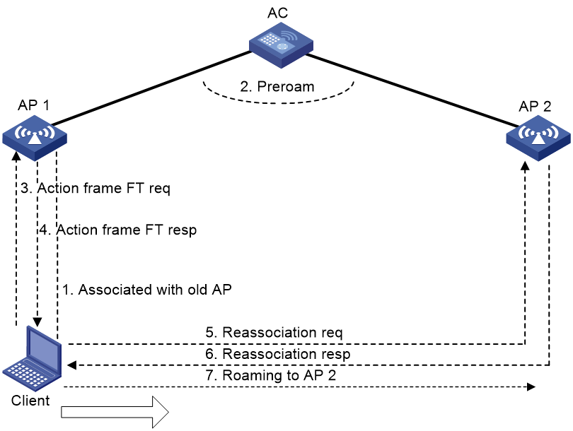

WLAN roaming mechanism
As shown in Figure 5, the client roams from AP 1 to AP 2 as follows:
1. The client comes online from AP 1, and the AC creates a roaming entry for the client.
The entry records the initial SSID at association, PMKID, authentication method, security mode, and roaming VLAN.
2. The client roams to AP 2. The AC examines the roaming entry.
3. The client performs reauthentication and then comes online from AP 2.
Figure 1 WLAN roaming mechanism

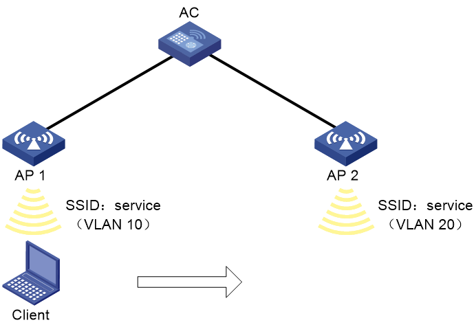

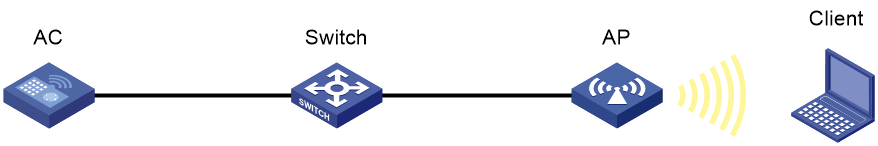

Layer 3 roaming
As shown in Figure 2, the client can roam between APs in different VLANs without special configuration. For the roaming procedure, see "WLAN roaming mechanism."

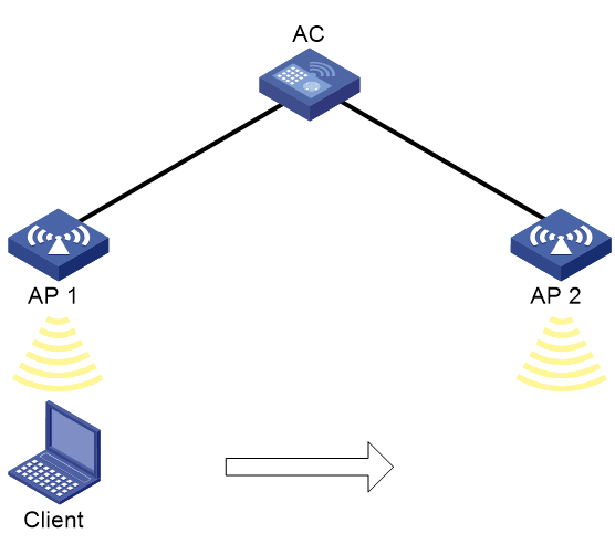

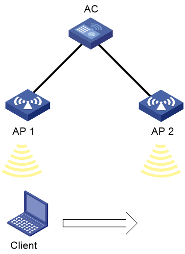

Example: Configuring intra-AC roaming
As shown in Figure 3, configure intra-AC roaming to enable the client to roam from AP 1 to AP 2. The two APs are managed by the same AC.
# Create a service template named service, set the SSID to 1, and enable the service template.
[AC] wlan service-template service
[AC-wlan-st-service] ssid 1
[AC-wlan-st-service] service-template enable
[AC-wlan-st-service] quit

# Enable the client to come online from AP 1. (Details not shown.)
# Verify that the client associates with AP 1, and the roaming status is N/A, which indicates that the client has not performed any roaming.

# Verify that the AC has a roaming entry for the client.
[AC] display wlan mobility roam-track mac-address 9cd3-6d9e-6778
Total entries: 1
BSSID Created at Online time AC IP address RID AP name
000f-e200-4444 2016-06-14 11:12:28 00hr 01min 16sec 127.0.0.1 1 ap1
# Enable the client roam to AP 2. (Details not shown.)
# Verify that the client has associated with AP 2, and the roaming status is Intra-AC roam.

# Verify that the AC has updated the roaming entry for the client.
Total entries: 2
000f-e203-7777 2016-06-14 11:12:28 00hr 01min 02sec 127.0.0.1 1 ap2
000f-e200-4444 2016-06-14 11:12:04 00hr 03min 51sec 127.0.0.1 1 ap1

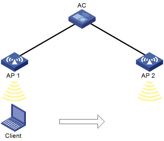

As shown in Figure 4, 802.1X fast roaming operates as follows:
1. The client comes online from AP 1 after passing RSN+802.1X authentication. AP 1 creates a roaming entry for the client.
For more information about 802.1X authentication, see "Configuring WLAN security."
2. The client roams to AP 2. The AP examines the roaming entry for the client and triggers 802.1X fast forwarding if the client carries the same PMKID as the AP.
The system uses the cached PMK to perform key negotiation and the client can associate with AP 2 without reauthentication.

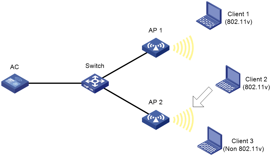

As shown in Figure 5, intra-AC roaming uses the following procedure:
1. The client comes online from AP 1, and the AC creates a roaming entry for the client. For more information about MAC authentication, see "Configuring WLAN authentication."
2. The client roams to AP 2. The AC examines the roaming entry for the client and determines whether to perform fast roaming.
If the client uses RSN + 802.1X authentication and carries the same PMKID as the AC, fast roaming is used, and the client can associate with AP 2 without reauthentication. If it is not, the client must be reauthenticated before associating with AP 2.

Intra-AC roaming through over-the-air FT
As shown in Figure 6, the client is associated with AP 1. Intra-AC roaming through over-the-air FT uses the following process:
1. The client sends an FT authentication request to AP 2.
2. AP 2 sends an FT authentication response to the client.
3. The client sends a reassociation request to AP 2.
4. AP 2 sends a reassociation response to the client.
5. The client roams to AP 2.

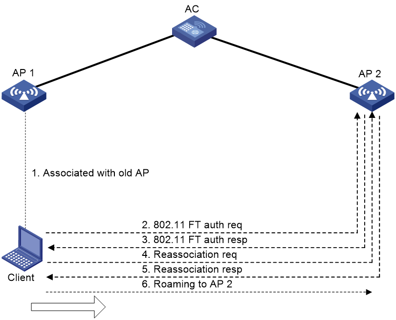

Inter-AC roaming through over-the-DS FT
As shown in Figure 7, the client is associated with AP 1. Intra-AC roaming through over-the-DS FT uses the following process:
1. After the client comes online, the AC creates a roaming entry and saves it for the client.
2. The client sends an FT authentication request to AP 1.
3. AP 1 sends an FT authentication response to the client.
4. The client sends a reassociation request to AP 2.
5. AP 2 sends a reassociation response to the client.
6. The client roams to AP 2.
Figure 7 Intra-AC roaming through over-the-DS FT

Example: Configuring over-the-DS FT (PSK authentication)
As shown in Figure 8, configure intra-AC roaming through over-the-DS FT to enable the client to roam between AP 1 and AP 2. Configure PSK as the authentication and key management mode.

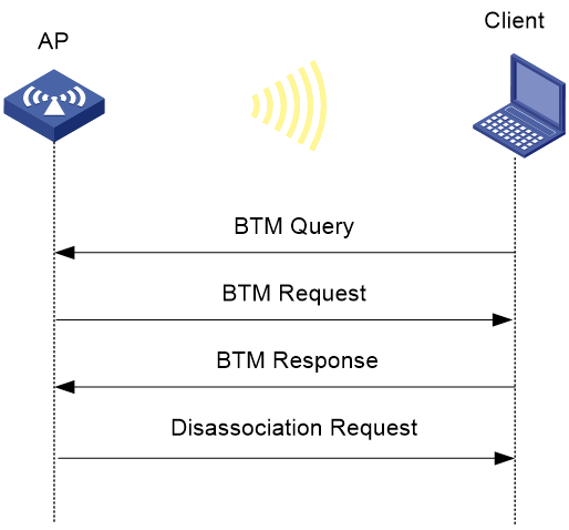

802.11v
About 802.11v
802.11v defines BSS transition management (BTM), which enables clients to roam to the optimal AP if the signal strength of the current AP is low or if a better AP is discovered.
As shown in Figure 9, BTM operates as follows:
1. If the RSSI of the currently associated AP is too low or the client discovered a better AP, the client sends a BTM query to the associated AP. Upon receiving the query, the AP responds with a BTM request.
A BTM request contains information about recommended BSSs.
2. Upon receiving the BTM request, the client determines whether to disconnect from the current AP and roam to a recommended AP.
3. If the client determines to perform a roaming, it sends a BTM response to the AP. If the client fails to leave the current BSS before the disassociation timer expires, the AP sends a disassociation request to the client and logs off the client.
Restrictions and guidelines: 802.11v configuration
802.11v supports only intra-AC roaming in the current software version.

Example: Configuring 802.11v
As shown in Figure 10, configure 802.11v for the AP to guide the client to an optimal AP.
# Create service template service.
<AC> system-view
# Set the SSID to service.
[AC-wlan-st-service] ssid service
# Enable BTM.
[AC-wlan-st-service] bss transition-management enable
# Specify the BTM disassociation timeout as 45 seconds.
[AC-wlan-st-service] bss transition-management disassociation recommended timer 45
# Enable the service template.
# Create AP ap1, specify the AP model and serial ID, enable the AP to obtain BSS candidate information, and bind service template service to radio 1 of AP ap1.
[AC] wlan ap ap1 model WA6320
[AC-wlan-ap-ap1] serial-id 219801A28N819CE0002T
[AC-wlan-ap-ap1] radio 1
[AC-wlan-ap-ap1-radio-1] sacp roam-optimize bss-candidate-list enable
[AC-wlan-ap-ap1-radio-1] service-template service
[AC-wlan-ap-ap1-radio-1] radio enable
[AC-wlan-ap-ap1-radio-1] quit
[AC-wlan-ap-ap1] quit
# Verify that BTM has been enabled.
[AC] display wlan service-template service verbose
Service template name : service
Description : Not configured
SSID : service
SSID-hide : Disabled
User-isolation : Disabled
Service template status : Disabled
Maximum clients per BSS : Not configured
Frame format : Dot3
Seamless roam status : Disabled
Seamless roam RSSI threshold : 50
Seamless roam RSSI gap : 20
VLAN ID : 1
Service VLAN ID : N/A
Service VLAN TPID : dot1q
AKM mode : Not configured
Security IE : Not configured
Cipher suite : Not configured
TKIP countermeasure time : 0 sec
PTK lifetime : 43200 sec
PTK rekey : Enabled
GTK rekey : Enabled
GTK rekey method : Time-based
GTK rekey time : 86400 sec
GTK rekey client-offline : Disabled
WPA3 status : Disabled
PPSK : Disabled
PPSK Fail Permit : Enabled
Enhance-open status : Disabled
Enhanced-open transition-mode service-template : N/A
User authentication mode : Bypass
Intrusion protection : Disabled
Intrusion protection mode : Temporary-block
Temporary block time : 180 sec
Temporary service stop time : 20 sec
Fail VLAN ID : Not configured
802.1X handshake : Disabled
802.1X handshake secure : Disabled
802.1X domain : Not configured
MAC-auth domain : Not configured
Max 802.1X users per BSS : 512
Max MAC-auth users per BSS : 512
802.1X re-authenticate : Disabled
Authorization fail mode : Online
Accounting fail mode : Online
Authorization : Permitted
Key derivation : SHA1
PMF status : Disabled
Hotspot policy number : Not configured
Forwarding policy status : Disabled
Forwarding policy name : Not configured
Forwarder : AC
FT status : Disabled
QoS trust : Port
QoS priority : 0
QoS U-APSD mode : 1
BTM status : Enabled
# Verify that the client has come online.
<AC> display wlan client
Total number of clients: 3
MAC address Username AP name R IP address VLAN
4581-61ac-885a N/A ap1 1 192.168.66.230 1
# Verify that the client has been logged off 45 seconds after the AP recommends an optimal AP for the client. (Details not shown.)
Cooperative roaming
About cooperative roaming
Cooperative roaming is defined by H3C to provide AP- and wireless client-guided roaming of wireless clients in an ESS by using IEEE802.11k, IEEE802.11r, and IEEE802.11v.
· 802.11k defines Beacon radio measurement, allowing monitoring of channel quality and resource performance on both 2.4 GHz and 5 GHz channels.
· 802.11r defines Fast BSS Transition (FT) to shorten transmission delay during client roaming, reducing disconnection rate and improving the roaming service quality.
· 802.11v defines BSS Transition Management (BTM) to guide 802.11v clients to the optimal AP, improving the access service quality.
Cooperative roaming also supports using APs to monitor 802.11v client signal strength and can proactively guide clients to better services.
Restrictions and guidelines: Cooperative roaming configuration
Cooperative roaming supports only intra-AC roaming in the current software version.
To use cooperative roaming, make sure the APs support Wi-Fi 6.
Configuring client anti-sticky
This feature enables APs to examine the signal strength of clients at the specified intervals. For an 802.11v client, its associated AP triggers a BSS transition to guide the client to a better BSS if the signal strength of the client is lower than the threshold. For a non-802.11v client, no action is performed.
With client anti-sticky enabled, the system logs off a client if the signal strength of the client cannot reach the RSSI threshold. This practice might cause frequent BSS transitions and affect user experience.
To solve this issue, configure ACL-based client anti-sticky to set different RSSI thresholds for clients matching different ACL rules.
ACL-based client anti-sticky takes effect only when client anti-sticky is enabled.
You can bind only one ACL rule to a radio.
You can use the display wlan client verbose command to view client RSSIs, and configure ACL-based client anti-sticky based on the RSSIs.

Example: Configuring cooperative roaming
As shown in Figure 10, most clients in the network support 802.11k and 802.11v. Configure cooperative roaming for clients to roam in the ESS seamlessly.
Figure 11 Network diagram
If most clients in the network do not support 802.11k or 802.11v, you can configure BTM, BTM disassociation, anti-sticky, and advanced data transmission holding for clients to perform seamless roaming.
# Configure interface IP addresses and route settings. Make sure the devices can reach each other. (Details not shown.)
