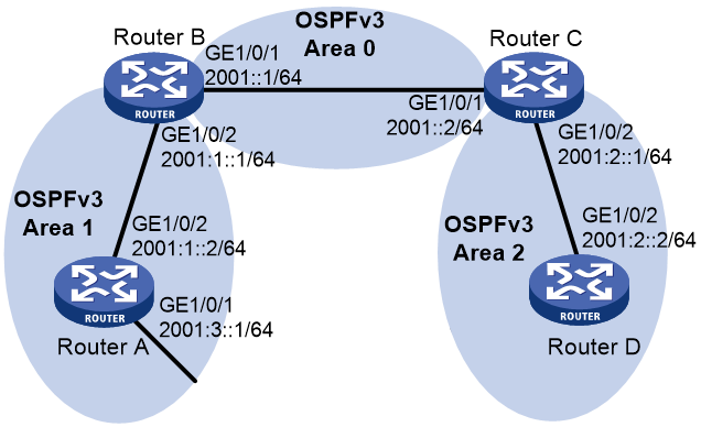

As shown in Figure 2:
· Enable OSPFv3 on all routers.
· Split the AS into three areas.
· Configure Router B and Router C as ABRs to forward routing information between areas.
· Configure Area 2 as a stub area to reduce LSAs in the area without affecting route reachability.

As shown in Figure 3:
· Configure OSPFv3 on all routers and split the AS into three areas.
· Configure Area 1 as an NSSA area and configure Router A as an ASBR to redistribute static routes into the AS.

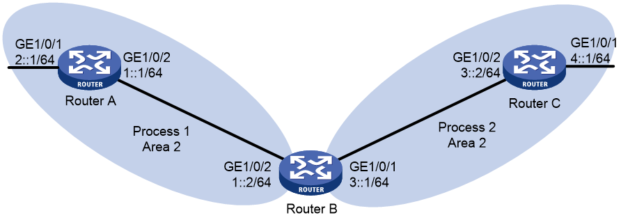

Example: Configuring OSPFv3 route redistribution
As shown in Figure 5:
· Router A, Router B, and Router C are in Area 2.
· OSPFv3 process 1 and OSPFv3 process 2 run on Router B. Router B communicates with Router A and Router C through OSPFv3 process 1 and OSPFv3 process 2.
· Configure OSPFv3 process 2 to redistribute direct routes and the routes from OSPFv3 process 1 on Router B, and set the cost for redistributed routes to 3. Router C can then learn the routes destined for 1::0/64 and 2::0/64, and Router A cannot learn the routes destined for 3::0/64 or 4::0/64.
1. Configure IPv6 addresses for interfaces. (Details not shown.)
2. Configure basic OSPFv3:
# Enable OSPFv3 process 1 on Router A.
<RouterA> system-view
[RouterA] ospfv3 1
[RouterA-ospfv3-1] router-id 1.1.1.1
[RouterA-ospfv3-1] quit
[RouterA] interface gigabitethernet 1/0/2
[RouterA-GigabitEthernet1/0/2] ospfv3 1 area 2
[RouterA-GigabitEthernet1/0/2] quit
[RouterA] interface gigabitethernet 1/0/1
[RouterA-GigabitEthernet1/0/1] ospfv3 1 area 2
[RouterA-GigabitEthernet1/0/1] quit
# Enable OSPFv3 process 1 and OSPFv3 process 2 on Router B.
<RouterB> system-view
[RouterB] ospfv3 1
[RouterB-ospfv3-1] router-id 2.2.2.2
[RouterB-ospfv3-1] quit
[RouterB] interface gigabitethernet 1/0/2
[RouterB-GigabitEthernet1/0/2] ospfv3 1 area 2
[RouterB-GigabitEthernet1/0/2] quit
[RouterB] ospfv3 2
[RouterB-ospfv3-2] router-id 3.3.3.3
[RouterB-ospfv3-2] quit
[RouterB-GigabitEthernet1/0/1] ospfv3 2 area 2
[RouterB-GigabitEthernet1/0/1] quit
# Enable OSPFv3 process 2 on Router C.
<RouterC> system-view
[RouterC] ospfv3 2
[RouterC-ospfv3-2] router-id 4.4.4.4
[RouterC-ospfv3-2] quit
[RouterC] interface gigabitethernet 1/0/2
[RouterC-GigabitEthernet1/0/2] ospfv3 2 area 2
[RouterC-GigabitEthernet1/0/2] quit
[RouterC] interface gigabitethernet 1/0/1
[RouterC-GigabitEthernet1/0/1] ospfv3 2 area 2
[RouterC-GigabitEthernet1/0/1] quit
# Display the routing table on Router C.
[RouterC] display ipv6 routing-table
Destinations : 7 Routes : 7
Destination: ::1/128 Protocol : Direct
NextHop : ::1 Preference: 0
Interface : InLoop0 Cost : 0
Destination: 3::/64 Protocol : Direct
NextHop : :: Preference: 0
Interface : GE1/0/2 Cost : 0
Destination: 3::2/128 Protocol : Direct
Destination: 4::/64 Protocol : Direct
Interface : GE1/0/1 Cost : 0
Destination: 4::1/128 Protocol : Direct
Destination: FE80::/10 Protocol : Direct
Interface : NULL0 Cost : 0
Destination: FF00::/8 Protocol : Direct
3. Configure OSPFv3 route redistribution:
# Configure OSPFv3 process 2 to redistribute direct routes and the routes from OSPFv3 process 1 on Router B, and set the cost for redistributed routes to 3.
[RouterB] ospfv3 2
[RouterB-ospfv3-2] import-route ospfv3 1 cost 3
[RouterB-ospfv3-2] import-route direct cost 3
Destinations : 9 Routes : 9
Destination: 1::/64 Protocol : O_ASE2
NextHop : FE80::200:CFF:FE01:1C03 Preference: 150
Interface : GE1/0/2 Cost : 3
Destination: 2::/64 Protocol : O_ASE2
Example: Configuring OSPFv3 route summarization
As shown in Figure 6:
· OSPFv3 process 1 and OSPFv3 process 2 run on Router B. Router B communicates with Router A and Router C through OSPFv3 process 1 and OSPFv3 process 2, respectively.
· On Router A, configure IPv6 addresses 2:1:1::1/64, 2:1:2::1/64, and 2:1:3::1/64 for GigabitEthernet 1/0/1.
· On Router B, configure OSPFv3 process 2 to redistribute direct routes and the routes from OSPFv3 process 1. Router C can then learn the routes destined for 2::/64, 2:1:1::/64, 2:1:2::/64, and 2:1:3::/64.
· On Router B, configure route summarization to advertise only summary route 2::/16 to Router C.
2. Configure OSPFv3:
[RouterA] ospfv3 1
[RouterA-GigabitEthernet1/0/1] ipv6 address 2:1:1::1 64
[RouterA-GigabitEthernet1/0/1] ipv6 address 2:1:2::1 64
[RouterA-GigabitEthernet1/0/1] ipv6 address 2:1:3::1 64
[RouterB] ospfv3 1
[RouterB] ospfv3 2
[RouterC] ospfv3 2
# Configure OSPFv3 process 2 to redistribute direct routes and the routes from OSPFv3 process 1 on Router B.
[RouterB] ospfv3 2
Destinations : 12 Routes : 12
Interface : GE1/0/2 Cost : 1
Destination: 2:1:1::/64 Protocol : O_ASE2
Destination: 2:1:2::/64 Protocol : O_ASE2
Destination: 2:1:3::/64 Protocol : O_ASE2
NextHop : 3::2 Preference: 0
NextHop : 4::1 Preference: 0
4. Configure ASBR route summarization:
# On Router B, configure OSPFv3 process 2 to advertise a summary route 2::/16.
[RouterB] ospfv3 2
[RouterB-ospfv3-2] asbr-summary 2:: 16
Destination: 2::/16 Protocol : O_ASE2
