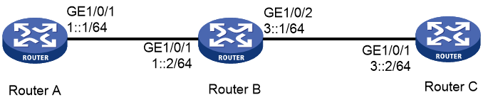

Figure 1 Network diagram for RIPng FRR
As shown in Figure 1, configure FRR on Router B by using a routing policy to specify a backup next hop. When the primary link fails, RIPng directs packets to the backup next hop. At the same time, RIPng calculates the shortest path based on the new network topology. Then, the device forwards packets over that path after network convergence.

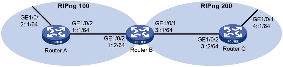

As shown in Figure 2, Router A, Router B, and Router C learn IPv6 routing information through RIPng. Configure route filtering on Router B to accept all received routes except the route 2::/64 and to advertise only the route 4::/64.
Figure 2 Network diagram

Example: Configuring RIPng route redistribution
As shown in Figure 3, Router B communicates with Router A through RIPng 100 and with Router C through RIPng 200.
Configure route redistribution on Router B, so the two RIPng processes can redistribute routes from each other.
Figure 3 Network diagram
1.     Configure IPv6 addresses for the interfaces. (Details not shown.)
2.     Configure basic RIPng settings:
# Enable RIPng 100 on Router A.
<RouterA> system-view
[RouterA] ripng 100
[RouterA-ripng-100] quit
[RouterA] interface gigabitethernet 1/0/1
[RouterA-GigabitEthernet1/0/1] ripng 100 enable
[RouterA-GigabitEthernet1/0/1] quit
[RouterA] interface gigabitethernet 1/0/2
[RouterA-GigabitEthernet1/0/2] ripng 100 enable
# Enable RIPng 100 and RIPng 200 on Router B.
<RouterB> system-view
[RouterB] ripng 100
[RouterB-ripng-100] quit
[RouterB] interface gigabitethernet 1/0/2
[RouterB-GigabitEthernet1/0/2] ripng 100 enable
[RouterB-GigabitEthernet1/0/2] quit
[RouterB] ripng 200
[RouterB-ripng-200] quit
[RouterB-GigabitEthernet1/0/1] ripng 200 enable
#  Enable RIPng 200 on Router C.
<RouterC> system-view
[RouterC] ripng 200
[RouterC] interface gigabitethernet 1/0/1
[RouterC-GigabitEthernet1/0/1] ripng 200 enable
[RouterC-GigabitEthernet1/0/1] quit
[RouterC] interface gigabitethernet 1/0/2
[RouterC-GigabitEthernet1/0/2] ripng 200 enable
[RouterC-GigabitEthernet1/0/2] quit
# Display the routing table on Router A.
[RouterA] display ipv6 routing-table
Destinations : 7 Routes : 7
Destination: ::1/128                                     Protocol  : Direct
NextHop    : ::1                                         Preference: 0
Interface  : InLoop0                                     Cost      : 0
Destination: 1::/64                                      Protocol  : Direct
NextHop    : 1::1                                        Preference: 0
Interface  : GE1/0/2                                     Cost      : 0
Destination: 1::1/128                                    Protocol  : Direct
Destination: 2::/64                                      Protocol  : Direct
NextHop    : ::                                          Preference: 0
Interface  : GE1/0/1                                     Cost      : 0
Destination: 2::1/128                                    Protocol  : Direct
Destination: FE80::/10                                   Protocol  : Direct
Interface  : NULL0                                       Cost      : 0
Destination: FF00::/8                                    Protocol  : Direct
3.     Configure RIPng route redistribution:
# Configure route redistribution between the two RIPng processes on Router B.
[RouterB] ripng 100
[RouterB-ripng-100] import-route ripng 200
[RouterB] ripng 200
[RouterB-ripng-200] import-route ripng 100
Destinations : 8 Routes : 8
Destination: 4::/64                                      Protocol  : RIPng
NextHop    : FE80::200:BFF:FE01:1C02                     Preference: 100
Interface  : GE1/0/2                                     Cost      : 1

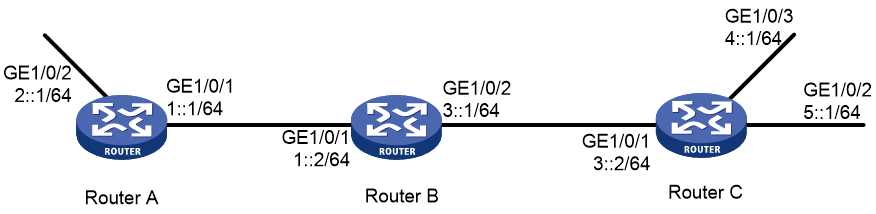

Example: Configuring RIPng NSR
As shown in Figure 5, Router S, Router A, and Router B learn IPv6 routing information through RIPng.
Enable RIPng NSR on Router S to ensure correct routing when an active/standby switchover occurs on Router S.
Figure 5 Network diagram
2.     Configure RIPng on the routers to ensure the following: (Details not shown.)
¡     Router S, Router A, and Router B can communicate with each other at Layer 3.
¡     Dynamic route update can be implemented among them with RIPng.
3.     Enable RIPng NSR on Router S.
<RouterS> system-view
[RouterS] ripng 1
[RouterS-ripng-1] non-stop-routing
[RouterS-ripng-1] quit
# Perform an active/standby switchover on Router S.
[RouterS] placement reoptimize
Predicted changes to the placement
Program                           Current location       New location
lb                                0/0                    0/0
lsm                               0/0                    0/0
slsp                              0/0                    0/0
rib6                              0/0                    0/0
routepolicy                       0/0                    0/0
rib                               0/0                    0/0
staticroute6                      0/0                    0/0
staticroute                       0/0                    0/0
ripng                             0/0                    1/0
Continue? [y/n]:y
Re-optimization of the placement start. You will be notified on completion
Re-optimization of the placement complete. Use 'display placement' to view the new placement
# During the switchover period, display RIPng neighbors on Router A to verify the neighbor relationship between Router A and Router S.
[RouterA] display ripng 1 neighbor
 Neighbor Address: FE80::AE45:5CE7:422E:2867
     Interface  : GigabitEthernet1/0/1
     Version    : RIPng version 1     Last update: 00h00m23s
     Bad packets: 0                   Bad routes : 0
# Display RIPng routes on Router A to verify if Router A has a route to the loopback interface on Router B.
[RouterA] display ripng 1 route
   Route Flags: A - Aging, S - Suppressed, G - Garbage-collect, D - Direct
                O - Optimal, F - Flush to RIB
 Peer FE80::AE45:5CE7:422E:2867 on GigabitEthernet1/0/1
 Destination 1400:1::/64,
     via FE80::AE45:5CE7:422E:2867, cost 1, tag 0, AOF, 1 secs
 Destination 4004::4/128,
     via FE80::AE45:5CE7:422E:2867, cost 2, tag 0, AOF, 1 secs
 Local route
 Destination 2002::2/128,
     via ::, cost 0, tag 0, DOF
 Destination 1200:1::/64,
# Display RIPng neighbors on Router B to verify the neighbor relationship between Router B and Router S.
[RouterB] display ripng 1 neighbor
 Neighbor Address: FE80::20C:29FF:FECE:6277
     Version    : RIPng version 1     Last update: 00h00m18s
# Display RIPng routes on Router B to verify if Router B has a route to the loopback interface on Router A.
[RouterB] display ripng 1 route
 Peer FE80::20C:29FF:FECE:6277 on GigabitEthernet1/0/1
     via FE80::20C:29FF:FECE:6277, cost 2, tag 0, AOF, 24 secs
     via FE80::20C:29FF:FECE:6277, cost 1, tag 0, AOF, 24 secs
 Local route
The output shows the following when an active/standby switchover occurs on Router S:
·     The neighbor relationships and routing information on Router A and Router B have not changed.
·     The traffic from Router A to Router B has not been impacted.

Router B
Loopback 0
20::1/128
Router C
GigabitEthernet 1/0/1
1::2/64
Router C
GigabitEthernet 1/0/2
3::2/64
1.     Configure IPv6 addresses for the interfaces on the routers. (Details not shown.)
2.     Configure RIPng on the routers to make sure Router A, Router B, and Router C can communicate with each other at the network layer. (Details not shown.)
3.     Configure RIPng FRR:
# Configure Router A.
[RouterA] ipv6 prefix-list abc index 10 permit 20::1 128
[RouterA] route-policy frr permit node 10
[RouterA-route-policy-frr-10] if-match ipv6 address prefix-list abc
[RouterA-route-policy-frr-10] apply ipv6 fast-reroute backup-interface gigabitethernet 1/0/1 backup-nexthop 1::2
[RouterA-route-policy-frr-10] quit
[RouterA] ripng 1
[RouterA-ripng-1] fast-reroute route-policy frr
[RouterA-ripng-1] quit
# Configure Router B.
[RouterB] ipv6 prefix-list abc index 10 permit 10::1 128
[RouterB] route-policy frr permit node 10
[RouterB-route-policy-frr-10] if-match ipv6 address prefix-list abc
[RouterB-route-policy-frr-10] apply ipv6 fast-reroute backup-interface gigabitethernet 1/0/1 backup-nexthop 3::2
[RouterB-route-policy-frr-10] quit
[RouterB] ripng 1
[RouterB-ripng-1] fast-reroute route-policy frr
[RouterB-ripng-1] quit

As shown in Figure 7, configure RIPng on the routers, and configure IPsec profiles on the routers to authenticate and encrypt protocol packets.
Figure 7 Network diagram

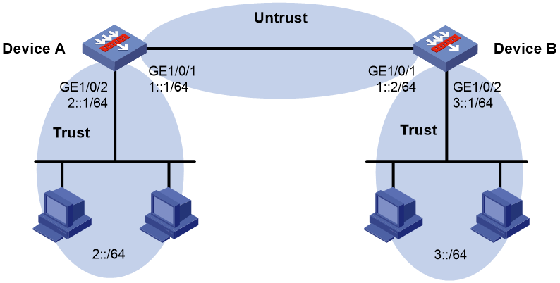

As shown in Figure 8, Device A and Device B are attached to networks 2::/64 and 3::/64, respectively. Configure RIPng on Device A and Device B to enable communication between the two networks.
Figure 8 Network diagram
Configuring Device A
1.     Assign IPv6 addresses to interfaces:

2.     Add interfaces to security zones.
[DeviceB] security-zone name untrust
[DeviceB-security-zone-Untrust] import interface gigabitethernet 1/0/1
[DeviceB-security-zone-Untrust] quit
[DeviceB] security-zone name trust
[DeviceB-security-zone-Trust] import interface gigabitethernet 1/0/2
[DeviceB-security-zone-Trust] quit
3.     Configure security policies:
a.     Configure a security policy to permit traffic between the Untrust and Local security zones, and enable the devices to establish RIPng neighbor relationship with each other.
# Configure a rule named ripnglocalin to allow Device B to receive RIPng packets from Device A.
[DeviceB] security-policy ipv6
[DeviceB-security-policy-ipv6] rule name ripnglocalin
[DeviceB-security-policy-ipv6-0-ripnglocalin] source-zone untrust
[DeviceB-security-policy-ipv6-0-ripnglocalin] destination-zone local
[DeviceB-security-policy-ipv6-0-ripnglocalin] service rip
[DeviceB-security-policy-ipv6-0-ripnglocalin] action pass
[DeviceB-security-policy-ipv6-0-ripnglocalin] quit
# Configure a rule named ripnglocalout to allow Device B to send RIPng packets to Device A.
[DeviceB-security-policy-ipv6] rule name ripnglocalout
[DeviceB-security-policy-ipv6-1-ripnglocalout] source-zone local
[DeviceB-security-policy-ipv6-1-ripnglocalout] destination-zone untrust
[DeviceB-security-policy-ipv6-1-ripnglocalout] service rip
[DeviceB-security-policy-ipv6-1-ripnglocalout] action pass
[DeviceB-security-policy-ipv6-1-ripnglocalout] quit
b.     Configure a security policy to permit traffic between the Trust and Untrust security zones, and enable communication between network 2::/64 and network 3::/64.
# Configure a rule named trust-untrust to permit packets from network 3::/64 to network 2::/64.
[DeviceB-security-policy-ipv6] rule name trust-untrust
[DeviceB-security-policy-ipv6-2-trust-untrust] source-zone trust
[DeviceB-security-policy-ipv6-2-trust-untrust] destination-zone untrust
[DeviceB-security-policy-ipv6-2-trust-untrust] source-ip-subnet 3:: 64
[DeviceB-security-policy-ipv6-2-trust-untrust] destination-ip-subnet 2:: 64
[DeviceB-security-policy-ipv6-2-trust-untrust] action pass
[DeviceB-security-policy-ipv6-2-trust-untrust] quit
# Configure a rule named untrust-trust to permit packets from network 2::/64 to network 3::/64.
[DeviceB-security-policy-ipv6] rule name untrust-trust
[DeviceB-security-policy-ipv6-3-untrust-trust] source-zone untrust
[DeviceB-security-policy-ipv6-3-untrust-trust] destination-zone trust
[DeviceB-security-policy-ipv6-3-untrust-trust] source-ip-subnet 2:: 64
[DeviceB-security-policy-ipv6-3-trust-untrust] destination-ip-subnet 3:: 64
[DeviceB-security-policy-ipv6-3-untrust-trust] action pass
[DeviceB-security-policy-ipv6-3-untrust-trust] quit
[DeviceB-security-policy-ipv6] quit
4.     Configure basic RIPng functions.
[DeviceB] ripng 1
[DeviceB-ripng-1] quit
[DeviceB-GigabitEthernet1/0/1] ripng 1 enable
[DeviceB-GigabitEthernet1/0/1] quit
[DeviceB] interface gigabitethernet 1/0/2
[DeviceB-GigabitEthernet1/0/2] ripng 1 enable
[DeviceB-GigabitEthernet1/0/2] quit
# Display the RIPng routing table of Device A.
[Device A] display ripng 1 route
 Peer FE80::76A5::A3FF:FE7B:205 on GigabitEthernet1/0/1
 Destination 3::/64,
     via FE80::76A5:A3FF:FE7B:205, cost 1, tag 0, AOF, 17 secs
 Local route
 Destination 2::/64,
 Destination 1::/64,
The output shows that the hosts in network 2::/64 can communicate with the hosts in network 3::/64.
