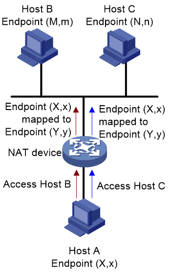

NAT mapping and filtering
In STUN, NAT mapping and NAT filtering are used to determine the type of NAT and therefore determine whether STUN works correctly. The related concepts are described as follows:
· Endpoint—A combination of an IP address and a port number. For example, Endpoint (X:x) indicates that the IP address and port number are X and x, respectively.
· NAT mapping—Maps an internal IP address and port number to an external IP address and port number for packets from the internal network to the external network. When an internal endpoint opens an outgoing session through a NAT device, the NAT device establishes a mapping between the internal IP address and port number and an external IP address and port number. Then, the NAT device forwards the packet based on the mapping.
· NAT filtering—Filters out packets from the external network to the internal network. To protect the internal network from attacks, the NAT device will discard attack packets and forward normal packets.
NAT mapping types
The following NAT mapping types are supported:
· Endpoint-independent mapping (EIM)—The NAT device uses the same mapping for all packets sent from the same internal IP address and port number to any external IP address and port number. As shown in Figure 2, Endpoint (X:x) in the internal network is always mapped to Endpoint (Y:y) in the external network.
· Address-dependent mapping (ADM)—The NAT device uses the same mapping for all packets sent from the same internal IP address and port number to the same external IP address, regardless of the external port number. As shown in Figure 3, Endpoint (X:x) in the internal network is mapped to Endpoint (Y1:y1) in the external network when it accesses Host B. Endpoint (X:x) in the internal network is mapped to Endpoint (Y2:y2) in the external network when it accesses Host C. Y1:y1 equals Y2:y2 as long as M equals N.
· Address and port-dependent mapping (APDM)—The NAT device uses the same mapping for all packets sent from the same internal IP address and port number to the same external IP address and port number. As shown in Figure 4, Endpoint (X:x) in the internal network is mapped to Endpoint (Y1:y1) in the external network when it accesses Host B. Endpoint (X:x) in the internal network is mapped to Endpoint (Y2:y2) in the external network when it accesses Host C. Y1:y1 equals Y2:y2 if M equals N and m equals n.

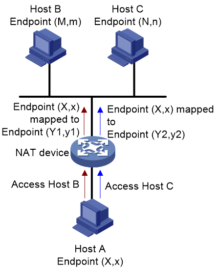

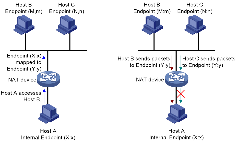

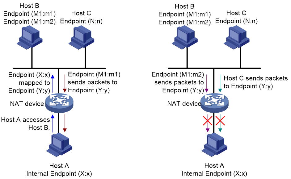

NAT filtering methods
The following NAT filtering types are supported:
· Endpoint-independent filtering (EIF)—As shown in Figure 5, the NAT device filters out only packets not destined to the internal IP address and port number (Endpoint (X:x), regardless of the external IP address and port source. The NAT device forwards any packets destined to X:x.
· Address-dependent filtering (ADF)—As shown in Figure 6, the NAT device filters out packets not destined to the internal address X:x. Additionally, the NAT device will filter out packets from Y:y destined for the internal endpoint X:x if X:x has not sent packets to Y:any port previously (independently of the port used by Y).
· Address and port-dependent filtering (APDF)—As shown in Figure 7, the NAT device filters out packets not destined to the internal address X:x. Additionally, the NAT device will filter out packets from Y:y destined for the internal endpoint X:x if X:x has not sent packets to Y:y previously.

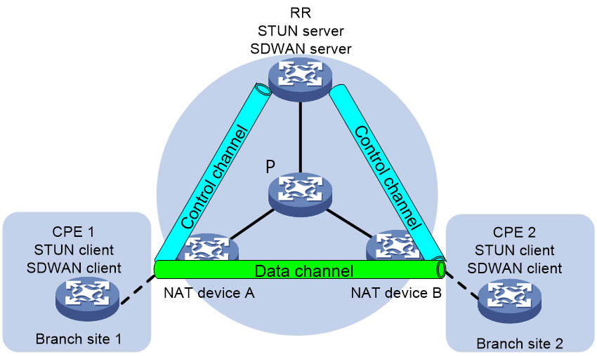

Application scenarios

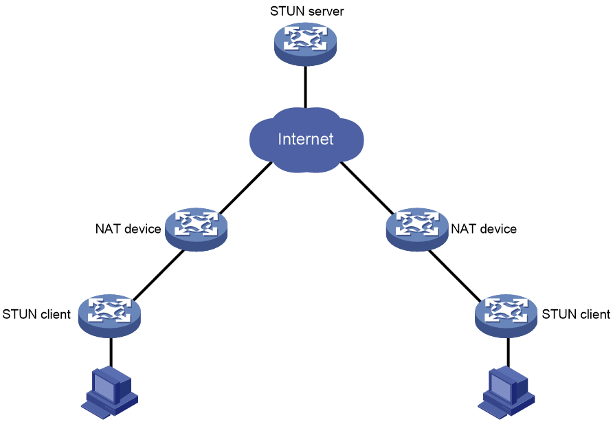

As shown in Figure 8, users at branch sites use private IP addresses so as to conserve IP address resources. After NAT devices translate the private IP addresses to public IP addresses, users at one branch site can access the headquarters.
IP addresses of the packets sent by a CPE will change after the packets pass through a NAT device. If the CPE cannot obtain its public IP address translated after NAT, it cannot establish a data channel with the other CPE. To resolve this issue, configure Session Traversal Utilities for NAT (STUN) in the SDWAN network. Typically, use CPEs as STUN clients and use the RR as the STUN server. The clients exchange packets with the server to identify whether NAT devices exist in the SDWAN network. If NAT devices exist, the clients obtain their public IP addresses and port numbers translated after NAT.
After a CPE (STUN client) obtains its public IP address and port number translated after NAT, it uses this public IP address to establish a data channel with the other CPE.
For more information about SDWAN tunnel establishment with NAT traversal, see SDWAN Configuration Guide.
Figure 8 SDWAN tunnel establishment with NAT traversal

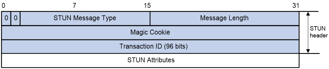

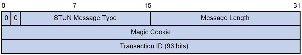

STUN header
Figure 12 shows the STUN header structure.
Figure 12 STUN header structure
A STUN header contains the following fields:
· STUN Message Type—14-bit long and can only be Binding request or Binding response.
· Message Length—16-bit long. The message length does not include the STUN header.
· Magic Cookie—Contains the fixed value 0x2112A442. This field allows a server to detect if the client will understand certain attributes. In addition, it aids in distinguishing STUN packets from packets of other protocols when STUN is multiplexed with those other protocols on the same port.
· Transaction ID—Used to uniquely identify STUN transactions. The transaction ID is chosen by the STUN client for the request and echoed by the server in the response.

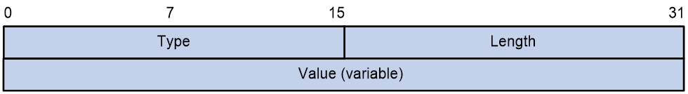

STUN attribute
Each STUN attribute is TLV (Type-Length-Value) encoded, with a 16-bit type, 16-bit length, and value.
Figure 13 Format of STUN attributes
The following are common STUN attributes:
· CHANGE-REQUEST—Carried in Binding requests. This attribute is used by the STUN client to request that the STUN server use a different address or port number when sending the response.
· MAPPED-ADDRESS—Carried in Binding responses. This attribute indicates the mapped IP address and port number of the client.
· XOR-MAPPED-ADDRESS—Carried in Binding responses. This field is identical to the MAPPED-ADDRESS attribute, except that the reflexive transport address is obfuscated through the XOR function.
· RESPONSE-ORIGIN—Carried in Binding responses. This attribute indicates the IP address and port number of the STUN server.
· OTHER-ADDRESS—Carried in Binding responses. This attribute indicates the alternate IP address and port number of the STUN server. Suppose the IP address and port number of the STUN server is Y1:YP1, and the alternate IP address and port number of the STUN server is Y2:YP2. Da represents the destination IP address in Binding requests sent by the STUN client, Dp represents the destination port number in Binding requests sent by the STUN client. If Da is Y1, the IP address in the OTHER-ADDRESS attribute is Y2. If Da is Y2, the IP address in the OTHER-ADDRESS attribute is Y1. If Dp is YP1, the port number in the OTHER-ADDRESS attribute is YP2. If Dp is YP2, the port number in the OTHER-ADDRESS attribute is YP1.
When the STUN client requests that the server use a different address or port number when sending the response:
¡ Using a different address—If the destination IP address of the Binding request is Y1, the alternate IP address is Y2, and vice versa. The STUN server uses the alternate IP address to send a response.
¡ Using a different port number—If the destination port number of the Binding request is YP1, the alternate port number is YP2, and vice versa. The STUN server uses the alternate port number to send a response.
If no alternate IP address is specified for a STUN server, the STUN server does not carry the OTHER-ADDRESS attribute in Binding responses. In this case, the STUN client cannot determine the NAT type.

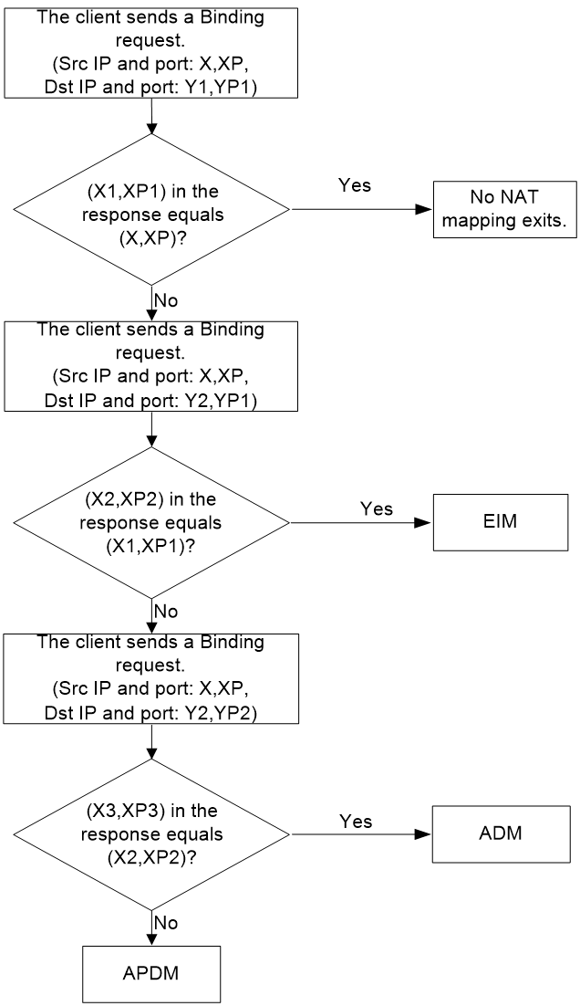

NAT mapping type detection
Suppose the IP address and port number of the STUN server is Y1:YP1, and the alternate IP address and port number of the STUN server is Y2:YP2. The IP address and port number of the STUN client is X:XP.
Figure 14 shows the process of NAT mapping type detection.
1. The STUN client sends a Binding request with source IP address and port number Endpoint (X:XP) to Endpoint (Y1:YP1) of the STUN server. The STUN server uses Endpoint (Y1:YP1) to send a Binding response to the STUN client. The Binding response includes the mapped Endpoint (X1:XP1) and another Endpoint (Y2:YP2) of the STUN server.
2. After receiving the Binding response, the STUN client checks whether Endpoint (X1:XP1) equals Endpoint (X:XP).
¡ If yes, the client considers that no mapping exists.
¡ If not, the client detects the mapping type as described in step 3.
3. The STUN client uses Endpoint (X:XP) to send a Binding request to Endpoint (Y2,YP1) of the STUN server. The STUN server uses Endpoint (Y2,YP1) to send a Binding response to the STUN client. The Binding response includes the mapped Endpoint (X2:XP2) of the STUN client.
4. After receiving the Binding response, the STUN client checks whether Endpoint (X2:XP2) equals Endpoint (X1:XP1) in step 1.
¡ If yes, the client considers that the mapping type is EIM.
¡ If not, the client detects the mapping type as described in step 5.
5. The STUN client uses Endpoint (X:XP) to send a Binding request to Endpoint (Y2:YP2) of the STUN server. The STUN server uses Endpoint (Y2:YP2) to send a Binding response to the STUN client. The Binding response includes the mapped Endpoint (X3:XP3) of the STUN client.
6. After receiving the Binding response, the STUN client checks whether Endpoint (X3:XP3) equals Endpoint (X2:XP2) in step 3.
¡ If yes, the client considers that the mapping type is ADM.
¡ If not, the client considers that the mapping type is APDM.
Figure 14 Process of NAT mapping type detection

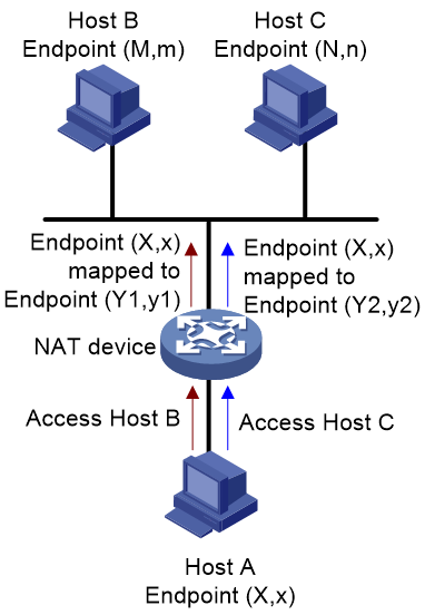

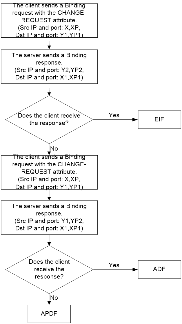

NAT filtering method detection
Figure 15 shows the process of NAT filtering method detection.
1. The STUN client sends a Binding request with source IP address and port number Endpoint (X:XP) to Endpoint (Y1:YP1) of the STUN server. The request includes the CHANGE-REQUEST attribute, which requests that the server use a different IP address and port number when sending the response. The OTHER-ADDRESS attribute in the response indicates that the alternate IP address and port number of the STUN server is Endpoint (Y2:YP2). The STUN server uses Endpoint (Y2:YP2) to send a Binding response to the STUN client.
2. If the client receives the Binding response, it considers that the mapping type is EIM.
3. If the client fails to receive the Binding response, it continues to detect the mapping type as described in step 3.
4. The client uses Endpoint (X:XP) to send a Binding request to Endpoint (Y1:YP1) of the STUN server. The request includes the CHANGE-REQUEST attribute, which requests that the server use a different IP address and port number when sending the response. The OTHER-ADDRESS attribute in the response indicates that the alternate port number of the STUN server is YP2. The STUN server uses Endpoint (Y1,YP2) to send a Binding response to the client.
5. If the client receives the Binding response, it considers that the mapping type is ADF.
6. If the client fails to receive the Binding response, it considers that the mapping type is APDF.
Figure 15 Process of NAT filtering method detection

Example: Configure STUN for SDWAN
See SDWAN configuration example in SDWAN Configuration Guide. SDWAN uses STUN for NAT traversal.
