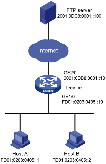

As shown in Figure 1, internal users use IPv6 prefix FD01:0203:0405::/48 and the internal IPv6 addresses are not routable on the Internet. For internal users to access the FTP server on the Internet, configure IPv6 source prefix translation to translate the internal IPv6 prefix FD01:0203:0405::/48 to external prefix 2001:0DF8:0001::/48.
# Assign IPv6 addresses to interfaces and configure routes. Make sure the network connections are available. (Details not shown.)
# Configure an IPv6 source prefix mapping from FD01:0203:0405::/48 to FD01:0203:0405::/48.
<Device> system-view
[Device] interface gigabitethernet 2/0
[Device-GigabitEthernet2/0] nat66 prefix source fd01:0203:0405:: 48 2001:0df8:0001:: 48
[Device-GigabitEthernet2/0] quit

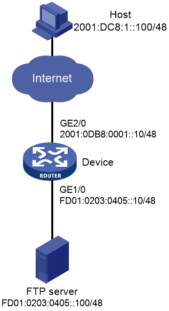

As shown in Figure 2, the internal IPv6 address of FTP server is FD01:0203:0405::100/48. The internal prefix is FD01:0203:0405::/48. Configure destination IPv6 prefix translation to allow the FTP server to use IPv6 address 2001:AB01:0001::1 to provide services for external users.
# Configure an IPv6 destination prefix mapping from 2001:AB01:0001::1/128 to FD01:0203:0405::100/128.
[Device-GigabitEthernet2/0] nat66 prefix destination 2001:ab01:1::1 128 fd01:203:405::100 128
