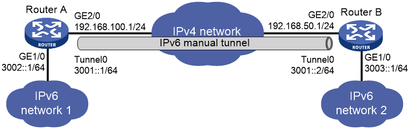

IPv6 over IPv4 tunneling enables isolated IPv6 networks to communicate, as shown in Figure 1.
The devices at both ends of an IPv6 over IPv4 tunnel must support the IPv4/IPv6 dual stack.
Figure 1 IPv6 over IPv4 tunnel
The IPv6 over IPv4 tunnel processes packets by using the following steps:
1.     A host in the IPv6 network sends an IPv6 packet to Device A at the tunnel source.
2.     After Device A receives the IPv6 packet, it processes the packet as follows:
a.     Searches the routing table to identify the outgoing interface for the IPv6 packet.
The outgoing interface is the tunnel interface, so Device A knows that the packet needs to be forwarded through the tunnel.
b.     Adds an IPv4 header to the IPv6 packet and forwards the packet through the physical interface of the tunnel.
In the IPv4 header, the source IPv4 address is the IPv4 address of the tunnel source, and the destination IPv4 address is the IPv4 address of the tunnel destination.
3.     Upon receiving the packet, Device B de-encapsulates the packet.
4.     If the destination address of the IPv6 packet is itself, Device B forwards it to the upper-layer protocol. If it is not, Device B forwards it according to the routing table.

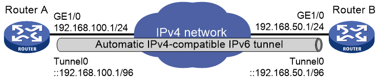

Automatic IPv4-compatible IPv6 tunneling
An automatic IPv4-compatible IPv6 tunnel is a point-to-multipoint link. The ends of an automatic IPv4-compatible IPv6 tunnel are IPv4-compatible IPv6 addresses. The address format is 0:0:0:0:0:0:a.b.c.d/96, where a.b.c.d is an IPv4 address. The destination IPv4 address of an automatic IPv4-compatible IPv6 tunnel is embedded in the destination IPv4-compatible IPv6 address. This mechanism enables the device to automatically obtain the tunnel destination address.
Automatic IPv4-compatible IPv6 tunnels have limitations because IPv4-compatible IPv6 addresses must use globally unique IPv4 addresses.

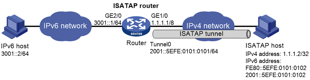

ISATAP tunneling
An ISATAP tunnel is a point-to-multipoint automatic tunnel. It provides a solution to connect an IPv6 host and an IPv6 network over an IPv4 network.
The destination address of an ISATAP tunnel is an ISATAP address. The address format is prefix:0:5EFE:abcd:efgh/64.
·     The 64-bit prefix is a valid IPv6 unicast address prefix.
·     The abcd:efgh/64 segments represent a 32-bit IPv4 address in hexadecimal notation, which identifies the tunnel destination but does not require global uniqueness.
ISATAP tunnels are mainly used for communication between IPv6 routers or between an IPv6 host and an IPv6 router over an IPv4 network.

Example: Configuring an ISATAP tunnel
As shown in Figure 8, configure an ISATAP tunnel between the ISATAP router (Router) and the ISATAP host so the ISATAP host in the IPv4 network can access the IPv6 network.
Figure 8 Network diagram
1.     Configure the ISATAP router (Router):
# Specify an IPv6 address for GigabitEthernet 2/0.
<Router> system-view
[Router] interface gigabitethernet 2/0
[Router-GigabitEthernet2/0] ipv6 address 3001::1/64
[Router-GigabitEthernet2/0] quit
# Specify an IPv4 address for GigabitEthernet 1/0.
[Router] interface gigabitethernet 1/0
[Router-GigabitEthernet1/0] ip address 1.1.1.1 255.0.0.0
[Router-GigabitEthernet1/0] quit
# Create ISATAP tunnel interface Tunnel 0.
[Router] interface tunnel 0 mode ipv6-ipv4 isatap
# Specify an EUI-64 IPv6 address for the tunnel interface.
[Router-Tunnel0] ipv6 address 2001:: 64 eui-64
# Specify GigabitEthernet 1/0 as the source interface of the tunnel.
[Router-Tunnel0] source gigabitethernet 1/0
# Disable RA suppression so that the ISATAP host can acquire information such as the address prefix from the RA message advertised by the ISATAP router.
[Router-Tunnel0] undo ipv6 nd ra halt
[Router-Tunnel0] quit
2.     Configure the ISATAP host:
Configurations on the ISATAP host vary by operating system. The following configuration is performed on Windows XP.
# Install IPv6.
C:\>ipv6 install
# On a host running Windows XP, the ISATAP interface is typically interface 2. Display information about the ISATAP interface.
C:\>ipv6 if 2
Interface 2: Automatic Tunneling Pseudo-Interface
  Guid {48FCE3FC-EC30-E50E-F1A7-71172AEEE3AE}
  does not use Neighbor Discovery
  does not use Router Discovery
  routing preference 1
  EUI-64 embedded IPv4 address: 0.0.0.0
  router link-layer address: 0.0.0.0
  preferred link-local fe80::5efe:1.1.1.2, life infinite
  link MTU 1280 (true link MTU 65515)
  current hop limit 128
  reachable time 42500ms (base 30000ms)
  retransmission interval 1000ms
  DAD transmits 0
  default site prefix length 48
# Specify an IPv4 address for the ISATAP router.
C:\>netsh interface ipv6 isatap set router 1.1.1.1
# Display information about the ISATAP interface.
C:\>ipv6 if 2
  uses Router Discovery
  EUI-64 embedded IPv4 address: 1.1.1.2
  router link-layer address: 1.1.1.1
  preferred global 2001::5efe:1.1.1.2, life 29d23h59m46s/6d23h59m46s (public)
  link MTU 1500 (true link MTU 65515)
  current hop limit 255
  DAD transmits 0
The host has obtained the prefix 2001::/64 and has automatically generated the global unicast address 2001::5efe:1.1.1.2. The message "uses Router Discovery" indicates that the router discovery feature is enabled on the host.
# Display information about IPv6 routes on the host.
C:\>ipv6 rt
2001::/64 -> 2 pref 1if+8=9 life 29d23h59m43s (autoconf)
::/0 -> 2/fe80::5efe:1.1.1.1 pref 1if+256=257 life 29m43s (autoconf)
3.     On the IPv6 host, configure a route to the ISATAP router.
C:\>netsh interface ipv6 set route 2001::/64 5 3001::1
# Verify that the ISATAP host can ping the IPv6 host.
C:\>ping 3001::2
Pinging 3001::2 with 32 bytes of data:
Reply from 3001::2: time=1ms
Ping statistics for 3001::2:

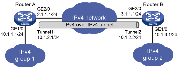

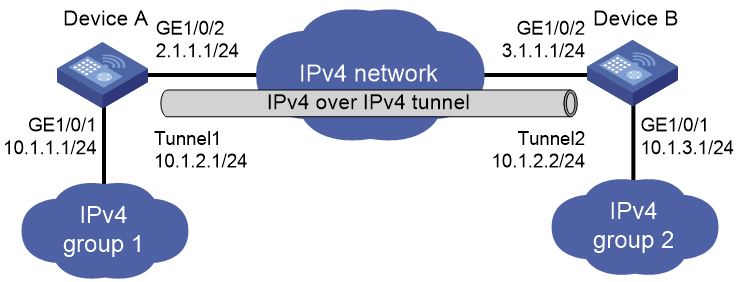

Example: Configuring an IPv4 over IPv4 tunnel
As shown in Figure 10, the two subnets IPv4 group 1 and IPv4 group 2 use private IPv4 addresses. Configure an IPv4 over IPv4 tunnel between Router A and Router B to make the two subnets reachable to each other.
Figure 10 Network diagram
Make sure Router A and Router B can reach each other through IPv4.
1.     Configure Router A:
<RouterA> system-view
[RouterA] interface gigabitethernet 1/0
[RouterA-GigabitEthernet1/0] ip address 10.1.1.1 255.255.255.0
[RouterA-GigabitEthernet1/0] quit
# Specify an IPv4 address for GigabitEthernet 2/0, which is the physical interface of the tunnel.
[RouterA] interface gigabitethernet 2/0
[RouterA-GigabitEthernet2/0] ip address 2.1.1.1 255.255.255.0
[RouterA-GigabitEthernet2/0] quit
# Create IPv4 over IPv4 tunnel interface Tunnel 1.
[RouterA] interface tunnel 1 mode ipv4-ipv4
# Specify an IPv4 address for the tunnel interface.
[RouterA-Tunnel1] ip address 10.1.2.1 255.255.255.0
# Specify the IP address of GigabitEthernet 2/0 as the source address of the tunnel.
[RouterA-Tunnel1] source 2.1.1.1
# Specify the IP address of GigabitEthernet 2/0 on Router B as the destination address of the tunnel.
[RouterA-Tunnel1] destination 3.1.1.1
[RouterA-Tunnel1] quit
# Configure a static route destined for IPv4 group 2 through the tunnel.
[RouterA] ip route-static 10.1.3.0 255.255.255.0 tunnel 1
2.     Configure Router B:
<RouterB> system-view
[RouterB] interface gigabitethernet 1/0
[RouterB-GigabitEthernet1/0] ip address 10.1.3.1 255.255.255.0
[RouterB-GigabitEthernet1/0] quit
[RouterB] interface gigabitethernet 2/0
[RouterB-GigabitEthernet2/0] ip address 3.1.1.1 255.255.255.0
[RouterB-GigabitEthernet2/0] quit
# Create IPv4 over IPv4 tunnel interface Tunnel 2.
[RouterB] interface tunnel 2 mode ipv4-ipv4
[RouterB-Tunnel2] ip address 10.1.2.2 255.255.255.0
[RouterB-Tunnel2] source 3.1.1.1
# Specify the IP address of GigabitEthernet 2/0 on Router A as the destination address of the tunnel.
[RouterB-Tunnel2] destination 2.1.1.1
[RouterB-Tunnel2] quit
# Configure a static route destined for IPv4 group 1 through the tunnel.
[RouterB] ip route-static 10.1.1.0 255.255.255.0 tunnel 2
# Use the display interface tunnel command to display the status of the tunnel interfaces on Router A and Router B. Verify that the tunnel interfaces are up. (Details not shown.)
# Verify that Router A and Router B can ping the IPv4 address of the peer interface GigabitEthernet 1/0. This example uses Router A.
[RouterA] ping -a 10.1.1.1 10.1.3.1
Ping 10.1.3.1 (10.1.3.1) from 10.1.1.1: 56 data bytes, press CTRL_C to break
56 bytes from 10.1.3.1: icmp_seq=0 ttl=255 time=2.000 ms
56 bytes from 10.1.3.1: icmp_seq=1 ttl=255 time=1.000 ms
56 bytes from 10.1.3.1: icmp_seq=2 ttl=255 time=0.000 ms
56 bytes from 10.1.3.1: icmp_seq=3 ttl=255 time=1.000 ms
56 bytes from 10.1.3.1: icmp_seq=4 ttl=255 time=1.000 ms
--- Ping statistics for 10.1.3.1 ---
round-trip min/avg/max/std-dev = 0.000/1.000/2.000/0.632 ms

As shown in Figure 11, the two subnets IPv4 group 1 and IPv4 group 2 use private IPv4 addresses. Configure an IPv4 over IPv4 tunnel between Device A and Device B to make the two subnets reachable to each other.
Figure 11 Network diagram
Make sure Device A and Device B can reach each other through IPv4.
1.     Configure Device A:
# Assign an IP address to interface GigabitEthernet 1/0.
<DeviceA> system-view
[DeviceA] interface gigabitethernet 1/0
[DeviceA-GigabitEthernet1/0] ip address 10.1.1.1 255.255.255.0
[DeviceA-GigabitEthernet1/0] quit
# Assign an IP address to interface GigabitEthernet 2/0, the physical interface of the tunnel.
[DeviceA] interface gigabitethernet 2/0
[DeviceA-GigabitEthernet2/0] ip address 2.1.1.1 255.255.255.0
[DeviceA-GigabitEthernet2/0] quit
[DeviceA] interface tunnel 1 mode ipv4-ipv4
# Specify an IP address for the tunnel interface.
[DeviceA-Tunnel1] ip address 10.1.2.1 255.255.255.0
[DeviceA-Tunnel1] source 2.1.1.1
# Specify the IP address of GigabitEthernet 2/0 on Device B as the destination address of the tunnel.
[DeviceA-Tunnel1] destination 3.1.1.1
[DeviceA-Tunnel1] quit
[DeviceA] ip route-static 10.1.3.0 255.255.255.0 tunnel 1
2.     Configure Device B:
<DeviceB> system-view
[DeviceB] interface gigabitethernet 1/0
[DeviceB-GigabitEthernet1/0] ip address 10.1.3.1 255.255.255.0
[DeviceB-GigabitEthernet1/0] quit
[DeviceB] interface gigabitethernet 2/0
[DeviceB-GigabitEthernet2/0] ip address 3.1.1.1 255.255.255.0
[DeviceB-GigabitEthernet2/0] quit
[DeviceB] interface tunnel 2 mode ipv4-ipv4
[DeviceB-Tunnel2] ip address 10.1.2.2 255.255.255.0
[DeviceB-Tunnel2] source 3.1.1.1
# Specify the IP address of GigabitEthernet 2/0 on Device A as the destination address of the tunnel.
[DeviceB-Tunnel2] destination 2.1.1.1
[DeviceB-Tunnel2] quit
[DeviceB] ip route-static 10.1.1.0 255.255.255.0 tunnel 2
# Use the display interface tunnel command to display the status of the tunnel interfaces on Device A and Device B. Verify that the tunnel interfaces are up. (Details not shown.)
# Verify that Device A and Device B can ping the IPv4 address of interface GigabitEthernet 1/0 of each other. This example uses Device A.
[DeviceA] ping -a 10.1.1.1 10.1.3.1
