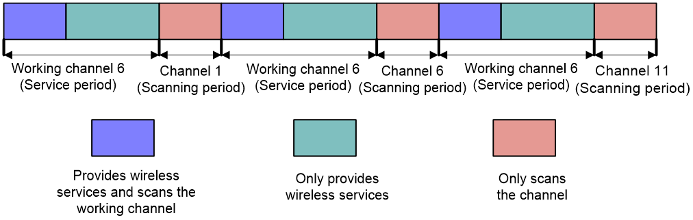

Work mechanism
An AP scans each channel on the channel scanning list in turn regardless of whether the AP provides wireless services, and each channel is scanned for a scanning period. If the AP does not provide wireless services, it starts scanning periods consecutively. If the AP provides wireless services, it starts service periods and scanning periods alternatively.
For example, Figure 1 shows the channel scanning mechanism for an AP when the AP works on channel 6 and the channel scanning list contains channels 1, 6, and 11.
Figure 1 Channel scanning mechanism

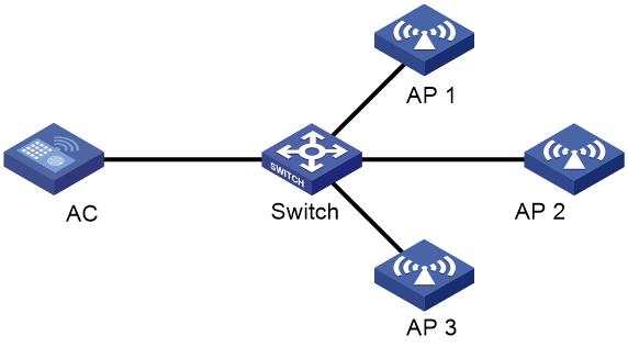

Channel scanning configuration examples
Example: Configuring relative forwarding preferred channel scanning
To ensure both channel scanning and wireless service quality, configure channel scanning and set the maximum service period for AP 1, as shown in Figure 2.
Figure 2 Network diagram

Example: Configuring absolute forwarding preferred channel scanning
To ensure wireless service quality, configure channel scanning and configure AP 1 to not limit the service period, as shown in Figure 3.
Figure 3 Network diagram
