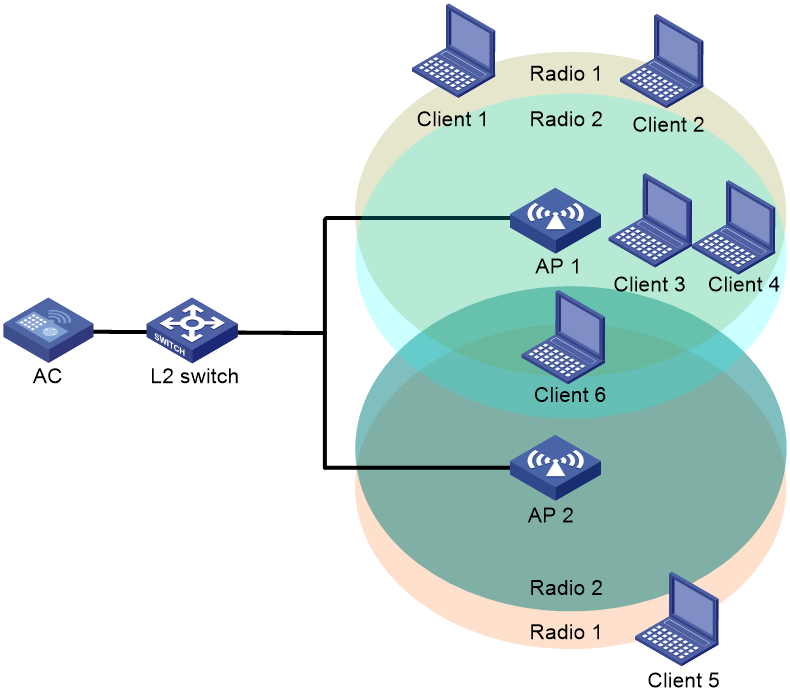

As shown in Figure 1, AP 1 and AP 2 are managed by the same AC and they each have Radio 1 and Radio 2 enabled. Radio load balancing is enabled in the WLAN. Radio 1 and Radio 2 of AP 1 have reached their maximum load. When Client 6 tries to associate with a radio on AP 1, the AC rejects the association request and directs Client 6 to other radios.

The device supports session-mode radio load balancing and the following radio load balancing types:
·     Session gap threshold based—The device performs radio load balancing when the following conditions are met:
¡     The number of clients associated with a radio reaches the session threshold.
¡     The session gap between the weighted client value of the radio and the weighted client value of the radio that has the fewest clients within the same AC reaches the session gap threshold.
The session gap is the difference between weighted client value of a radio where the client comes online and the weighted client value of the radio that has the fewest clients within the same AC. The weighted client value is equivalent to the number of clients multiplied by the radio weight value. The radio weight values of 2.4 GHz and 5 GHz radios are 2 and 1, respectively.
·     Band ratio based—The device performs radio load balancing in the following scenarios:
Scenario 1
¡     A client requests to associate with a 5 GHz radio.
¡     The number of online clients associated with the 5 GHz radio reaches the session threshold.
¡     The ratio between the number of clients associated with all 5 GHz neighbor radios multiplied by the radio weight value and the number of clients associated with all 2.4 GHz neighbor radios multiplied by the radio weight value is larger than the band ratio, or the load of the radio is higher than the average load of all radios of the same type.
Scenario 2
¡     A client requests to associate with a 2.4 GHz radio.
¡     The number of online clients associated with the 2.4 GHz radio reaches the session threshold.
¡     The ratio between the number of clients associated with all 5 GHz neighbor radios multiplied by the radio weight value and the number of clients associated with all 2.4 GHz neighbor radios multiplied by the radio weight value is smaller than or equivalent to the band ratio, or the load of the radio is lower than or equivalent to the average load of all radios of the same type.
Neighbor radios of a client refer to all radios that receive requests from the client.

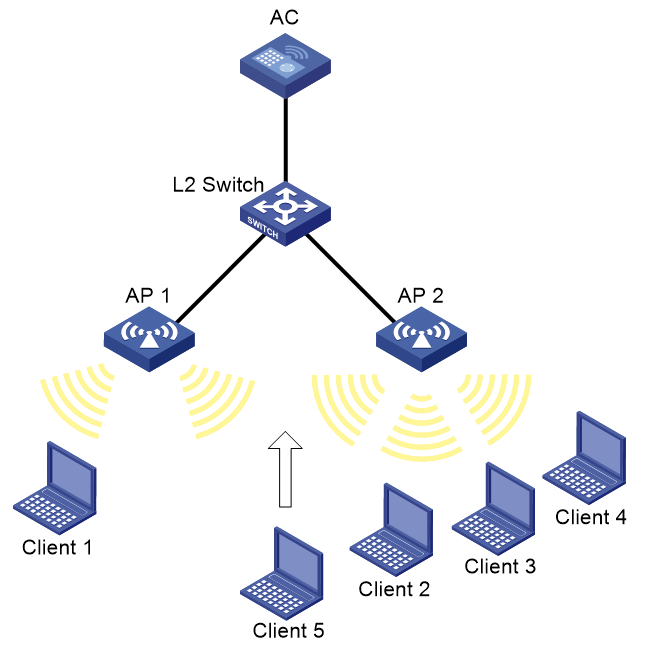

As shown in Figure 2, AP 1 and AP 2 are managed by the AC and the clients can discover the APs. Client 1 associates with AP 1, and Client 2 through Client 4 associate with AP 2.
Configure the AP to perform radio load balancing on radios of AP 1 and AP 2 when the following conditions are met:
·     The number of sessions on a radio of an AP reaches 3.
·     The session gap between the radio and the radio that has the fewest sessions reaches 2.
Figure 2 Network diagram

# Enable WLAN radio load balancing, and set the session threshold and session gap threshold to 3 and 2, respectively.
[AC] wlan radio-load-balance enable mode session 3 gap 2
# Set the RSSI threshold to 30.
[AC] wlan radio-load-balance rssi-threshold 30
# Set the maximum number of denials for association requests to 4.
[AC] wlan radio-load-balance access-denial 4
# Verify that the AC performs radio load balancing on radios of AP 1 and AP 2 when the following conditions are met:
·     The number of sessions on radio 2 of AP 2 reaches 3.
·     The session gap between radio 2 of AP 2 and radio 2 of AP 1 reaches 2. (Details not shown.)
# Verify that radio 2 on AP 1 and radio 2 on AP 2 are load balanced by using the display wlan client command. (Details not shown.)
