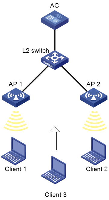

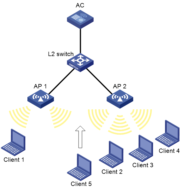

Work mechanism
The device performs load balancing when the following conditions are met:
·     The load of a radio reaches the threshold.
·     The load gap between the radio and the radio that has the lightest load reaches the load gap threshold.
When the load and load gap for the radio reach their respective threshold, the radio rejects the association request of a client. If the number of times that the radio rejects the client reaches the specified maximum number of denials for association requests, the radio accepts the client's association request.
Load balancing modes
The device supports session-mode, traffic-mode, and bandwidth-mode load balancing. It performs load balancing of a specific mode when the following conditions are met:

Session-mode load balancing
As shown in Figure 2, each AP has only one radio enabled. Client 1 associates with AP 1, and Client 2 through Client 4 associate with AP 2. The session threshold and session gap threshold are set to 3 and 2, respectively. When Client 5 tries to associate with AP 2, AP 2 rejects the request because both the session threshold and session gap threshold are reached.
Figure 2 Session-mode load balancing
Traffic-mode load balancing
As shown in Figure 3, each AP has only one radio enabled. Client 1 associates with AP 1, and Client 2 associates with AP 2. When the traffic of AP 1 and the traffic gap between AP 1 and AP 2 reach their respective thresholds, AP 1 rejects the association request from Client 3.
Figure 3 Traffic-mode load balancing
