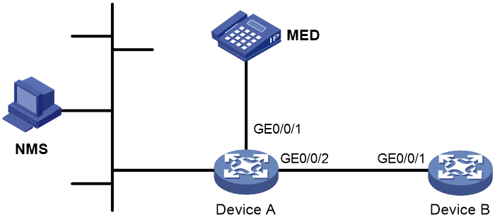

LLDP exchanges packets between neighbor agents and creates and maintains neighbor information for them. Figure 1 shows the neighbor relationships for these LLDP agents.
Figure 1 LLDP neighbor relationships

Example: Configuring basic LLDP functions
As shown in Figure 5, enable LLDP globally on Device A and Device B to perform the following tasks:
·     Monitor the link between Device A and Device B on the NMS.
·     Monitor the link between Device A and the MED device on the NMS.
Figure 5 Network diagram
1.     Configure Device A:
# Enable LLDP globally.
<DeviceA> system-view
[DeviceA] lldp global enable
# Enable LLDP on GigabitEthernet 0/0/1. By default, LLDP is enabled on ports.
[DeviceA] interface gigabitethernet 0/0/1
[DeviceA-GigabitEthernet0/0/1] lldp enable
# Set the LLDP operating mode to Rx on GigabitEthernet 0/0/1.
[DeviceA-GigabitEthernet0/0/1] lldp admin-status rx
[DeviceA-GigabitEthernet0/0/1] quit
# Enable LLDP on GigabitEthernet 0/0/2. By default, LLDP is enabled on ports.
[DeviceA] interface gigabitethernet1/2
[DeviceA-GigabitEthernet0/0/2] lldp enable
# Set the LLDP operating mode to Rx on GigabitEthernet 0/0/2.
[DeviceA-GigabitEthernet0/0/2] lldp admin-status rx
[DeviceA-GigabitEthernet0/0/2] quit
2.     Configure Device B:
<DeviceB> system-view
[DeviceB] lldp global enable
[DeviceB] interface gigabitethernet 0/0/1
[DeviceB-GigabitEthernet0/0/1] lldp enable
# Set the LLDP operating mode to Tx on GigabitEthernet 0/0/1.
[DeviceB-GigabitEthernet0/0/1] lldp admin-status tx
[DeviceB-GigabitEthernet0/0/1] quit
# Verify the following items:
·     GigabitEthernet 0/0/1 of Device A connects to a MED device.
·     GigabitEthernet 0/0/2 of Device A connects to a non-MED device.
·     Both ports operate in Rx mode, and they can receive LLDP frames but cannot send LLDP frames.
