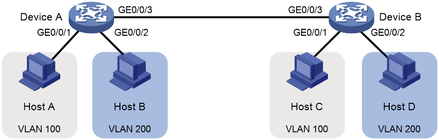

Configuring VLANs
About VLANs
The Virtual Local Area Network (VLAN) technology divides a physical LAN into multiple logical LANs. It has the following benefits:
·     Security—Hosts in the same VLAN can communicate with one another at Layer 2, but they are isolated from hosts in other VLANs at Layer 2.
·     Broadcast traffic isolation—Each VLAN is a broadcast domain that limits the transmission of broadcast packets.
·     Flexibility—A VLAN can be logically divided on a workgroup basis. Hosts in the same workgroup can be assigned to the same VLAN, regardless of their physical locations.

Example: Configuring port-based VLANs
As shown in Figure 2:
·     Host A and Host C belong to Department A. VLAN 100 is assigned to Department A.
·     Host B and Host D belong to Department B. VLAN 200 is assigned to Department B.
Configure port-based VLANs so that only hosts in the same department can communicate with each other.
Figure 2 Network diagram
1.     Configure Device A:
# Create VLAN 100, and assign GigabitEthernet 0/0/1 to VLAN 100.
<DeviceA> system-view
[DeviceA] vlan 100
[DeviceA-vlan100] port gigabitethernet 0/0/1
[DeviceA-vlan100] quit
# Create VLAN 200, and assign GigabitEthernet 0/0/2 to VLAN 200.
[DeviceA] vlan 200
[DeviceA-vlan200] port gigabitethernet 0/0/2
[DeviceA-vlan200] quit
# Configure GigabitEthernet 0/0/3 as a trunk port, and assign the port to VLANs 100 and 200.
[DeviceA] interface gigabitethernet 0/0/3
[DeviceA-GigabitEthernet0/0/3] port link-type trunk
[DeviceA-GigabitEthernet0/0/3] port trunk permit vlan 100 200
Please wait... Done.
2.     Configure Device B in the same way Device A is configured. (Details not shown.)
3.     Configure hosts:
a.     Configure Host A and Host C to be on the same IP subnet. For example, 192.168.100.0/24.
b.     Configure Host B and Host D to be on the same IP subnet. For example, 192.168.200.0/24.
# Verify that Host A and Host C can ping each other, but they both fail to ping Host B and Host D. (Details not shown.)
# Verify that Host B and Host D can ping each other, but they both fail to ping Host A and Host C. (Details not shown.)
# Verify that VLANs 100 and 200 are correctly configured on Device A.
[DeviceA-GigabitEthernet0/0/3] display vlan 100
 VLAN ID: 100
 VLAN type: Static
 Route interface: Not configured
 Description: VLAN 0100
 Tagged ports:
 Untagged ports:
    GigabitEthernet0/0/1
[DeviceA-GigabitEthernet0/0/3] display vlan 200
 VLAN ID: 200
 VLAN type: Static
 Description: VLAN 0200
 Tagged ports:
 Untagged ports:
    GigabitEthernet0/0/2
