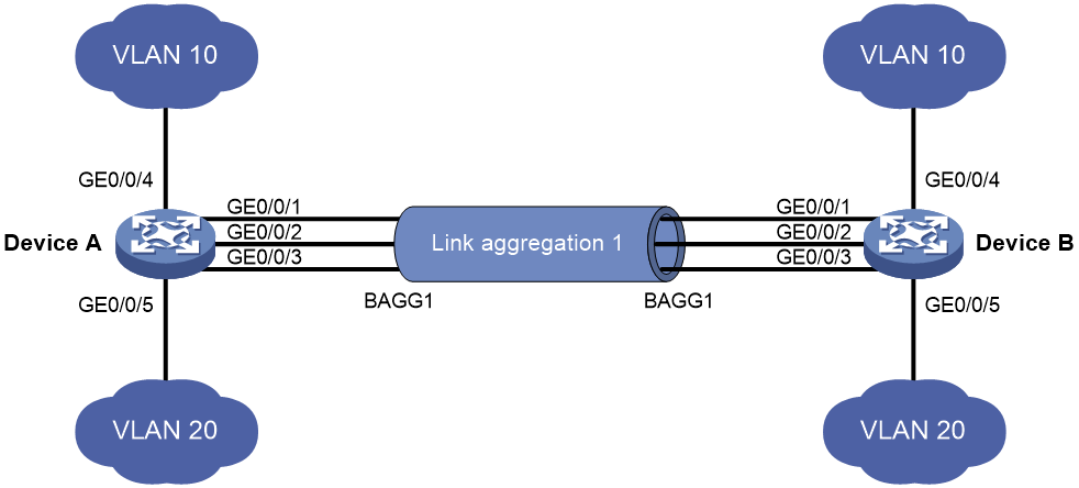

Ethernet link aggregation application scenario
As shown in Figure 1, Device A and Device B are connected by three physical Ethernet links. These physical Ethernet links are combined into an aggregate link called link aggregation 1. The bandwidth of this aggregate link can reach up to the total bandwidth of the three physical Ethernet links. At the same time, the three Ethernet links back up one another. When a physical Ethernet link fails, the traffic transmitted on the failed link is switched to the other two links.
Figure 1 Ethernet link aggregation diagram

Ethernet link aggregation configuration examples
Example: Configuring a Layer 2 static aggregation group
On the network shown in Figure 6, perform the following tasks:
·     Configure a Layer 2 static aggregation group on both Device A and Device B.
·     Enable VLAN 10 at one end of the aggregate link to communicate with VLAN 10 at the other end.
·     Enable VLAN 20 at one end of the aggregate link to communicate with VLAN 20 at the other end.
Figure 6 Network diagram
1.     Configure Device A:
# Create VLAN 10, and assign port GigabitEthernet 0/0/4 to VLAN 10.
<DeviceA> system-view
[DeviceA] vlan 10
[DeviceA-vlan10] port gigabitethernet 0/0/4
[DeviceA-vlan10] quit
# Create VLAN 20, and assign port GigabitEthernet 0/0/5 to VLAN 20.
[DeviceA] vlan 20
[DeviceA-vlan20] port gigabitethernet 0/0/5
[DeviceA-vlan20] quit
# Create Layer 2 aggregate interface Bridge-Aggregation 1.
[DeviceA] interface bridge-aggregation 1
[DeviceA-Bridge-Aggregation1] quit
# Assign ports GigabitEthernet 0/0/1 through GigabitEthernet 0/0/3 to link aggregation group 1.
[DeviceA] interface gigabitethernet 0/0/1
[DeviceA-GigabitEthernet0/0/1] port link-aggregation group 1
[DeviceA-GigabitEthernet0/0/1] quit
[DeviceA] interface gigabitethernet 0/0/2
[DeviceA-GigabitEthernet0/0/2] port link-aggregation group 1
[DeviceA-GigabitEthernet0/0/2] quit
[DeviceA] interface gigabitethernet 0/0/3
[DeviceA-GigabitEthernet0/0/3] port link-aggregation group 1
[DeviceA-GigabitEthernet0/0/3] quit
# Configure Layer 2 aggregate interface Bridge-Aggregation 1 as a trunk port and assign it to VLANs 10 and 20.
[DeviceA-Bridge-Aggregation1] port link-type trunk
[DeviceA-Bridge-Aggregation1] port trunk permit vlan 10 20
2.     Configure Device B in the same way Device A is configured. (Details not shown.)
# Display detailed information about all aggregation groups on Device A.
[DeviceA] display link-aggregation verbose
Loadsharing Type: Shar -- Loadsharing, NonS -- Non-Loadsharing
Port Status: S -- Selected, U -- Unselected, I -- Individual
Port: A -- Auto port, M -- Management port, R -- Reference port
Flags:  A -- LACP_Activity, B -- LACP_Timeout, C -- Aggregation,
        G -- Defaulted, H -- Expired
Aggregate Interface: Bridge-Aggregation1
Aggregation Mode: Static
Management VLANs: None
  Port             Status  Priority Oper-Key
  GE0/0/1(R)       S       32768    1
  GE0/0/2          S       32768    1
  GE0/0/3          S       32768    1
The output shows that link aggregation group 1 is a Layer 2 static aggregation group that contains three Selected ports.

Example: Configuring a Layer 3 static aggregation group
On the network shown in Figure 9, perform the following tasks:
·     Configure a Layer 3 static aggregation group on both Device A and Device B.
·     Configure IP addresses and subnet masks for the corresponding Layer 3 aggregate interfaces.
Figure 9 Network diagram
# Create Layer 3 aggregate interface Route-Aggregation 1, and configure an IP address and subnet mask for the aggregate interface.
[DeviceA] interface route-aggregation 1
[DeviceA-Route-Aggregation1] ip address 192.168.1.1 24
[DeviceA-Route-Aggregation1] quit
# Assign Layer 3 Ethernet interfaces GigabitEthernet 0/0/1 through GigabitEthernet 0/0/3 to aggregation group 1.
