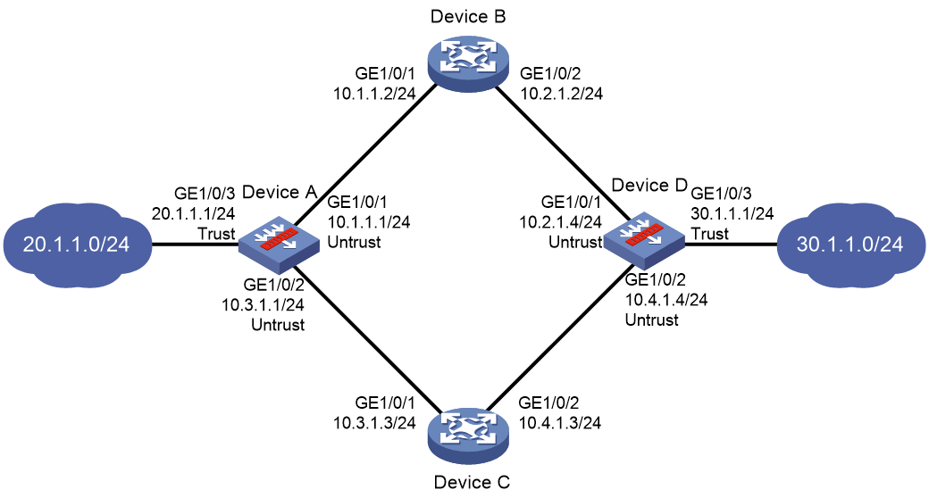

Collaboration application example
The following is an example of collaboration between NQA, Track, and static routing.
Configure a static route with next hop 192.168.0.88 on the device. If the next hop is reachable, the static route is valid. If the next hop becomes unreachable, the static route is invalid. For this purpose, configure NQA-Track-static routing collaboration as follows:
1.     Create an NQA operation to monitor the accessibility of IP address 192.168.0.88.
2.     Create a track entry and associate it with the NQA operation.
¡     When next hop 192.168.0.88 is reachable, NQA sends the result to the Track module. The Track module sets the track entry to Positive state.
¡     When the next hop becomes unreachable, NQA sends the result to the Track module. The Track module sets the track entry to Negative state.
3.     Associate the track entry with the static route.
¡     When the track entry is in Positive state, the static routing module considers the static route to be valid.
¡     When the track entry is in Negative state, the static routing module considers the static route to be invalid.

As shown in Figure 2:
·     Device A is the default gateway of the hosts in network 20.1.1.0/24.
·     Device D is the default gateway of the hosts in network 30.1.1.0/24.
·     Hosts in the two networks communicate with each other through static routes.
To ensure network availability, configure route backup and static routing-Track-NQA collaboration on Device A and Device D as follows:
·     On Device A, assign a higher priority to the static route to 30.1.1.0/24 with next hop Device B. This route is the master route. The static route to 30.1.1.0/24 with next hop Device C acts as the backup route. When the master route is unavailable, the backup route takes effect.
·     On Device D, assign a higher priority to the static route to 20.1.1.0/24 with next hop Device B. This route is the master route. The static route to 20.1.1.0/24 with next hop Device C acts as the backup route. When the master route is unavailable, the backup route takes effect.
Figure 2 Network diagram

5.     Create an NQA operation to test connectivity of path Device A—Device B—Device D.
[DeviceA] nqa entry admin test
[DeviceA-nqa-admin-test] type icmp-echo
[DeviceA-nqa-admin-test-icmp-echo] destination ip 10.2.1.4
[DeviceA-nqa-admin-test-icmp-echo] next-hop ip 10.1.1.2
[DeviceA-nqa-admin-test-icmp-echo] frequency 100
[DeviceA-nqa-admin-test-icmp-echo] reaction 1 checked-element probe-fail threshold-type consecutive 5 action-type trigger-only
[DeviceA-nqa-admin-test-icmp-echo] quit
[DeviceA] nqa schedule admin test start-time now lifetime forever
6.     Associate track entry 1 with reaction entry 1 of the NQA operation.
[DeviceA] track 1 nqa entry admin test reaction 1
[DeviceA-track-1] quit

# Display track entry information on Device A.
[DeviceA] display track all
Track ID: 1
  State: Positive
  Duration: 0 days 0 hours 0 minutes 32 seconds
  Tracked object type: NQA
  Notification delay: Positive 0, Negative 0 (in seconds)
  Tracked object:
    NQA entry: admin test
    Reaction: 1
    Remote IP/URL: 10.2.1.4
    Local IP:--
    Interface:--
The output shows that the status of track entry 1 is Positive, indicating that the NQA operation has succeeded and the master route is available.
# Display the routing table of Device A.
[DeviceA] display ip routing-table
Destinations : 10       Routes : 10
10.1.1.0/24         Direct 0    0            10.1.1.1        GE1/0/1
10.1.1.1/32         Direct 0    0            127.0.0.1       InLoop0
10.2.1.0/24         Static 60   0            10.1.1.2        GE1/0/1
10.3.1.0/24         Direct 0    0            10.3.1.1        GE1/0/2
10.3.1.1/32         Direct 0    0            127.0.0.1       InLoop0
20.1.1.0/24         Direct 0    0            20.1.1.1        GE1/0/3
20.1.1.1/32         Direct 0    0            127.0.0.1       InLoop0
30.1.1.0/24         Static 60   0            10.1.1.2        GE1/0/1
127.0.0.0/8         Direct 0    0            127.0.0.1       InLoop0
127.0.0.1/32        Direct 0    0            127.0.0.1       InLoop0
The output shows that Device A forwards packets to 30.1.1.0/24 through Device B.
# Remove the IP address of GigabitEthernet 1/0/1 on Device B.
<DeviceB> system-view
[DeviceB-GigabitEthernet1/0/1] undo ip address
# Display information about the track entry on Device A.
Track ID: 1
  State: Negative
  Tracked object:
    Reaction: 1
    Local IP:--
    Interface:--
The output shows that the status of the track entry is Negative, indicating that the NQA operation has failed and the master route is unavailable.
30.1.1.0/24         Static 80   0            10.3.1.3        GE1/0/2
The output shows that Device A forwards packets to 30.1.1.0/24 through Device C. The backup static route has taken effect.
# Verify that hosts in 20.1.1.0/24 can communicate with the hosts in 30.1.1.0/24 when the master route fails.
[DeviceA] ping -a 20.1.1.1 30.1.1.1
Ping 30.1.1.1: 56  data bytes, press CTRL_C to break
Reply from 30.1.1.1: bytes=56 Sequence=1 ttl=254 time=2 ms
Reply from 30.1.1.1: bytes=56 Sequence=2 ttl=254 time=1 ms
Reply from 30.1.1.1: bytes=56 Sequence=3 ttl=254 time=1 ms
Reply from 30.1.1.1: bytes=56 Sequence=4 ttl=254 time=2 ms
Reply from 30.1.1.1: bytes=56 Sequence=5 ttl=254 time=1 ms
--- Ping statistics for 30.1.1.1 ---
5 packet(s) transmitted, 5 packet(s) received, 0.00% packet loss
round-trip min/avg/max/std-dev = 1/1/2/1 ms
# Verify that the hosts in 30.1.1.0/24 can communicate with the hosts in 20.1.1.0/24 when the master route fails.
[DeviceD] ping -a 30.1.1.1 20.1.1.1
Ping 20.1.1.1: 56  data bytes, press CTRL_C to break
Reply from 20.1.1.1: bytes=56 Sequence=1 ttl=254 time=2 ms
Reply from 20.1.1.1: bytes=56 Sequence=2 ttl=254 time=1 ms
Reply from 20.1.1.1: bytes=56 Sequence=3 ttl=254 time=1 ms
Reply from 20.1.1.1: bytes=56 Sequence=4 ttl=254 time=1 ms
Reply from 20.1.1.1: bytes=56 Sequence=5 ttl=254 time=1 ms
--- Ping statistics for 20.1.1.1 ---

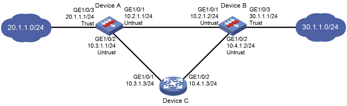

Example: Configuring static routing-Track-BFD collaboration
As shown in Figure 3:
·     Device B is the default gateway of the hosts in network 30.1.1.0/24.
To ensure network availability, configure route backup and static routing-Track-BFD collaboration on Device A and Device B as follows:
·     On Device A, assign a higher priority to the static route to 30.1.1.0/24 with next hop Device B. This route is the master route. The static route to 30.1.1.0/24 with next hop Device C acts as the backup route. When the master route is unavailable, BFD can quickly detect the route failure to make the backup route take effect.
·     On Device B, assign a higher priority to the static route to 20.1.1.0/24 with next hop Device A. This route is the master route. The static route to 20.1.1.0/24 with next hop Device C acts as the backup route. When the master route is unavailable, BFD can quickly detect the route failure to make the backup route take effect.
Figure 3 Network diagram

[DeviceA-security-zone-Untrust] import interface gigabitethernet 1/0/2
[DeviceA-security-zone-Untrust] quit
[DeviceA] security-zone name trust
[DeviceA-security-zone-Trust] import interface gigabitethernet 1/0/3
[DeviceA-security-zone-Trust] quit
4.     Configure a security policy:
# Configure a rule named trust-untrust to permit packets from network 20.1.1.0/24 to network 30.1.1.0/24.
[DeviceA] security-policy ip
[DeviceA-security-policy-ip] rule name trust-untrust
[DeviceA-security-policy-ip-1-trust-untrust] source-zone trust
[DeviceA-security-policy-ip-1-trust-untrust] destination-zone untrust
[DeviceA-security-policy-ip-1-trust-untrust] source-ip-subnet 20.1.1.0 24
[DeviceA-security-policy-ip-1-trust-untrust] destination-ip-subnet 30.1.1.0 24
[DeviceA-security-policy-ip-1-trust-untrust] action pass
[DeviceA-security-policy-ip-1-trust-untrust] quit
# Configure a rule named untrust-trust to permit packets from network 30.1.1.0/24 to network 20.1.1.0/24.
[DeviceA-security-policy-ip] rule name untrust-trust
[DeviceA-security-policy-ip-2-untrust-trust] source-zone untrust
[DeviceA-security-policy-ip-2-untrust-trust] destination-zone trust
[DeviceA-security-policy-ip-2-untrust-trust] source-ip-subnet 30.1.1.0 24
[DeviceA-security-policy-ip-2-untrust-trust] destination-ip-subnet 20.1.1.0 24
[DeviceA-security-policy-ip-2-untrust-trust] action pass
[DeviceA-security-policy-ip-2-untrust-trust] quit
# Configure a rule named bfdlocalout to allow Device A to send BFD echo packets to Device B.
[DeviceA-security-policy-ip] rule name bfdlocalout
[DeviceA-security-policy-ip-3-bfdlocalout] source-zone local
[DeviceA-security-policy-ip-3-bfdlocalout] destination-zone untrust
[DeviceA-security-policy-ip-2-bfdlocalout] service bfd-echo
[DeviceA-security-policy-ip-3-bfdlocalout] action pass
[DeviceA-security-policy-ip-3-bfdlocalout] quit
# Configure a rule named bfdlocalin to allow Device A to receive BFD echo packets.
[DeviceA-security-policy-ip] rule name bfdlocalin
[DeviceA-security-policy-ip-4-bfdlocalin] source-zone untrust
[DeviceA-security-policy-ip-4-bfdlocalin] destination-zone local
[DeviceA-security-policy-ip-2-bfdlocalin] service bfd-echo
[DeviceA-security-policy-ip-4-bfdlocalin] action pass
[DeviceA-security-policy-ip-4-bfdlocalin] quit
# Configure a rule named untrust-untrust to allow Device A to respond to the BFD echo packets from Device B.
[DeviceA-security-policy-ip] rule name untrust-untrust
[DeviceA-security-policy-ip-5-untrust-untrust] source-zone untrust
[DeviceA-security-policy-ip-5-untrust-untrust] destination-zone untrust
[DeviceA-security-policy-ip-5-untrust-untrust] source-ip-host 1.1.1.1
[DeviceA-security-policy-ip-5-untrust-untrust] destination-ip-host 10.2.1.2
[DeviceA-security-policy-ip-5-untrust-untrust] action pass
[DeviceA-security-policy-ip-5-untrust-untrust] quit
# Configure a rule named pinglocalout to allow Device A to send ping packets to Device B.
[DeviceA-security-policy-ip] rule name pinglocalout
[DeviceA-security-policy-ip-6-pinglocalout] source-zone local
[DeviceA-security-policy-ip-6-pinglocalout] destination-zone untrust
[DeviceA-security-policy-ip-6-pinglocalout] service ping
[DeviceA-security-policy-ip-6-pinglocalout] action pass
[DeviceA-security-policy-ip-6-pinglocalout] quit
# Configure a rule named pinglocalin to allow Device A to respond to the ping packets from Device B.
[DeviceA-security-policy-ip] rule name pinglocalin
[DeviceA-security-policy-ip-7-pinglocalin] source-zone untrust
[DeviceA-security-policy-ip-7-pinglocalin] destination-zone local
[DeviceA-security-policy-ip-7-pinglocalin] service ping
[DeviceA-security-policy-ip-7-pinglocalin] action pass
[DeviceA-security-policy-ip-7-pinglocalin] quit
[DeviceA-security-policy-ip] quit
5.     Specify 10.10.10.10 as the source address for BFD echo packets.
[DeviceA] bfd echo-source-ip 10.10.10.10
6.     Configure track entry 1, and associate it with the BFD session to verify the connectivity between Device A and Device B.
[DeviceA] track 1 bfd echo interface gigabitethernet 1/0/1 remote ip 10.2.1.2 local ip 10.2.1.1
Configuring Device B
1.     Assign IP addresses to interfaces:
# Assign an IP address to interface GigabitEthernet 1/0/1.
[DeviceB-GigabitEthernet1/0/1] ip address 10.2.1.2 255.255.255.0
[DeviceB-GigabitEthernet1/0/1] quit
2.     Configure settings for routing:
# Configure a main static route to 20.1.1.0/24 with next hop 10.2.1.1 and default priority 60, and associate the static route with track entry 1.
[DeviceB] ip route-static 20.1.1.0 24 10.2.1.1 track 1
# Configure a backup static route to 20.1.1.0/24 with next hop 10.4.1.3 and priority 80.
[DeviceB] ip route-static 20.1.1.0 24 10.4.1.3 preference 80
3.     Add interfaces to security zones.
[DeviceB] security-zone name untrust
[DeviceB-security-zone-Untrust] import interface gigabitethernet 1/0/1
[DeviceB-security-zone-Untrust] import interface gigabitethernet 1/0/2
[DeviceB-security-zone-Untrust] quit
[DeviceB] security-zone name trust
[DeviceB-security-zone-Trust] import interface gigabitethernet 1/0/3
[DeviceB-security-zone-Trust] quit
# Configure a rule named trust-untrust to permit packets from network 30.1.1.0/24 to network 20.1.1.0/24.
[DeviceB] security-policy ip
[DeviceB-security-policy-ip] rule name trust-untrust
[DeviceB-security-policy-ip-1-trust-untrust] source-zone trust
[DeviceB-security-policy-ip-1-trust-untrust] destination-zone untrust
[DeviceB-security-policy-ip-1-trust-untrust] source-ip-subnet 30.1.1.0 24
[DeviceB-security-policy-ip-1-trust-untrust] destination-ip-subnet 20.1.1.0 24
[DeviceB-security-policy-ip-1-trust-untrust] action pass
[DeviceB-security-policy-ip-1-trust-untrust] quit
# Configure a rule named untrust-trust to permit packets from network 20.1.1.0/24 to network 30.1.1.0/24.
[DeviceB-security-policy-ip] rule name untrust-trust
[DeviceB-security-policy-ip-2-untrust-trust] source-zone untrust
[DeviceB-security-policy-ip-2-untrust-trust] destination-zone trust
[DeviceB-security-policy-ip-2-untrust-trust] source-ip-subnet 20.1.1.0 24
[DeviceB-security-policy-ip-2-untrust-trust] destination-ip-subnet 30.1.1.0 24
[DeviceB-security-policy-ip-2-untrust-trust] action pass
[DeviceB-security-policy-ip-2-untrust-trust] quit
# Configure a rule named bfdlocalout to allow Device B to send BFD echo packets to Device A.
[DeviceB-security-policy-ip] rule name bfdlocalout
[DeviceB-security-policy-ip-3-bfdlocalout] source-zone local
[DeviceB-security-policy-ip-3-bfdlocalout] destination-zone untrust
[DeviceB-security-policy-ip-3-bfdlocalout] service bfd-echo
[DeviceB-security-policy-ip-3-bfdlocalout] action pass
[DeviceB-security-policy-ip-3-bfdlocalout] quit
# Configure a rule named bfdlocalin to allow Device B to receive BFD echo packets.
[DeviceB-security-policy-ip] rule name bfdlocalin
[DeviceB-security-policy-ip-4-bfdlocalin] source-zone untrust
[DeviceB-security-policy-ip-4-bfdlocalin] destination-zone local
[DeviceB-security-policy-ip-4-bfdlocalin] service bfd-echo
[DeviceB-security-policy-ip-4-bfdlocalin] action pass
[DeviceB-security-policy-ip-4-bfdlocalin] quit
# Configure a rule named untrust-untrust to allow Device B to respond to the BFD echo packets from Device A.
[DeviceB-security-policy-ip] rule name untrust-untrust
[DeviceB-security-policy-ip-5-untrust-untrust] source-zone untrust
[DeviceB-security-policy-ip-5-untrust-untrust] destination-zone untrust
[DeviceB-security-policy-ip-5-untrust-untrust] source-ip-host 10.10.10.10
[DeviceB-security-policy-ip-5-untrust-untrust] destination-ip-host 10.2.1.1
[DeviceB-security-policy-ip-5-untrust-untrust] action pass
[DeviceB-security-policy-ip-5-untrust-untrust] quit
# Configure a rule named pinglocalout to allow Device B to send ping packets to Device A.
[DeviceB-security-policy-ip] rule name pinglocalout
[DeviceB-security-policy-ip-6-pinglocalout] source-zone local
[DeviceB-security-policy-ip-6-pinglocalout] destination-zone untrust
[DeviceB-security-policy-ip-6-pinglocalout] service ping
[DeviceB-security-policy-ip-6-pinglocalout] action pass
[DeviceB-security-policy-ip-6-pinglocalout] quit
# Configure a rule named pinglocalin to allow Device B to respond to the ping packets from Device A.
[DeviceB-security-policy-ip] rule name pinglocalin
[DeviceB-security-policy-ip-7-pinglocalin] source-zone untrust
[DeviceB-security-policy-ip-7-pinglocalin] destination-zone local
[DeviceB-security-policy-ip-7-pinglocalin] service ping
[DeviceB-security-policy-ip-7-pinglocalin] action pass
[DeviceB-security-policy-ip-7-pinglocalin] quit
[DeviceB-security-policy-ip] quit
5.     Specify 1.1.1.1 as the source address of BFD echo packets.
[DeviceB] bfd echo-source-ip 1.1.1.1
6.     Configure track entry 1, and associate it with the BFD session to verify the connectivity between Device B and Device A.
[DeviceB] track 1 bfd echo interface gigabitethernet 1/0/1 remote ip 10.2.1.1 local ip 10.2.1.2
[DeviceB-track-1] quit
Configuring Device C
<DeviceC> system-view
[DeviceC] interface gigabitethernet 1/0/1
[DeviceC-GigabitEthernet1/0/1] ip address 10.3.1.3 255.255.255.0
[DeviceC-GigabitEthernet1/0/1] quit
# Configure a static route to 30.1.1.0/24 with next hop 10.4.1.2.
[DeviceC] ip route-static 30.1.1.0 24 10.4.1.2
# Configure a static route to 20.1.1.0/24 with next hop 10.3.1.1.
[DeviceC] ip route-static 20.1.1.0 24 10.3.1.1
Track ID: 1
  State: Positive
  Tracked object type: BFD
  Tracked object:
    BFD session mode: Echo
    Outgoing interface: GigabitEthernet1/0/1
    VPN instance name: --
    Remote IP: 10.2.1.2
    Local IP: 10.2.1.1
The output shows that the status of the track entry is Positive, indicating that next hop 10.2.1.2 is reachable.
Destinations : 9        Routes : 9
10.2.1.0/24         Direct 0    0            10.2.1.1        GE1/0/1
10.2.1.1/32         Direct 0    0            127.0.0.1       InLoop0
30.1.1.0/24         Static 60   0            10.2.1.2        GE1/0/1
The output shows that Device A forwards packets to 30.1.1.0/24 through Device B. The master static route has taken effect.
Track ID: 1
  State: Negative
  Tracked object:
    Remote IP: 10.2.1.2
    Local IP: 10.2.1.1
The output shows that the status of the track entry is Negative, indicating that next hop 10.2.1.2 is unreachable.
# Verify that the hosts in 20.1.1.0/24 can communicate with the hosts in 30.1.1.0/24 when the master route fails.
[DeviceB] ping -a 30.1.1.1 20.1.1.1
