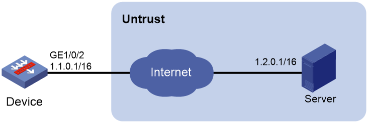

Fast log output configuration examples
Example: Configuring fast log output to a log host
As shown in Figure 1, configure fast log output on the device to send session logs to the log server.
Figure 1 Network diagram
1.     Assign IP addresses to interface GigabitEthernet 1/0/2.
<Device> system-view
[Device] interface gigabitethernet 1/0/2
[Device-GigabitEthernet1/0/2] ip address 1.1.0.1 255.255.0.0
[Device-GigabitEthernet1/0/2] quit
2.     Configure settings for routing.
This example configures a static route, and the next hop in the router is 1.1.0.2.
[Device] ip route-static 1.2.0.0 16 1.1.0.2
3.     Add interface GigabitEthernet 1/0/2 to security zone untrust.
[Device] security-zone name untrust
[Device-security-zone-Untrust] import interface gigabitethernet 1/0/2
[Device-security-zone-Untrust] quit
4.     Configure a security policy:
# Configure a rule named loglocalout to allow the device to send fast log output messages to the server.
[Device] security-policy ip
[Device-security-policy-ip] rule name loglocalout
[Device-security-policy-ip-1-loglocalout] source-zone local
[Device-security-policy-ip-1-loglocalout] destination-zone untrust
[Device-security-policy-ip-1-loglocalout] source-ip-host 1.1.0.1
[Device-security-policy-ip-1-loglocalout] destination-ip-host 1.2.0.1
[Device-security-policy-ip-1-loglocalout] action pass
[Device-security-policy-ip-1-loglocalout] quit
[Device-security-policy-ip] quit
5.     Configure fast log output. Enable fast log output, configure log output to the log server, and enable logging for session creation and deletion. Enable IPv4 session logging in the inbound direction of the interface connected to the internal network.
[Device] customlog format session
[Device] customlog host 1.2.0.1 port 1000 export session
[Device] session log flow-begin
[Device] session log flow-end
[Device-GigabitEthernet1/0/1] session log enable ipv4 inbound
On the server, verify that logs are received from the device successfully.
