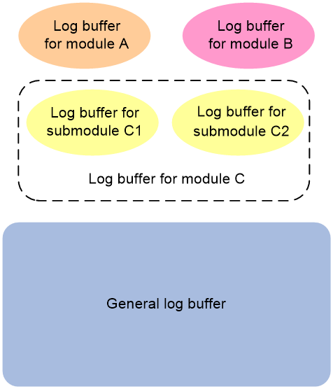

Outputting logs to the log buffer
This feature enables log output to log buffers based on the log source modules. Log buffers include the following types:
·     Separate module-specific log buffers—Logs generated by modules or submodules that have separate log buffers are saved to their respective log buffers.
For example, session logs and attack defense logs are saved to the session log buffer and the attack defense log buffer, respectively. With separate buffers, you can manage and view the module-specific logs and general logs conveniently.
The modules and submodules that have separate log buffers are determined by factory settings. To view the names of supported modules and submodules, use the display logbuffer module ? command and the display logbuffer module module-name submodule ? command, respectively. You can use the display logbuffer module module-name to view buffered logs of the specified module. You can use the display logbuffer module module-name and submodule submodule-name command to view buffered logs of the specified submodule.
·     General log buffer—Logs generated by the system and the modules other than the modules and submodules that have separate log buffers are saved to the general log buffer.
You can use the display logbuffer command without the module keyword to view buffered logs in the general log buffer.
Figure 2 Genratal log buffer and separate log buffers for modules and submodules

Setting the minimum storage period for logs
About setting the minimum storage period
Use this feature to set the minimum storage period for logs in log buffers and log files. This feature ensures that logs will not be overwritten by new logs during a set period of time.
Logs of the modules that have separate log buffers and log files are output to their respective log buffers or log files. Logs of other modules and the system logs are output the general log buffer or log file. By default, when a log buffer or log file is full, new logs will automatically overwrite the oldest logs. After the minimum storage period is set, the system identifies the storage period of a log to determine whether to delete the log. The system current time minus a log's generation time is the log's storage period.
·     If the storage period of a log is shorter than or equal to the minimum storage period, the system does not delete the log. The new log will not be saved.
·     If the storage period of a log is longer than the minimum storage period, the system deletes the log to save the new log.
Setting the minimum storage period for logs in a module-specific log buffer or log file
2.     Set the minimum storage period for logs stored in the log buffer or log file of a module.
info-center syslog module module-name min-age min-age
By default, the log minimum storage period is not set.
Setting the minimum storage period for logs in the general log buffer and log file
2.     Set the minimum storage period for logs stored in the general log buffer and log file.
info-center syslog min-age min-age
