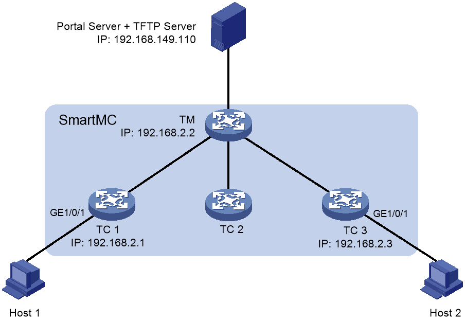

Example: Configuring static endpoint identification
As shown in Figure 3, the SmartMC network is established manually. Configure the devices in SmartMC network so EPA can automatically identify camera 1 and camera 2 when they access the SmartMC network.

2. Configure static endpoint identification rules on the commander.
[TM] epa monitor-rule mac 1-1-1
[TM] epa monitor-rule mac 2-2-2

# On TC 1, display the online and offline information of endpoints.
[TC1] display epa monitor-information verbose
Auto identification : Disabled
Local device type : SmartMC TC
Local device ID : 3acc-58e2-0100
Total endpoints identified by EPA: 1
Access device ID: 3acc-58e2-0100
MAC address : 0001-0001-0001 VLAN : 1
IP address : -
Interface : GigabitEthernet1/0/1 Status: Online
Category : Camera Vendor: -
OS : -
# On the TM, display the online and offline information of endpoints.
[TM] display epa monitor-information verbose
Local device type : SmartMC TM
Local device ID : 90bc-1b85-0300
Total endpoints identified by EPA: 2
IP address : 192.168.2.11
OS : -
Access device ID: 3acc-58e2-0300
MAC address : 0002-0002-0002 VLAN : 1
IP address : 192.168.2.12

Example: Configuring automatic endpoint identification (portal authentication)
As shown in Figure 4, the SmartMC network is established automatically. Configure the devices in SmartMC network so EPA can automatically identify host 1 and host 2 when they access the SmartMC network through portal authentication.

3. Configure a BYOD endpoint identification rule:
# Configure a rule to identify BYOD endpoints containing HTTP UserAgent fingerprint Mozilla/5.0.
[TC1] byod rule http-user-agent Mozilla/5.0 device-attributes
# Configure at least one piece of the following fingerprint information.
[TC1-byod-ua-Mozilla/5.0] device-category PC
[TC1-byod-ua-Mozilla/5.0] device-vendor Xerox
[TC1-byod-ua-Mozilla/5.0] device-os "Window Vista/7 or Server 2008 (Version 6.0)"
[TC1-byod-ua-Mozilla/5.0] quit
Configuring TC 3
# Configure TC 3 in the same way TC 1 is configured. (Details not shown.)
# On TC 1, verify that EPA can successfully identify the hosts when they come online.
Auto identification : Enabled
MAC address : 0a00-2700-0010 VLAN : -
IP address : 192.168.226.1
Category : PC Vendor: Xerox
OS : Windows Vista/7 or Server 2008 (Version 6.0)
# On the TM, verify that EPA can successfully identify the hosts when they come online.
MAC address : 0001-0001-0001 VLAN : -
MAC address : 0002-0002-0002 VLAN : -
IP address : 192.168.226.2

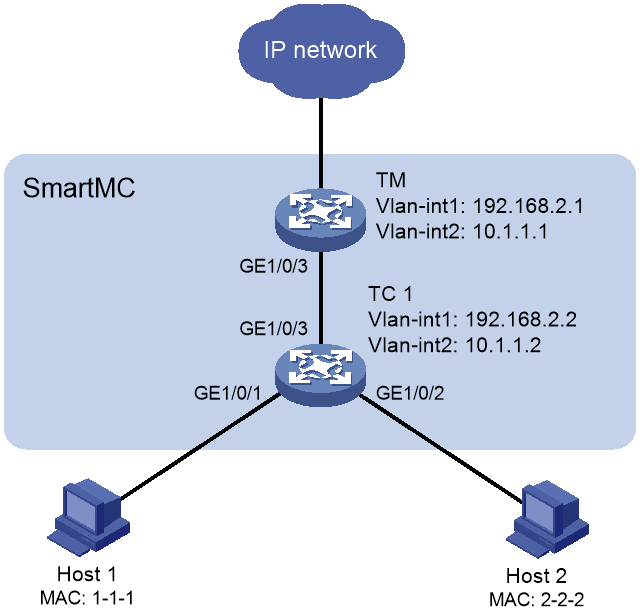

Example: Configuring automatic endpoint identification (DHCP)
As shown in Figure 5, the SmartMC network is established automatically. Configure the devices in SmartMC network so EPA can automatically identify host 1 and host 2 when they access the SmartMC network through DHCP.

4. Configure a BYOD endpoint identification rule:
If you use the default fingerprint information, skip this step.
# Configure a rule to identify BYOD endpoints containing DHCP Option55 fingerprint 1,121,3,6,12,15,33,43,66,67,138,150.
[TC1] byod rule dhcp-option 1,121,3,6,12,15,33,43,66,67,138,150 device-attribute
[TC1-byod-opt-1,121,3,6,12,15,33,43,66,67,138,150] device-category PC
[TC1-byod-opt-1,121,3,6,12,15,33,43,66,67,138,150] device-vendor Xerox
[TC1-byod-opt-1,121,3,6,12,15,33,43,66,67,138,150] device-os "Window Vista/7 or Server 2008 (Version 6.0)"
[TC1-byod-opt-1,121,3,6,12,15,33,43,66,67,138,150] quit
5. Configure host 1 and host 2 to obtain IP addresses through DHCP.
MAC address : 0001-0001-0001 VLAN : 2
IP address : 10.1.1.3
OS : Window Vista/7 or Server 2008 (Version 6.0)
MAC address : 0002-0002-0002 VLAN : 2
IP address : 10.1.1.4
Interface : GigabitEthernet1/0/2 Status: Online
