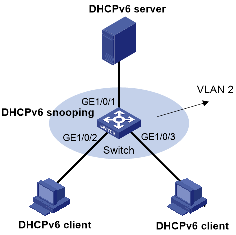

Example: Configuring DHCPv6-only SAVI
As shown in Figure 1, configure SAVI on the switch to meet the following requirements:
·     Clients obtain IPv6 addresses only through DHCPv6.
·     SAVI checks the source addresses of DHCPv6 messages, ND messages (RA and RR messages excluded), and IPv6 data packets on GigabitEthernet 1/0/2 and GigabitEthernet 1/0/3.
Figure 1 Network diagram
# Enable SAVI.
<Switch> system-view
[Switch] ipv6 savi strict
# Assign GigabitEthernet 1/0/1 through GigabitEthernet 1/0/3 to VLAN 2.
[Switch] vlan 2
[Switch-vlan2] port gigabitethernet 1/0/1 gigabitethernet 1/0/2 gigabitethernet 1/0/3
[Switch-vlan2] quit
# Enable DHCPv6 snooping.
[Switch] ipv6 dhcp snooping enable
# Configure GigabitEthernet 1/0/1 as a DHCPv6 snooping trusted port.
[Switch] interface gigabitethernet 1/0/1
[Switch-GigabitEthernet1/0/1] ipv6 dhcp snooping trust
[Switch-GigabitEthernet1/0/1] quit
# Enable recording DHCPv6 snooping entries on GigabitEthernet 1/0/2 and GigabitEthernet 1/0/3.
[Switch] interface gigabitethernet 1/0/2
[Switch-GigabitEthernet1/0/2] ipv6 dhcp snooping binding record
[Switch-GigabitEthernet1/0/2] quit
[Switch] interface gigabitethernet 1/0/3
[Switch-GigabitEthernet1/0/3] ipv6 dhcp snooping binding record
[Switch-GigabitEthernet1/0/3] quit
# Enable ND attack detection.
[Switch] vlan 2
[Switch-vlan2] ipv6 nd detection enable
[Switch-vlan2] quit
# Enable IPv6 source guard on GigabitEthernet 1/0/2 and GigabitEthernet 1/0/3.
[Switch-GigabitEthernet1/0/2] ipv6 verify source ip-address mac-address
[Switch-GigabitEthernet1/0/3] ipv6 verify source ip-address mac-address

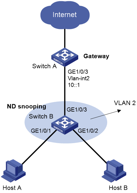

Example: Configuring SLAAC-only SAVI
As shown in Figure 2, configure SAVI on Switch B to meet the following requirements:
·     Hosts obtain IPv6 addresses only through SLAAC.
·     DHCPv6 messages are dropped on GigabitEthernet 1/0/1 through GigabitEthernet 1/0/3 in VLAN 2.
·     SAVI checks the source addresses of ND messages and IPv6 data packets on GigabitEthernet 1/0/1 and GigabitEthernet 1/0/2.
Figure 2 Network diagram
# Enable SAVI.
<SwitchB> system-view
[SwitchB] ipv6 savi strict
[SwitchB] vlan 2
[SwitchB-vlan2] port gigabitethernet 1/0/1 gigabitethernet 1/0/2 gigabitethernet 1/0/3
[SwitchB-vlan2] quit
# Enable ND snooping for global unicast addresses in VLAN 2.
[SwitchB] vlan 2
[SwitchB-vlan2] ipv6 nd snooping enable global
# Enable ND attack detection for VLAN 2.
[SwitchB-vlan2] ipv6 nd detection enable
[SwitchB] ipv6 dhcp snooping enable
# Configure GigabitEthernet 1/0/3 as an ND trusted port.
[SwitchB] interface gigabitethernet 1/0/3
[SwitchB-GigabitEthernet1/0/3] ipv6 nd detection trust
[SwitchB-GigabitEthernet1/0/3] quit
# Enable IPv6 source guard on GigabitEthernet 1/0/1 and GigabitEthernet 1/0/2.
[SwitchB] interface gigabitethernet 1/0/1
[SwitchB-GigabitEthernet1/0/1] ipv6 verify source ip-address mac-address
[SwitchB-GigabitEthernet1/0/1] quit
[SwitchB] interface gigabitethernet 1/0/2
[SwitchB-GigabitEthernet1/0/2] ipv6 verify source ip-address mac-address
[SwitchB-GigabitEthernet1/0/2] quit

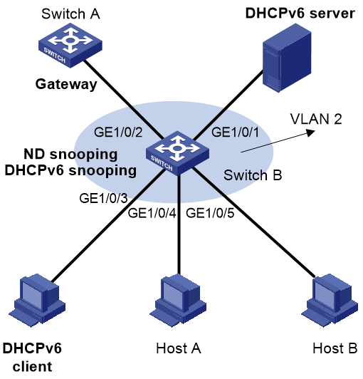

Example: Configuring DHCPv6+SLAAC SAVI
As shown in Figure 3, configure SAVI on Switch B to meet the following requirements:
·     Hosts obtain IP addresses through DHCPv6 or SLAAC.
·     SAVI checks the source addresses of DHCPv6 messages, ND messages, and IPv6 data packets on GigabitEthernet 1/0/3 through GigabitEthernet 1/0/5.
Figure 3 Network diagram
# Enable SAVI.
# Assign GigabitEthernet 1/0/1 through GigabitEthernet 1/0/5 to VLAN 2.
[SwitchB] vlan 2
[SwitchB-vlan2] port gigabitethernet 1/0/1 gigabitethernet 1/0/2 gigabitethernet 1/0/3 gigabitethernet 1/0/4 gigabitethernet 1/0/5
# Enable recording DHCPv6 snooping entries on GigabitEthernet 1/0/3 through GigabitEthernet 1/0/5.
[SwitchB-GigabitEthernet1/0/3] ipv6 dhcp snooping binding record
[SwitchB] interface gigabitethernet 1/0/4
[SwitchB-GigabitEthernet1/0/4] ipv6 dhcp snooping binding record
[SwitchB-GigabitEthernet1/0/4] quit
[SwitchB] interface gigabitethernet 1/0/5
[SwitchB-GigabitEthernet1/0/5] ipv6 dhcp snooping binding record
[SwitchB-GigabitEthernet1/0/5] quit
[SwitchB-GigabitEthernet1/0/1] ipv6 dhcp snooping trust
[SwitchB] vlan 2
# Configure GigabitEthernet 1/0/2 as an ND trusted port.
[SwitchB-GigabitEthernet1/0/2] ipv6 nd detection trust
# Enable IPv6 source guard on GigabitEthernet 1/0/3 through GigabitEthernet 1/0/5.
[SwitchB-GigabitEthernet1/0/3] ipv6 verify source ip-address mac-address
[SwitchB-GigabitEthernet1/0/4] ipv6 verify source ip-address mac-address
[SwitchB-GigabitEthernet1/0/5] ipv6 verify source ip-address mac-address
