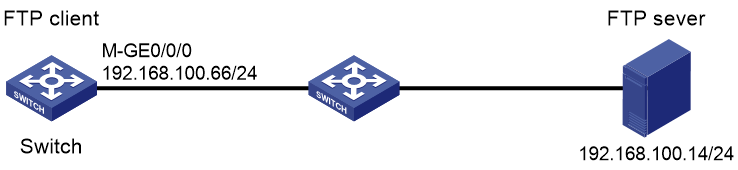

As shown in Figure 1, use TFTP to download a software upgrade file from a TFTP server to upgrade the switch.
Figure 1 Network diagram

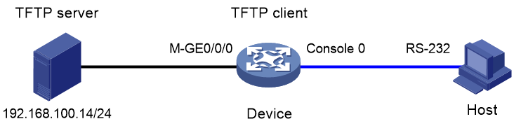

As shown in Figure 3, use FTP to download a software upgrade file from an FTP server to upgrade the switch.
Figure 3 Network diagram

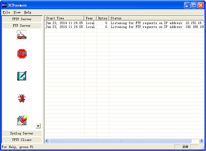

# Start the FTP server and specify a working directory. This example uses the 3CDaemon FTP server. (Details not shown.)
# Add a local user account. (Details not shown.)
# Set the username to 123456 and the password to 123456 for the user account.
Figure 4 Configuring the FTP server

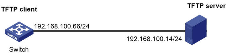

As shown in Figure 5:
·     Enable the FTP server on the switch.
·     Use FTP to upload a software upgrade file from an FTP client to upgrade the switch.
Figure 5 Network diagram

2.     Configure the FTP client:
# Assign the IP address 192.168.100.14/24 to the FTP client. Make sure the FTP client can reach the switch. (Details not shown.)
# Use the username abc and the password hello123456 to log in to the FTP server.

Example: Using the device as a TFTP client to upgrade software
As shown in Figure 6, the device cannot start up.
Use TFTP to upgrade the device from the BootWare menu.
Figure 6 Network diagram

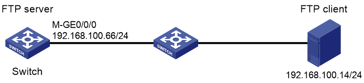

Example: Upgrading a feature
As shown in Figure 6, use TFTP to download feature-t0001016.ipe from the TFTP server to the TFTP client and use it to upgrade the Feature feature from T0001015 to T0001016.
Figure 7 Network diagram

1.     Configure the TFTP server:
# Assign the IP address 192.168.100.14/24 to the TFTP server. (Details not shown.)
# Start the TFTP server and specify a working directory. This example uses the 3CDaemon TFTP server. (Details not shown.)
Figure 8 Configuring the TFTP server

# Use TFTP to download the upgrade file feature-t0001016.ipe from the TFTP server to the switch.
<Sysname> tftp 192.168.100.14 get feature-t0001016.ipe
  % Total    % Received % Xferd  Average Speed   Time    Time     Time  Current
                                 Dload  Upload   Total   Spent    Left  Speed
100   256  100  256     0     0    764      0 --:--:-- --:--:-- --:--:--   810
Writing file...Done.
# Decompress the .ipe file.
<Sysname> install add flash:/feature-t0001016.ipe flash:
Verifying the file flash:/feature-t0001016.ipe on slot 1...Done.
Decompressing file feature-t0001016.bin to flash:/feature-t0001016.bin.......................Done.
# Display active software images.
<Sysname> display install active
Active packages on slot 1:
  flash:/boot-t0001015.bin
  flash:/system-t0001015.bin
  flash:/feature-t0001015.bin
# Identify the recommended ISSU methods and possible impact of the upgrade.
<Sysname> install activate feature flash:/feature-t0001016.bin slot 1 test
Verifying the file flash:/feature1-t0001016.bin on slot 1...Done.
Upgrade summary according to following table:
  Running Version             New Version
  Test 0001015                Test 0001016
Upgrade Way: Service Upgrade
Influenced service according to following table on slot 1:
         Feature
The output shows that an incremental upgrade is recommended and the Feature module will be rebooted during the upgrade.
# Activate the new Feature image to upgrade the Feature feature.
Verifying the file flash:/feature-t0001016.bin on slot 1...Done.
Upgrading software images to compatible versions. Continue? [Y/N]:y
This operation might take several minutes, please wait...Done.
# Verify that the switch is running the new Feature image.
# Commit the software changes.
<Sysname> install commit
This operation will take several minutes, please wait...........................Done.
The current software images have been saved as the startup software images.
Current software images on slot 1:
