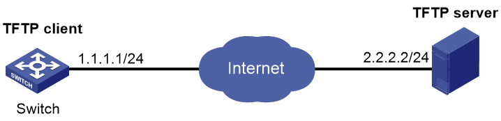

As shown in Figure 1, the switch and the TFTP server can reach each other. The switch is running CMW910-SYSTEM-R1116, and it is not been patched before.
Use the patch image file CMW910-SYSTEM-R1116H04.bin to fix bugs without rebooting the switch.
Figure 1 Network diagram
