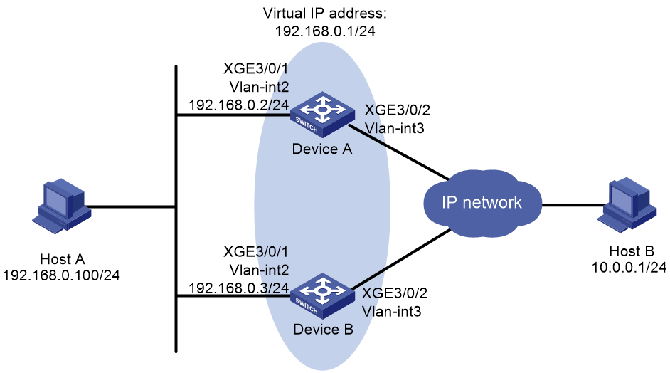

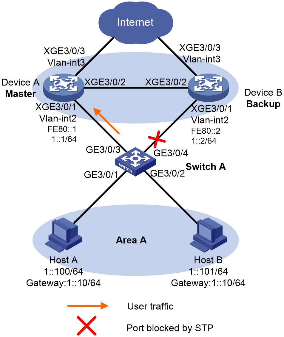

As shown in Figure 1, configure a VRRP group on Device A and Device B as the gateway for Host A to meet the following requirements:
·     Device A operates as the master to forward packets from Host A to the external network.
·     If Device A or its uplink interface fails, Host A can access the external network through Device B.
Figure 1 Network diagram
Analysis
To meet the network requirements, you must perform the following tasks:
·     For Device A to become the master when it recovers from a failure, configure the preemptive mode for the VRRP group.
·     For Device A to decrease its priority and become a backup when its uplink interface fails, configure VRRP tracking on Device A.
·     To avoid frequent role change in the VRRP group, set a preemption delay.

1.     Verify that Host A can ping Host B. (Details not shown.)
2.     Verify that Device A is operating as the master in VRRP group 1 to forward packets from Host A to Host B.
# Display detailed information about VRRP group 1 on Device A.
[DeviceA-Vlan-interface2] display vrrp verbose
IPv4 Virtual Router Information:
 Running mode : Standard
 Total number of virtual routers : 1
   Interface Vlan-interface2
     VRID           : 1                    Adver Timer  : 100
     Admin Status   : Up                   State        : Master
     Config Pri     : 110                  Running Pri  : 110
     Preempt Mode   : Yes                  Delay Time   : 500
     Auth Type      : Not supported
     Version        : 3
     Virtual IP     : 192.168.0.1
     Virtual MAC    : 0000-5e00-0101
     Master IP      : 192.168.0.2
   VRRP Track Information:
     Track Object   : 1                   State : Positive   Pri Reduced : 50
# Display detailed information about VRRP group 1 on Device B.
[DeviceB-Vlan-interface2] display vrrp verbose
     Admin Status   : Up                   State        : Backup
     Config Pri     : 100                  Running Pri  : 100
     Become Master  : 401ms left
     Version        : 3
3.     Disconnect the link between Host A and Device A, and verify that Host A can still ping Host B. (Details not shown.)
4.     Verify that Device B takes over to forward packets from Host A to Host B when Device A fails.
     Version        : 3
     Master IP      : 192.168.0.3
5.     Verify that Device A becomes the master to forward packets from Host A to Host B after Device A recovers.
     Version        : 3

Figure 2 Network diagram

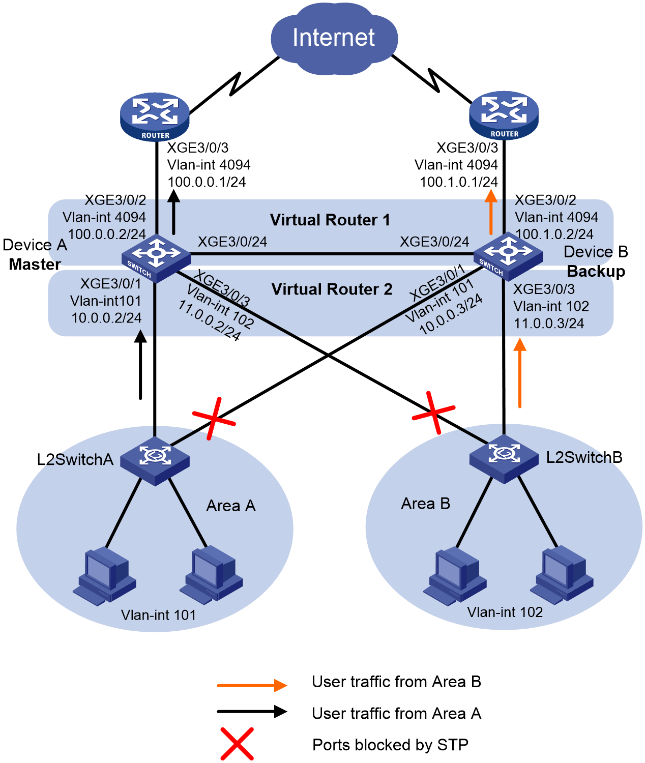

Analysis
·     To avoid loops between Device A, Device B, and the Layer 2 switches, use the spanning tree feature to block a port in the two VRRP groups.

Procedures
Configuring Device A
# Create VLAN 101, and assign Ten-GigabitEthernet 3/0/1 to VLAN 101.
<DeviceA> system-view
[DeviceA] vlan 101
[DeviceA-vlan101] port ten-gigabitethernet 3/0/1
[DeviceA-vlan101] quit
# Create VLAN-interface 101, and assign an IP address to the VLAN interface.
[DeviceA] interface vlan-interface 101
[DeviceA-Vlan-interface101] ip address 10.0.0.2 24
[DeviceA-Vlan-interface101] quit
# Assign IP addresses to other VLAN interfaces of Device A. (Details not shown.)
# Configure Ten-GigabitEthernet 3/0/24 as a trunk port, and assign it to VLAN 101 and VLAN 102.
[DeviceA] interface ten-gigabitethernet 3/0/24
[DeviceA-Ten-GigabitEthernet3/0/24] port link-type trunk
[DeviceA-Ten-GigabitEthernet3/0/24] undo port trunk permit vlan 1
[DeviceA-Ten-GigabitEthernet3/0/24] port trunk permit vlan 101 to 102
[DeviceA-Ten-GigabitEthernet3/0/24] port trunk pvid vlan 101
[DeviceA-Ten-GigabitEthernet3/0/24] quit
# Disable the spanning tree feature on Ten-GigabitEthernet 3/0/2.
[DeviceA-Ten-GigabitEthernet3/0/2] undo stp enable
[DeviceA-Ten-GigabitEthernet3/0/2] quit
# Create VRRP group 1, and set its virtual IP address to 10.0.0.1. Assign Device A a higher priority than Device B in VRRP group 1, so Device A can become the master.
[DeviceA-Vlan-interface101] vrrp vrid 1 virtual-ip 10.0.0.1
# Set the priority of Device A to 120 in VRRP group 1. Device A has a higher priority than Device B in VRRP group 1, so Device A can become the master.
[DeviceA-Vlan-interface101] vrrp vrid 1 priority 120
# Create VRRP group 2, and set its virtual IP address to 11.0.0.1.
[DeviceA] interface vlan-interface 102
[DeviceA-Vlan-interface102] vrrp vrid 2 virtual-ip 11.0.0.1
[DeviceA-Vlan-interface102] quit
# Configure Device A to operate in preemptive mode, and set the preemption delay to 5 seconds.
[DeviceA-Vlan-interface101] vrrp vrid 1 preempt-mode delay 500
# Create track entry 1 to monitor the link status of the uplink interface Ten-GigabitEthernet 3/0/2.
[DeviceA] track 1 interface ten-gigabitethernet 3/0/2
[DeviceA-track-1] quit
# Associate VRRP group 1 with track entry 1 to decrease the weight of Device A by 50 when the track entry transits to Negative.
[DeviceA-Vlan-interface101] vrrp vrid 1 track 1 priority reduced 50
# Configure MSTP, map VLAN 101 to MSTI 1 and VLAN 102 to MSTI 2, and configure Device A as the root bridge of MSTI 1.
[DeviceA] stp region-configuration
[DeviceA-mst-region] region-name vrrp
[DeviceA-mst-region] instance 1 vlan 101
[DeviceA-mst-region] instance 2 vlan 102
[DeviceA-mst-region] active region-configuration
[DeviceA-mst-region] quit
[DeviceA] stp instance 1 root primary
[DeviceA] stp instance 2 root secondary
# Enable the spanning tree feature globally.
[DeviceA] stp global enable
Configuring Device B
<DeviceB> system-view
[DeviceB] vlan 101
[DeviceB-vlan101] port ten-gigabitethernet 3/0/1
[DeviceB-vlan101] quit
[DeviceB] interface vlan-interface 101
[DeviceB-Vlan-interface101] ip address 10.0.0.3 24
[DeviceB-Vlan-interface101] quit
# Assign IP addresses to other VLAN interfaces of Device B. (Details not shown.)
[DeviceB] interface ten-gigabitethernet 3/0/24
[DeviceB-Ten-GigabitEthernet3/0/24] port link-type trunk
[DeviceB-Ten-GigabitEthernet3/0/24] undo port trunk permit vlan 1
[DeviceB-Ten-GigabitEthernet3/0/24] port trunk permit vlan 101 to 102
[DeviceB-Ten-GigabitEthernet3/0/24] port trunk pvid vlan 101
[DeviceB-Ten-GigabitEthernet3/0/24] quit
[DeviceB-Ten-GigabitEthernet3/0/2] undo stp enable
[DeviceB-Ten-GigabitEthernet3/0/2] quit
[DeviceB-Vlan-interface101] vrrp vrid 1 virtual-ip 10.0.0.1
# Create VRRP group 2, and set its virtual IP address to 11.0.0.1. Assign Device B a higher priority than Device A in VRRP group 2, so Device B can become the master.
[DeviceB] interface vlan-interface 102
[DeviceB-Vlan-interface102] vrrp vrid 2 virtual-ip 11.0.0.1
# Set the priority of Device B to 120 in VRRP group 2. Device B has a higher priority than Device A in VRRP group 2, so Device B can become the master.
[DeviceB-Vlan-interface102] vrrp vrid 2 priority 120
# Configure Device B to operate in preemptive mode, and set the preemption delay to 5 seconds.
[DeviceB-Vlan-interface102] vrrp vrid 2 preempt-mode delay 500
[DeviceB-Vlan-interface102] quit
# Create track entry 2 to monitor the link status of the uplink interface Ten-GigabitEthernet 3/0/2.
[DeviceB] track 2 interface ten-gigabitethernet 3/0/2
[DeviceB-track-2] quit
# Associate VRRP group 2 with track entry 2 to decrease the weight of Device A by 50 when the track entry transits to Negative.
[DeviceB-Vlan-interface102] vrrp vrid 2 track 2 priority reduced 50
# Configure MSTP, map VLAN 101 to MSTI 1 and VLAN 102 to MSTI 2, and configure Device B as the root bridge of MSTI 2.
[DeviceB] stp region-configuration
[DeviceB-mst-region] region-name vrrp
[DeviceB-mst-region] instance 1 vlan 101
[DeviceB-mst-region] instance 2 vlan 102
[DeviceB-mst-region] active region-configuration
[DeviceB-mst-region] quit
[DeviceB] stp instance 2 root primary
[DeviceB] stp instance 1 root secondary
[DeviceB] stp global enable
Configuring L2SwitchA
# Set the MST region name of the device to vrrp.
<L2SwitchA> system-view
[L2SwitchA] stp region-configuration
[L2SwitchA-mst-region] region-name vrrp
# Map VLAN 101 to MSTI 1 and activate the MST region configuration
[L2SwitchA-mst-region] instance 1 vlan 101
[L2SwitchA-mst-region] active region-configuration
[L2SwitchA-mst-region] quit
[L2SwitchA] stp global enable
Configuring L2SwitchB
<L2SwitchB> system-view
[L2SwitchB] stp region-configuration
[L2SwitchB-mst-region] region-name vrrp
# Map VLAN 102 to MSTI 1 and activate the MST region configuration.
[L2SwitchB-mst-region] instance 1 vlan 102
[L2SwitchB-mst-region] active region-configuration
[L2SwitchB-mst-region] quit
[L2SwitchB] stp global enable
1.     Verify that the hosts in Area A and Area B can ping the external network.
# Ping 100.0.0.1 from Host A in Area A.
<host A> ping 100.0.0.1
PING 100.0.0.1 (100.0.0.1): 56 data bytes
56 bytes from 100.0.0.1: seq=0 ttl=128 time=22.43 ms
56 bytes from 100.0.0.1: seq=1 ttl=128 time=7.17 ms
56 bytes from 100.0.0.1: seq=2 ttl=128 time=8.91 ms
56 bytes from 100.0.0.1: seq=3 ttl=128 time=7.45 ms

2.     Verify that Device A is operating as the master in VRRP group 1 and the backup in VRRP group 2. Device B is operating as the backup in VRRP group 1 and the master in VRRP group 2.
# Display detailed information about the VRRP groups on Device A.
[DeviceA] display vrrp verbose
 Total number of virtual routers : 2
   Interface Vlan-interface101

3.     Verify that Device B becomes the master in VRRP group 1 when Device A fails.
[DeviceB] display vrrp verbose
   Interface Vlan-interface102
     VRID           : 2                    Adver Timer  : 100
     Preempt Mode   : Yes                  Delay Time   : 0
     Become Master  : 3550ms left
     Version        : 3
     Virtual IP     : 11.0.0.1
     Virtual MAC    : 0000-5e00-0102
     Master IP      : 11.0.0.3
Configuration files
·     Device A:
vlan 101 to 102
vlan 4094
 region-name vrrp
 instance 1 vlan 101
 instance 2 vlan 102
 stp global enable
interface Vlan-interface101
 ip address 10.0.0.2 255.255.255.0
interface Vlan-interface102
 ip address 11.0.0.2 255.255.255.0
interface Vlan-interface4094
 ip address 100.0.0.2 255.255.255.0
interface Ten-GigabitEthernet3/0/1
 port link-mode bridge
 port access vlan 101
interface Ten-GigabitEthernet3/0/2
 port access vlan 4094
 undo stp enable
interface Ten-GigabitEthernet3/0/3
 port access vlan 102
interface Ten-GigabitEthernet3/0/24
 track 1 interface Ten-GigabitEthernet3/0/2
·     Device B:
vlan 101 to 102
vlan 4094
 region-name vrrp
 instance 1 vlan 101
 instance 2 vlan 102
 stp global enable
 ip address 10.0.0.3 255.255.255.0
 ip address 11.0.0.3 255.255.255.0
 ip address 100.1.0.2 255.255.255.0
 undo stp enable
 track 2 interface Ten-GigabitEthernet3/0/2

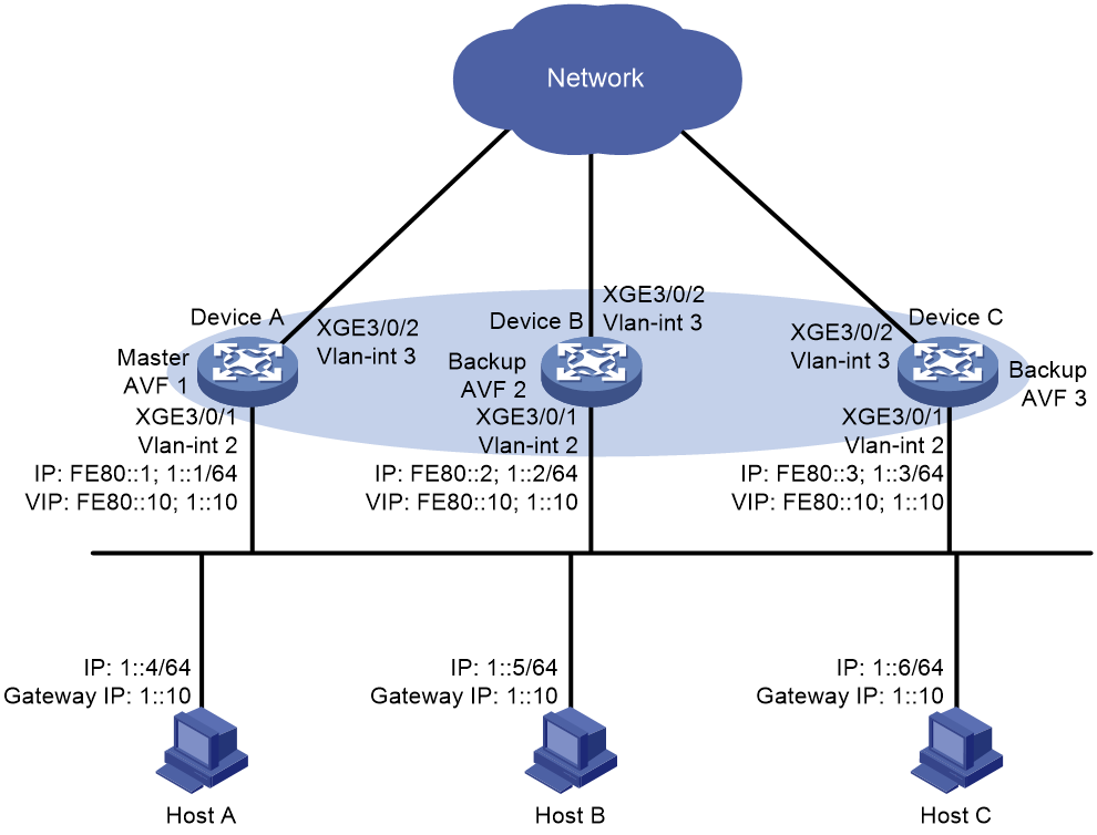

Example: Configuring IPv4 VRRP load balancing
As shown in Figure 3, configure a load-balanced VRRP group on Device A, Device B, and Device C as the gateway for the hosts to meet the following requirements:
·     Packets from the hosts are load balanced among the devices.
·     If one device fails, hosts can access the external network through the other devices.
Figure 3 Network diagram
Analysis
·     For traffic to be switched to the other two devices when the uplink interface of one device fails, configure VF tracking on Device A, Device B, and Device C. When the uplink interface of one device fails, the weights of the VFs (including the AVF) on the device decrease by the specified value.
·     For the failed device to become the master when it recovers, configure the preemptive mode for the VRRP group.

When you configure VRRP load balancing, follow these restrictions and guidelines:
·     The virtual IP address of a VRRP group cannot be any of the following addresses:
¡     All-zero address (0.0.0.0).
¡     Broadcast address (255.255.255.255).
¡     Loopback address.
¡     IP address of other than Class A, Class B, and Class C.
¡     Invalid IP address (for example, 0.0.0.1).
·     For the hosts to access the external network, make sure the following IP addresses are on the same subnet:
¡     The virtual IP address of the VRRP group.
¡     The downlink interface IP addresses of the VRRP group members.
·     In load balancing mode, the virtual IP address of a VRRP group cannot be the IP address of any interface in the VRRP group. Otherwise, VRRP load balancing cannot operate correctly.
·     If the uplink interface of the VF owner fails, an LVF must take over as the AVF. The switchover occurs when the weight of the VF owner drops below the lower limit of failure. This requires the reduced weight for the VF owner to be higher than 245.
·     Configure the same virtual IP addresses for each device in the VRRP group.
Procedures
1.     Configure the interfaces:
[DeviceA] vlan 2
[DeviceA-vlan2] port ten-gigabitethernet 3/0/1
[DeviceA-vlan2] quit
[DeviceA] interface vlan-interface 2
[DeviceA-Vlan-interface2] ip address 10.1.1.2 24
[DeviceA-Vlan-interface2] quit
[DeviceA] vlan 3
[DeviceA-vlan3] port ten-gigabitethernet 3/0/2
[DeviceA-vlan3] quit
[DeviceA] interface vlan-interface 3
[DeviceA-Vlan-interface3] quit
2.     Configure VRRP:
# Configure VRRP to operate in load balancing mode.
[DeviceA] vrrp mode load-balance
# Create VRRP group 1, and set its virtual IP address to 10.1.1.1.
[DeviceA-Vlan-interface2] vrrp vrid 1 virtual-ip 10.1.1.1
# Set the priority of Device A to 120 in VRRP group 1. Device A has the highest priority in VRRP group 1, so Device A can become the master.
[DeviceA-Vlan-interface2] vrrp vrid 1 priority 120
[DeviceA-Vlan-interface2] vrrp vrid 1 preempt-mode delay 500
3.     Configure Track:
# Create track entry 1 to monitor the link status of the uplink interface Ten-GigabitEthernet 3/0/2. If the uplink interface fails, the track entry transits to Negative.
# Configure the VFs in VRRP group 1 to monitor track entry 1, and decrease their weights by 250 when the track entry transits to Negative.
[DeviceA-Vlan-interface2] vrrp vrid 1 weight track 1 weight reduced 250
[DeviceB] vlan 2
[DeviceB-vlan2] port ten-gigabitethernet 3/0/1
[DeviceB-vlan2] quit
[DeviceB] interface vlan-interface 2
[DeviceB-Vlan-interface2] ip address 10.1.1.3 24
[DeviceB-Vlan-interface2] quit
[DeviceB] vlan 3
[DeviceB-vlan3] port ten-gigabitethernet 3/0/2
[DeviceB-vlan3] quit
[DeviceB] interface vlan-interface 3
[DeviceB-Vlan-interface3] quit
2.     Configure VRRP:
[DeviceB] vrrp mode load-balance
[DeviceB-Vlan-interface2] vrrp vrid 1 virtual-ip 10.1.1.1
# Set the priority of Device B to 110 in VRRP group 1. Device B has a higher priority than Device C in VRRP group 1, so Device B can become the master when Device A fails.
[DeviceB-Vlan-interface2] vrrp vrid 1 priority 110
[DeviceB-Vlan-interface2] vrrp vrid 1 preempt-mode delay 500
3.     Configure Track:
# Create track entry 1 to monitor the link status of the uplink interface Ten-GigabitEthernet3 /0/2. When the uplink interface fails, the track entry transits to Negative.
[DeviceB] track 1 interface ten-gigabitethernet 3/0/2
[DeviceB-track-1] quit
[DeviceB-Vlan-interface2] vrrp vrid 1 weight track 1 weight reduced 250
Configuring Device C
<DeviceC> system-view
[DeviceC] vlan 2
[DeviceC-vlan2] port ten-gigabitethernet 3/0/1
[DeviceC-vlan2] quit
[DeviceC] interface vlan-interface 2
[DeviceC-Vlan-interface2] ip address 10.1.1.4 24
[DeviceC-Vlan-interface2] quit
[DeviceC] vlan 3
[DeviceC-vlan3] port ten-gigabitethernet 3/0/2
[DeviceC-vlan3] quit
[DeviceC] interface vlan-interface 3
[DeviceC-Vlan-interface3] quit
2.     Configure VRRP:
[DeviceC] vrrp mode load-balance
[DeviceC-Vlan-interface2] vrrp vrid 1 virtual-ip 10.1.1.1
# Configure Device C to operate in preemptive mode, and set the preemption delay to 5 seconds.
[DeviceC-Vlan-interface2] vrrp vrid 1 preempt-mode delay 500
3.     Configure Track:
# Create track entry 1 to monitor the link status of the uplink interface Ten-GigabitEthernet 3/0/2. When the uplink interface fails, the track entry transits to Negative.
[DeviceC] track 1 interface ten-gigabitethernet 3/0/2
[DeviceC-track-1] quit
[DeviceC-Vlan-interface2] vrrp vrid 1 weight track 1 weight reduced 250
1.     Verify that Host A can ping the external network. (Details not shown.)
2.     Verify that Device A is operating as the master and Device B and Device C as the backups in VRRP group 1. Each of the three devices has one AVF and two LVFs.
IPv4 Virtual Device Information:
 Running mode : Load balance
     Config Pri     : 120                  Running Pri  : 120
     Version        : 3
     Virtual IP     : 10.1.1.1
     Member IP List : 10.1.1.2 (Local, Master)
                      10.1.1.3 (Backup)
                      10.1.1.4 (Backup)
   Forwarder Information: 3 Forwarders 1 Active
     Config Weight  : 255
     Running Weight : 255
    Forwarder 01
     State          : Active
     Virtual MAC    : 000f-e2ff-0011 (Owner)
     Owner ID       : 0000-5e01-1101
     Priority       : 255
     Active         : local
    Forwarder 02
     State          : Listening
     Virtual MAC    : 000f-e2ff-0012 (Learnt)
     Owner ID       : 0000-5e01-1103
     Priority       : 127
     Active         : 10.1.1.3
    Forwarder 03
     State          : Listening
     Virtual MAC    : 000f-e2ff-0013 (Learnt)
     Owner ID       : 0000-5e01-1105
     Priority       : 127
     Active         : 10.1.1.4
   Forwarder Weight Track Information:
     Track Object   : 1          State : Positive   Weight Reduced : 250
     Become Master  : 2150ms left
     Version        : 3
     Member IP List : 10.1.1.3 (Local, Backup)
                      10.1.1.2 (Master)
                      10.1.1.4 (Backup)
     Config Weight  : 255
    Forwarder 01
     State          : Listening
     Virtual MAC    : 000f-e2ff-0011 (Learnt)
     Priority       : 127
     Active         : 10.1.1.2
    Forwarder 02
     State          : Active
     Virtual MAC    : 000f-e2ff-0012 (Owner)
     Priority       : 255
     Active         : local
    Forwarder 03
     State          : Listening
     Priority       : 127
     Active         : 10.1.1.4
# Display detailed information about VRRP group 1 on Device C.
[DeviceC] display vrrp verbose
     Version        : 3
     Member IP List : 10.1.1.4 (Local, Backup)
                      10.1.1.2 (Master)
                      10.1.1.3 (Backup)
     Config Weight  : 255
    Forwarder 01
     State          : Listening
     Priority       : 127
     Active         : 10.1.1.2
    Forwarder 02
     State          : Listening
     Priority       : 127
     Active         : 10.1.1.3
    Forwarder 03
     State          : Active
     Virtual MAC    : 000f-e2ff-0013 (Owner)
     Priority       : 255
     Active         : local
3.     Verify that AVF switchover can be performed when the uplink interface of Device A fails.
     Version        : 3
                      10.1.1.3 (Backup)
                      10.1.1.4 (Backup)
   Forwarder Information: 3 Forwarders 0 Active
     Config Weight  : 255
     Running Weight : 5
    Forwarder 01
     State          : Initialize
     Priority       : 0
     Active         : 10.1.1.4
    Forwarder 02
     State          : Initialize
     Priority       : 0
     Active         : 10.1.1.3
    Forwarder 03
     State          : Initialize
     Priority       : 0
     Active         : 10.1.1.4
     Track Object   : 1          State : Negative   Weight Reduced : 250
     Version        : 3
                      10.1.1.2 (Master)
                      10.1.1.3 (Backup)
   Forwarder Information: 3 Forwarders 2 Active
     Config Weight  : 255
    Forwarder 01
     State          : Active
     Virtual MAC    : 000f-e2ff-0011 (Take Over)
     Priority       : 85
     Active         : local
     Redirect Time  : 93 secs
     Time-out Time  : 1293 secs
    Forwarder 02
     State          : Listening
     Priority       : 85
     Active         : 10.1.1.3
    Forwarder 03
     State          : Active
     Priority       : 255
     Active         : local
The output shows that when the uplink interface of Device A fails, the weights of the VFs on Device A drop below the lower limit of failure. All VFs on Device A transit to Initialized state and cannot forward traffic. The VF for MAC address 000f-e2ff-0011 on Device C becomes the AVF to forward traffic.
4.     Verify that the VF for virtual MAC address 000f-e2ff-0011 is removed from Device C when the timeout timer (about 1800 seconds) expires. The VF no longer forwards the packets destined for the MAC address.
     Version        : 3
                      10.1.1.2 (Master)
                      10.1.1.3 (Backup)
   Forwarder Information: 2 Forwarders 1 Active
     Config Weight  : 255
    Forwarder 02
     State          : Listening
     Priority       : 127
     Active         : 10.1.1.3
    Forwarder 03
     State          : Active
     Priority       : 255
     Active         : local
5.     Verify that Device B has a higher priority than Device C and becomes the master when Device A fails.
 IPv4 Standby Information:
     Run mode : Load balance
     Run Method     : Virtual MAC
     Version        : 3
     Member IP List : 10.1.1.3 (Local, Master)
                      10.1.1.4 (Backup)
     Config Weight  : 255
    Forwarder 02
     State          : Active
     Priority       : 255
     Active         : local
    Forwarder 03
     State          : Listening
     Priority       : 127
     Active         : 10.1.1.4

Example: Configuring a single IPv6 VRRP group
As shown in Figure 4, configure an IPv6 VRRP group on Device A and Device B as the gateway for hosts in Area A to meet the following requirements:
·     Device A operates as the master to forward packets from the hosts in Area A to the external network.
·     If Device A or its uplink interface fails, the hosts in Area A can access the external network through Device B.
Figure 4 Network diagram
Analysis
·     To avoid loops between Device A, Device B, and the Layer 2 switches, use the spanning tree feature to block a port in the IPv6 VRRP group.

When you configure a single IPv6 VRRP group, follow these restrictions and guidelines:
·     For the hosts in Area A to access the external network, make sure the following IP addresses are on the same subnet:
¡     The virtual IPv6 address of the VRRP group.
¡     The downlink interface IPv6 addresses of the VRRP group members.
·     Removal of the IPv6 VRRP group on the IP address owner causes IP address collision. To avoid a collision, change the IP address of the interface on the IP address owner before you remove the VRRP group from the interface.
·     Configure the same virtual IPv6 addresses for each device in the IPv6 VRRP group.

3.     Verify that Host A can still ping the IPv6 address 30::1 after Device A or its uplink interface fails.
Microsoft Windows [Version 6.1.7601]
Copyright (c) 2009 Microsoft Corporation.  All rights reserved.
C:\Users\hostA>ping 30::1
Pinging 30::1 with 32 bytes of data:
Reply from 30::1: time<1ms
Ping statistics for 30::1:
    Minimum = 0ms, Maximum = 0ms, Average = 0ms
4.     Verify that Device B takes over to forward packets from the hosts in Area A to the external network after Device A or its uplink interface fails.
[DeviceB] display vrrp ipv6 verbose
IPv6 Virtual Router Information:
     Virtual IP     : FE80::10
                      1::10
     Virtual MAC    : 0000-5e00-0201
     Master IP      : FE80::2
5.     Verify that Device A becomes the master to forward packets from the hosts in Area A to the external network when Device A or its uplink interface recovers.
[DeviceA] display vrrp ipv6 verbose
                      1::10
     Master IP      : FE80::1

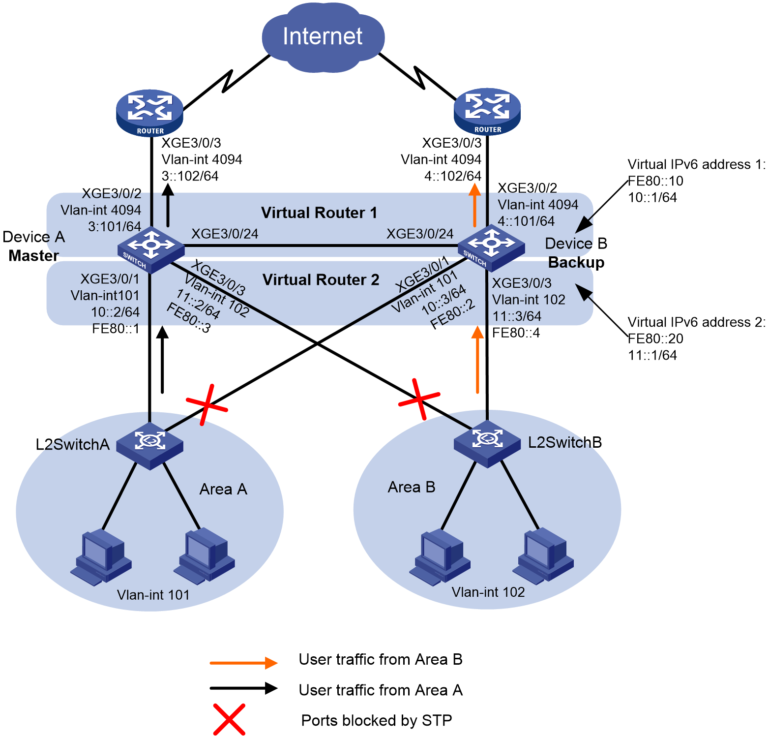

Example: Configuring multiple IPv6 VRRP groups
As shown in Figure 5, configure two IPv6 VRRP groups on Device A and Device B as gateways for internal hosts to meet the following requirements:
·     Device A operates as the master of IPv6 VRRP group 1 to forward packets from Area A. Device B operates as the master of IPv6 VRRP group 2 to forward packets from Area B.
·     When one device or its uplink interface fails, the other device provides gateway service for both areas.
Figure 5 Network diagram
Analysis
·     For Device A or Device B to decrease its priority and become a backup in an IPv6 VRRP group when the uplink interface of the device fails, configure VRRP tracking on both devices.
·     To avoid loops between Device A, Device B, and the Layer 2 switches, use the spanning tree feature to block a port in each IPv6 VRRP group.
Hardware
Software version
S12500G-AF
Release 8053P05 and later
S12500CR
S10500X-G
Release 7753P05 and later
S7500X-G
When you configure multiple IPv6 VRRP groups, follow these restrictions and guidelines:
·     For the hosts in both areas to access the external network, make sure the following IP addresses for each VRRP group are on the same subnet:
·     Removal of the IPv6 VRRP group on the IP address owner causes IP address collision. To avoid a collision, change the IPv6 address of the interface on the IP address owner before you remove the VRRP group from the interface.
·     Make sure the following configurations are the same on the members of an IPv6 VRRP group:
¡     Number of virtual IPv6 addresses.
¡     Virtual IPv6 addresses.
¡     Advertisement interval.
Procedures
# Create VLAN 101 and assign Ten-GigabitEthernet 3/0/1 to VLAN 101.
[DeviceA] vlan 101
# Create VLAN-interface 101, and assign IPv6 addresses to VLAN-interface 101.
[DeviceA-Vlan-interface101] ipv6 address fe80::1 link-local
[DeviceA-Vlan-interface101] ipv6 address 10::2 64
# Assign IPv6 addresses to other VLAN interfaces of Device A. (Details not shown.)
# Configure Ten-GigabitEthernet 3/0/24 as a trunk port and assign the port to VLAN 101 and VLAN 102.
# Create IPv6 VRRP group 1, and set its virtual IPv6 addresses to FE80::10 and 10::1.
[DeviceA-Vlan-interface101] vrrp ipv6 vrid 1 virtual-ip fe80::10 link-local
[DeviceA-Vlan-interface101] vrrp ipv6 vrid 1 virtual-ip 10::1
[DeviceA-Vlan-interface101] vrrp ipv6 vrid 1 preempt-mode delay 500
# Set the priority of Device A to 120 in IPv6 VRRP group 1. Device A has a higher priority than Device B in IPv6 VRRP group 1, so Device A can become the master.
[DeviceA-Vlan-interface101] vrrp ipv6 vrid 1 priority 120
# Disable RA message suppression on VLAN-interface 101. The hosts in Area A can learn the default gateway address from the RA messages.
[DeviceA-Vlan-interface101] undo ipv6 nd ra halt
# Create IPv6 VRRP group 2, and set its virtual IPv6 addresses to FE80::20 and 11::1.
[DeviceA-Vlan-interface102] vrrp ipv6 vrid 2 virtual-ip fe80::20 link-local
[DeviceA-Vlan-interface102] vrrp ipv6 vrid 2 virtual-ip 11::1
[DeviceA-Vlan-interface102] vrrp ipv6 vrid 2 preempt-mode delay 500
# Disable RA message suppression on VLAN-interface 102. The hosts in Area B can learn the default gateway address from the RA messages.
[DeviceA-Vlan-interface102] undo ipv6 nd ra halt
# Associate IPv6 VRRP group 1 with track entry 1 and decrease the device priority by 50 when the state of track entry 1 changes to Negative.
[DeviceA-Vlan-interface101] vrrp ipv6 vrid 1 track 1 priority reduced 50
[DeviceB] vlan 101
[DeviceB-Vlan-interface101] ipv6 address fe80::2 link-local
[DeviceB-Vlan-interface101] ipv6 address 10::3 64
# Assign IPv6 addresses to other VLAN interfaces of Device B. (Details not shown.)
# Configure Ten-GigabitEthernet 3/0/24 as a trunk port, and assign the port to VLAN 101 and VLAN 102.
[DeviceB-Vlan-interface101] vrrp ipv6 vrid 1 virtual-ip fe80::10 link-local
[DeviceB-Vlan-interface101] vrrp ipv6 vrid 1 virtual-ip 10::1
[DeviceB-Vlan-interface101] vrrp ipv6 vrid 1 preempt-mode delay 500
[DeviceB-Vlan-interface101] undo ipv6 nd ra halt
[DeviceB-Vlan-interface102] vrrp ipv6 vrid 2 virtual-ip fe80::20 link-local
[DeviceB-Vlan-interface102] vrrp ipv6 vrid 2 virtual-ip 11::1
# Set the priority of Device B to 120 in IPv6 VRRP group 2. Device B has a higher priority than Device A in IPv6 VRRP group 2, so Device B can become the master.
[DeviceB-Vlan-interface102] vrrp ipv6 vrid 2 priority 120
[DeviceB-Vlan-interface102] undo ipv6 nd ra halt
# Associate IPv6 VRRP group 2 with track entry 2 and decrease the device priority by 50 when the state of track entry 2 changes to Negative.
[DeviceB-Vlan-interface102] vrrp ipv6 vrid 2 track 2 priority reduced 50
# Map VLAN 101 to MSTI 1, and activate the MST region configuration.
# Map VLAN 102 to MSTI 1, and activate the MST region configuration.
1.     Verify that the hosts in both Area A and Area B can ping the external network.
# Ping the IPv6 address 30::1 from a host in Area A.
C:\Users\areaA>ping 30::1
# Ping the IPv6 address 30::1 from a host in Area B.
C:\Users\areaB>ping 30::1
2.     Verify that Device A is operating as the master in IPv6 VRRP group 1 and the backup in IPv6 VRRP group 2. Device B is operating as the master in IPv6 VRRP group 2 and the backup in IPv6 VRRP group 1.
# Display detailed information about all IPv6 VRRP groups on Device A.
                      10::1
     Master IP      : FE80::1
     Virtual IP     : FE80::20
                      11::1
     Virtual MAC    : 0000-5e00-0202
     Master IP      : FE80::4
# Display detailed information about all IPv6 VRRP groups on Device B.
     Become Master  : 3500ms left
                      10::2
     Master IP      : FE80::1
                      11::1
     Master IP      : FE80::4
     Track Object   : 2                   State : Positive   Pri Reduced : 50
3.     Verify that Device B becomes the master in IPv6 VRRP group 1 when Device A or its uplink interface fails.
                      10::2
     Master IP      : FE80::2
                      11::1
     Master IP      : FE80::4
4.     Verify that Device A becomes the master in IPv6 VRRP group 1 after Device A or its uplink interface recovers.
                      10::1
     Master IP      : FE80::1
                      11::1
     Master IP      : FE80::4
Configuration files
·     Device A:
vlan 101 to 102
vlan 4094
 region-name vrrp
 instance 1 vlan 101

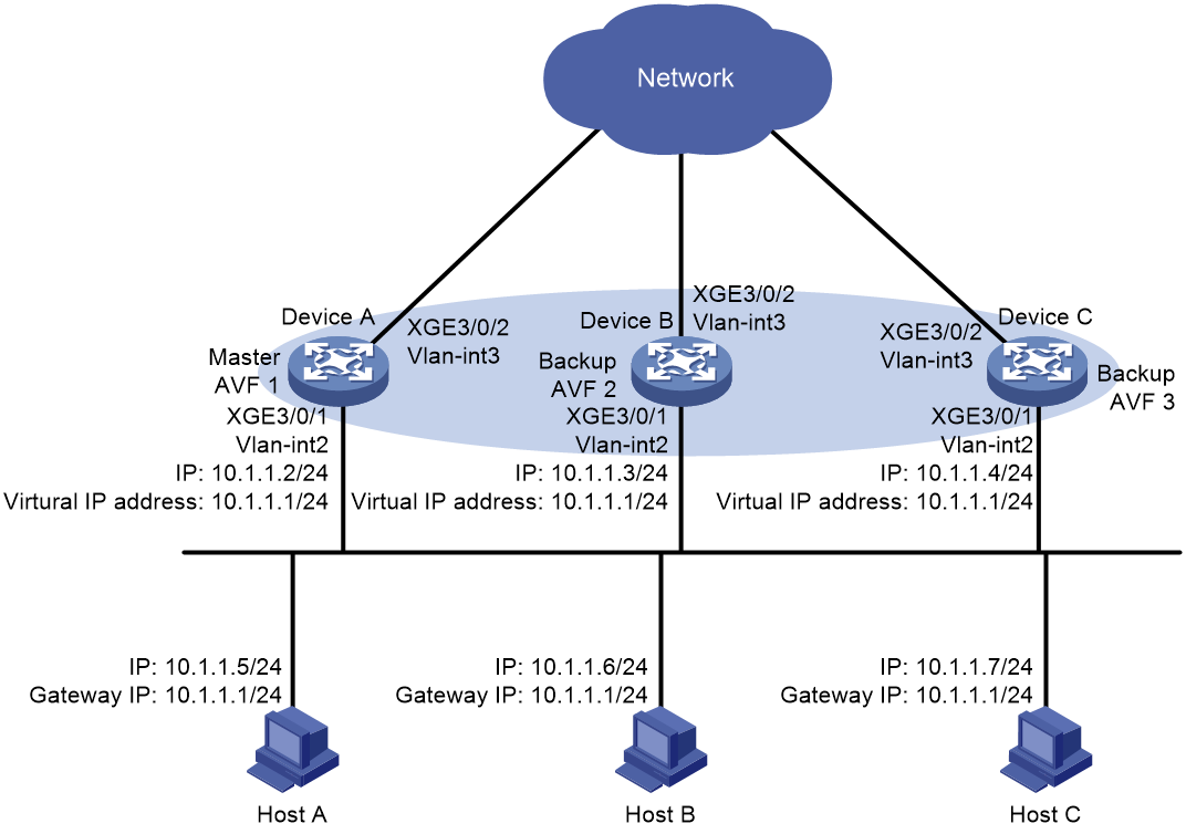

Example: Configuring IPv6 VRRP load balancing
As shown in Figure 6, configure a load-balanced VRRP group on Device A, Device B, and Device C as the gateway for the hosts to meet the following requirements:
Figure 6 Network diagram
Analysis
Hardware
Software version
S12500G-AF
S12500CR
S10500X-G
S7500X-G
When you configure IPv6 VRRP load balancing, follow these restrictions and guidelines:
·     In load balancing mode, the virtual IPv6 addresses of a VRRP group cannot be the IPv6 addresses of any interfaces in the VRRP group. Otherwise, VRRP load balancing cannot operate correctly.
·     If the uplink of the VF owner fails, an LVF must take over as the AVF. The switchover occurs when the weight of the VF owner drops below the lower limit of failure. This requires the reduced weight for the VF owner to be higher than 245.
Procedures
# Create VLAN 2 and assign Ten-GigabitEthernet 3/0/1 to VLAN 2.
[DeviceA] vlan 2
# Create VLAN-interface 2, and assign IPv6 addresses to the VLAN interface.
[DeviceA-Vlan-interface2] ipv6 address fe80::1 link-local
[DeviceA-Vlan-interface2] ipv6 address 1::1 64
2.     Configure VRRP:
# Configure IPv6 VRRP to operate in load balancing mode.
[DeviceA] vrrp ipv6 mode load-balance
# Create IPv6 VRRP group 1, and set its virtual IPv6 addresses to FE80::10 and 1::10.
[DeviceA-Vlan-interface2] vrrp ipv6 vrid 1 virtual-ip fe80::10 link-local
[DeviceA-Vlan-interface2] vrrp ipv6 vrid 1 virtual-ip 1::10
# Set the priority of Device A to 120 in IPv6 VRRP group 1. Device A has the highest priority in the VRRP group, so Device A can become the master.
[DeviceA-Vlan-interface2] vrrp ipv6 vrid 1 priority 120
[DeviceA-Vlan-interface2] vrrp ipv6 vrid 1 preempt-mode delay 500
# Disable RA message suppression on VLAN-interface 2. The hosts on subnet 1::/64 can learn the default gateway address from the RA messages.
[DeviceA-Vlan-interface2] undo ipv6 nd ra halt
3.     Configure Track:
# Configure the VFs in IPv6 VRRP group 1 to monitor track entry 1, and decrease their weights by 250 when the track entry transits to Negative.
[DeviceB] vlan 2
[DeviceB-Vlan-interface2] ipv6 address fe80::2 link-local
[DeviceB-Vlan-interface2] ipv6 address 1::2 64
2.     Configure VRRP:
[DeviceB] vrrp ipv6 mode load-balance
[DeviceB-Vlan-interface2] vrrp ipv6 vrid 1 virtual-ip fe80::10 link-local
[DeviceB-Vlan-interface2] vrrp ipv6 vrid 1 virtual-ip 1::10
# Set the priority of Device B to 110 in IPv6 VRRP group 1. Device B has a higher priority than Device C in the VRRP group, so Device B can become the master when Device A fails.
[DeviceB-Vlan-interface2] vrrp ipv6 vrid 1 priority 110
[DeviceB-Vlan-interface2] vrrp ipv6 vrid 1 preempt-mode delay 500
[DeviceB-Vlan-interface2] undo ipv6 nd ra halt
3.     Configure Track:
[DeviceB-Vlan-interface2] vrrp ipv6 vrid 1 weight track 1 reduced 250
[DeviceC] vlan 2
[DeviceC-Vlan-interface2] ipv6 address fe80::3 link-local
[DeviceC-Vlan-interface2] ipv6 address 1::3 64
2.     Configure VRRP:
[DeviceC] vrrp ipv6 mode load-balance
[DeviceC-Vlan-interface2] vrrp ipv6 vrid 1 virtual-ip fe80::10 link-local
[DeviceC-Vlan-interface2] vrrp ipv6 vrid 1 virtual-ip 1::10
[DeviceC-Vlan-interface2] vrrp ipv6 vrid 1 preempt-mode delay 500
[DeviceC-Vlan-interface2] undo ipv6 nd ra halt
3.     Configure Track:
[DeviceC-Vlan-interface2] vrrp ipv6 vrid 1 weight track 1 reduced 250
2.     Verify that Device A is operating as the master and Device B and Device C as the backups in IPv6 VRRP group 1. Each of the three devices has one AVF and two LVFs.
IPv6 Virtual Device Information:
                      1::10
     Member IP List : FE80::1 (Local, Master)
                      FE80::2 (Backup)
                      FE80::3 (Backup)
     Config Weight  : 255
    Forwarder 01
     State          : Active
     Priority       : 255
     Active         : local
    Forwarder 02
     State          : Listening
     Priority       : 127
     Active         : FE80::2
    Forwarder 03
     State          : Listening
     Priority       : 127
     Active         : FE80::3
     Become Master  : 3120ms left
                      1::10
     Member IP List : FE80::2 (Local, Backup)
                      FE80::1 (Master)
                      FE80::3 (Backup)
     Config Weight  : 255
    Forwarder 01
     State          : Listening
     Priority       : 127
     Active         : FE80::1
    Forwarder 02
     State          : Active
     Priority       : 255
     Active         : local
    Forwarder 03
     State          : Listening
     Priority       : 127
     Active         : FE80::3
# Display detailed information about all VRRP groups on Device C.
[DeviceC] display vrrp ipv6 verbose
                      1::10
     Member IP List : FE80::3 (Local, Backup)
                      FE80::1 (Master)
                      FE80::2 (Backup)
     Config Weight  : 255
    Forwarder 01
     State          : Listening
     Priority       : 127
     Active         : FE80::1
    Forwarder 02
     State          : Listening
     Priority       : 127
     Active         : FE80::2
    Forwarder 03
     State          : Active
     Priority       : 255
     Active         : local
3.     Verify that AVF switchover can be performed when the uplink interface Ten-GigabitEthernet 3/0/2 of Device A fails.
                      1::10
                      FE80::2 (Backup)
                      FE80::3 (Backup)
     Config Weight  : 255
     Running Weight : 5
    Forwarder 01
     State          : Initialize
     Priority       : 0
     Active         : FE80::3
    Forwarder 02
     State          : Initialize
     Priority       : 0
     Active         : FE80::2
    Forwarder 03
     State          : Initialize
     Priority       : 0
     Active         : FE80::3
# Display detailed information about all IPv6 VRRP groups on Device C.
                       1::10
                      FE80::1 (Master)
                      FE80::2 (Backup)
     Config Weight  : 255
    Forwarder 01
     State          : Active
     Priority       : 85
     Active         : local
    Forwarder 02
     State          : Listening
     Priority       : 85
     Active         : FE80::2
    Forwarder 03
     State          : Active
     Priority       : 255
     Active         : local
The output shows that the weights of the VFs on Device A drop below the lower limit of failure when the uplink interface Ten-GigabitEthernet 3/0/2 of Device A fails. All VFs on Device A transit to Initialized state and cannot forward traffic. The VF for MAC address 000f-e2ff-0011 on Device C becomes the AVF to forward traffic.
                      1::10
                      FE80::1 (Master)
                      FE80::2 (Backup)
     Config Weight  : 255
    Forwarder 02
     State          : Listening
     Priority       : 127
     Active         : FE80::2
    Forwarder 03
     State          : Active
     Priority       : 255
     Active         : local
 IPv6 Standby Information:
                      1::10
     Member IP List : FE80::2 (Local, Master)
                      FE80::3 (Backup)
     Config Weight  : 255
    Forwarder 02
     State          : Active
     Priority       : 255
     Active         : local
    Forwarder 03
     State          : Listening

Configuration files
·     Device A:
 vlan 2 to 3
interface Vlan-interface2
interface Vlan-interface3
 port access vlan 2
 port access vlan 3
track 1 interface vlan-interface3
·     Device B:
 vlan 2 to 3
 port access vlan 2
 port access vlan 3
·     Device C:
 vlan 2 to 3
 port access vlan 2
 port access vlan 3

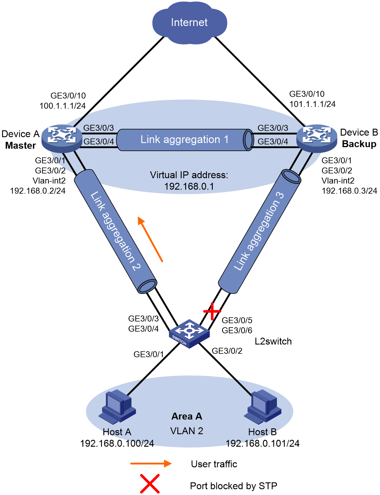

Example: Configuring VRRP with Ethernet link aggregation
As shown in Figure 7, Device A, Device B, and L2switch are connected to one another through aggregate links to improve link reliability.
Configure a VRRP group on Device A and Device B as the gateway for the hosts in Area A to meet the following requirements:
·     If the uplink interface of Device A fails, the hosts in Area A can access the external network through Device B.
Figure 7 Network diagram
Analysis
·     To avoid loops between Device A, Device B, and L2switch, use the spanning tree feature to block a port in the VRRP group.
Hardware
Software version
S12500G-AF
S12500CR
S10500X-G
S7500X-G
When you configure VRRP with Ethernet link aggregation, follow these restrictions and guidelines:
·     Removal of the VRRP group on the IP address owner causes IP address collision. To avoid a collision, change the IP address of the interface on the IP address owner before you remove the VRRP group from the interface.
·     You must configure the same aggregation mode on both ends of an aggregate link.
·     Deleting an aggregate interface also deletes the aggregation group. At the same time, the member ports of the aggregation group, if any, leave the aggregation group.
·     You cannot assign a port to a Layer 2 aggregation group if any of the following features are configured on the port:
¡     MAC authentication. (See XXX Series Security Configuration Guide.)
¡     Port security. (See XXX Series Security Configuration Guide.)
¡     802.1X. (See XXX Series Security Configuration Guide.)
¡     Association between AC and cross-connect. (See XXX Series MPLS Configuration Guide.)
¡     Association between AC and VSI. (See XXX Series VXLAN Configuration Guide.)
Procedures
# Create the Layer 2 aggregate interface Bridge-aggregation 1.
[DeviceA] interface bridge-aggregation 1
[DeviceA-Bridge-Aggregation1] quit
# Assign the ports Ten-GigabitEthernet 3/0/3 and Ten-GigabitEthernet 3/0/4 to Layer 2 aggregation group 1.
[DeviceA] interface ten-gigabitethernet 3/0/3
[DeviceA-Ten-GigabitEthernet3/0/3] port link-aggregation group 1
[DeviceA-Ten-GigabitEthernet3/0/3] quit
[DeviceA] interface ten-gigabitethernet 3/0/4
[DeviceA-Ten-GigabitEthernet3/0/4] port link-aggregation group 1
[DeviceA-Ten-GigabitEthernet3/0/4] quit
# Configure Bridge-Aggregation 1 as a trunk port, and assign it to all VLANs.
[DeviceA-Bridge-Aggregation1] port link-type trunk
[DeviceA-Bridge-Aggregation1] port trunk permit vlan all
# Create the Layer 2 aggregate interface Bridge-Aggregation 2.
[DeviceA] interface bridge-aggregation 2
[DeviceA-Bridge-Aggregation2] quit
# Assign the ports Ten-GigabitEthernet 3/0/1 and Ten-GigabitEthernet 3/0/2 to Layer 2 aggregation group 2.
[DeviceA] interface ten-gigabitethernet 3/0/1
[DeviceA-Ten-GigabitEthernet3/0/1] port link-aggregation group 2
[DeviceA-Ten-GigabitEthernet3/0/1] quit
[DeviceA-Ten-GigabitEthernet3/0/2] port link-aggregation group 2
# Create VLAN 2 and VLAN-interface 2, and assign an IP address to the VLAN interface.
[DeviceA] vlan 2
[DeviceA-Vlan-interface2] ip address 192.168.0.2 24
# Configure Bridge-Aggregation 2 as an access port, and assign the port to VLAN 2.
[DeviceA-Bridge-Aggregation2] port link-type access
[DeviceA-Bridge-Aggregation2] port access vlan 2
# Create VRRP group 1, and set its virtual IP address to 192.168.0.1.
[DeviceA-Vlan-interface2] vrrp vrid 1 virtual-ip 192.168.0.1
# Set the priority of Device A to 110 in VRRP group 1. Device A has a higher priority than Device B in the VRRP group, so Device A can become the master.
[DeviceA-Vlan-interface2] vrrp vrid 1 priority 110
# Create track entry 1 to monitor the link status of the uplink interface Ten-GigabitEthernet 3/0/10.
[DeviceA] track 1 interface ten-gigabitethernet 3/0/10
# Associate VRRP group 1 with track entry 1 and decrease the device priority by 50 when the state of track entry 1 changes to Negative.
[DeviceA-Vlan-interface2] vrrp vrid 1 track 1 priority reduced 50
# Configure MSTP, map VLAN 2 to MSTI 1, and configure Device A as the root bridge of MSTI 1.
[DeviceA-mst-region] instance 1 vlan 2
# Create the Layer 2 aggregate interface Bridge-Aggregation 1.
[DeviceB] interface bridge-aggregation 1
[DeviceB-Bridge-Aggregation1] quit
[DeviceB] interface ten-gigabitethernet 3/0/3
[DeviceB-Ten-GigabitEthernet3/0/3] port link-aggregation group 1
[DeviceB-Ten-GigabitEthernet3/0/3] quit
[DeviceB] interface ten-gigabitethernet 3/0/4
[DeviceB-Ten-GigabitEthernet3/0/4] port link-aggregation group 1
[DeviceB-Ten-GigabitEthernet3/0/4] quit
[DeviceB-Bridge-Aggregation1] port link-type trunk
[DeviceB-Bridge-Aggregation1] port trunk permit vlan all
# Create the Layer 2 aggregate interface Bridge-Aggregation 3.
[DeviceB] interface bridge-aggregation 3
[DeviceB-Bridge-Aggregation3] quit
# Assign the ports Ten-GigabitEthernet 3/0/1 and Ten-GigabitEthernet 3/0/2 to Layer 2 aggregation group 3.
[DeviceB] interface ten-gigabitethernet 3/0/1
[DeviceB-Ten-GigabitEthernet3/0/1] port link-aggregation group 3
[DeviceB-Ten-GigabitEthernet3/0/1] quit
[DeviceB-Ten-GigabitEthernet3/0/2] port link-aggregation group 3
[DeviceB] vlan 2
[DeviceB-Vlan-interface2] ip address 192.168.0.3 24
# Configure Bridge-Aggregation 3 as an access port, and assign the port to VLAN 2.
[DeviceB-Bridge-Aggregation3] port link-type access
[DeviceB-Bridge-Aggregation3] port access vlan 2
[DeviceB-Vlan-interface2] vrrp vrid 1 virtual-ip 192.168.0.1
# Configure MSTP, map VLAN 2 to MSTI 1, and configure Device B as a secondary root bridge in MSTI 1.
[DeviceB-mst-region] instance 1 vlan 2
Configuring L2switch
<L2switch> system-view
[L2switch] interface bridge-aggregation 2
[L2switch-Bridge-Aggregation2] quit
# Assign the ports Ten-GigabitEthernet 3/0/3 and Ten-GigabitEthernet 3/0/4 to Layer 2 aggregation group 2.
[L2switch] interface ten-gigabitethernet 3/0/3
[L2switch-Ten-GigabitEthernet3/0/3] port link-aggregation group 2
[L2switch-Ten-GigabitEthernet3/0/3] quit
[L2switch] interface ten-gigabitethernet 3/0/4
[L2switch-Ten-GigabitEthernet3/0/4] port link-aggregation group 2
[L2switch-Ten-GigabitEthernet3/0/4] quit
[L2switch] interface bridge-aggregation 3
[L2switch-Bridge-Aggregation3] quit
# Assign the ports Ten-GigabitEthernet 3/0/5 and Ten-GigabitEthernet 3/0/6 to Layer 2 aggregation group 3.
[L2switch] interface ten-gigabitethernet 3/0/5
[L2switch-Ten-GigabitEthernet3/0/5] port link-aggregation group 3
[L2switch-Ten-GigabitEthernet3/0/5] quit
[L2switch] interface ten-gigabitethernet 3/0/6
[L2switch-Ten-GigabitEthernet3/0/6] port link-aggregation group 3
[L2switch-Ten-GigabitEthernet3/0/6] quit
# Create VLAN 2, configure Bridge-Aggregation 2 and Bridge-Aggregation 3 as access ports, and assign the aggregate interfaces to VLAN 2.
[L2switch] vlan 2
[L2switch-vlan2] quit
[L2switch-Bridge-Aggregation2] port access vlan 2
[L2switch-Bridge-Aggregation3] port access vlan 2
[L2switch] stp region-configuration
[L2switch-mst-region] region-name vrrp
# Map VLAN 2 to MSTI 1, and activate the MST region configuration.
[L2switch-mst-region] instance 1 vlan 2
[L2switch-mst-region] active region-configuration
[L2switch-mst-region] quit
[L2switch] stp global enable
     Version        : 3
# Display detailed information about all VRRP groups on Device B.
     Become Master  : 2950ms left
     Version        : 3
3.     Verify that link aggregation groups are successfully configured on Device A, Device B, and L2switch.
# Display brief information about all Layer 2 aggregate interfaces on Device A.
[DeviceA] display interface Bridge-Aggregation brief
Brief information on interfaces in bridge mode:
Link: ADM - administratively down; Stby - standby
Speed: (a) - auto
Duplex: (a)/A - auto; H - half; F - full
Type: A - access; T - trunk; H - hybrid
Interface            Link Speed   Duplex Type PVID Description
BAGG1                UP   2G(a)   F(a)   A    1
BAGG2                UP   2G(a)   F(a)   A    2
# Display brief information about all Layer 2 aggregate interfaces on Device B.
[DeviceB] display interface Bridge-Aggregation brief
Speed: (a) - auto
BAGG3                UP   2G(a)   F(a)   A    2
# Display brief information about all Layer 2 aggregate interfaces on L2switch.
[L2switch] display interface Bridge-Aggregation brief
Speed: (a) - auto
The output shows that the speed of each aggregate link is 2 Gbps, and the bandwidth is twice the bandwidth of each physical link.
4.     Verify that Host A can still ping the IP address 20.1.1.1 after the uplink interface Ten-GigabitEthernet 3/0/10 of Device A fails.
C:\Users\hostA>ping 20.1.1.1
Pinging 20.1.1.1 with 32 bytes of data:
Reply from 20.1.1.1: bytes=32 time<1ms TTL=128
Ping statistics for 20.1.1.1:
5.     Verify that Device B takes over to forward packets from the hosts in Area A to the external network after Ten-GigabitEthernet 3/0/10 of Device A fails.
# Display detailed information about all VRRP groups on Device A.
     Config Pri     : 110                 Running Pri  : 60
     Become Master  : 3350ms left
     Version        : 3
     Track Object   : 1                   State : Negative   Pri Reduced : 50
     Version        : 3
6.     Verify that Device A becomes the master to forward packets from the hosts in Area A to the external network when Ten-GigabitEthernet 3/0/10 recovers.
     Version        : 3
     Version        : 3
Configuration files
·     Device A:
 sysname DeviceA
vlan 2
 region-name vrrp
 instance 1 vlan 2
stp global enable
interface Bridge-Aggregation1
interface Bridge-Aggregation2
 port access vlan 2
 ip address 192.168.0.2 255.255.255.0
 port access vlan 2
interface GigabitEthernet3/0/2
 port access vlan 2
interface Ten-GigabitEthernet3/0/4
track 1 interface Ten-GigabitEthernet3/0/10
·     Device B:
 sysname DeviceB
vlan 2
 region-name vrrp
 instance 1 vlan 2
stp global enable
 port access vlan 2
 ip address 192.168.0.3 255.255.255.0
 port access vlan 2
 port access vlan 2
·     L2switch:
 sysname L2switch
vlan 2
 region-name vrrp
 instance 1 vlan 2
 stp global enable
 port access vlan 2
interface Bridge-Aggregation3
 port access vlan 2
 port access vlan 2
 port access vlan 2
 port access vlan 2
interface Ten-GigabitEthernet3/0/5
 port access vlan 2
interface Ten-GigabitEthernet3/0/6
 port access vlan 2
