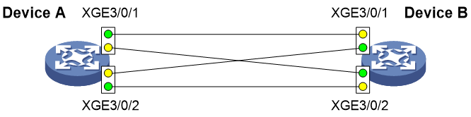

As shown in Figure 1, Device A and Device B are connected through two fiber pairs.
Configure DLDP on the devices so each device performs the following tasks:
·     Detects unidirectional links caused by cross-connected fibers or a disconnected fiber.
·     Automatically shuts down the faulty interface when detecting a unidirectional link.
·     Automatically brings up the interface after the administrator clears the fault.
Figure 1 Network diagram

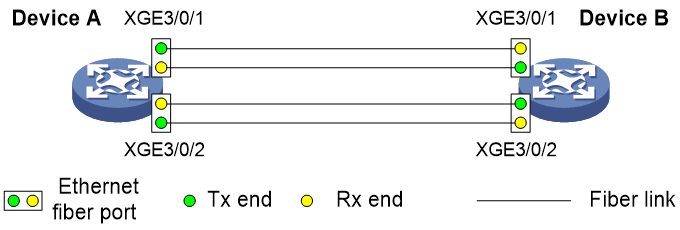

As shown in Figure 2, the two pairs of fibers between Device A and Device B are cross-connected.
Figure 2 Cross-connected fibers
The following log information is displayed on Device A:
<DeviceA>%Jul 11 17:40:31:089 2018 DeviceA IFNET/3/PHY_UPDOWN: Physical state on the interface Ten-GigabitEthernet3/0/1 changed to down.
%Jul 11 17:40:31:091 2018 DeviceA IFNET/5/LINK_UPDOWN: Line protocol state on the interface Ten-GigabitEthernet3/0/1 changed to down.
%Jul 11 17:40:31:677 2018 DeviceA IFNET/3/PHY_UPDOWN: Physical state on the interface Ten-GigabitEthernet3/0/2 changed to down.
%Jul 11 17:40:31:678 2018 DeviceA IFNET/5/LINK_UPDOWN: Line protocol state on the interface Ten-GigabitEthernet3/0/2 changed to down.
%Jul 11 17:40:38:544 2018 DeviceA IFNET/3/PHY_UPDOWN: Physical state on the interface Ten-GigabitEthernet3/0/1 changed to up.
%Jul 11 17:40:38:836 2018 DeviceA IFNET/3/PHY_UPDOWN: Physical state on the interface Ten-GigabitEthernet3/0/2 changed to up.
The output shows that the physical status of both Ten-GigabitEthernet 3/0/1 and Ten-GigabitEthernet 3/0/2 is down and then up. The link status of both interfaces is down.

The output shows that the physical status of Ten-GigabitEthernet 3/0/1 is up, but DLDP automatically shuts down the interface. The output for interface Ten-GigabitEthernet 3/0/2 is similar to Ten-GigabitEthernet 3/0/1. (Details not shown.)

The output shows that the DLDP port status of both Ten-GigabitEthernet 3/0/1 and Ten-GigabitEthernet 3/0/2 is Unidirectional. DLDP has detected a unidirectional link on both interfaces.
# Correct the fiber connections. As a result, the ports shut down by DLDP automatically recover, and Device A displays the following log information:

As shown in Figure 4, the two pairs of fibers between Device A and Device B are cross-connected.
Figure 4 Cross-connected fibers
<DeviceA>%Jul 12 08:29:17:786 2018 DeviceA IFNET/3/PHY_UPDOWN: Physical state on the interface Ten-GigabitEthernet3/0/1 changed to down.
%Jul 12 08:29:17:787 2018 DeviceA IFNET/5/LINK_UPDOWN: Line protocol state on the interface Ten-GigabitEthernet3/0/1 changed to down.
%Jul 12 08:29:17:800 2018 DeviceA IFNET/3/PHY_UPDOWN: Physical state on the interface Ten-GigabitEthernet3/0/2 changed to down.
%Jul 12 08:29:17:800 2018 DeviceA IFNET/5/LINK_UPDOWN: Line protocol state on the interface Ten-GigabitEthernet3/0/2 changed to down.
%Jul 12 08:29:25:004 2018 DeviceA IFNET/3/PHY_UPDOWN: Physical state on the interface Ten-GigabitEthernet3/0/1 changed to up.
%Jul 12 08:29:25:005 2018 DeviceA IFNET/5/LINK_UPDOWN: Line protocol state on the interface Ten-GigabitEthernet3/0/1 changed to up.
%Jul 12 08:29:25:893 2018 DeviceA IFNET/3/PHY_UPDOWN: Physical state on the interface Ten-GigabitEthernet3/0/2 changed to up.
%Jul 12 08:29:25:894 2018 DeviceA IFNET/5/LINK_UPDOWN: Line protocol state on the interface Ten-GigabitEthernet3/0/2 changed to up.
The output shows that the physical status and link status of both Ten-GigabitEthernet 3/0/1 and Ten-GigabitEthernet 3/0/2 are down and then up.

As shown in Figure 6, the two pairs of fibers between Device A and Device B are cross-connected.
Figure 6 Cross-connected fibers
<DeviceA>%Jan  4 07:16:06:556 2018 DeviceA DLDP/5/DLDP_NEIGHBOR_AGED: A neighbor on interface
Ten-GigabitEthernet3/0/1 was deleted because the neighbor was aged. The neighbor's system MAC is 0023-8956-3600, and the port index is 162.
%Jan  4 07:16:06:560 2018 DeviceA DLDP/5/DLDP_NEIGHBOR_AGED: A neighbor on interface
Ten-GigabitEthernet3/0/2 was deleted because the neighbor was aged. The neighbor's system MAC is 0023-8956-3600, and the port index is 165.
%Jan  4 07:16:06:724 2018 DeviceA IFNET/3/PHY_UPDOWN: Physical state on the interface Ten-GigabitEthernet3/0/1 changed to down.
%Jan  4 07:16:06:730 2018 DeviceA IFNET/3/PHY_UPDOWN: Physical state on the interface Ten-GigabitEthernet3/0/2 changed to down.
%Jan  4 07:16:06:736 2018 DeviceA IFNET/5/LINK_UPDOWN: Line protocol state on the interface Ten-GigabitEthernet3/0/1 changed to down.
%Jan  4 07:16:06:738 2018 DeviceA IFNET/5/LINK_UPDOWN: Line protocol state on the interface Ten-GigabitEthernet3/0/2 changed to down.
%Jan  4 07:16:07:152 2018 DeviceA DLDP/3/DLDP_LINK_UNIDIRECTIONAL: DLDP detected a unidirectional link on interface Ten-GigabitEthernet3/0/1. DLDP automatically shut down the interface. Please manually bring up the interface.
%Jan  4 07:16:07:156 2018 DeviceA DLDP/3/DLDP_LINK_UNIDIRECTIONAL: DLDP detected a unidirectional link on interface Ten-GigabitEthernet3/0/2. DLDP automatically shut down the interface. Please manually bring up the interface.
The output shows that the port status and link status of both Ten-GigabitEthernet 3/0/1 and Ten-GigabitEthernet 3/0/2 are down.
