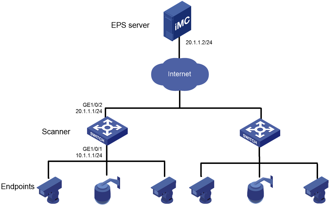

As shown in Figure 2, configure the scanner to enable it to scan endpoints based on the instruction of the EPS server.
Figure 2 Network diagram

# Specify 20.1.1.2 and 4500 as the IP address and port number of the EPS server, respectively.
<Sysname> system-view
[Sysname] eps server 20.1.1.2 port 4500
# Enable EPS agent on slot 1.
[Sysname] eps agent enable slot 1
# Display EPS scanner information.
[Sysname] display eps agent
EPS agent information:
  Slot       Port number
  1          12000
EPS server information:
  IP address        : 20.1.1.2
  Port number       : 4500
  Cipher key        : $c$3$rGn++lJ/vHnkk1oQDAKX9NLIz+4vXONZXCRTpQ==
  Log level         : 5
  Use server setting: Yes
# Verify that the scanned information is displayed on slot 1 after the EPS server issues a scan instruction.
[Sysname] display eps agent discovery slot 1
IP-Address        MAC-Address        OS-Type  OS-ver   Vendor    Product
100.100.100.100  cc:ef:48:9b:5f:c1 IOS       12.X     Cisco     C3560E
