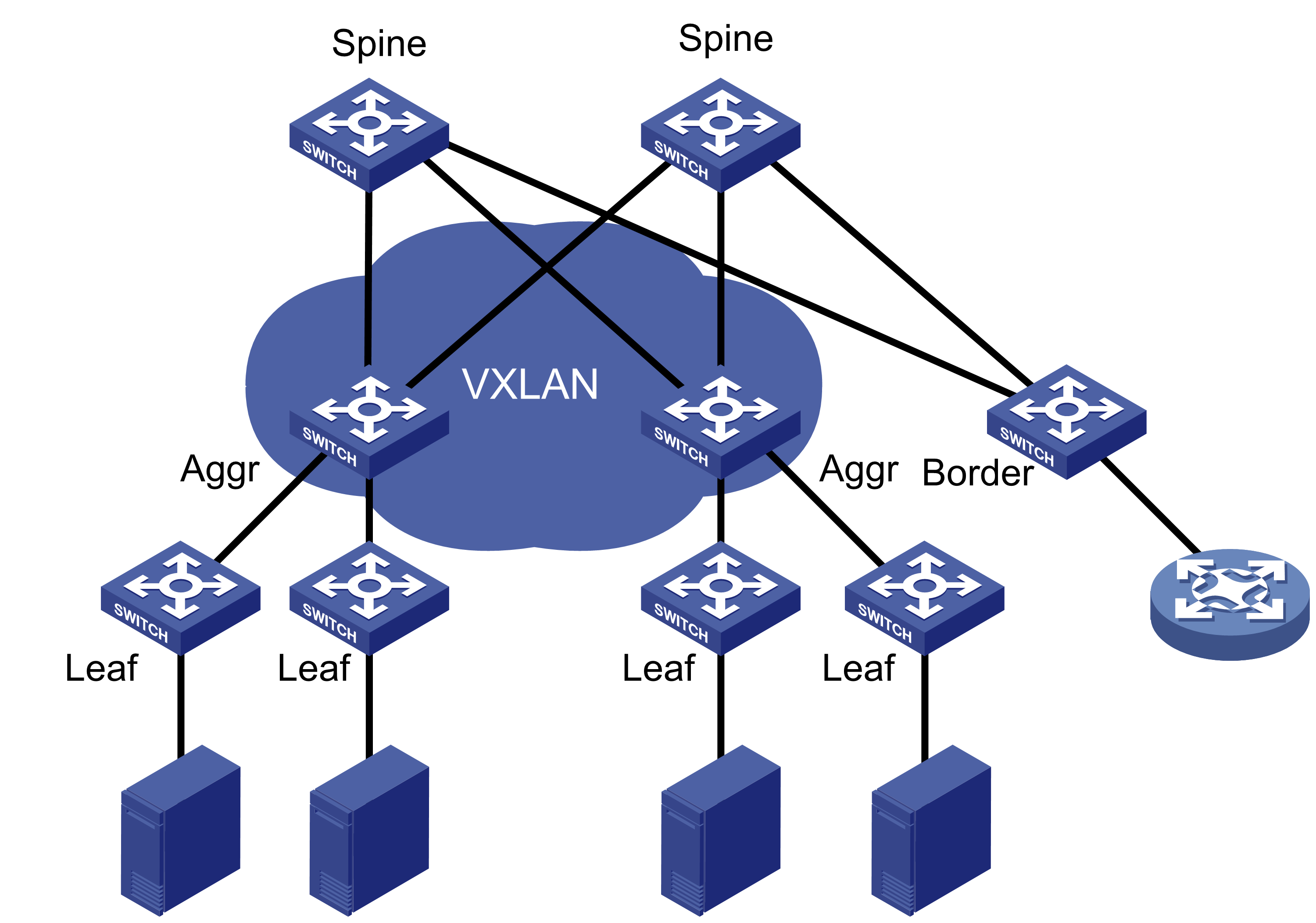

As shown in Figure 1, the following nodes exist in a 2-layer data center VCF fabric:
·     Spine node—Connects to leaf nodes.
·     Leaf node—Connects to servers.
·     Border node—Located at the border of a VCF fabric to provide access to the external network.
Spine nodes and leaf nodes form a large Layer 2 network, which can be a VLAN, a VXLAN with centralized IP gateways, or a VXLAN with distributed IP gateways. For more information about centralized IP gateways and distributed IP gateways, see VXLAN Configuration Guide.
Figure 1 Topology for a 2-layer data center VCF fabric

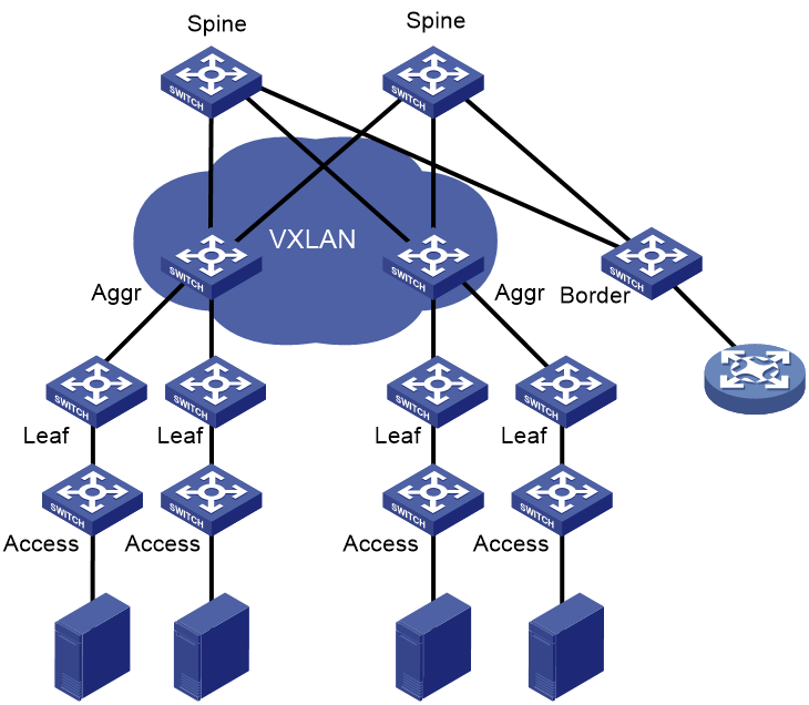

Topology for a 4-layer data center VCF fabric
In a 4-layer data center VCF fabric, a device has one of the following roles:
·     Spine node—Connects to aggregate nodes.
·     Aggregate node—Located between leaf nodes and spine nodes.
·     Leaf node—Located between aggregate nodes and access nodes.
·     Access node—An access device, which connects to an upstream leaf node and a downstream server.
OSPF runs on the Layer 3 networks between the spine and aggregate nodes and between the aggregate and leaf nodes. VXLAN is used to set up the Layer 2 overlay network.
Figure 3 Topology for a 4-layer data center VCF fabric
